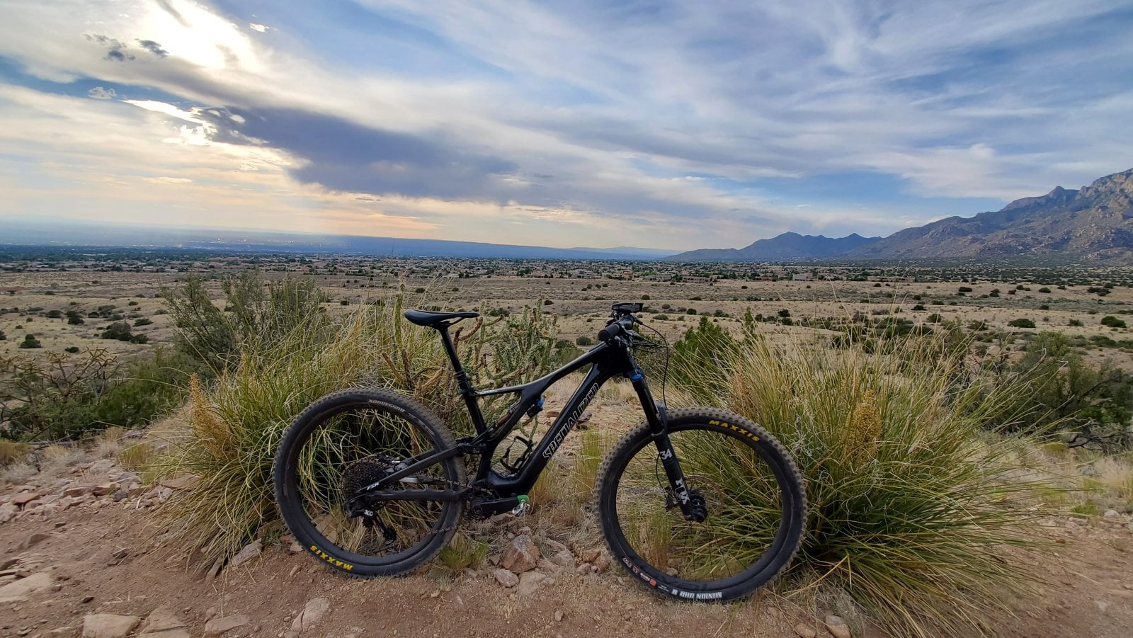

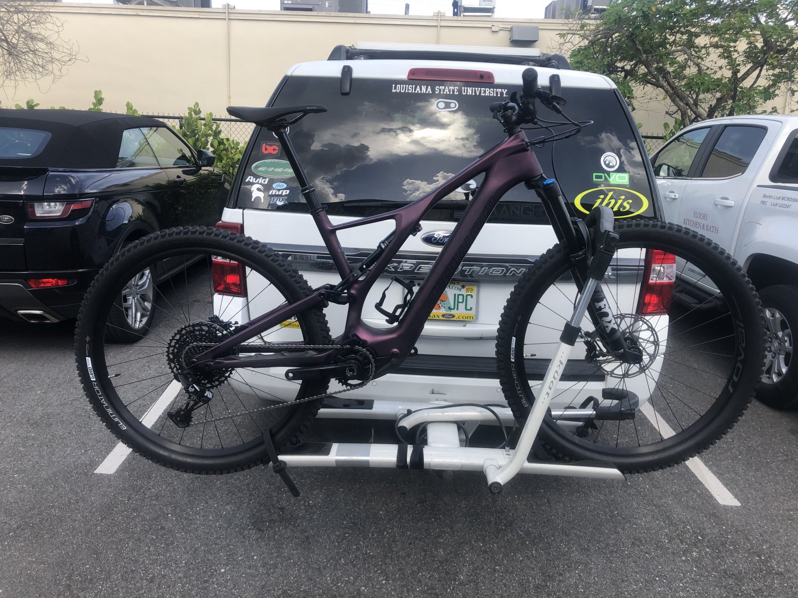

My new bike!

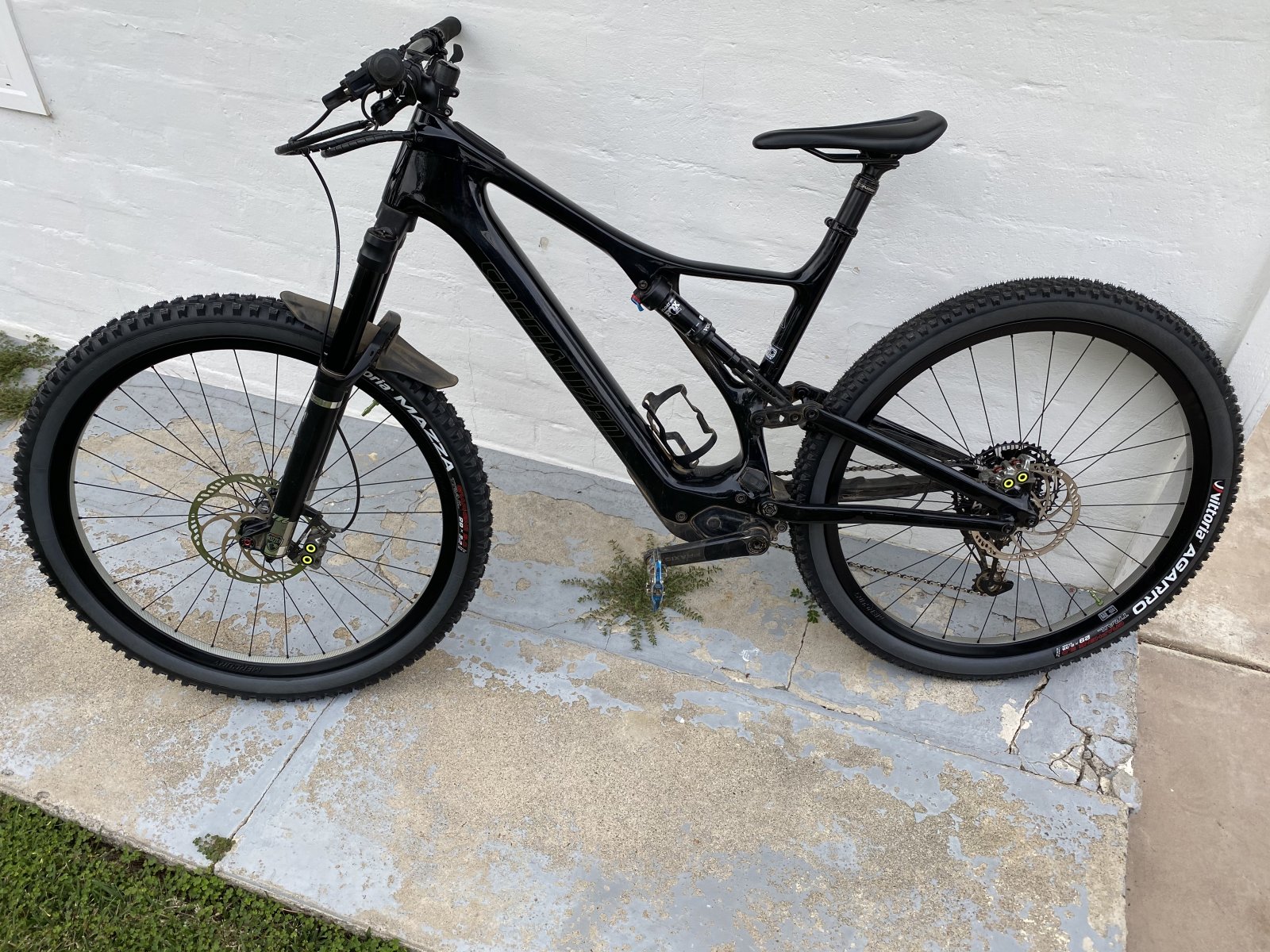

Got some new shoes... Mercury Enduro X1 carbon hoops and Vittoria tires. Shave ~1.6lbs off the bike (also added a TRS 12+ cassette). I am at 39.84 lbs now :) (not going for weight, but sub 40lb is nice) .Definitely felt snappier + more damp over small bump. Super fun!

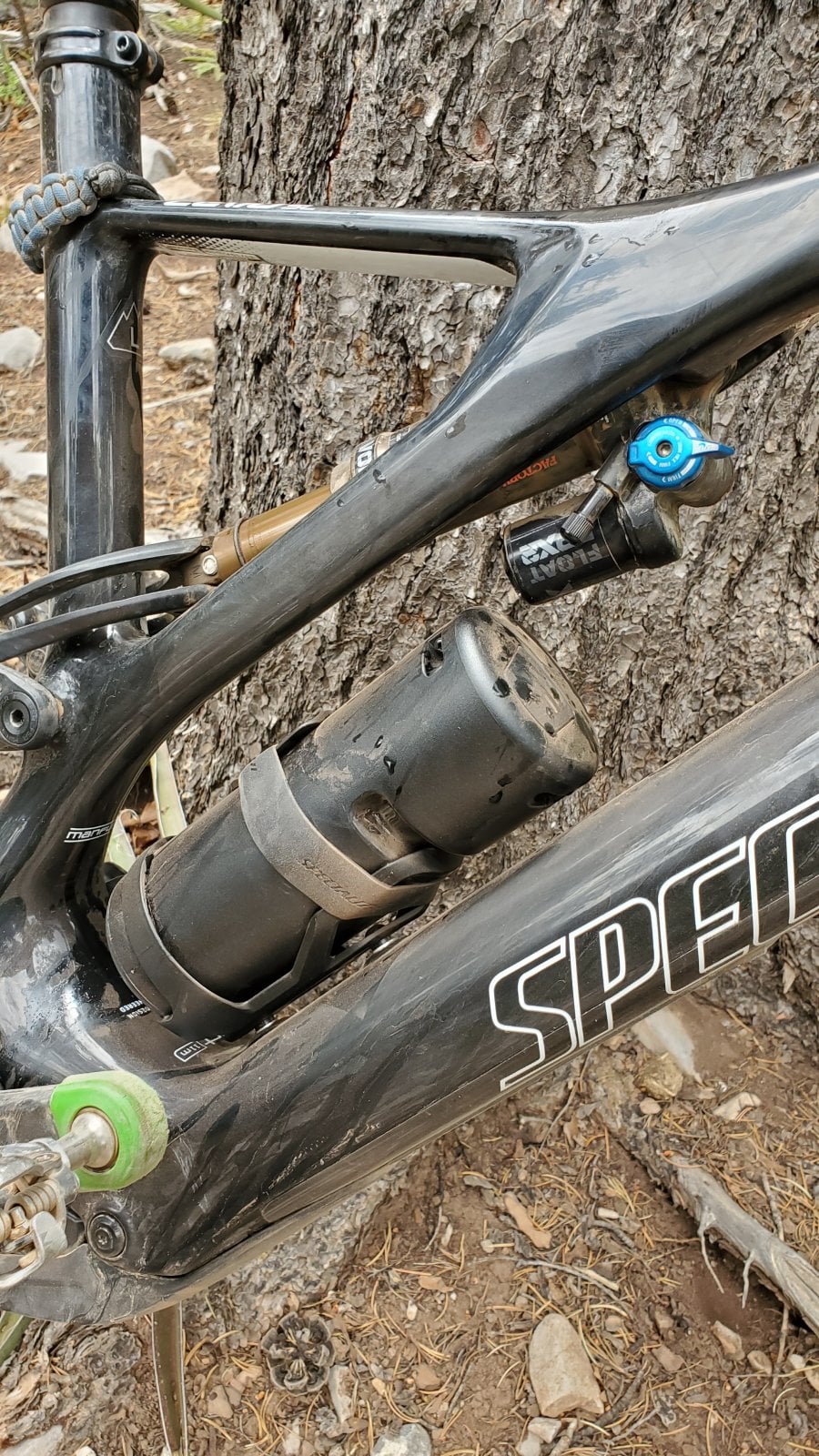

Anyone having issues getting their range extender to fasten properly to the bike? I am having an issue sliding the attachment ring to the locked position. Thinking I may be doing it wrongly as well. I was trying without luck to find a video showing exactly how that locking ring works (or should work). Any tips, insights, or content would be most appreciated.
@Tommidd - see post #1216
Yes, clockwise 90°. You can confirm rotation off the bike.
On the bike it should go from near vertical to near horizontal .
It turns easily once properly aligned - you should not have to force it.
Can be a bit fiddly. Try pressing the cap inward while turning the lever.
Cable tension can make it difficult. Mine fits best with the bottle cage slammed down.
I was having trouble at first. Push the cable plug firmly into the charging port. That sorted it for me.
Has any one had any issues with the lever on the rear shock moving after using your water bottle? I'm finding that after i have had a drink the lever is being nudged over too lock out position :mad:, minor issue but bloody annoying tho.
Any hacks or bodges to sort this?
There is an expensive option-DPX2. Also, no clearance issues with the new shock and RE/ mid-sized water bottles.
