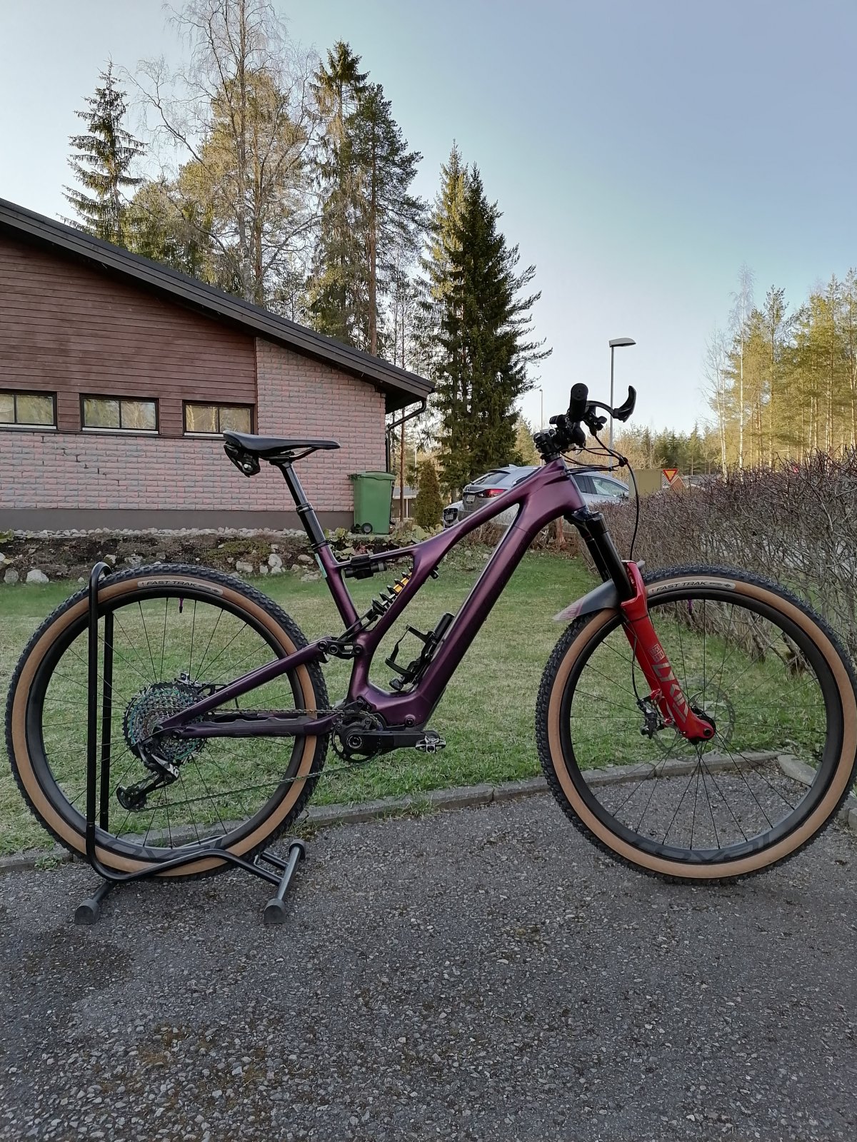

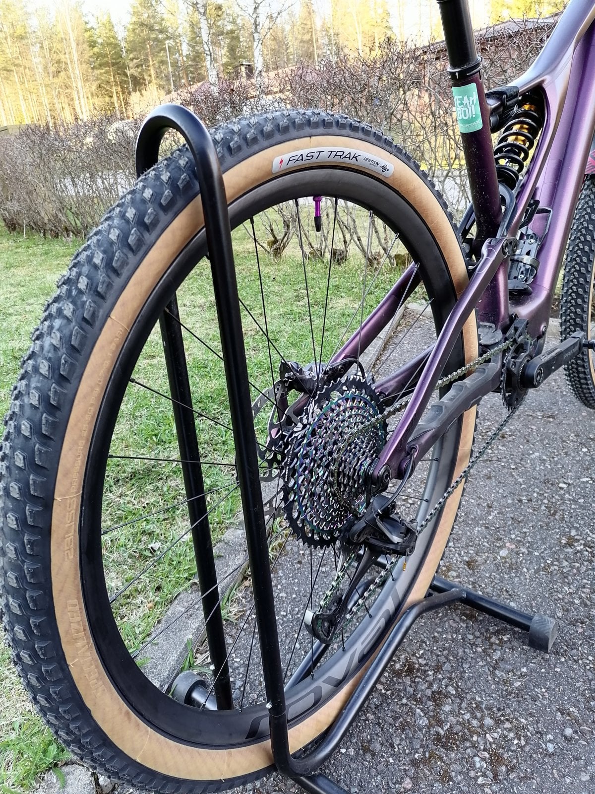

Tested today those roval carbon wheels wrapped with fast traks.
Wtf??? this thing accelerates like F1 and keeps its speed fastastic.
Also steering is very precise now ?
Did you upgrade the wheels to a comp model or just added the tires to your existing wheels?
Skin Wall Fast Tracks?

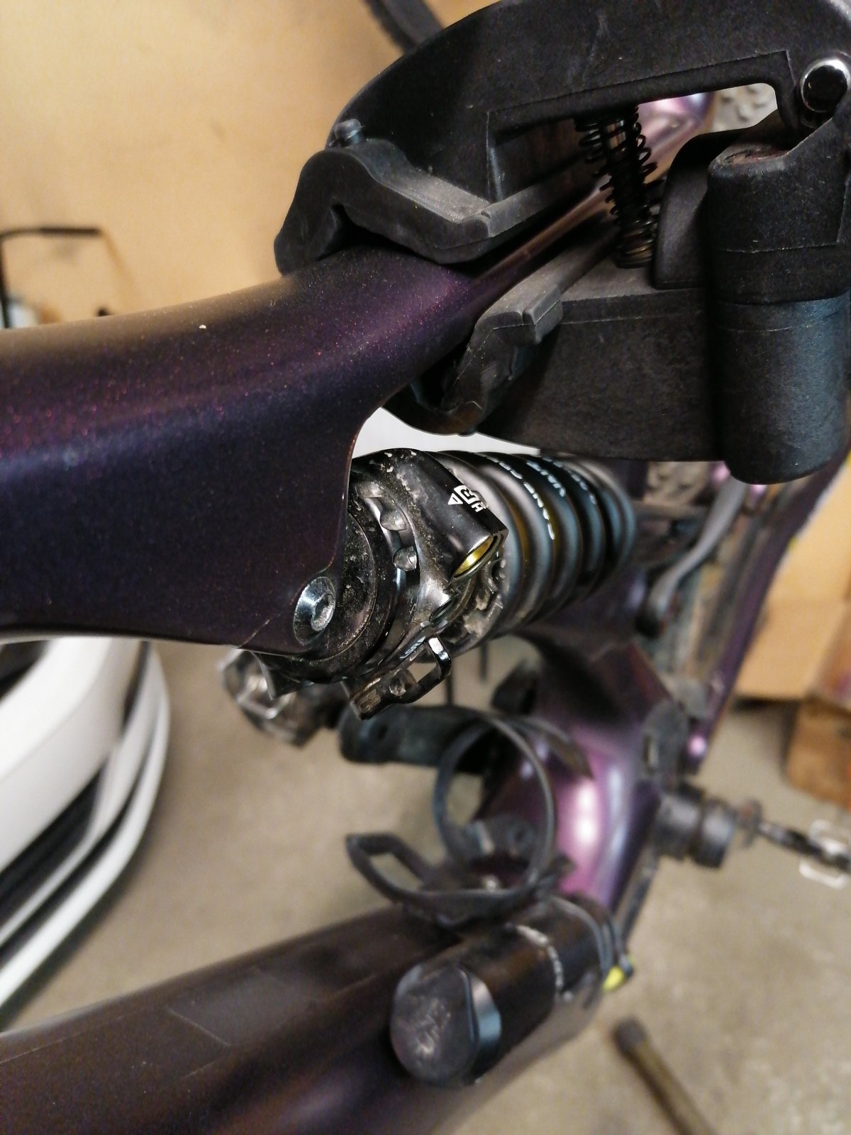

Can you send me a picture of the upper part from your shock mount, please?
I tried to fit a cane creek shock and it didn‘t work.
It needs to be stumjumper specific and top of the shock needs to be tilted 45' to the right

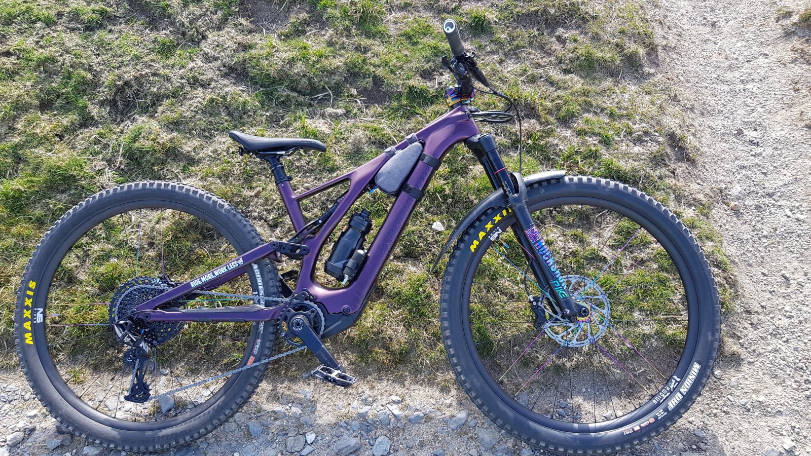

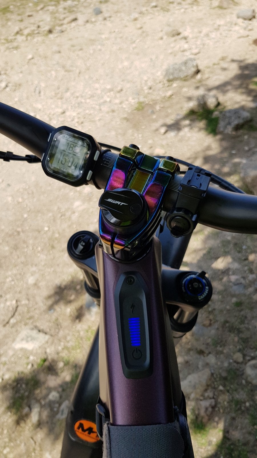

Well, she's here, after 3 long weeks of waiting and a day of stripping and rebuilding. Size M, comes in at a shade over 20kgs, ride ready and with a full water bottle. Like for like, as if it had come out of the shop, my build was 10g lighter than the stock spec! That includes Code R brakes, a GX cassette, the Pike (2018 RCT3, with 2021 DebonAir spring), a Double Down 2.5" rear tyre, and a Nukeproof insert in the 2.6 Exo+ front, plus a bunch of other bits. The wheels and stem are particular highlights for me, just because of the bling (wheels lighter than stock, stem heavier)!
