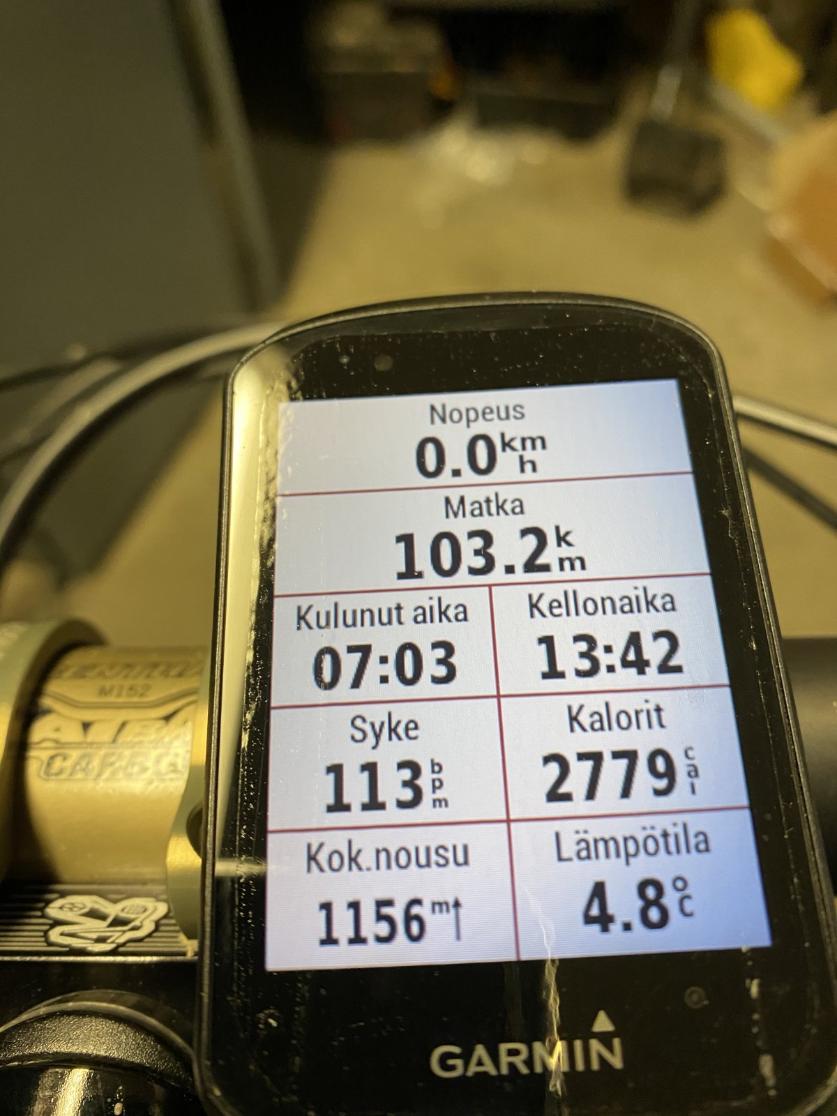

So what ranges arw people getting with sl levo, without range extender?Yesterday did a ride with my 2020 levo comp, bit over 100km and battery left around 30%. mostly ride with eco 15/30, little turbo 100/100.

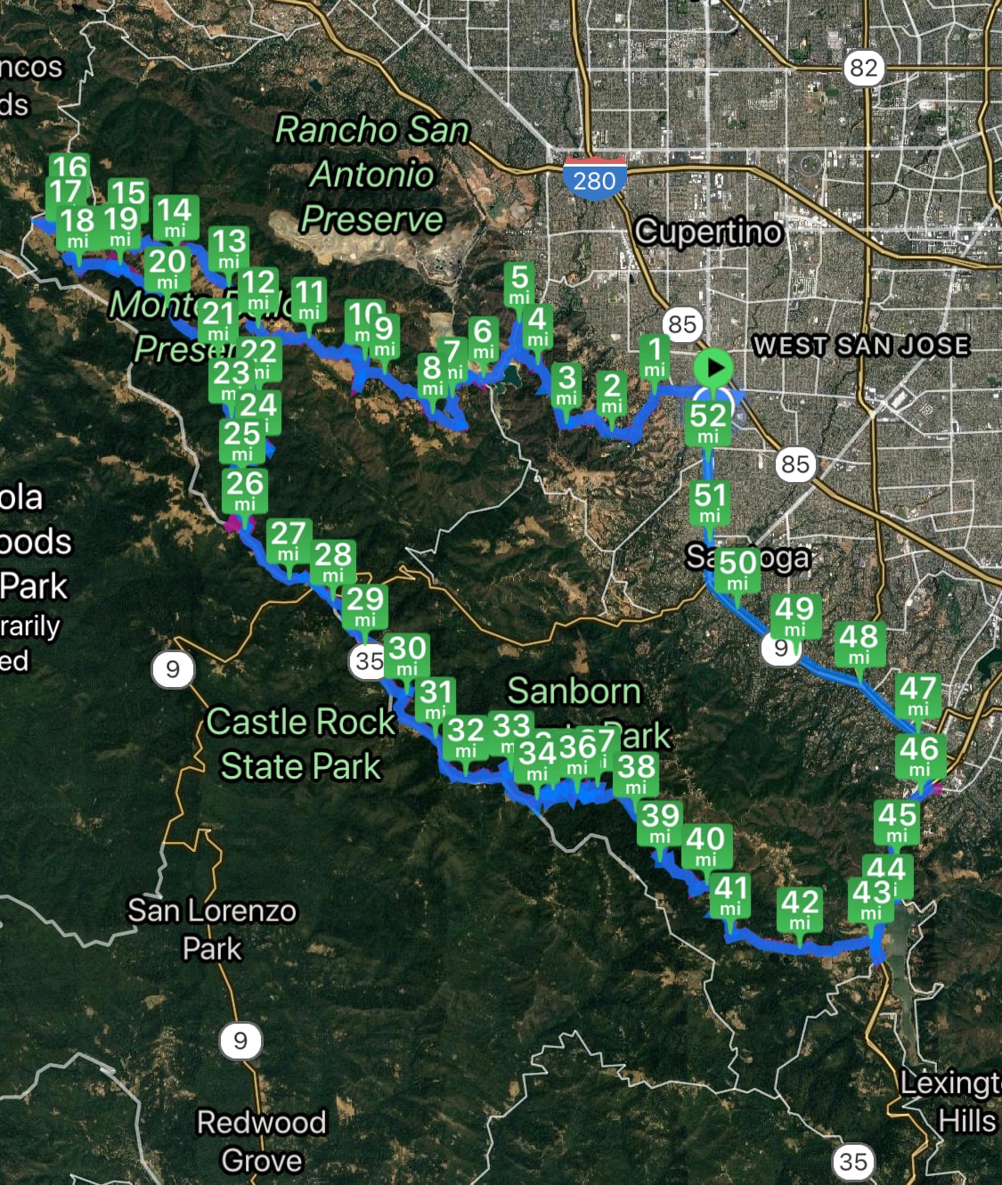

Rode solo again today. Ride time is about 6.5 hours; about 53 miles and 7,300 ft of elevation. All eco until the last 3 miles where I used trail. I used 2 extenders. The first extender lasted for about 10.72 miles and 2,600 ft of elevation. After this ride, I have 23% left. For comparison purposes, I did the same ride with my pivot shuttle using 2 batteries but only managed 45 miles and 6,600 ft of elevation. The SL is very efficient and the weight really is noticeable when climbing steeps.

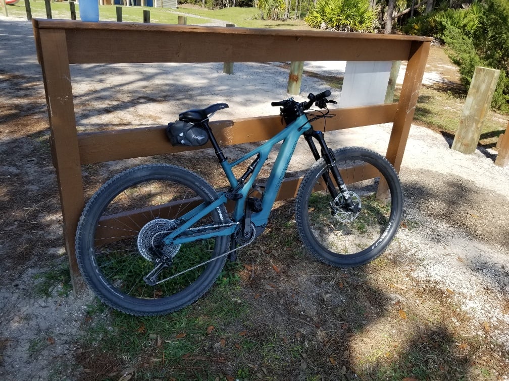

Been riding my Levo SL Comp for about a month, my most ambitious ride so far was 32 miles. The ride is Florida flat, elevation change of less than 16 feet except for the bridge over the ICW which is a whopping 75'. Most of the ride was in Eco (set for 35/45) except for the bridge where I used Turbo for the minute or so it took to climb the grade (maybe 12%). The battery was down to about half so I can probably expect 50-60 miles on a charge.

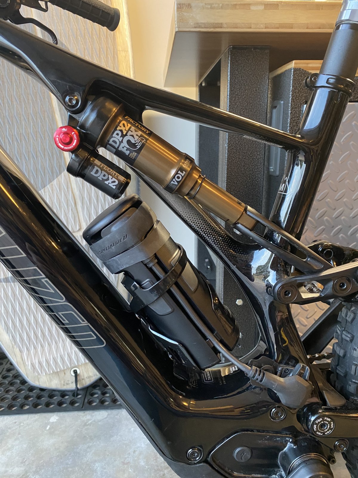

Can you get full compression out of that with the range extender?
I’d like to know if anyone has tried a Rockshox Super Deluxe Ultimate, and if it fits?
I want to know this too as ive got coil ultimate on my stumpy and now im thinking this wont fit .. im about to order my comp carbon any day now .. this would pee my right off if the extender wont fit .
