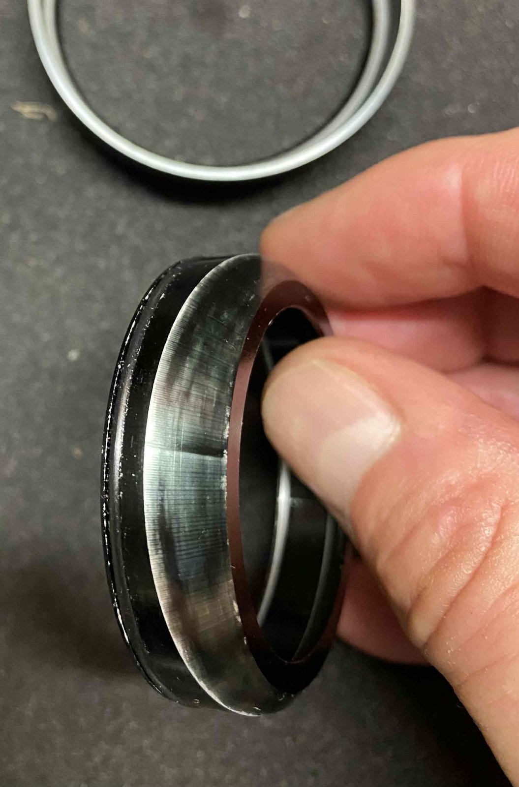

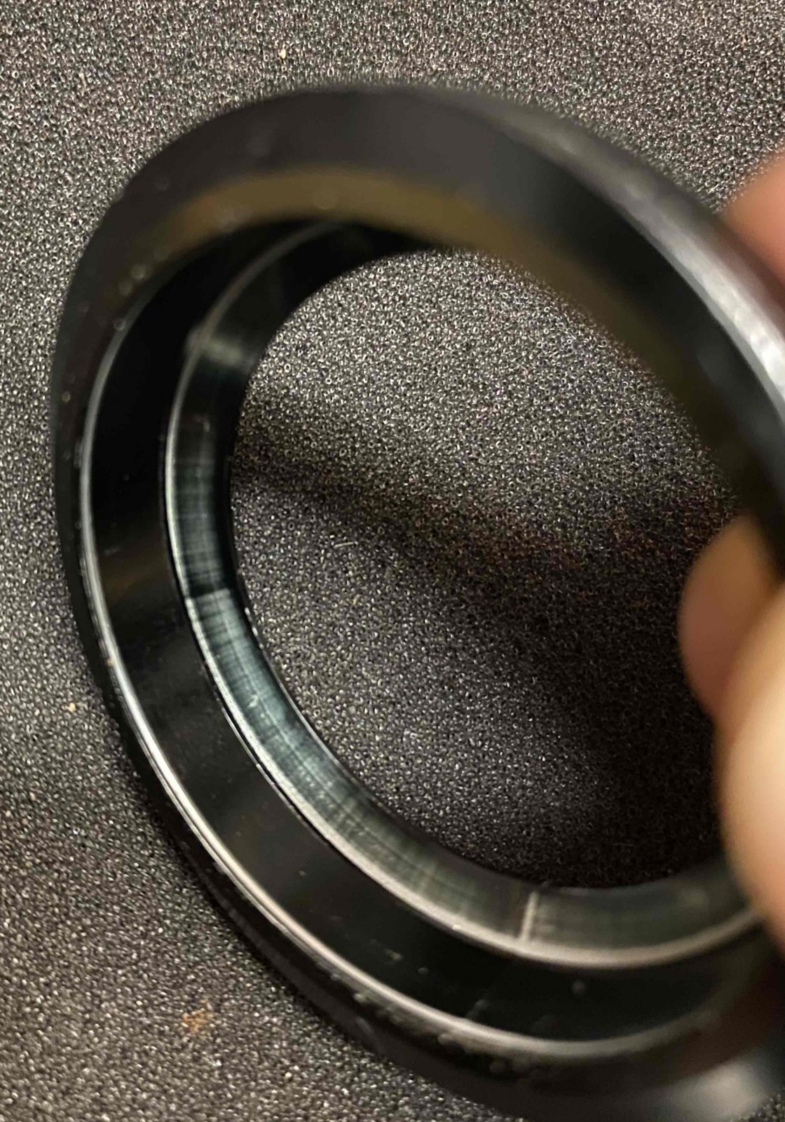

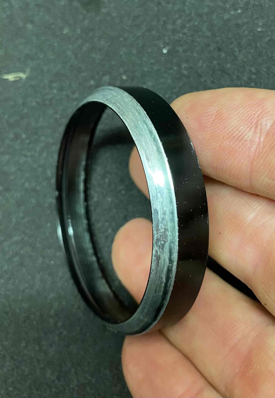

Also has anyone had any drama with the headset cup and frame interface creaking and cracking under load? My bike has done it from new and it is incredibly distracting when it starts as it sounds like carbon cracking. Only remedy was to remove the front end, clean and regrease. I was getting 5 or 6 rides before it started again but now its all the time no matter what I do.
To be clear its only when the fork is under heavy load will this occur so normal trail riding is fine but heavy braking on steeps into jumps, the landings always get a good crack....every time is happens it makes me cringe! I've changed bearings and forks multiple times, everything is torqued to spec (over and under to check also). The difference between the outer diameter of the cup and the inner diameter of the frame is 1.2mm which Specialized seem to think is ok. Replacement cups have been on order since christmas..
Couple of pics of the wear on the cups
Same thing for my headset cup. It only started with the angled cup though. The bearing is rusty too only after a couple of muddy rides. I'll get some other bearing to test it with. The ones from Chris King should work. I have regreased it with marine grease and will see how long this will last.
I’ve tried multiple different bearings including a Chris King lower bearing and a few different high pressure greases but still end up with the cups cracking and creaking.
Have you measured the ID of the frame and the OD of the lower cup? My frame is about 1.6mm bigger than the OD of the lower cup. Not sure if this clearance should be smaller to help stop it moving…waiting for Specialized to respond directly to that question.
Have you tried copper grease?

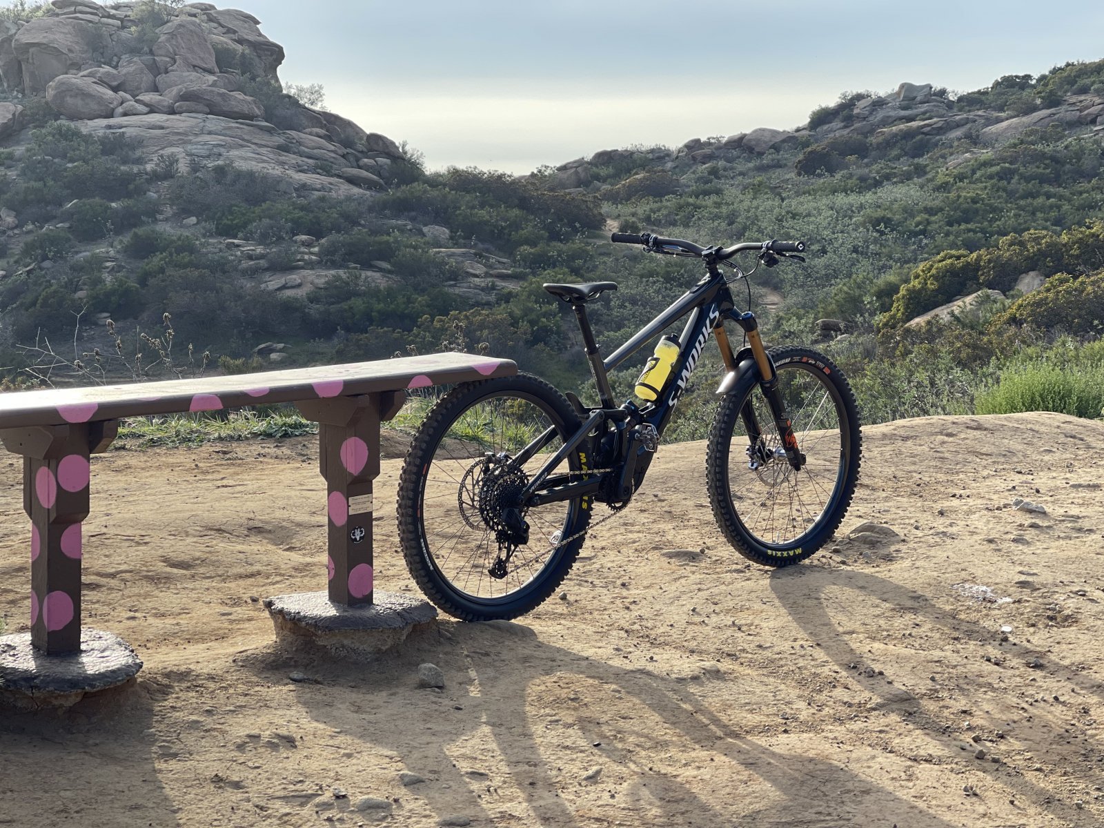

Nice! Rocky Peak. I need to get back out there, coming from SB, hit it maybe 6x a year. BTW I do shuttle runs for SB if people want, usually Cold Springs (1-2x) Tunnel, Arroyo Burro.
Yes sir! Trails are running pretty good right now 🤙🏼 Never been up to SB but need to… very likely this summer to escape the Simi Valley heat 😉

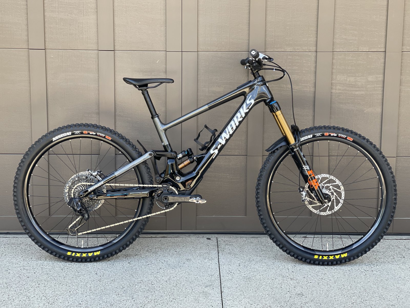

Is the bike too long for you? Because you have pushed the saddle all the way to the front.
No not to long, I have a 35.5” inseam so a very high seat height, putting the saddle forward in the rails makes for a comfy position 🤷🏼‍♂️
I’m 6’1 ish riding a S4 with a 210mm dropper 👍🏼 I think I’ve since moved the saddle forward about 10mm
