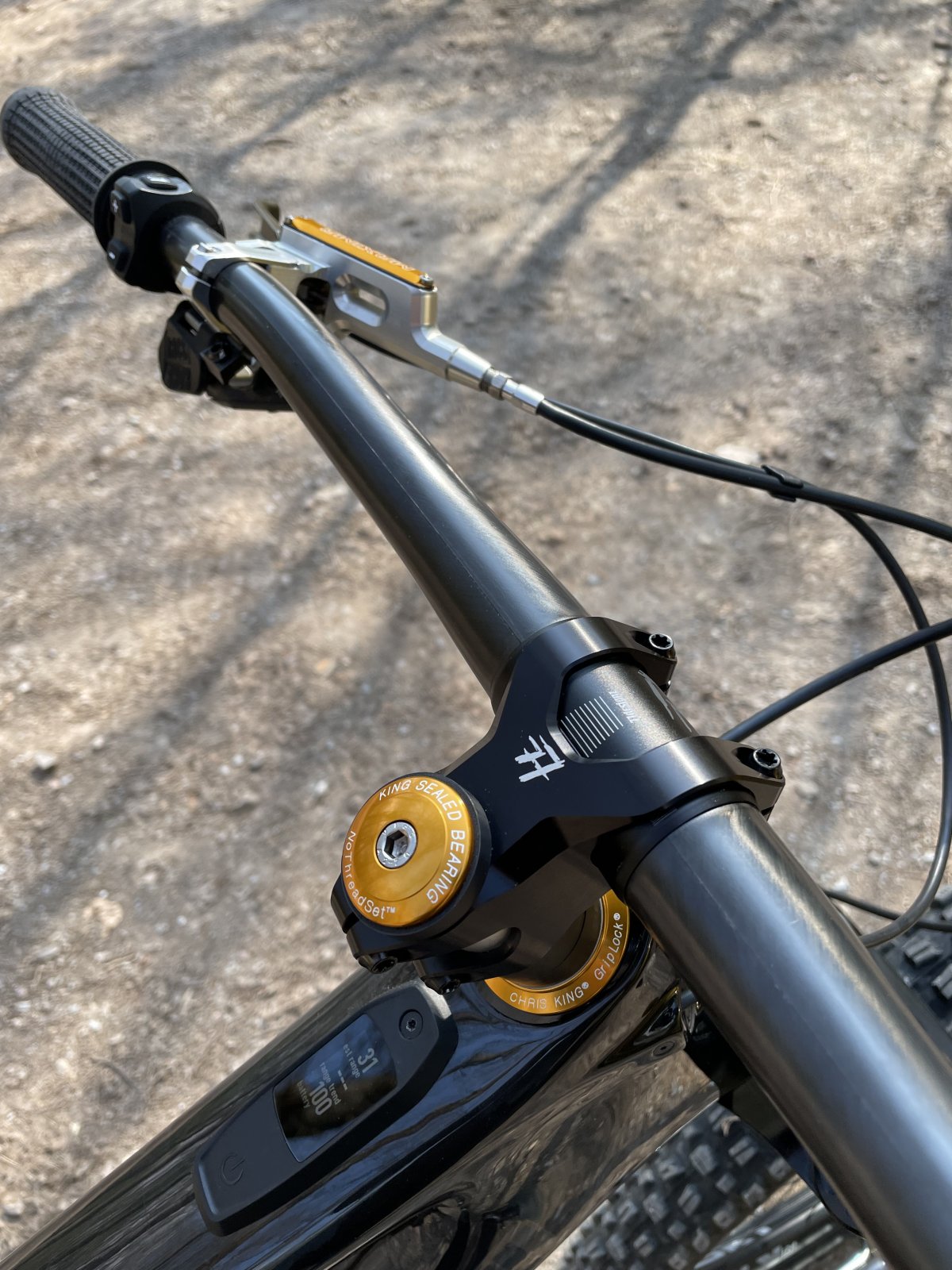

I know it could be everything and it's not necessarily KSL specific, but maybe someone has an idea. I'm running out of them.
After a few of descents my headset develops some play - again and again. I correct it, it feels fine, until it does not after a few rounds. It's annoying and kills my confidence. I tried the original SWAT tool, an Intend Smarty expander and now a star nut.
I use a 77designz stem torqued to the max. of 8 nm
With 8 nm and the nut it seems to be better. All rides two days ago without complaints. Today the issue is back.
Anyone had a similar issue? Could it be the headset itself? It looks fine and is cleaned regularly.

I installed a Chris King Dropset 5 today and tested it on a couple if laps.
After adjusting the headset play it made a bomb proof impression. On the original one I could hallucinate some minimal play even after aligning the headset. On the CK not at all.
But after some laps over rocks, roots and drops... it's back. By no means as strong as with the standard one, but still noticeable.
The stem is tightened to 8 nm which is max according to the manufacturer.
Does anyone think some carbon gripper paste on the stem would help?
I run carbon gripper paste with the dropset 5 and have no issues at all. Ran that combo from day dot on this bike. I also run renthal stem and one up bars.
Applied today. Test ride has to wait though.

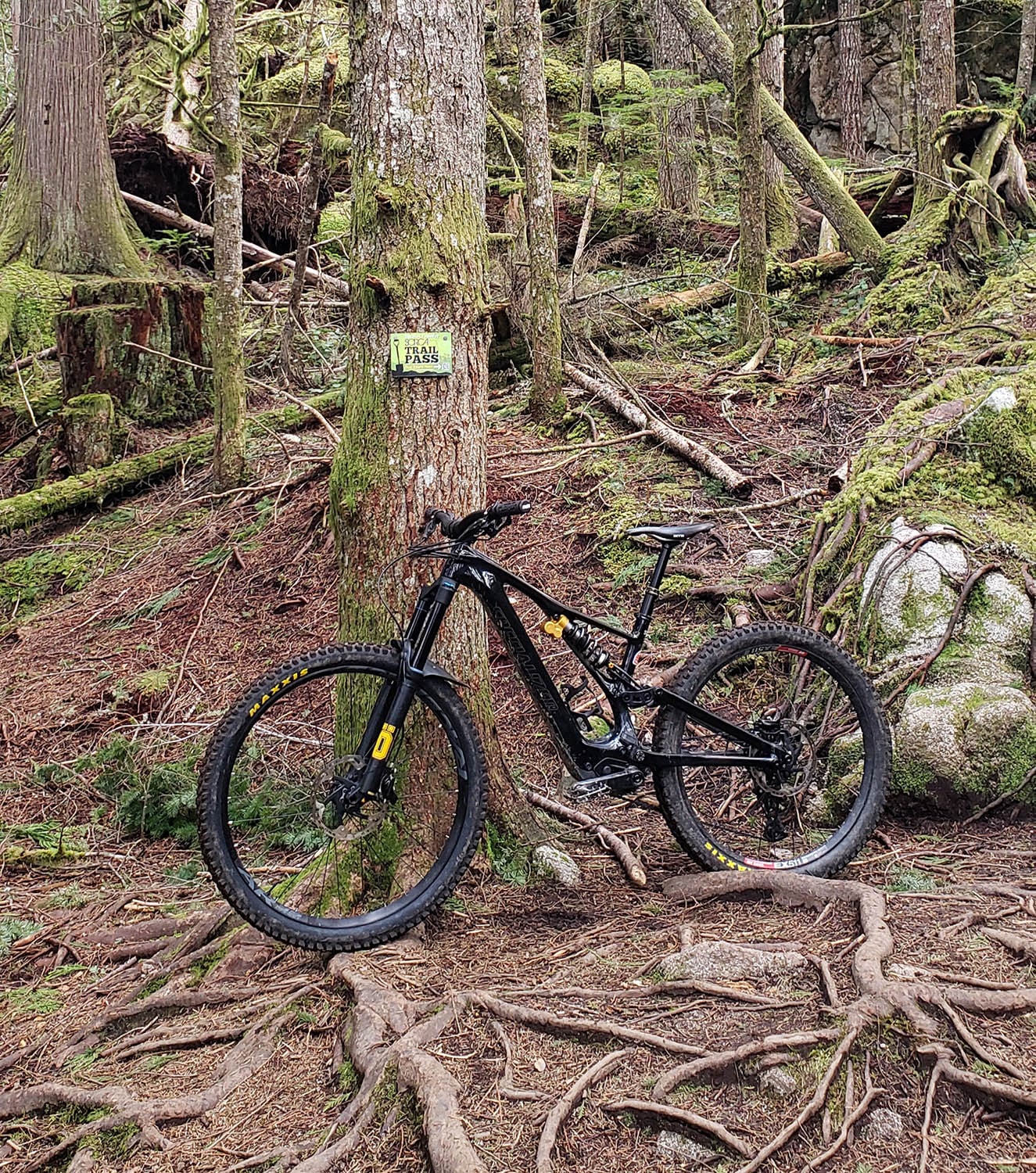

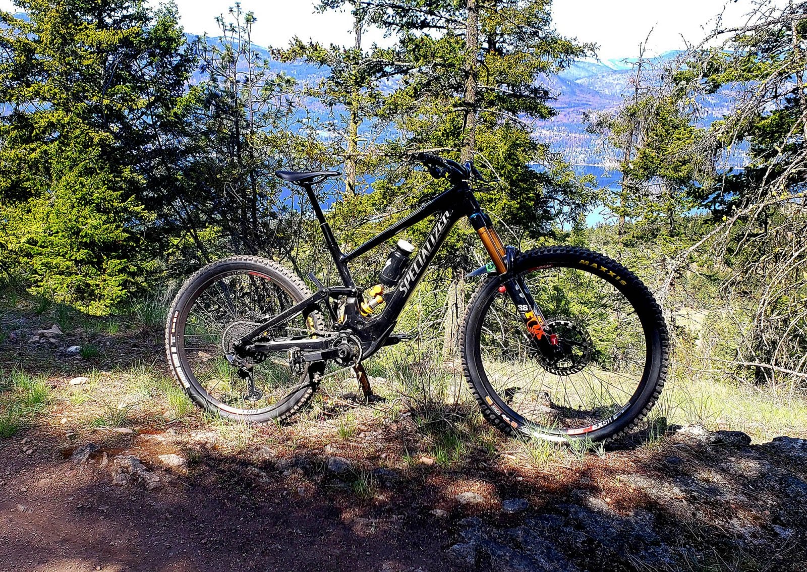

After putting my $1000 deposit down on an Expert (they only came in white - yuck!) in September, I was told by my LBS last week that "Specialized is no longer giving shipping dates due to various reasons beyond their control" and if I could find a bike some where else, I could get my deposit back. I am happy to say that one showed up (and in black too!) at a bike store only 6 hours away, so Road Trip!
I had already planned on changing the usual parts as the stock parts are crap or over priced so missing out on a white Expert (saving over $2000) and finding this black Comp was absolutely great! The only sad part so far is that it weighs more than my Levo SL which makes it move difficult to load it onto the back the truck.
After looking at the pics side by side i gotta say the Ohlins Levo actually looks better imo (never thought I'd say that!). I think the more subtle frame decals along with the Ohlins fork and black spring just set it off real nice. Obviously the KSL is a better bike (in my eyes)...a set of Ohlins 38 forks would look good ;)
I would have to agree with you but its a work in progress. I am just happy its black! I also have access to a vinyl cutter so its only a matter of time before I change the decals. The biggest issue is the obnoxious SPECIALIZED on the downtube. Maybe its just a Canadian thing but around here when people pass one another on a climbing trail/FSR (if they acknowledge you at all), they always look at what bike you are riding first. I think I will make new Ohlins decals for the fork and put KNOLLY on the downtube so I can feel at peace again :sneaky:
