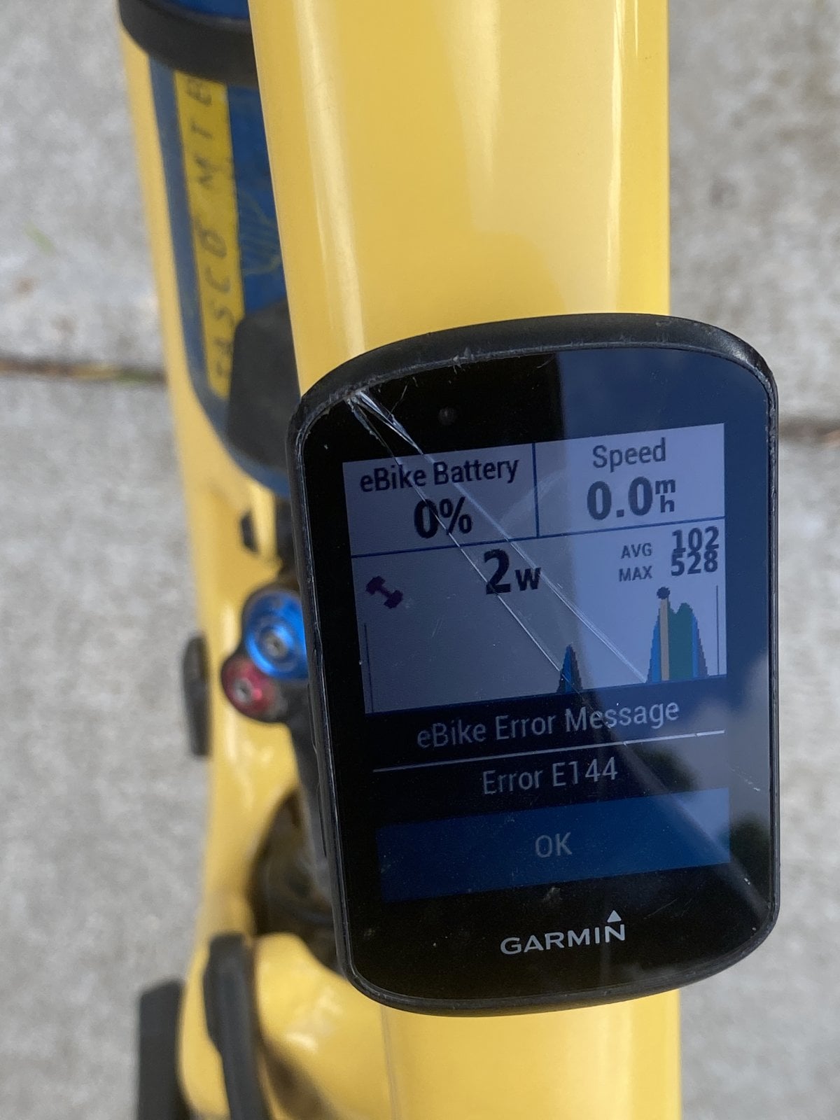

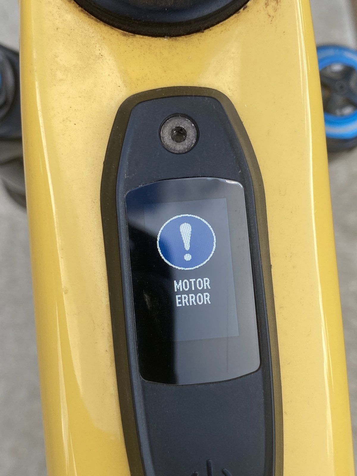

Well this is a first… happened at end of ride. Restarting bike doesn’t clear it. Motor works in walk mode but when I pedal it cuts out.
E144 error. . Battery is not at 0%
Anyone know what this is? A quick search didn’t show me anything @Specialized Rider Care

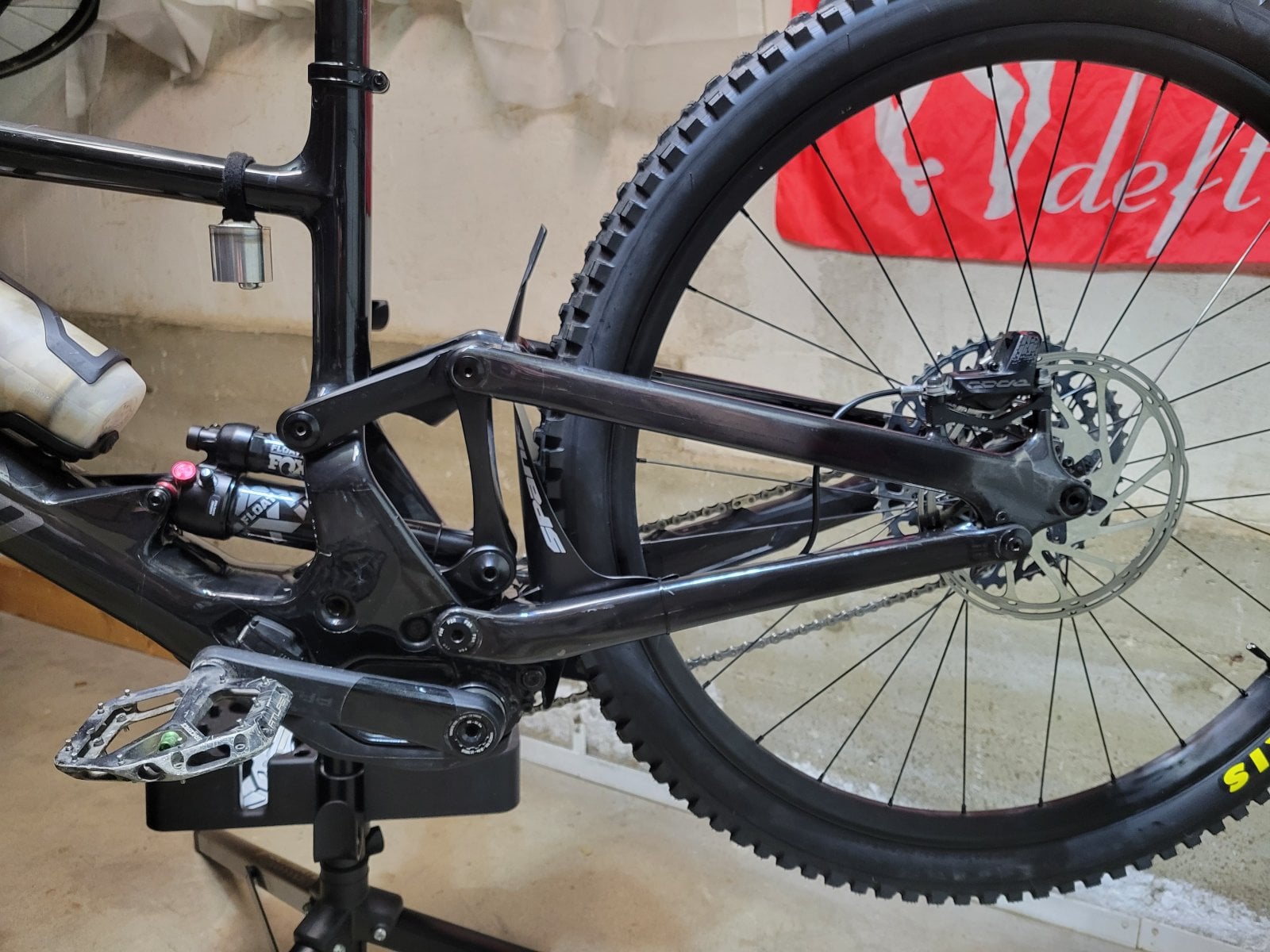

I think it's just there to protect the rear shock.

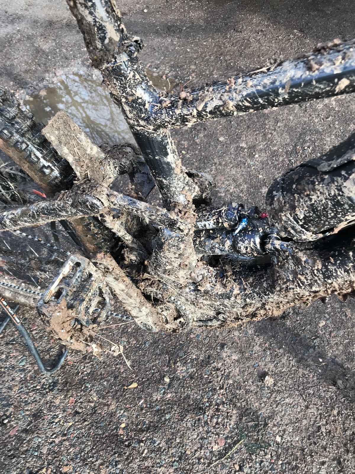

Actually the linkage to the rear shock does that, however it has a gaping hole in it due to how it moves. Still could cover it better. The rear mudguard is much too high to help for the lower shock area. Just the tiniest mud gets tossed into this area terribly so. At least its not as bad as the Levo SL dropping rocks into the rear chainstay.
View attachment 83366View attachment 83364
Follow up - my magnet came loose ( not stock wheels with center lock rotors means it’s a bit of a hack to make work). Should have been first thing I checked. Crisis averted 😅

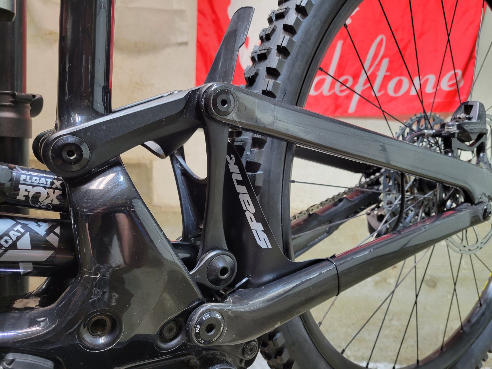

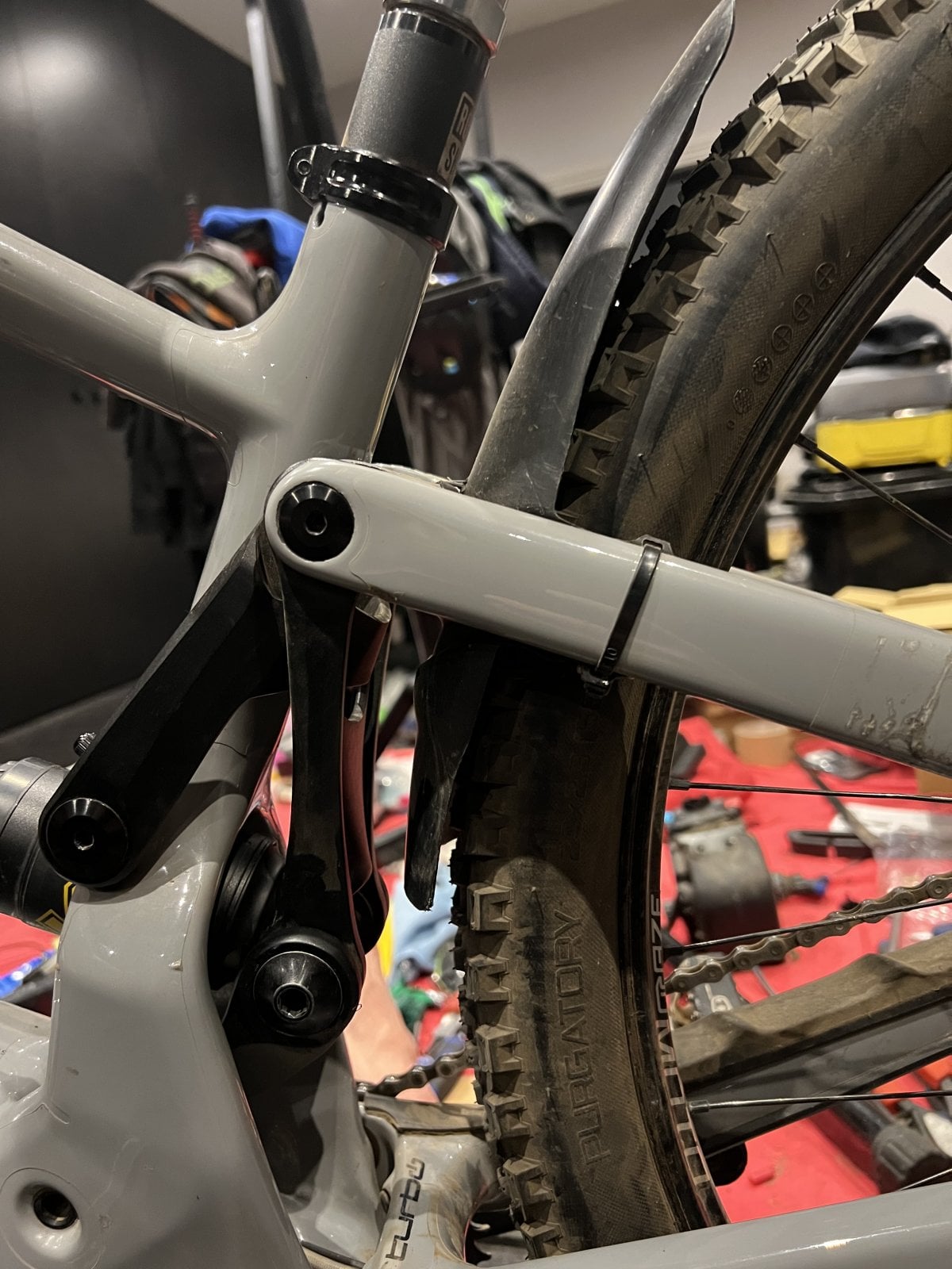

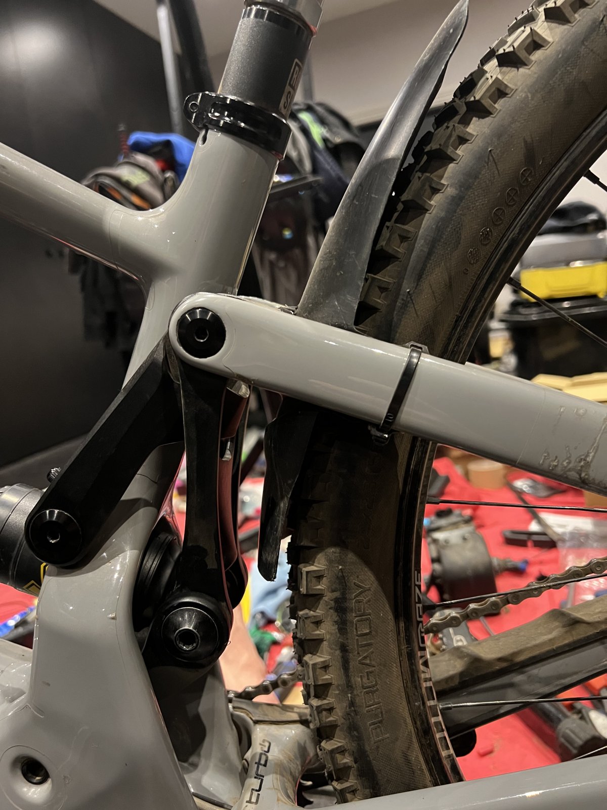

Getting tired of the rear lower pivot shelf getting insanely dirty from the lightest of rides. Took a front shorty mudguard and zip tied it in. I did have to make clearance for the chain in 1st gear. As suspension compresses, the gap increases between the stock mudguard, this addition and the shock linkage. Have plans to get some kydex and form it for one continuous piece that bolts to the stock guard.
From a maintenance perspective.....screw this linkage. My Hightower V2 was stupid simple to clean and take apart.
Love it, was gonna do the very same, but used my last flexy mudguard on other bike :- ). Looks pretty good and rather invisible.

Still gets some mud in the shock tunnel but not too bad. Shocks mostly clean. Waiting on Sicomtb to bring something out.

Wish we had enough moisture in CA right now to make something like this necessary
^Glad I live in CA. I hate to even cross a sole deep puddle...but I crossed 2 shallow creeks in a 2 week span and LOATHED the cleanup.
If only DuPont made something that dirt did not stick to.....

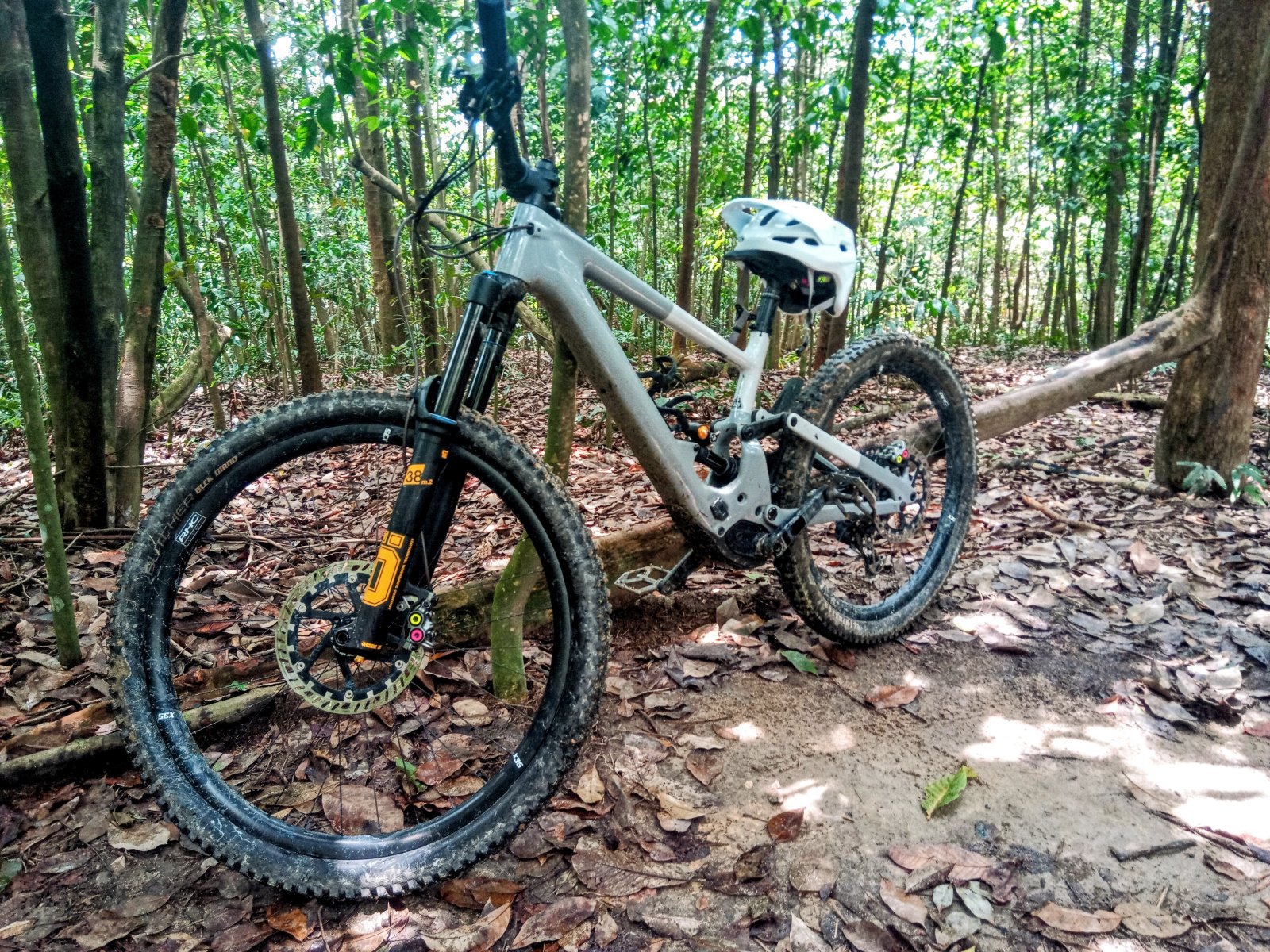

Hi All, just saying hi - finally got my KSL Expert here in Malaysia! and moved over to ohlins F&R. First time on ohlins and looking for some recommendations on ratio's for the 2 fork chambers - stock (1:2 ratio) seems a bit harsh! Otherwise really enjoying this bike. Moved from a FF Levo Gen 2. Have setup with mullet carbon Wheelset, axs and MT7's!
