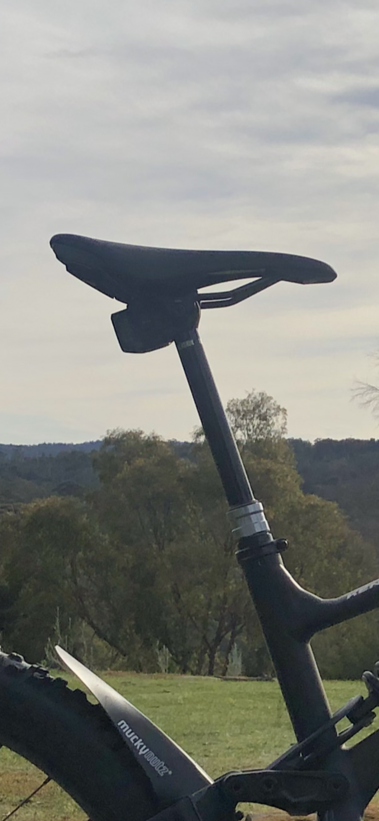

I have the 170mm dropper, it misses out by around 5mm from going all the way in. I’m 5”10 and the height is fine.
Nice, I assume it's an S4 as well? Is the extra 10mm drop very noticeable?
Yes S4, I had it on my Medium 2019 Kenevo which was a massive difference over the Wu post. With the new 2020 post I only rode it in the car park before I changed it so can’t really remember how it felt as I was so excited!
The Axs seat on the other hand is bloody unreal. Way way better seat that anything with a wire.

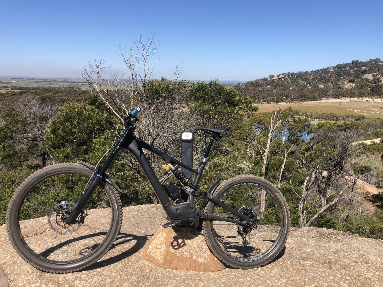

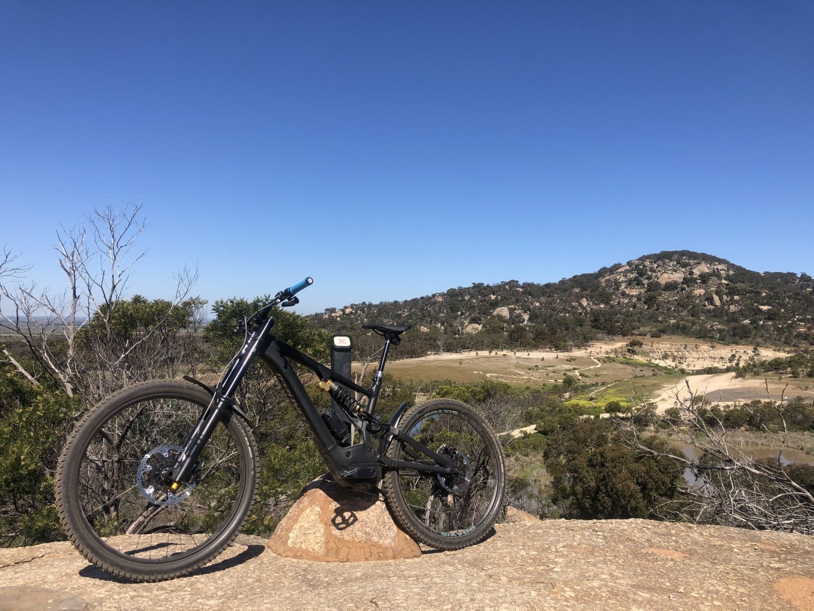

So I’ve had a few rides on the new bike so I thought I’d share my thoughts.
First and foremost I love it! Like a lot!
There are many reasons why but the sizing was the main advantage
I am 5”10 and my old Kenevo was a medium which I found a tad small. The new one is an S4 and it’s just spot on.

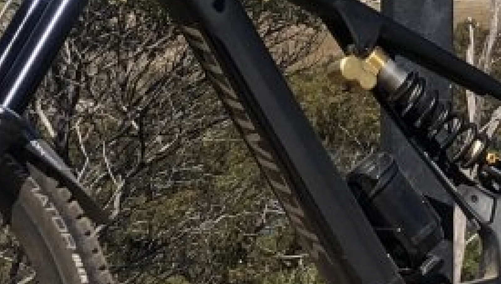

I have upgraded mine with a longer front and back shock so it’s essentially a mini downhill bike. Exactly what I’ve always wanted since I first heard about ebikes.
I now feel complete.

Hey Christian,. Nice looking bike!! What size shock were you able to fit? Is the stock boxxer fork a dogged down 200 mm or is it fixed at 180mm travel?

Thanks mate! Not sure on the BoXXer fork. I’ve got the 200 Ohlins front and the Ohlins rear is a 240/76 shock with a reduced shaft down to 70mm which gives me 201mm travel and then I run two custom offset bushes to get the 230mm eye to eye.

Like many on here, I've been agonising over whether to go for a 2020 Levo Comp and beef it up a bit, or the 2020 Kenevo comp.
Anyway, listened to Rob’s recent podcast on his Kenevo Expert and it was the final push I needed to pull the pin on a Kenevo Comp S5 along with a 700 batt. Thanks Rob ?
I'm around 6'1" and 14st without bike gear on. Managed to get a ride on an S4 and S5 (just on the road) and was surprised to find the S5 a noticeably better fit for me (had been planning on S4 based on reach numbers etc).
First proper ride yesterday. Everything stock - just set up tubeless and slapped some decent pedals on. Rode with the heavier 700 batt.
Rode some local off piste trails that are generally steep, slippery and tight with some faster and flatter loam tracks too. I’d just ridden the same trails in the last week on my ‘18 Meta Power and Orbea Rallon acoustic so it was a good opportunity to compare.
First impressions
  • Climbs well - you can feel the steepish seat tube angle compensating for the slack HA
  • Butcher Black Diamonds surprisingly good. Was going to swap out but don't really feel the need now (for the moment anyway)
  • Brose motor noticeable quieter (in this installation at least) than the Shimano on my Meta Power and the Bosch on my previous Haibike Nduro
  • Standover on the S5 is great BUT as others have mentioned, could do with a longer travel dropper than the 160 Manic
  • On steep very tight technical trails, the bike felt reasonably agile. I was really worried the (very) long wheelbase and reach of the S5 would make it difficult to get round tight steep switchbacks but it didn't seem disadvantaged against my size Large Meta Power and XL Rallon.
  • Haven’t dialled in the suspension yet, but on drop offs and smaller jumps it felt very assured and confidence inspiring. The standard 600lb spring on the S5 seemed just about spot on for my weight. Need to ride it a lot more and on different types of trails to give any meaningful comment, but so far, I’m happy with the Marz /Fox coil and fork combo. Will get it up to BPW soon which should give a better indicator.
  • Slightly harder to pop the front up than my Meta but not really an issue - just needs a bit more man handling.
  • As an aside, love the 700 battery – a big reason for wanting to change bikes. Had a monster ride yesterday (almost all in trail) and still had around 100wh left. Not fussed on the awkward battery retaining bolt (same as on the Levo). I tend to charge my battery off the bike most of the time (in work etc) and the bolt just seems a bit of a faff when taking the battery on and off. Small grumble really but just feel this could have been better designed from the off.
Anyway, early days and all that (… and I’ve still got Brose motor anxiety), but so far it’s a thumbs up!
