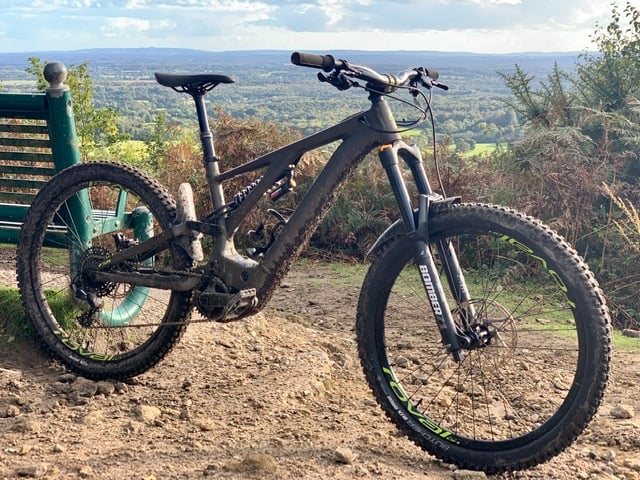

Picked up my Comp from ACE Bicycles Burpham yesterday after the guys set it up for me !
Took it over pitch hill for a 3 hr 1st date , we hit it off instantly ☺️ I’m 5’10ish , 12.5st and Toby recommended a S3 which I thought would be too small but after adding a renthal stem and bars , moved the seat back 10mm it was perfect ! Switched between all the modes but did most decents in eco which was enough . Jumping was no different to a non ebike which was very pleasing , on the steep rough bits it did sink into trace abit but turned the hi/low combined compression to half and it was slot better. Will have a play with some tokens when they arrive . The Marzocchi shock was pretty good too , didn’t do anything it shouldn’t and I just forgot about it . This thing is a trail rocket that handles anything I could do , felt very nimble and the more I rode the better it felt . After 3ish hrs the battery still had 3bars left ! Very happy , no need for the big bro version !

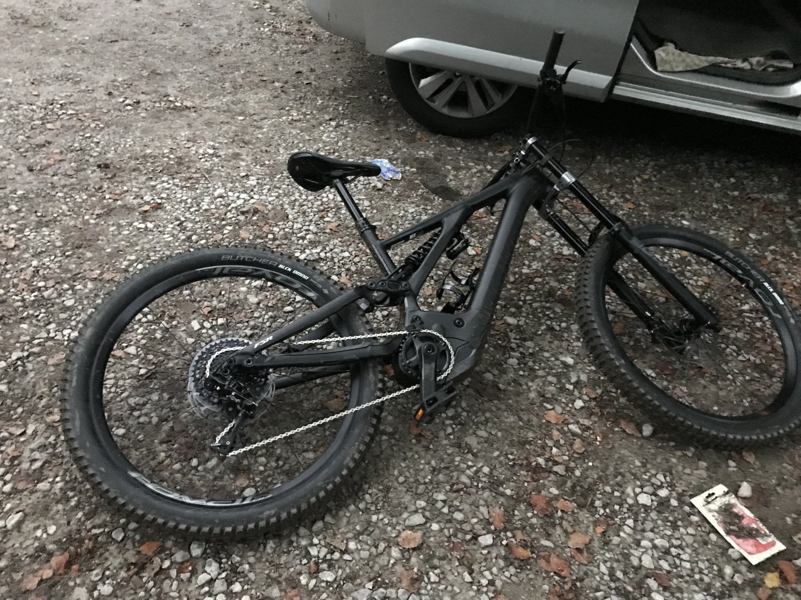

The Marzocchi shock on my comp exploded yesterday ! The chamber dial seized , was knocking and lost oil . A bit disappointing on 2nd proper ride but took it in to Ace Bicycles and they quickly swapped it ! Hope it’s a one off ! Edited lol
The Marzocchi shock on my comp exploded yesterday ! The chamber dial seized , was knocking and lost oil . A bit disappointing on 2nd proper ride but took it in to Ace Bycyles and they quickly swapped it ! Hope it’s a one off !

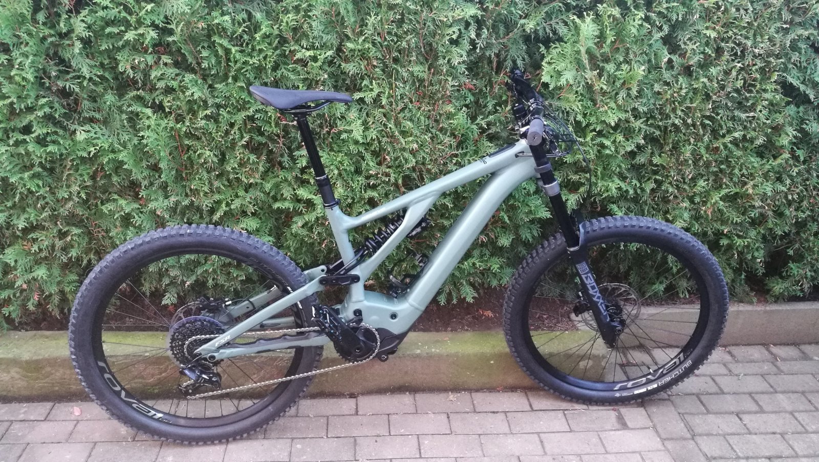

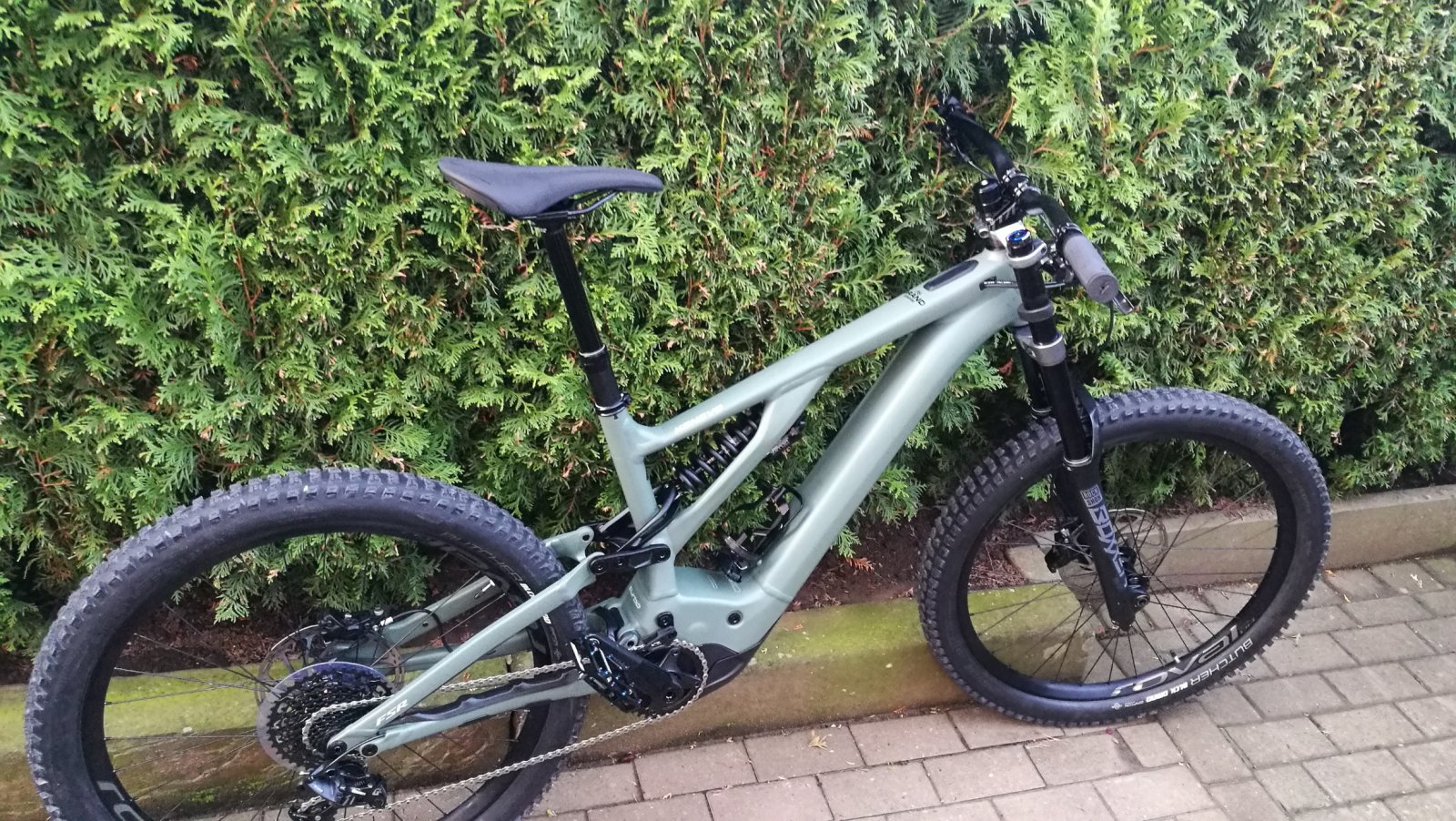

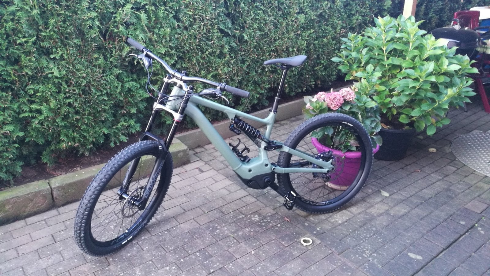

Finally picked up my huntsman-green S4 Kenevo today. Unfortunately it was a bit too late, so i only had a short ride.
First impression: What a little monster...we will surely become BB´s :love:

The new shock is working and I’ve added a fork token to the one in there , set the sag to 20% . It feels much better , sits higher , doesn’t dive down and hasn’t bottom yet . Feels stiffer but comfy enough over bumps.
Went to it to BPW yesterday, no rain but very damp . After slowing the rebound a few clicks on the shock it was sweet , this bike jumps fine ( at first I wanted more powered speed but once you can land in the sweet spot and pump it was fast enough , for now) and absolutely flies around flowy trails . Was as good on the rough stuff . Was surprised how good the butcher diamonds were ! We managed 4 runs on the 500 wt battery then stopped for an hr lunch , we took a geny to charge 3 bikes which wasn’t powerful enough but all got just over half battery life . We used the uplift in the afternoon and did another 4 downs ! It was quicker to ride up than queue and get the bus ! Next time I’d climb on a lower power then an hr lunch charge would be enough for the rest or the day . We took my 2020 comp a 2019 expert and a borrowed Olly Wilkins focus , we all had a blast !
