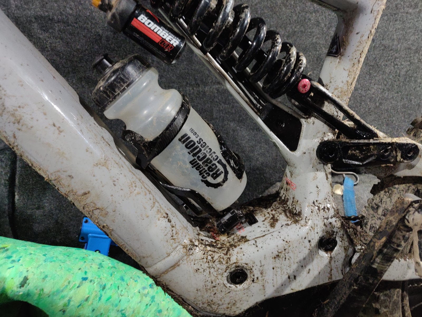

Boom, 2nd time after it was repaired few weeks ago :(

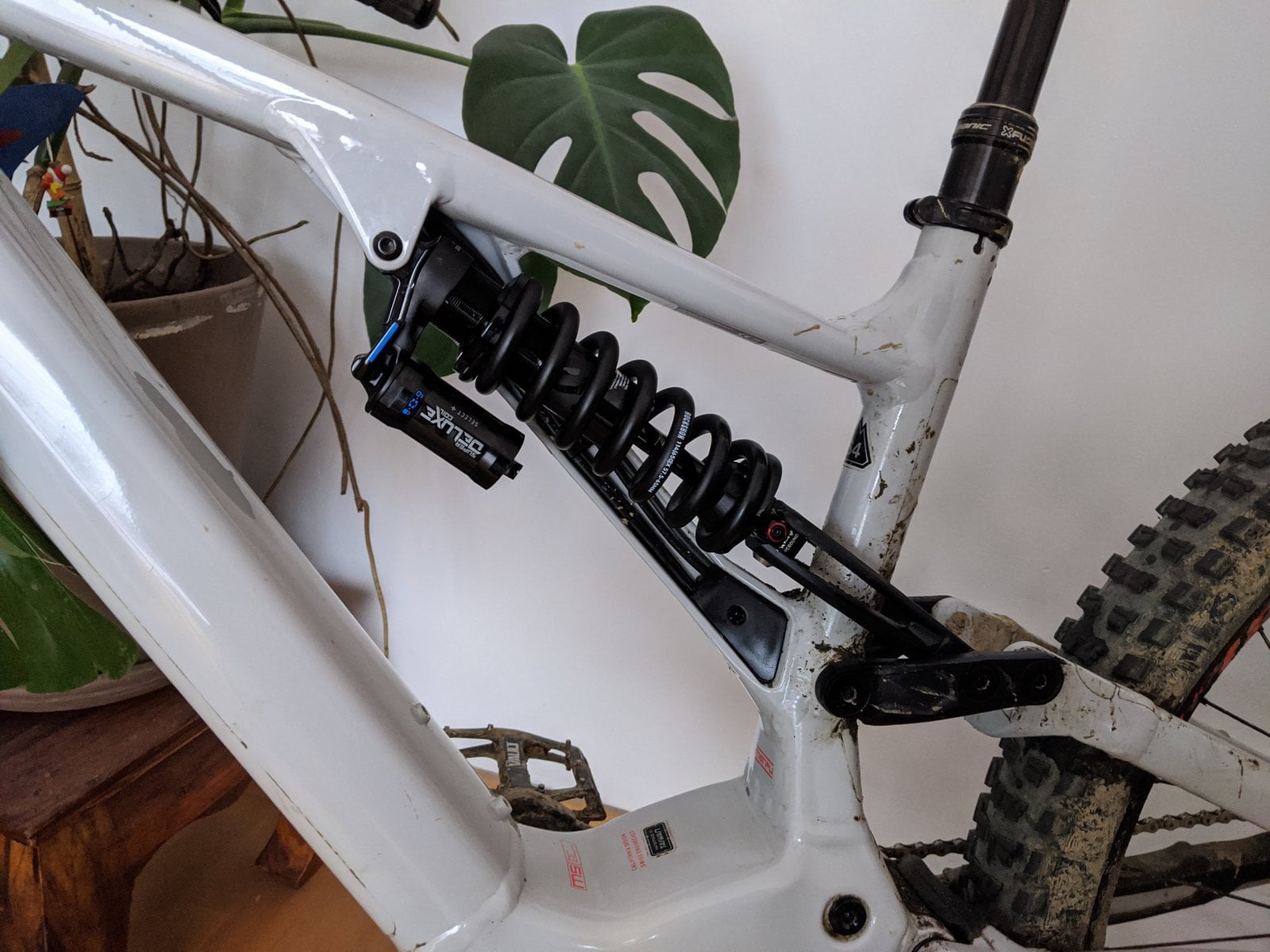

Could anyone tell which bushings exactly are needed to install the RS super delux damper on the 2020 Kenevo?

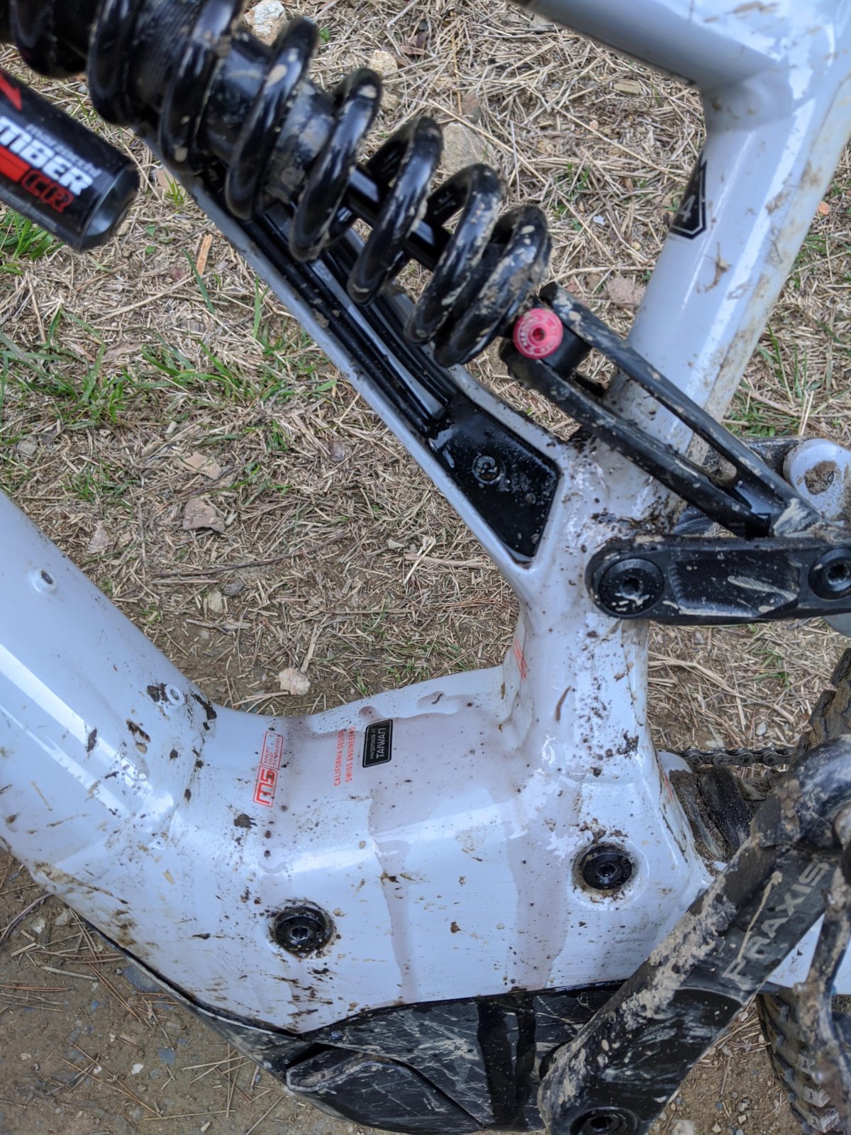

My shock failed today after one blue run! Only rode the bike twice and this happens at the start of the 3rd ride! Not happy!

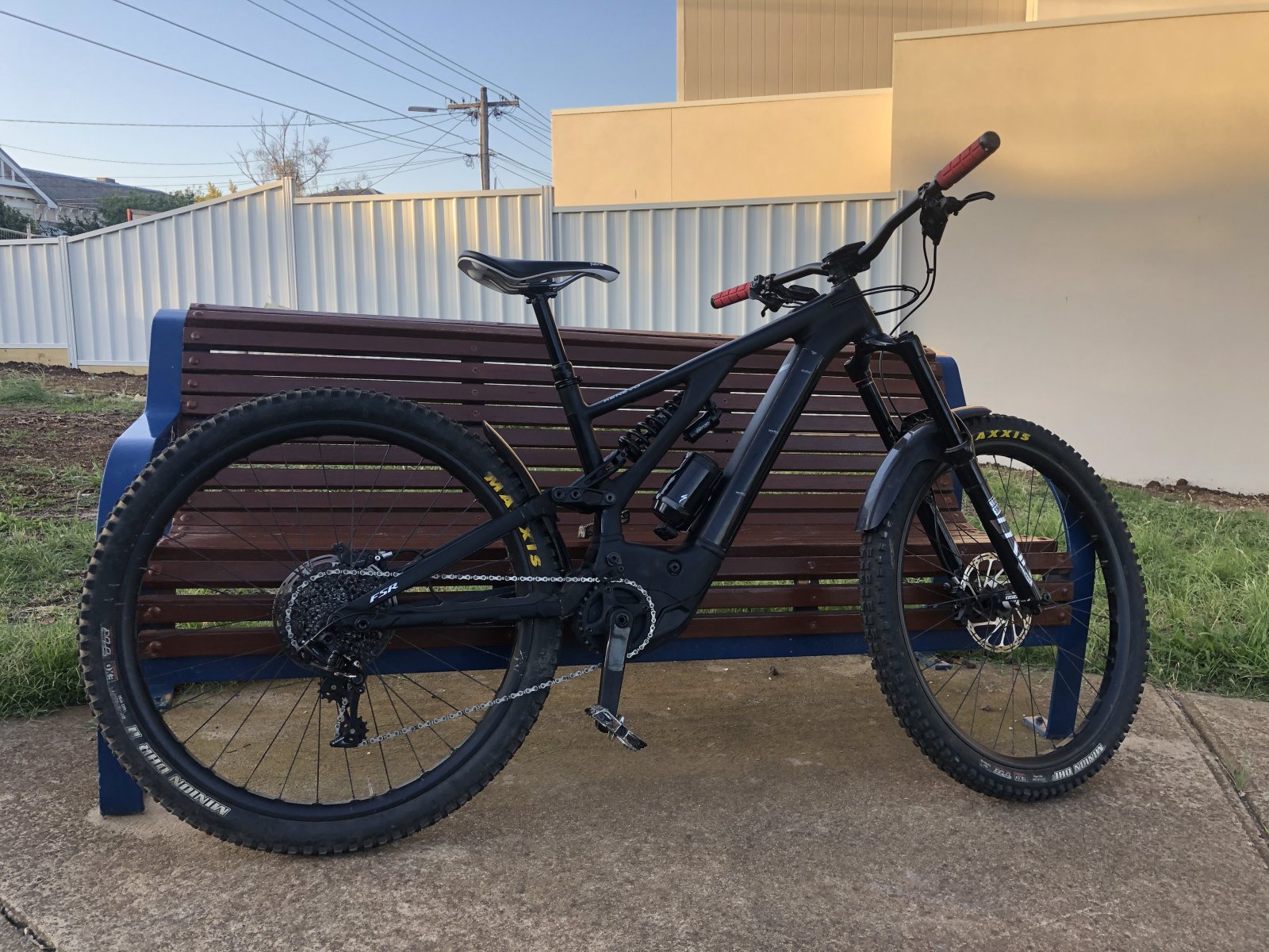

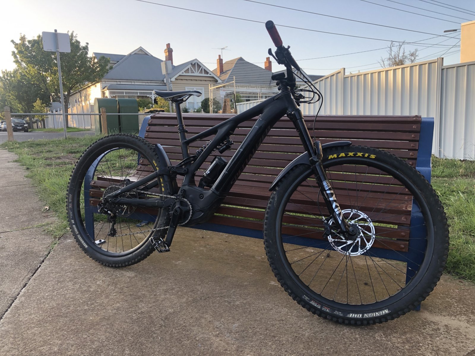

My replaced Kenevo back together with all the good bits. This time I put the Rohloff back on!

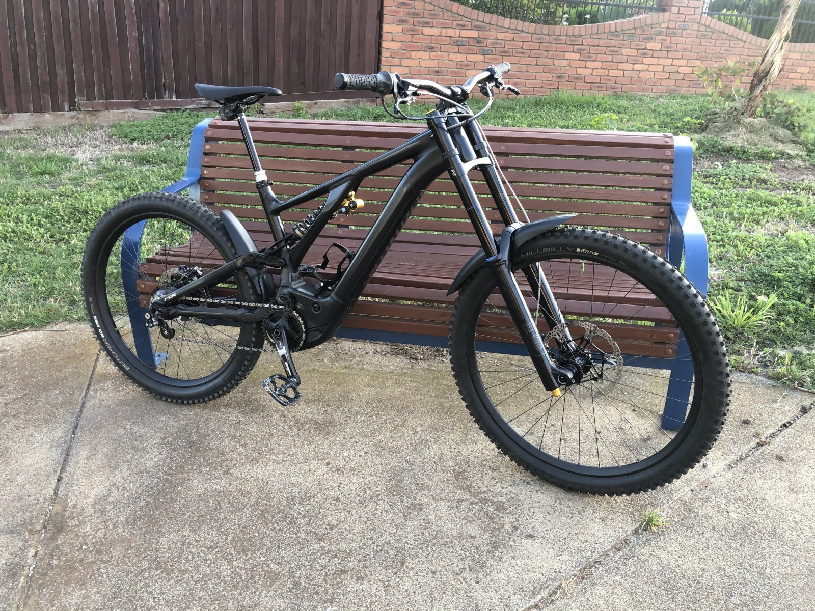

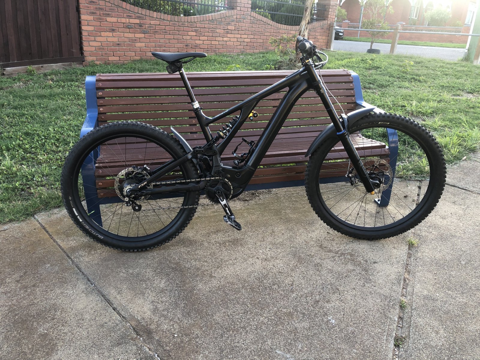

Brothers Kenevo with 29/2.5 wheels back and front. Had to use my single crown Lyrik for now to see how it rides first. So far he loves it on our urban creek test ride.

I bought these and are just with the mech to mount it. And its clearly not 6x20 but 8x20 :(
Really???? Dude, I am sorry!!!! That is what worked on mine. Maybe the packaging I got was mislabeled or something. Again, apologies.
Don´t worry mate. The mech took a good sip out of his bottle, fetched the 8mm drill and made it work:
Given the performance of the comp CR shocks I guess I wasn´t the last one doing this exercise. So maybe it helps someone to see the right bushing size (8x20 upper eye, nothing in the lower.)
