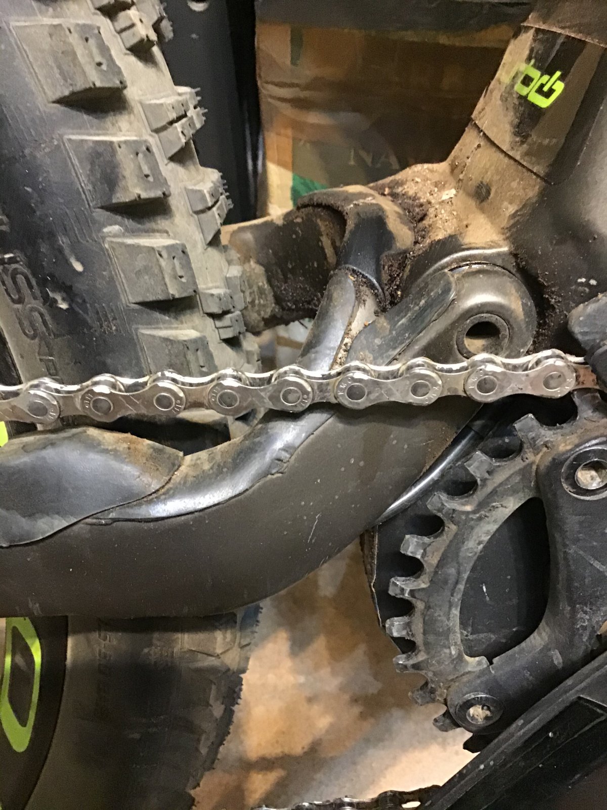

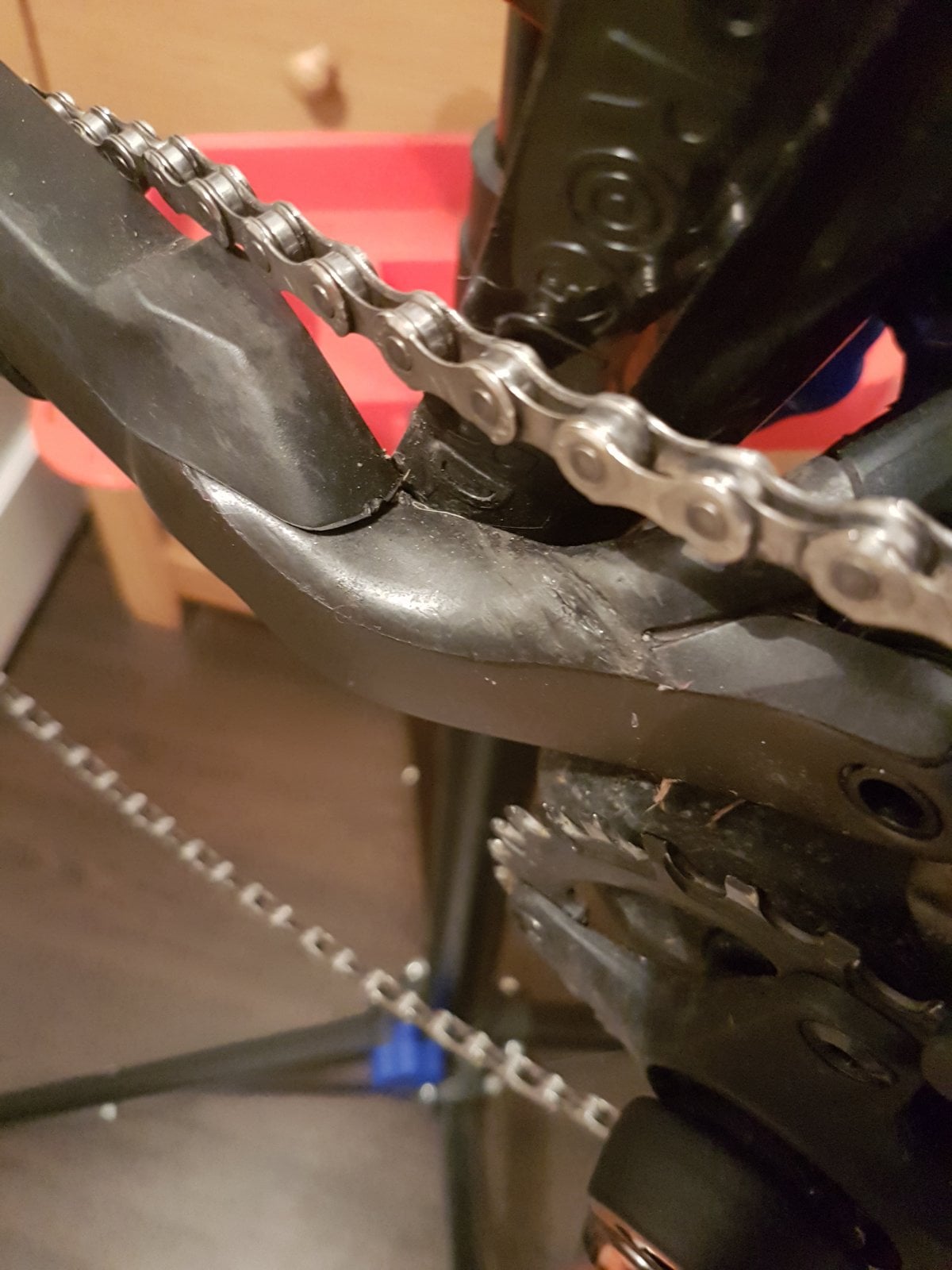

Any idea how to stop this kind of chain rob?
1. It looks like you lost the rubber guard (See attached photo of my bike). You could put some 3M sealing tape or a piece of inner tube or any plastic high impact frame protection.
2.- On the other hand your chain looks slack. Check the derrailleur tension and chain length.
The rubber guard is still attached if you look closely. Rear wheel was off that's why the chain looks slack. But you might be right, I'll see if the derailer need tension
