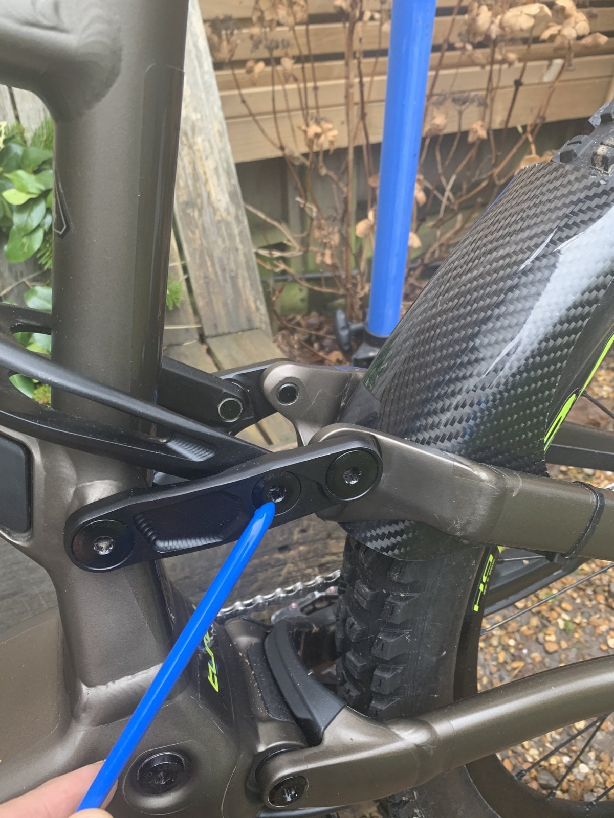

Any one know what the torque setting is on this? both sides are loose (other side was sticking out)
Cheers

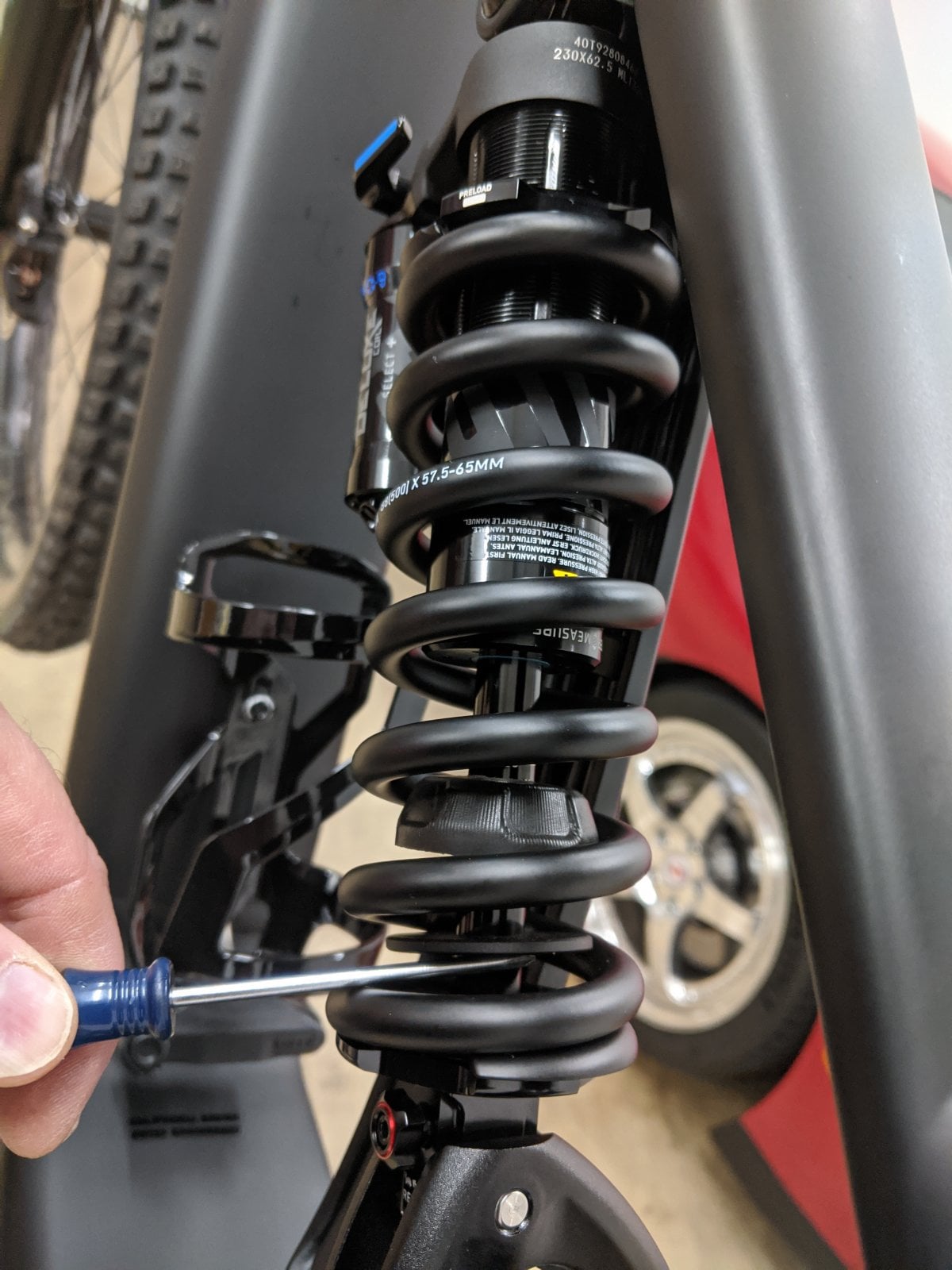

When swapping the coil on my X-spurt, I noticed there's a plastic washer underneath the rubber bump stop. See photo.
This washer does not appear in the super deluxe coil service manual as near as I can tell. So my question is, is this really a 65 mm shock simply shimmed down to 62.5 and can I remove the shim to increase the travel? If so, I am thinking remove the shim, flip the chip, and change the boxxer to 190 mm for a little more travel and a little more ground clearance without totally changing the geometry. What do you guys think?

How are you planning on removing the washer? If you want to get it off without damaging it you need to drain the nitrogen from the shock and remove the shock mounting eye. The nitrogen will need to be replaced afterwards which isn’t a home mechanic job.
If you cut it off and any of the shock linkages hit the frame because of the extra travel what are you going to do?
I was planning to cut it off.. Hoping somebody has tried a 230 x 65 and would report in..

Thanks Christian. I am somewhat known for having bad ideas..??
Me too, I am never happy with anything I buy. It has to be modified to my liking. Im running a 236/70mm Ohlins with an offset bush on my 2020 and have no problems at all.
Haha!!! Nice... Think you are close to the 230mm eye to eye?
232 exactly as the bush is 4mm offset. I had another bush up top but it was a solid fit and would keep loosening the shock bolt so had to take it out. The bike rides a little higher than it should but no biggie. I am going to play with a Levo bracket to see if I can drop the bottom bracket down to stock height or lower
Thanks Christian for the info. If you are 232 w/ a 70mm stroke and no clearance issues, I should have no problem @ 65 mm
Plenty of space there, I think on full squash it had around 20mm space. You’ll shit it in with 65mm.
For the record I’ve bottomed out a few times on massive drops and no marks on the frame.
this is good news

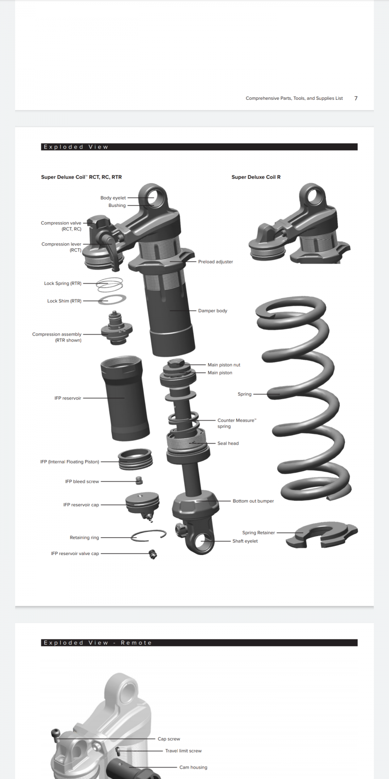

When swapping the coil on my X-spurt, I noticed there's a plastic washer underneath the rubber bump stop. See photo.View attachment 23904 This washer does not appear in the super deluxe coil service manual as near as I can tell. So my question is, is this really a 65 mm shock simply shimmed down to 62.5 and can I remove the shim to increase the travel? If so, I am thinking remove the shim, flip the chip, and change the boxxer to 190 mm for a little more travel and a little more ground clearance without totally changing the geometry. What do you guys think?
That washer is supposed to be there - I recently bought a brand new super deluxe coil for another bike and it has the washer, its purpose is to stop the rubber bottom out bumper stop deforming on the spring retainer , specifically the slot where you slide the retainer on. At least that's what I was told!
My 55mm stroke super deluxe coil does not have the gravel reducing washer and the bump stop is directly on the spring retainer so it's unlikely the washer has any other function other than reducing travel.
interesting - given the "give" in the bump stop it doesn't seem to me to be doing that much of a job of reducing the travel
Yes, interesting. What was the stroke on your new shock? The exploded view does not show it, but if you look really closely at the bottom of the bump stop it looks like there's something
That's what I am thinking..
