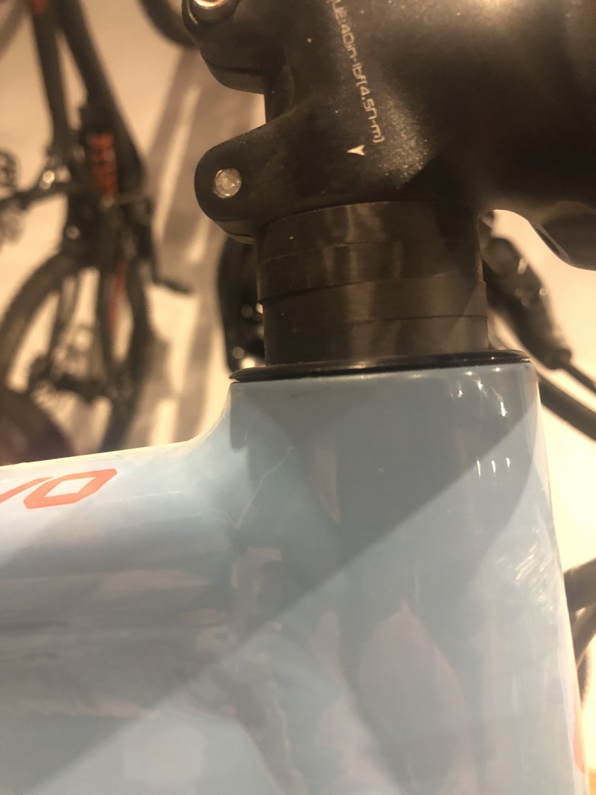

Mine has it, and so does my Stumpjumper.
I’ve seen other bikes with it too.
As long as there’s no play in the headset I’m sure it’s not a problem.

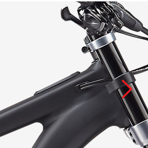

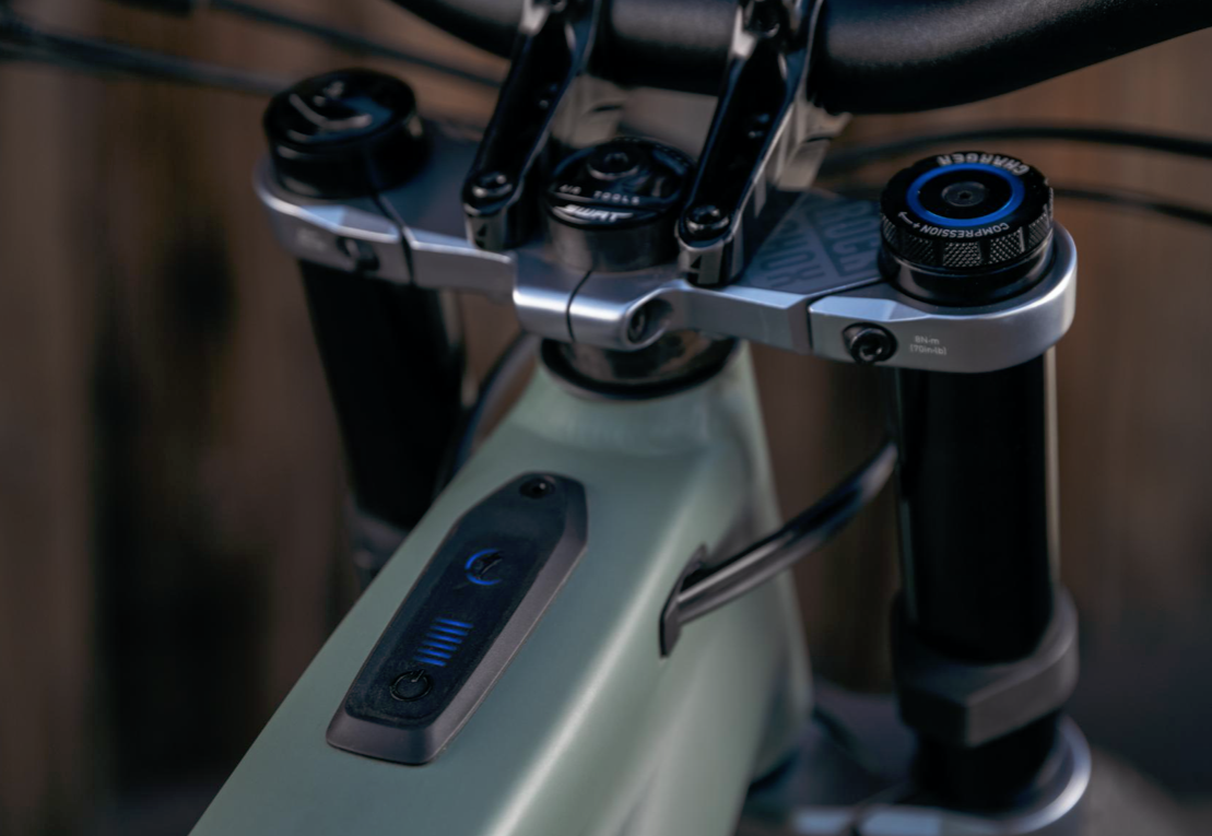

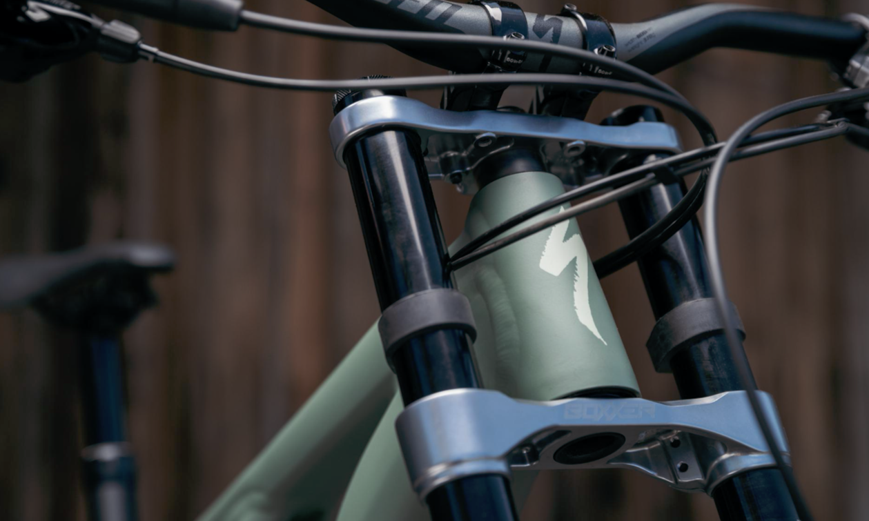

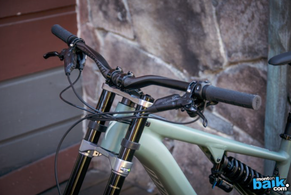

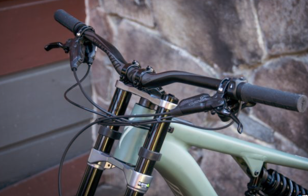

Here's a screenshot from the german Specialized Homepage. The gap is definitely visible.
Well I’m quite surprised by these responses. I’ve sent a quick email to Specialized. Interested to get to the bottom of this. Safe to say the gap is triggering a bit of OCD in me...
No way its meant to be like that, that's just not how you put a headset together, doesn't appear to be like that on the press bikes from the launch, to me it looks like the bikes been put together by someone who has never fitted a set of dual crown forks before

This is interesting to me too as I'm looking at getting the Kenevo Expert at the moment. But I've built many bikes over the years and I don't think you should ever have a gap between the cartridge bearing, compression ring and the top seal.
It will just let water and grime go straight into the headset and ruin the bearings I'd have thought.

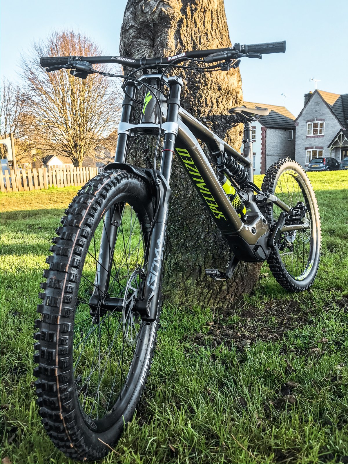

Mine has the same gap... Seems they all have it.
2019 Kenevo .3/.4mm gap
2020 Kenevo Ohlins 1mm gap
2020 Kenevo Boxxers 1mm gap

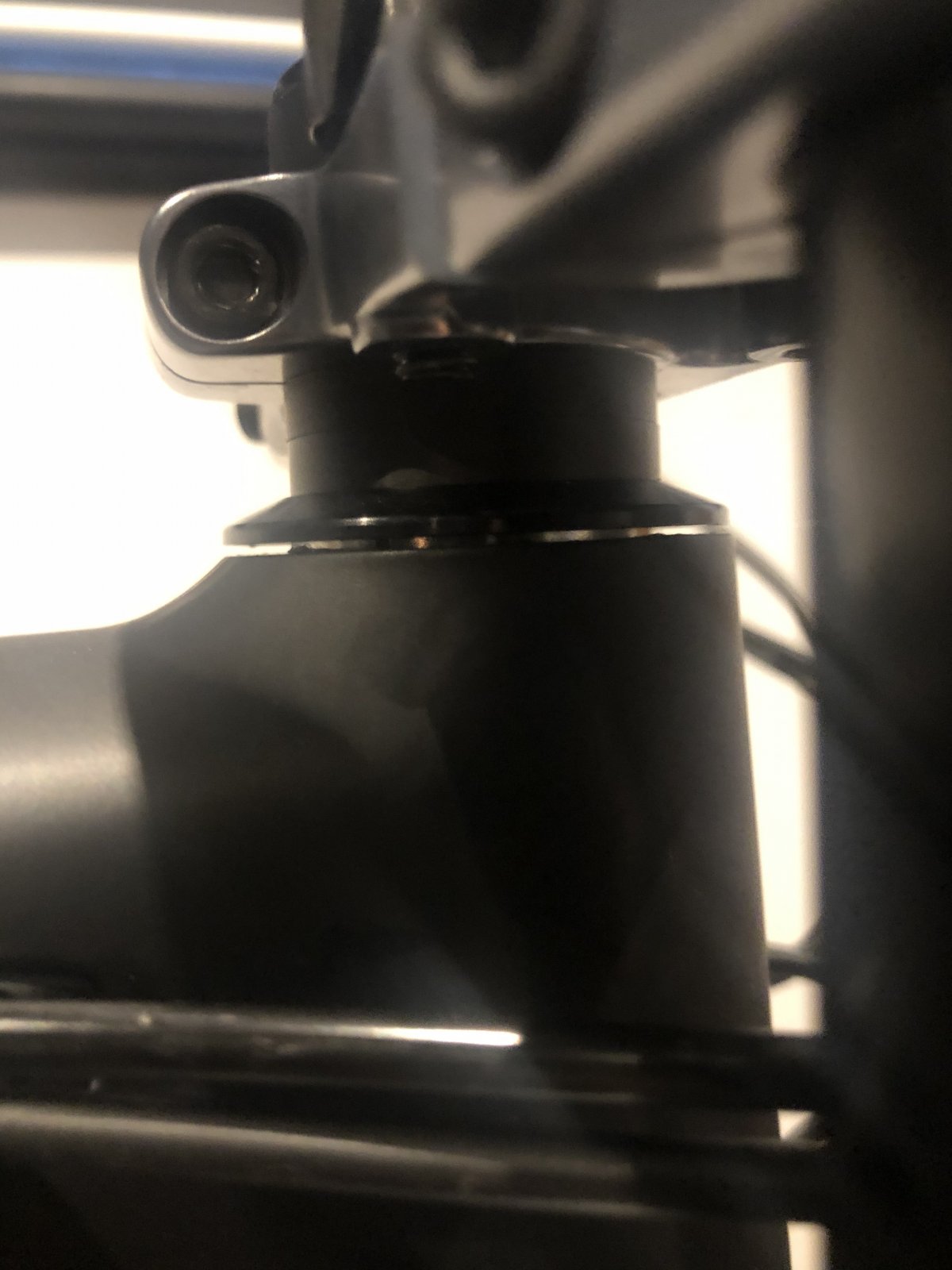

Can anyone comment on whether the below ~1mm gap in the headset is normal?
After querying it with the shop they said that ‘they’re all like that’ but they did let it out of the workshop with a steerer tube spacer missing and therefore some noticeable play in the headset, so I’m a bit reluctant to just take their word for it...
It doesn’t push down any further, as the compression ring is pronounced and stops this.
With my cane creek 40 headset on the analogue bike everything sits flush.
Mine had the gap. played with spacers and got rid of it. I am afraid it is just bad set up, but a really easy fix
I don’t think this is the case. Can’t imagine so many bike shops making the same mistake. I’ve also had mine in bits a couple of times and cannot see a solution. Nothing to do with the steerer tube spacers. It seems to be the compression ring.
