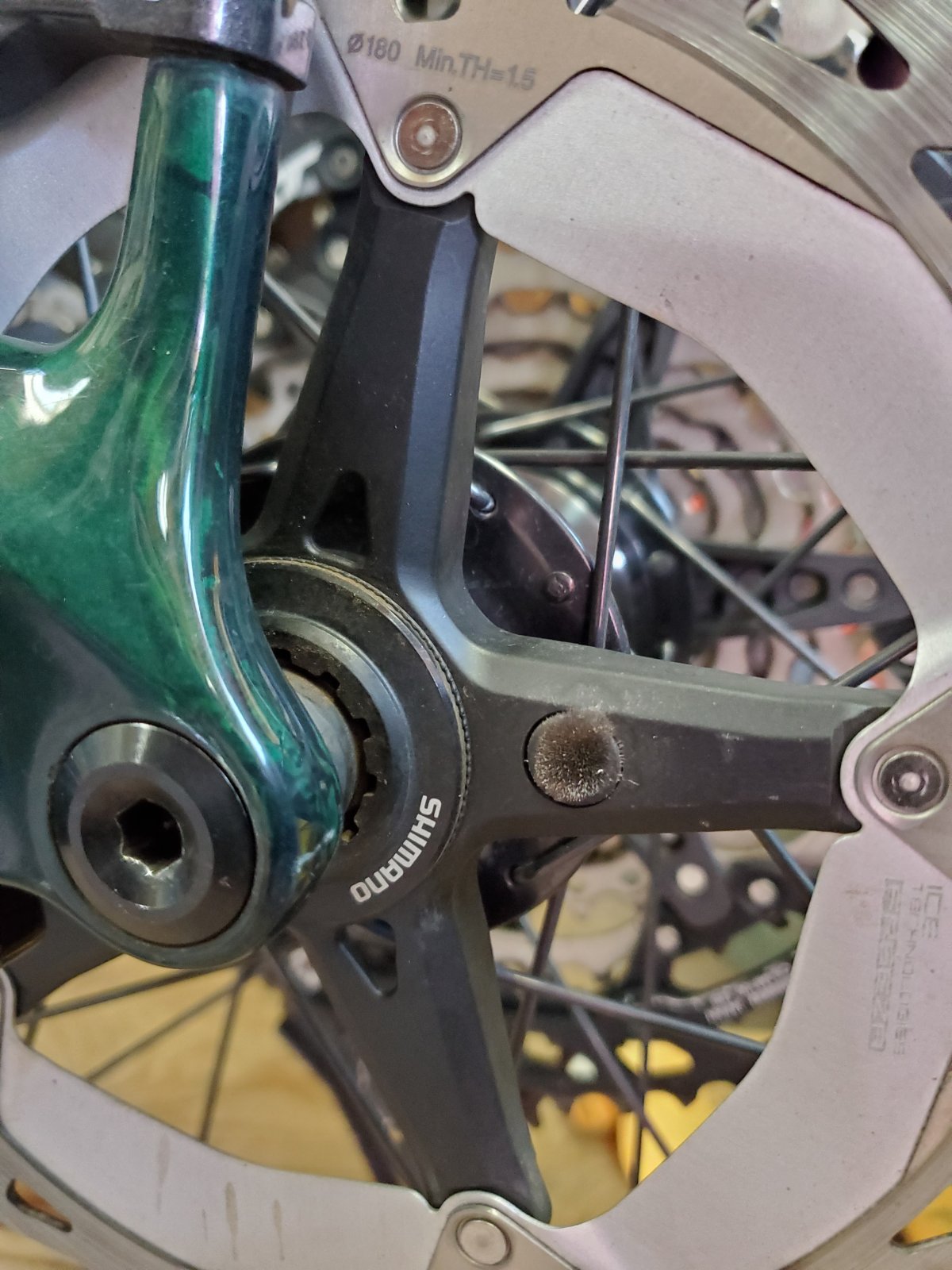

I feel for you Bro! Being an expert at swapping wheelsets over between bikes and forgetting to swap the speed sensing magnet over, I decided to make my own. Unfortunately, the stock magnet seems to require a pretty exact height and/or guass value as the neodeum magnet I put on did not work consistently and kept giving me an error code.
If you are handy, you might be able to get something like this to work with your original magnet.

Had same issue with ChrisKing hub center lock. I ended using the stock magnet glued to the rotor. I tried without glue and I didn’t loose it but just to be safe……
One other thing is you might have to put locktite on the center lock ring, it was constantly getting loose and it was driving me nuts until I figure out that was the ring.

I forgot. I did try the Shimano lock ring with magnet but didn’t work. The magnet needs to be close to the sensor. You can add a thin magnet on top and it will work.

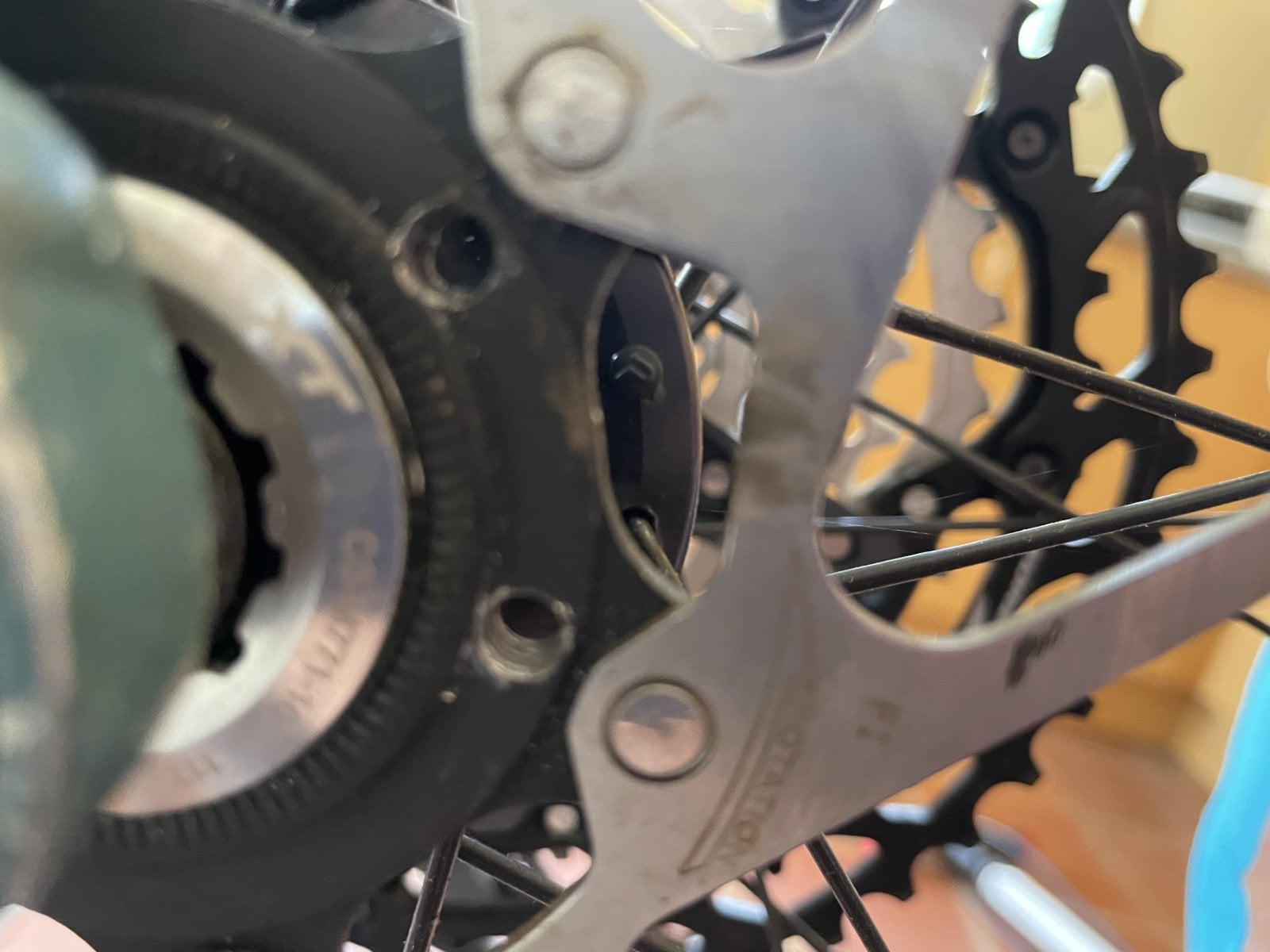

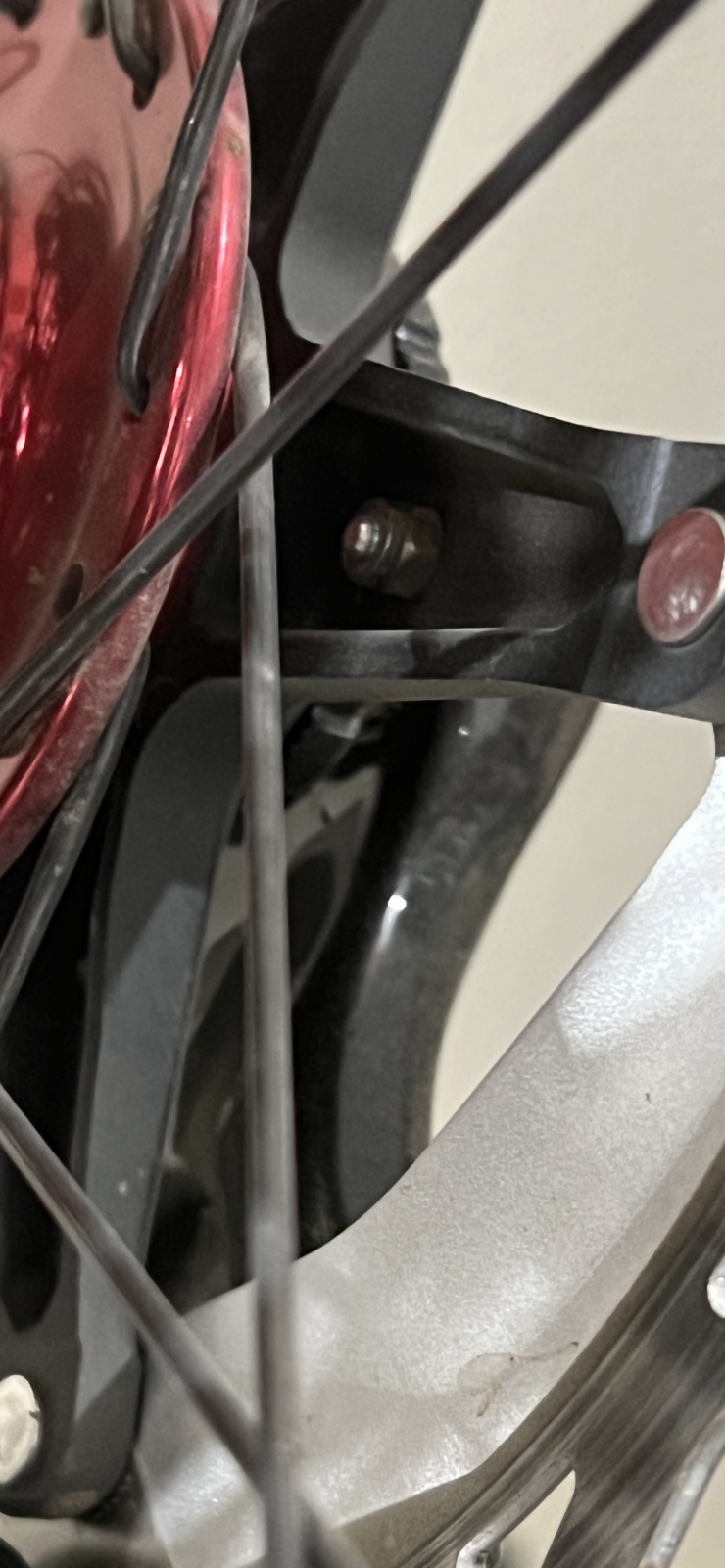

I too put Chris King wheels on my Levo SL and ran into the same problem. Specialized does make a center lock ring with a magnet, but wont fit on the CK hub. I had bought Shimano center lock rotors. In the cut out of the rotor spider I put a round magnet from an old cateye computer magnet, the kind that screw onto a spoke....I also put a nylon locking nut on the backside. Works flawless!

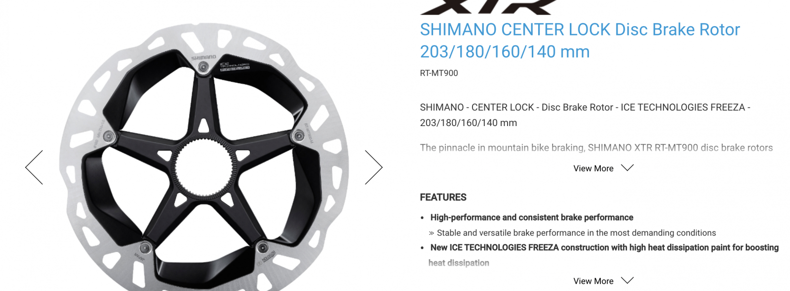

Did you use the XTR rotor? I think the XT may have the same cutouts but not sure. I assume you are referring to one of the small holes above the lock ring area. is that right?

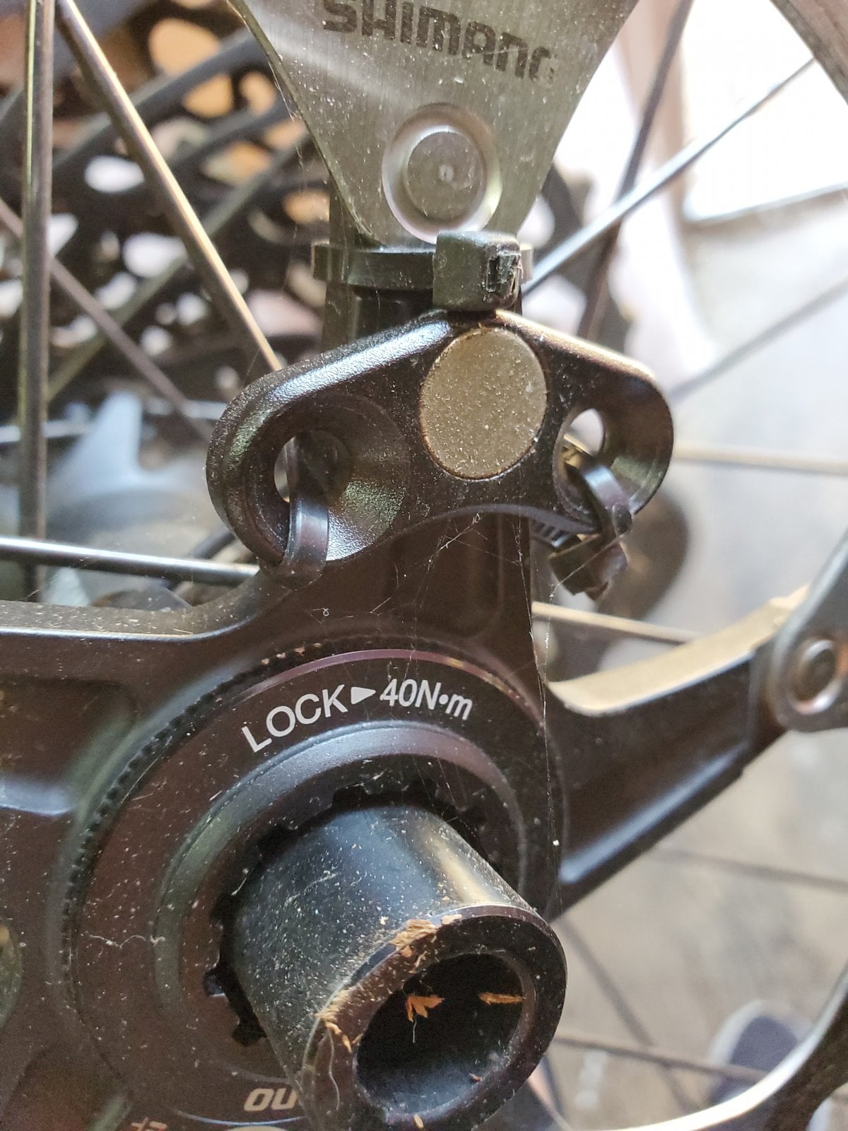

I did the same. Built a new wheelset, jumped on the bike,...WTF! Oh yeah the efing magnet. Soooo,...
It works! But until I got the mag rotor I did this,
Yeah I know, I know scarey. I checked it about 20 times every ride. I used it probably half dozen times no problem. I got the mag rotor no problem. I've tried to get another for my spare wheels with no luck. Like you said not readily available.

The lock rings did not work (as mentioned above). They don't fit onto the Chris King hub. I ended up using a Cateye wheel sensor on a (rotor swap) XTR rotor that replaced my SRAM HS2. Yeah, bummer. Thanks Bicyclenut, for the pics. Do you recall what size nyloc nut you used? I currently have the VCateye black plastic piece but that will prob come loose eventually.

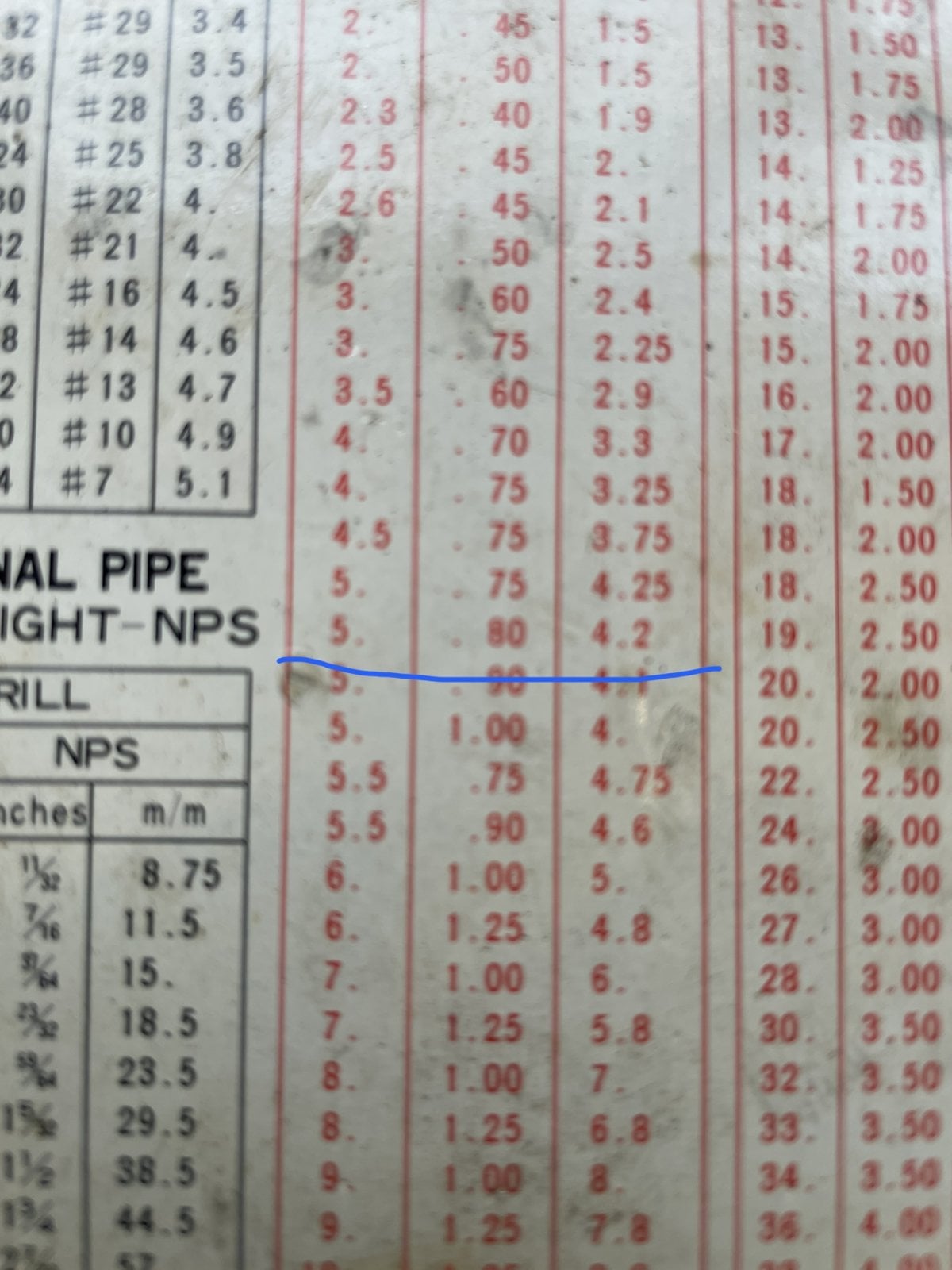

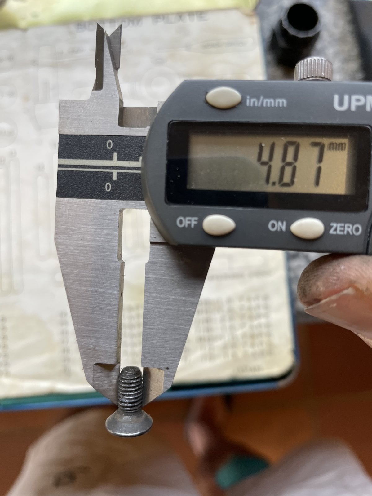

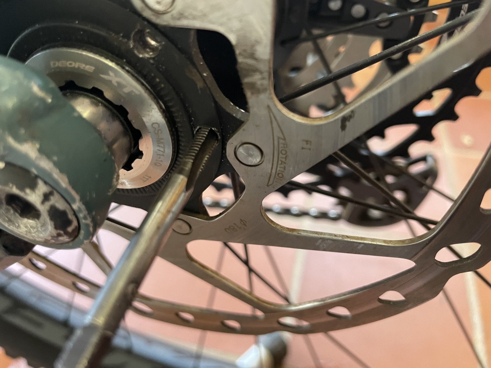

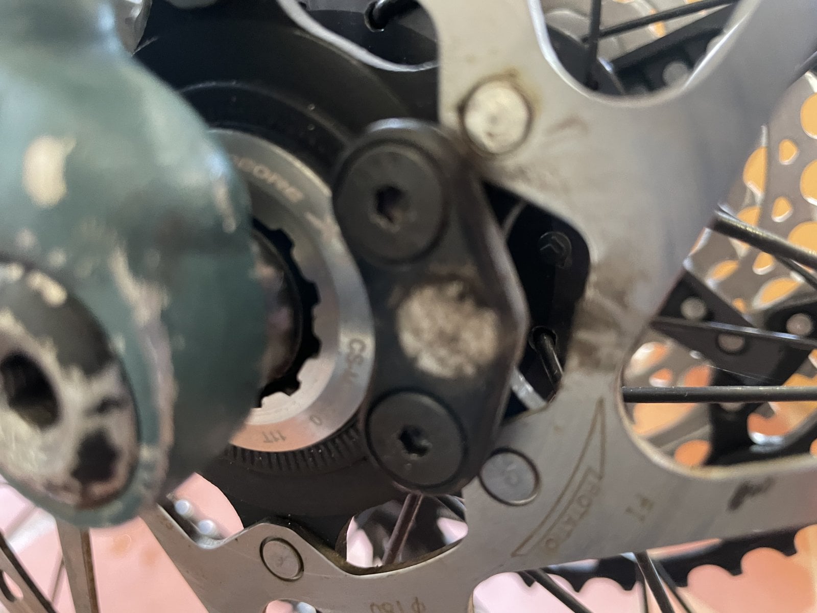

Hi I solved this issue quite easily, I had built a second wheel on a Shimano hub with centre lock. I simply took off the magnet and placed it as per the pics. Marked the centre of the holes, drilled through the aluminium with a 4 mm drill then tapped the new thread using a 5x 0,8 tap and the fastened the magent with new M5 cheese head screws. It’s a 2 min job now if I change wheels to take the magnet off from one wheel to another
Im sorry I dont remember the size of the nut. I just took the magnet to my local hardware store and found one that screwed on.
