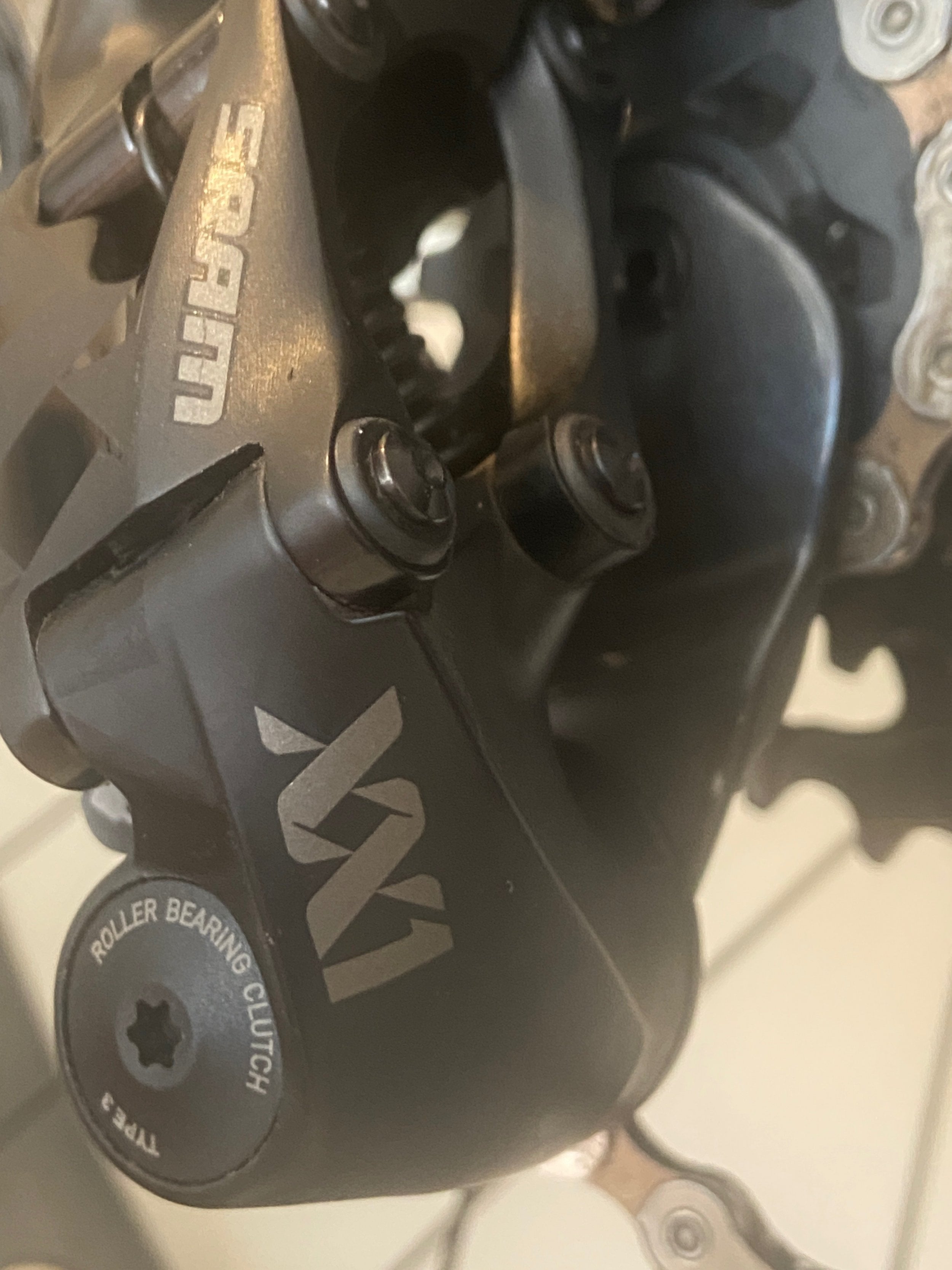

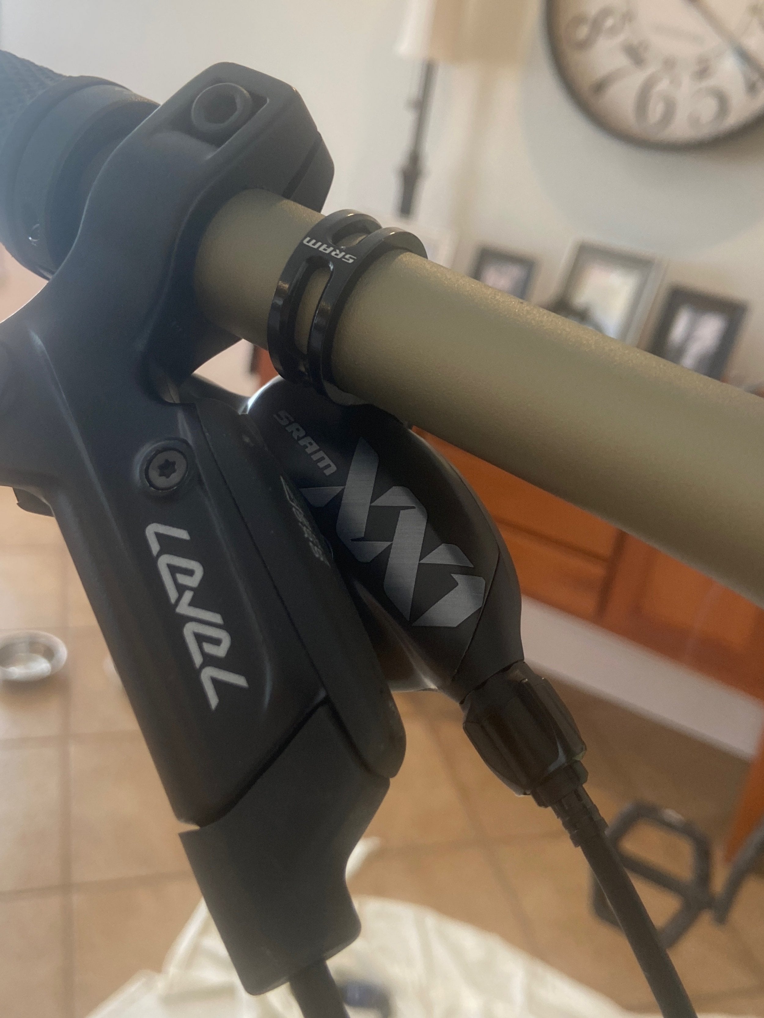

Swapped out the SX shifter and derailleur for XX1.

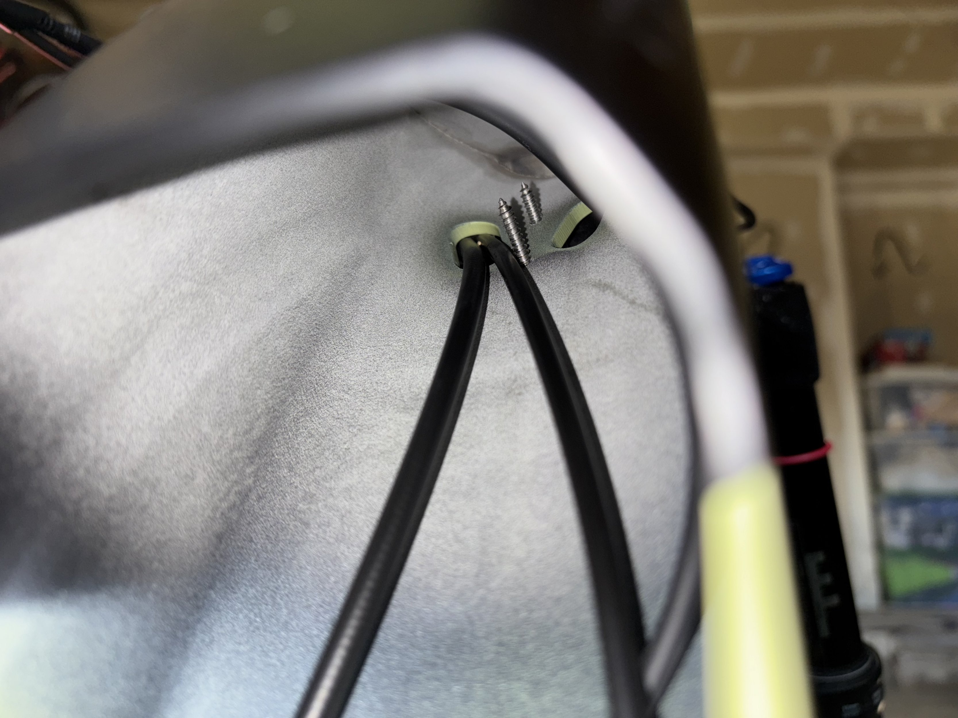

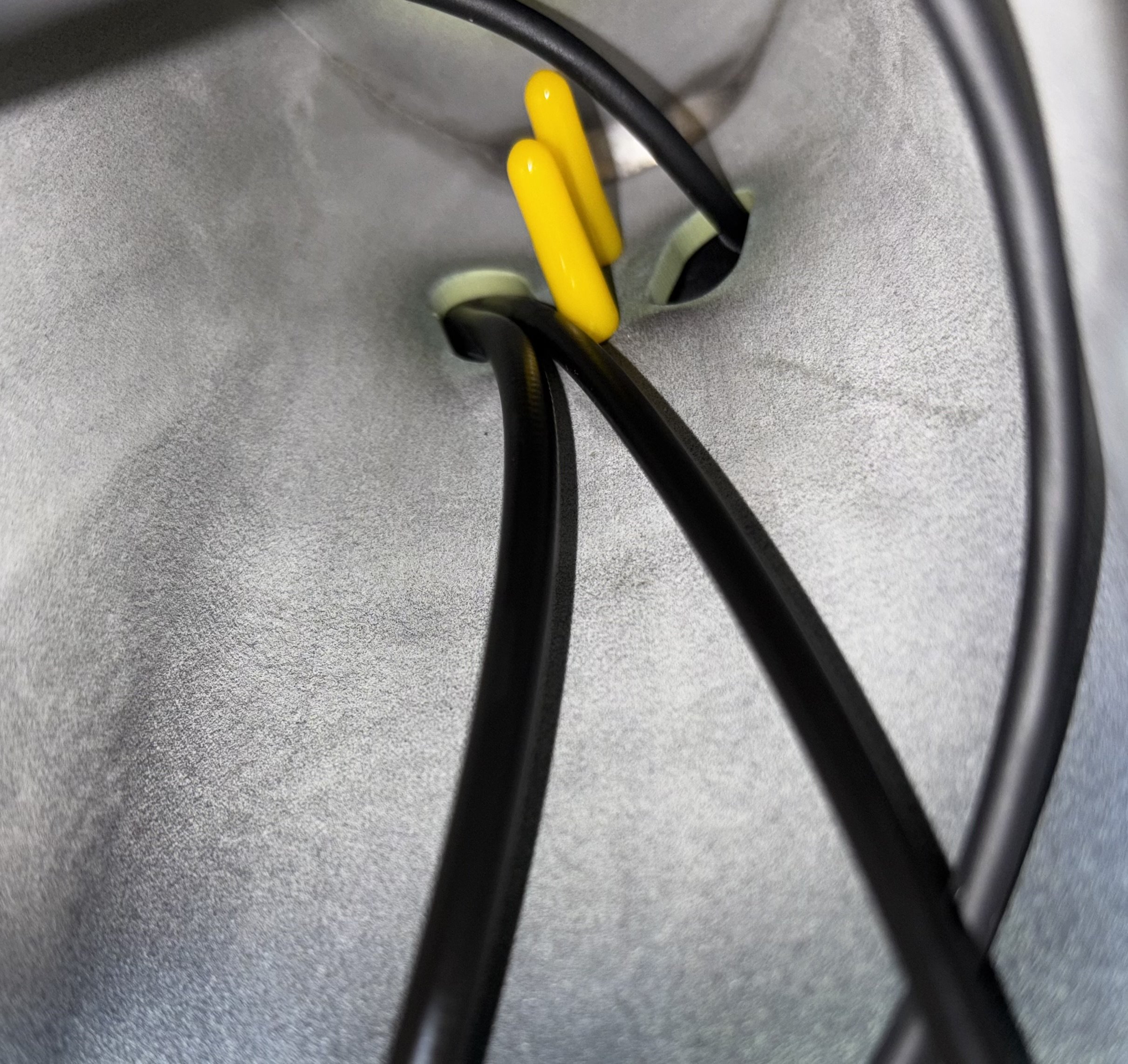

*** just saw your edit/addition to your original post about going tubeless.
Nice catch on the screws!
My LBS did my tubeless set up. They seemed to think it was fine doing Stans tubeless schrader valves, 80mm Stans rim tape, and Orange Seal with the stock Jumbo Jim tires. Both of mine sealed up fine. They thought it was a little funny that the rims are already drilled out for the larger schrader valve size but used a presta valve tube stock.

XX1 engaged. Feels like X01 to me.
*EDIT* I think the lever throw is shorter than my X01. I thumbed a few double upshifts on accident when I first rode in the timber. It is crisp and short.
