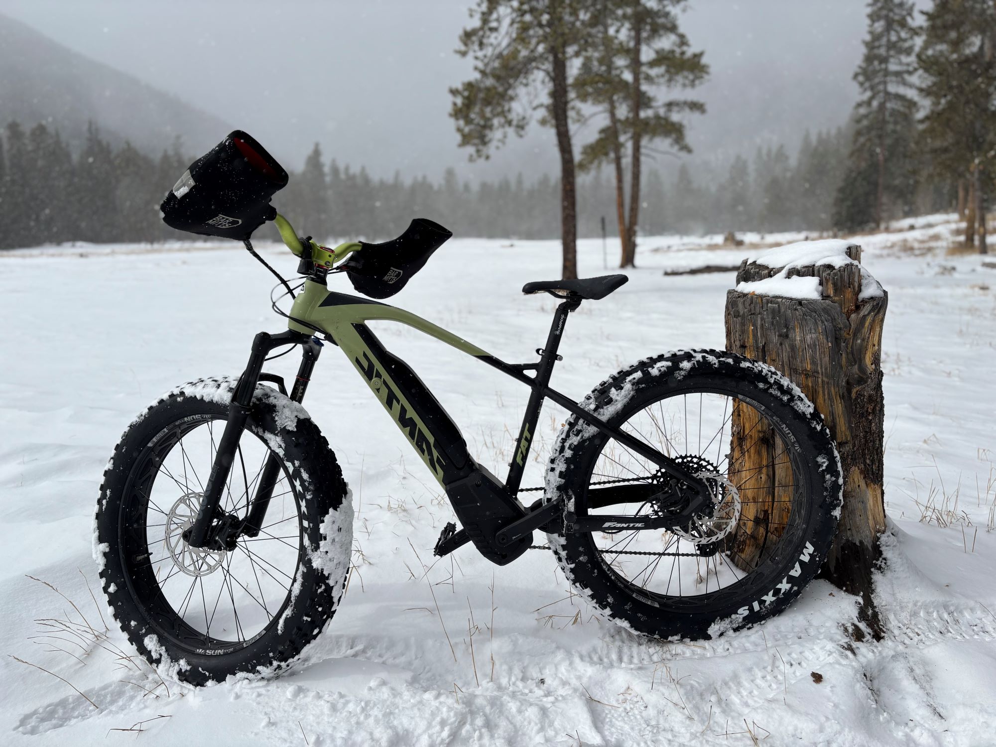

Just been riding my neighborhood loop getting used to the bike before heading up in the mountains. Still super impressed with the bike. It wants so plow thru everything
How do you like the bar mitts? With just decent gloves on I only lasted about 2 miles in -2 deg F temps. Going to either get better gloves or mitts.
Bike looks great BTW. And I NEED some snow! So jealous at this point! 😂
Brad
Sorry about the late response. The pogies work really well in cold, windy conditions. The ones I am using currently are just neoprene and cheap but work pretty well. There are some others that are better insulated and have vents that can be opened up - https://www.levelninesports.com/pro...ies-flat-bar-2023?selectedOptions=Color=Black
You do need to be careful as they can restrict your ability to pull your hands out quickly if you end up going over the bars in technical sections One good face plant will wake you up real quick.

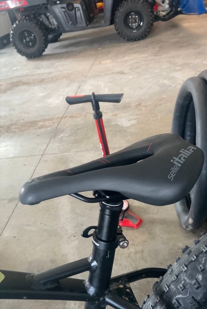

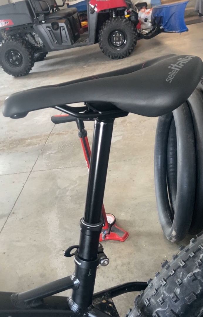

Dropper posts? I'm thinking about doing a 400-420mm with 130-150mm drop. What is everyone running on their Fantic Fat's?
Brad
My first dropper post ever, for any bike, is on my 9zero7 Whiteout fatbike. This allows me to remount the saddle when my feet are sinking in the deep snow which is my main purpose for a dropper. In addition to the remounting advantage, I wanted my new dropper for the Fantic to also have "suspension." I did a lot of research and I've been riding the PNW Coast dropper suspension seat post for the past 1200 miles. The comfort is adjusted via air pressure. I have mine set to take the edge off unsuspected hits and firm enough not to bob when pedaling. It has 120mm of drop, no other option for our seat tube diameter. This dropper works great for me.

Dropper: You will need a dropper with external routing. The cable will rout outside the seat tube and then under the motor and battery. It will enter the motor housing in the same access as the sensor and rear brake housing.

I actually got a OneUp 150mm to fit with internal routing. The 180 might have fit but the assembly that the cable actuates might have been close to the top cage bolt.

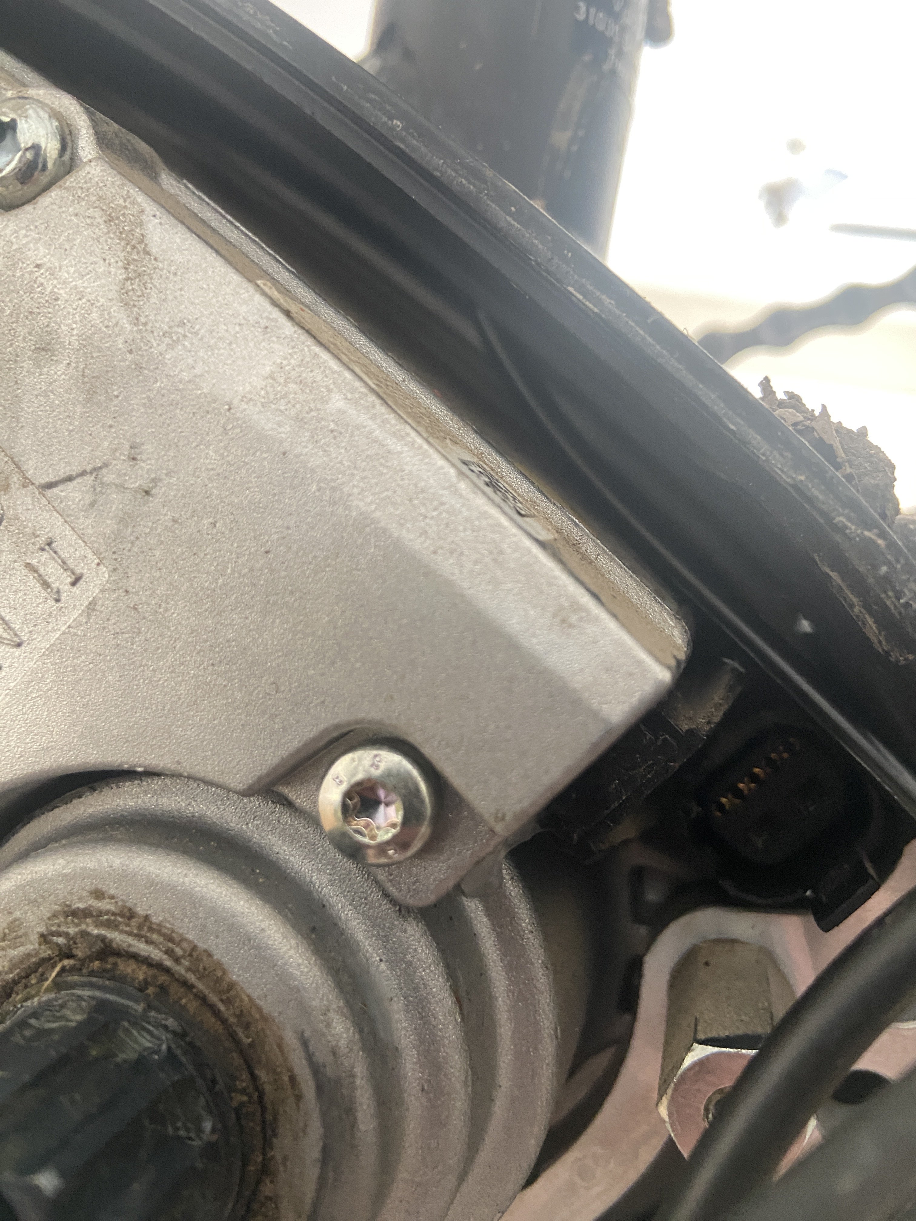

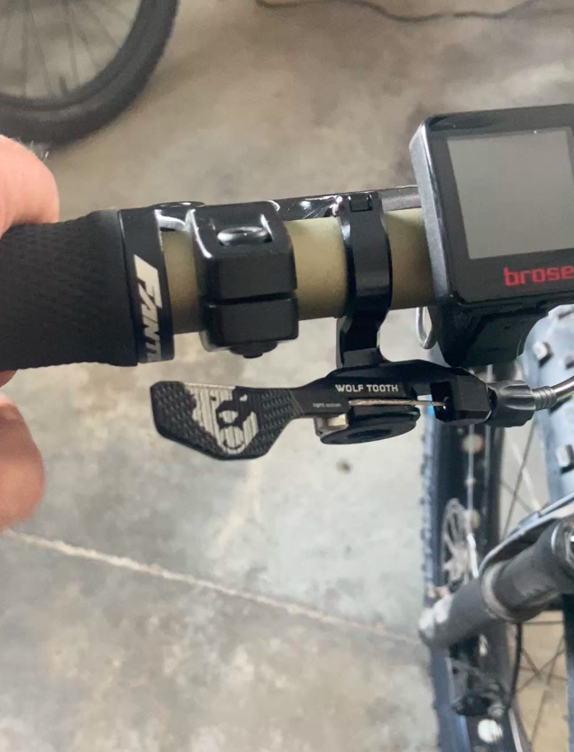

I just installed an internal OneUp V2 420mm - 150mm dropper post and Wolf Tooth ReMote Light Action Dropper Lever with 22.2mm clamp. I order both items off of eBay and the post came with the travel shims and cable barrel. It did not come with a cable or cable housing. I ended up buying Jagwire bulk length cable housing around 7 feet long and a Jagwire 2300mm shifter cable. The routing required removing the left side crank arm, motor cover and battery. I fished the cable housing down through the seat tube until it was touching the motor. I used a long flat blade screwdriver to push the cable to the rear and loop it around behind the motor wire and along the bottom of the motor. I then followed the display cable and brake line out into the battery area. I clipped it in the same holders that hold the brake line. I exited the frame on the right side with the display wire and wrapped it up outside the fame with the display wire and front brake line. I did have to move my display inside the lever so I could easily be able to touch the buttons. The walk button has to be touched behind the drop lever now. No big deal. My post came in at 150psi and it was recommended to be pressurized anywhere from 200-300psi. I used my shock pump to get it up to 275psi. Overall I am very happy with this set up.

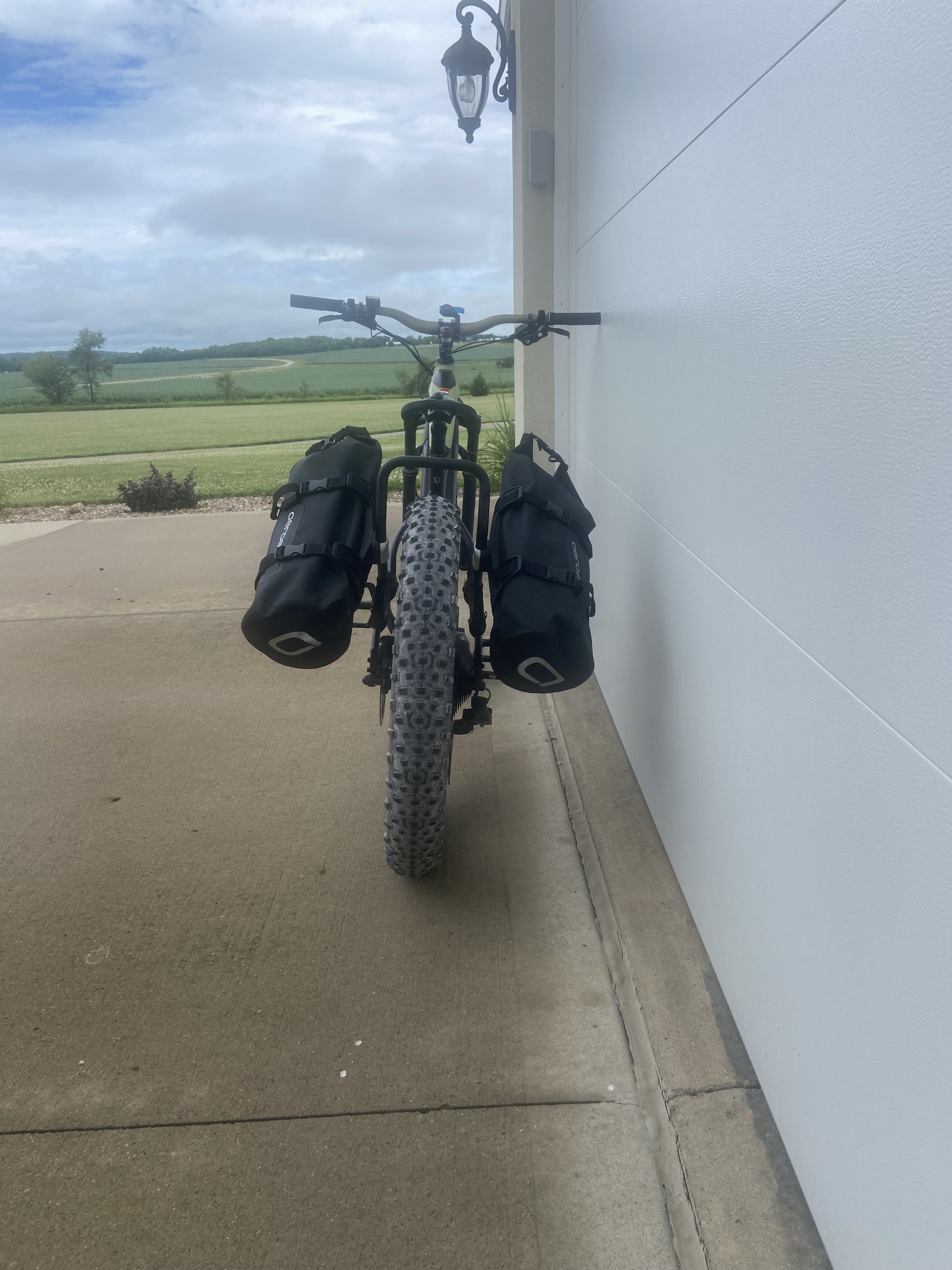

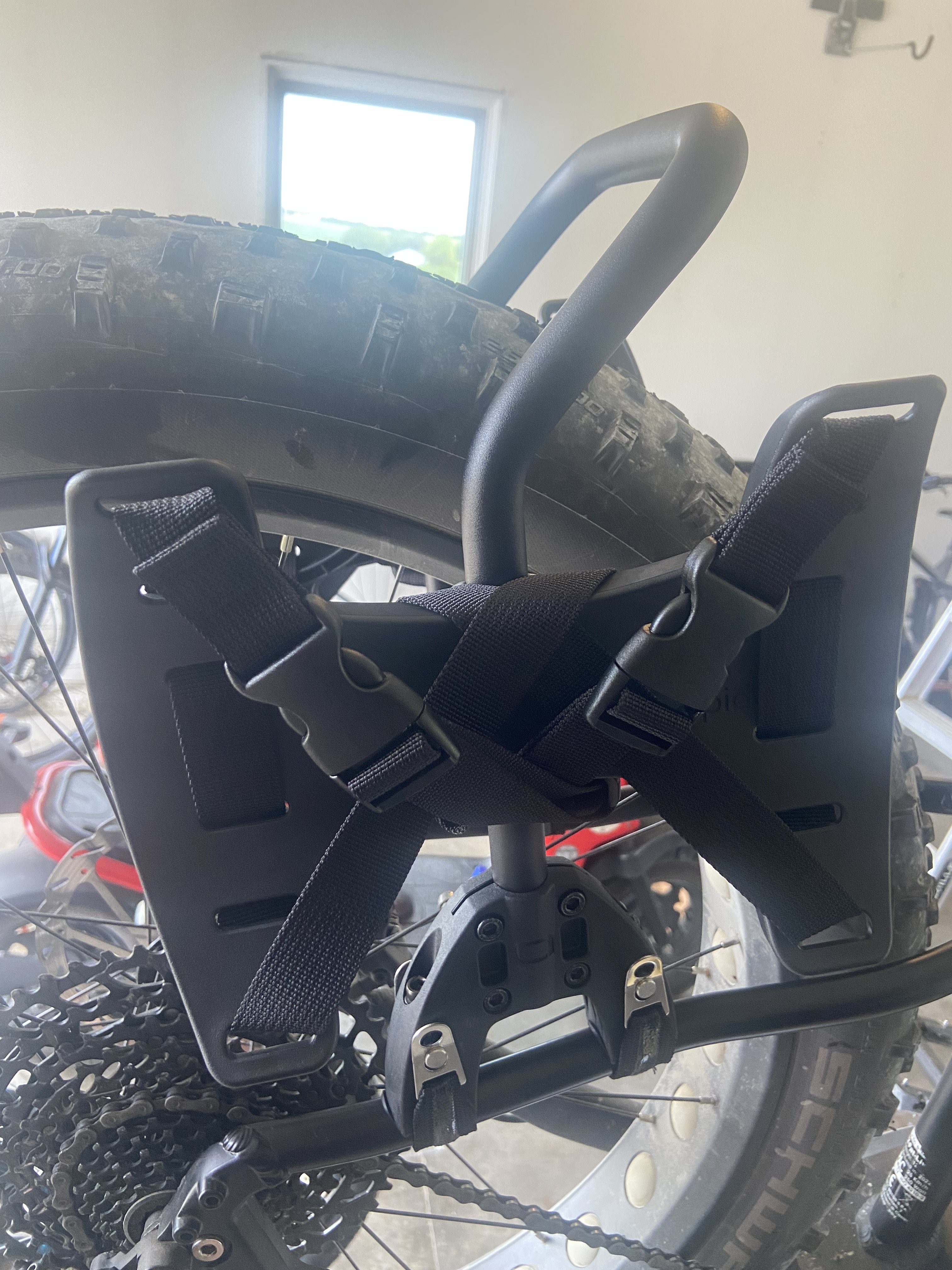

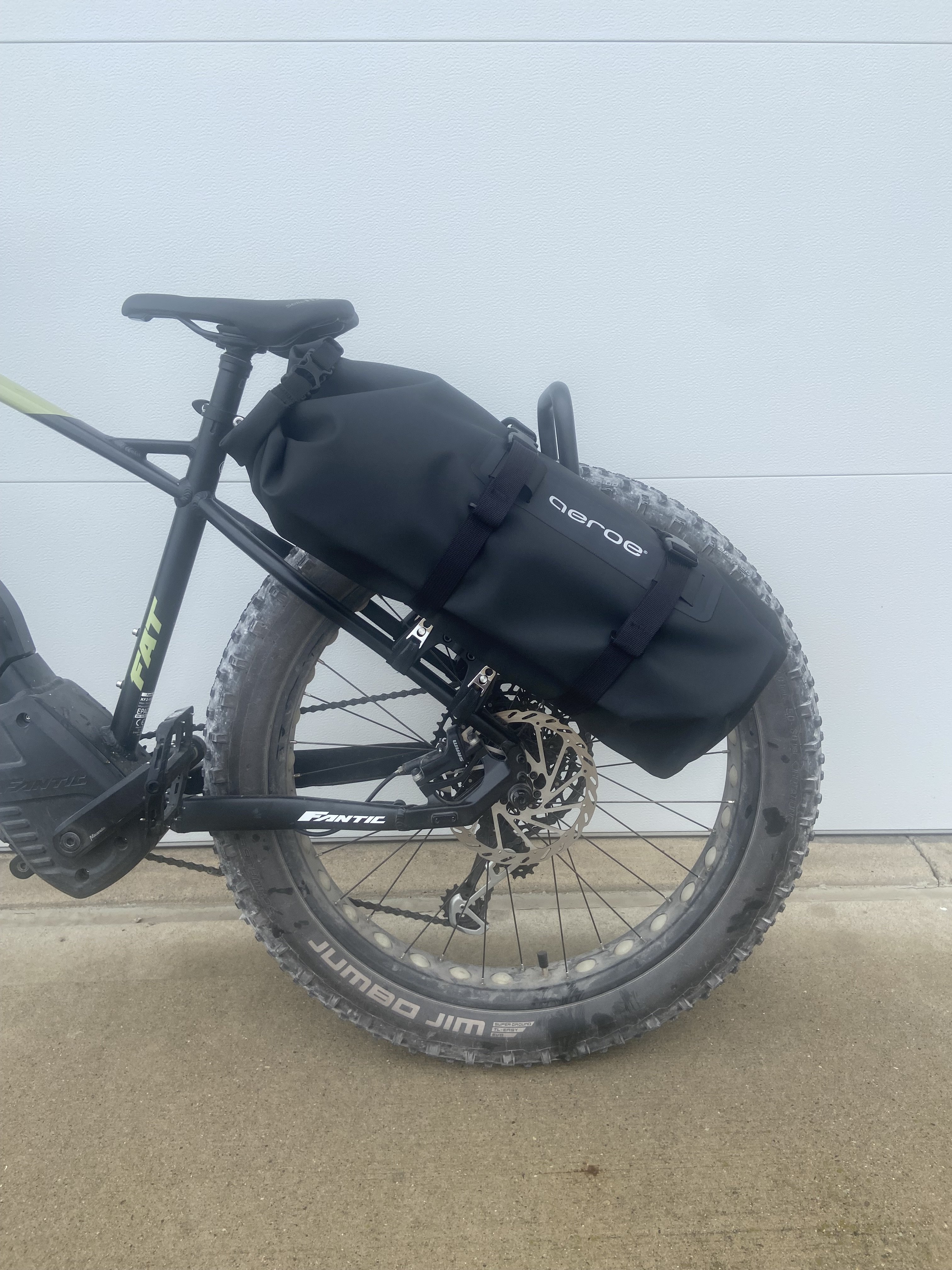

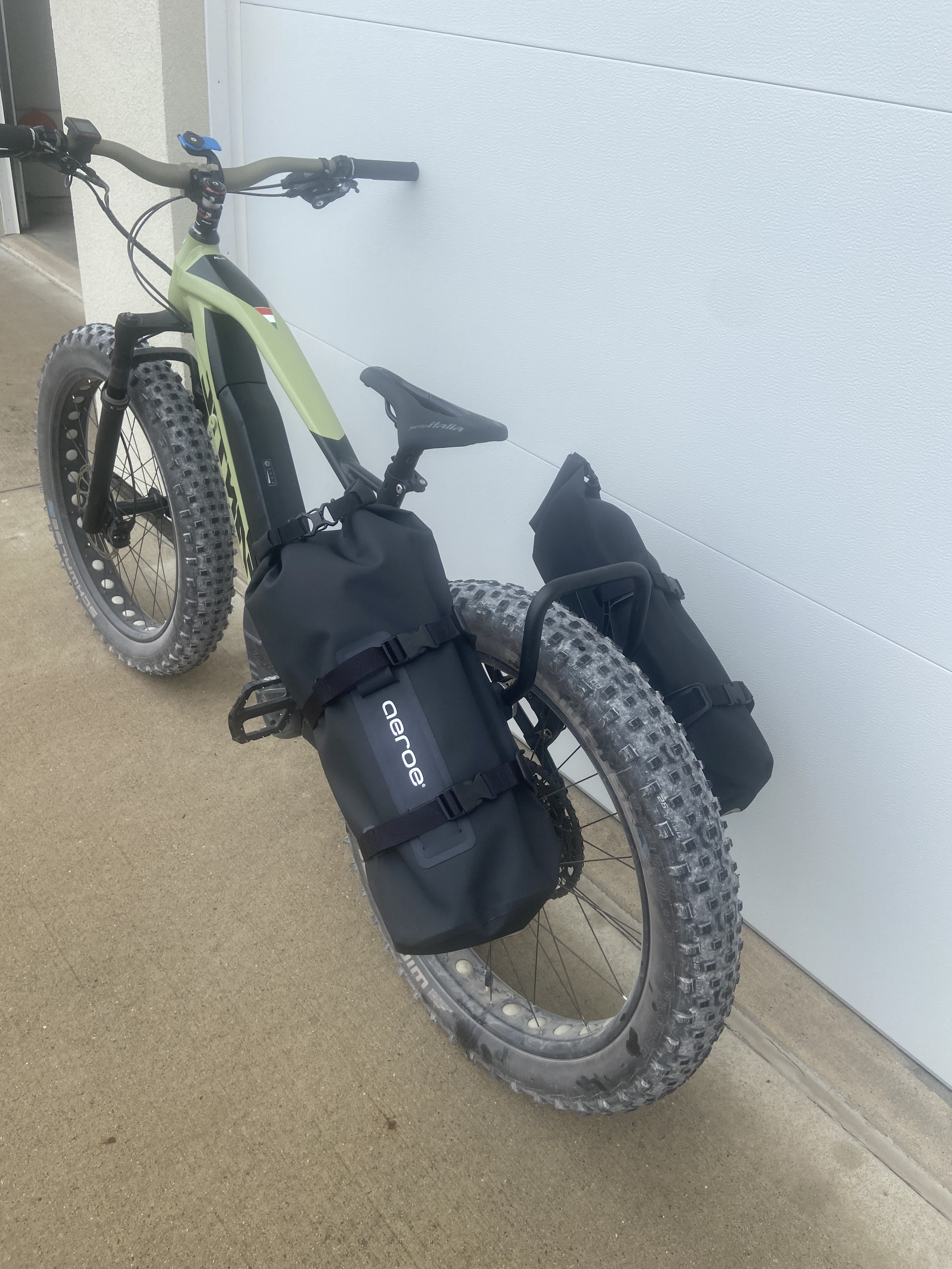

I just bought an Aeroe Spider Fat rack, double 12L dry bag set up and a 3.0 Speedbox from Ebiketuner. I most always run the bike in ECO mode with the software set down to 2% assistance. The battery lasts a LONG time! The reason for wanting to derestrict is because when I am gravel traveling I run into a ton of unleashed/untied dogs. I have had quite a few close calls and having the added speed would get me out of these situations.
Looking forward to some extended rides now! Longest single ride is 34 miles so far.
Brad
I am very happy with the Aeroe products. They are very high quality and will be a great addition to my Fantic. I ended up buying two plates and two 12L dry bags. They will easily store all of our traveling things and shopping items when we go by bike. I was going to replace the factory straps with some Voile straps but like the way they can be strapped up crossed and on the ready when bags are not in use. I'm trying to get away from wearing a backpack unless necessary.
