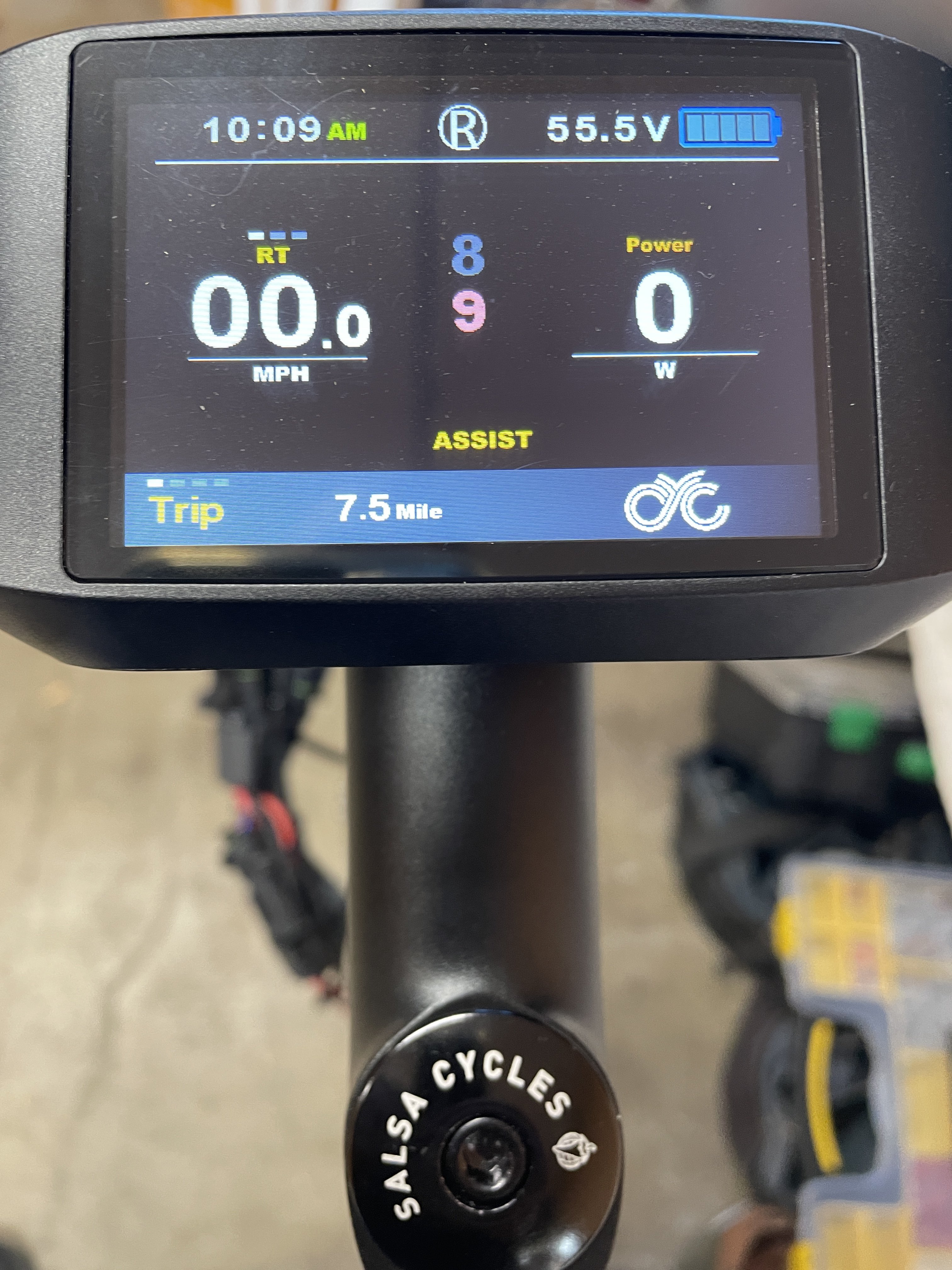

Display. It's quite fun as has human power in watts, and cadence measure which I've always been curious about. Looks like you can also hook it up to a heart rate monitor.
Downside is it seems only to have 3 power levels whereas previous display allowed for up to 9 levels. Not really that much of an inconvenience if I'm honest.

I do like that display though, as someone whos pushing his motor and rides in the summer when its over 100F outside a temp read out right there would be nice. And I agree I have 9 on my ebike but I only use 3, but I am running a throttle though for temporary extra high assist when needed without going through the hassle of upping it for just a few seconds.

Regards heat, you'd like the display as it looks like it keeps track of motor temperature.

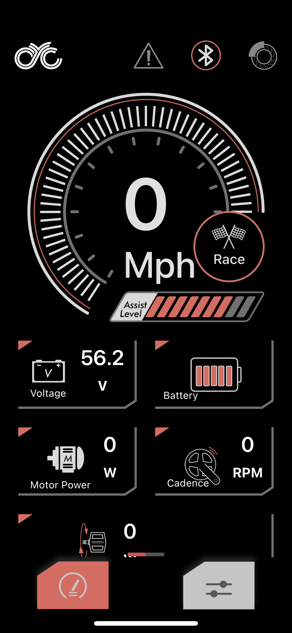

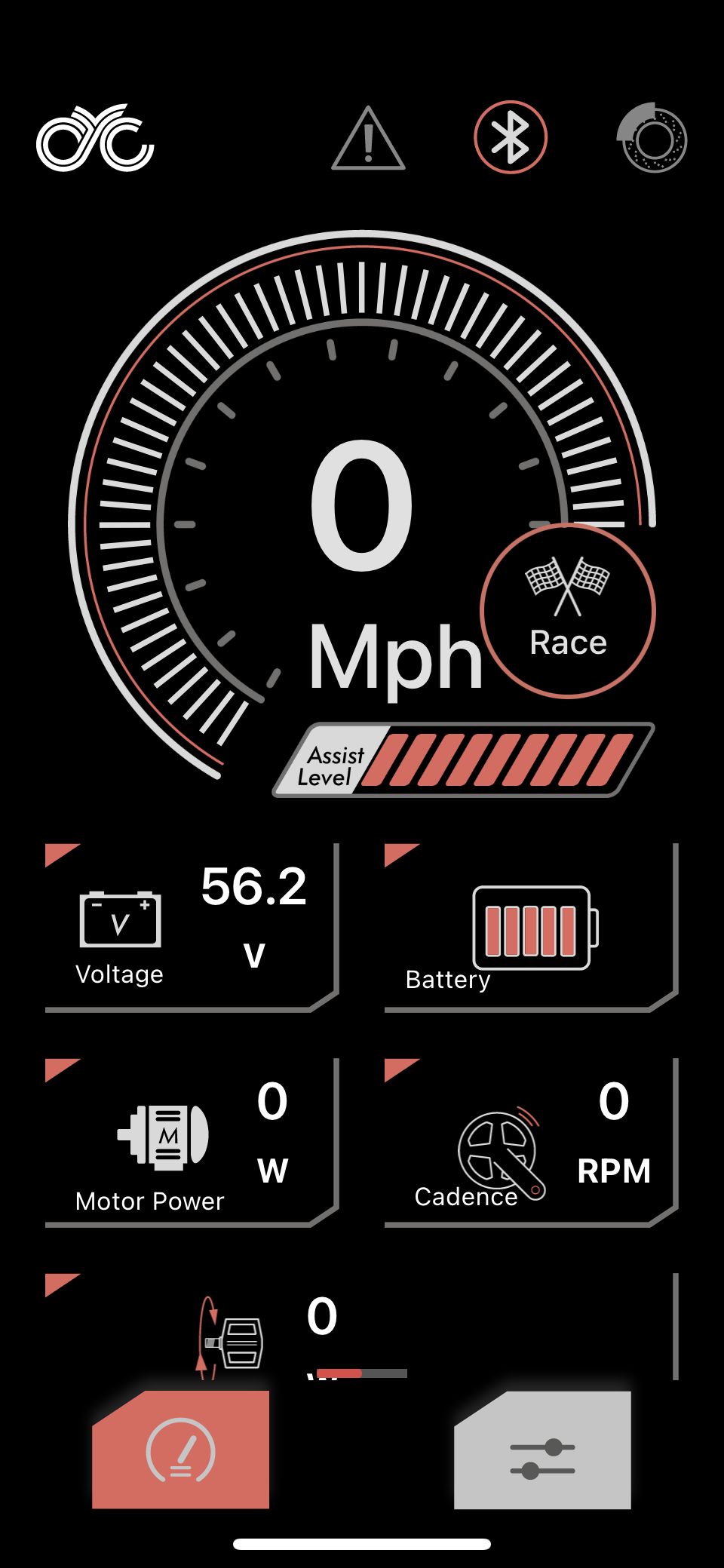

Marjoriefinnegan - Have you used the app yet? I am running a CYC X1 Pro Gen 2 with the new X6 controller and a 750c display and I have noticed a few bugs in the app. The main one I am trying to work out is once I stop peddling the motor keeps running for about a second before it stops applying power. Very evident when you have max power set at 4000 Watts. CYC and GoldenMotor do not answer my technical support inquiries even though the whole setup is still under warranty and the manual does not help.
NapaTom
Feb 11, 2023
94558
I have noticed that I can change the number of levels to 9 on the 750C display and the app will show each level every time I hit the + button on my 750c Display control button. However, in the app setup it only shows 3 levels.

Only had a cursory play with the app to change power levels so can't comment at the moment really, but have used the 750c display before and am considering going back to it as I have a spare. The 103 is a fun display with loads of information... That you probably don't really need.
Interesting about displays levels vs app levels. As I recall there were only 3 power levels displayed in the app, but I assumed that was linked to the 103 display.

With the 750C set at 9 level the app starts out with the first bar on level 1, then 2 bars level 2, etc... the pics attached are level 1, 5,7 & 9.
