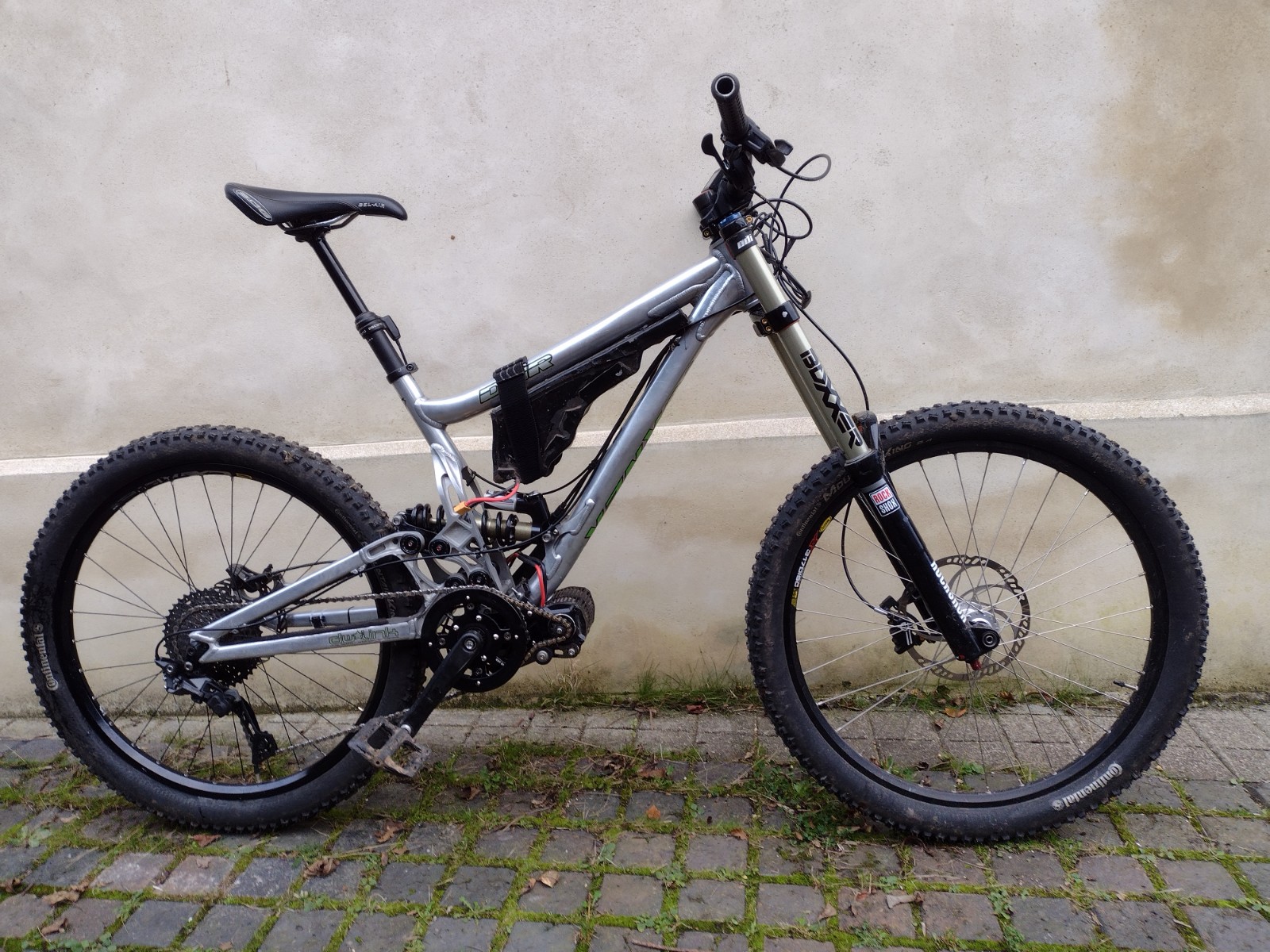

Ghetto battery installation for testing, hopefully on the road tomorrow weather permitting.
21700 batteries in a 14s3p configuration with BMS.
3d printed carbon nylon adaptors to make bottom of downtube flat.
All up weight of 24.74kgs with 2.5 knobblies.

I'm not sure. I thought about it, but no way to know from where I am... I already paid for the controller mount, so I'll have that and can determine if it will fit there. That would be a clean location.
My goal is a clean install, so if I can keep things from hanging off the bottom, even better.

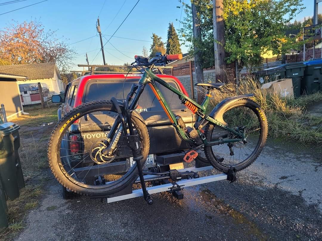

The square taper was a huge red flag for me. This new gen 3 solves that and a ton more. Its looking pretty dialed. I think i could tuck this inside the front triangle on my commencal meta29

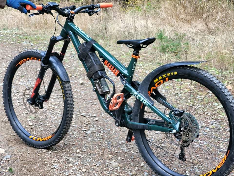

This guys bike looks so clean with the cyc unit inside the fron triangle. I just happen to have one of these bikes. So tempted

Thank you! Now to look for a used one for sale.
If youre looking for a large, a friend is just posting up his frame on pinkbike. He's in vernon bc. I dont know the details but he really looks after his bikes. I doubt he used it much. He was injured and when he was riding he was riding his bullit emtb a large majority of the time.
I have a medium complete im considering selling just not sure. Ive barely used it. Like you im thinking of adding a cyc bolt on motor to it
