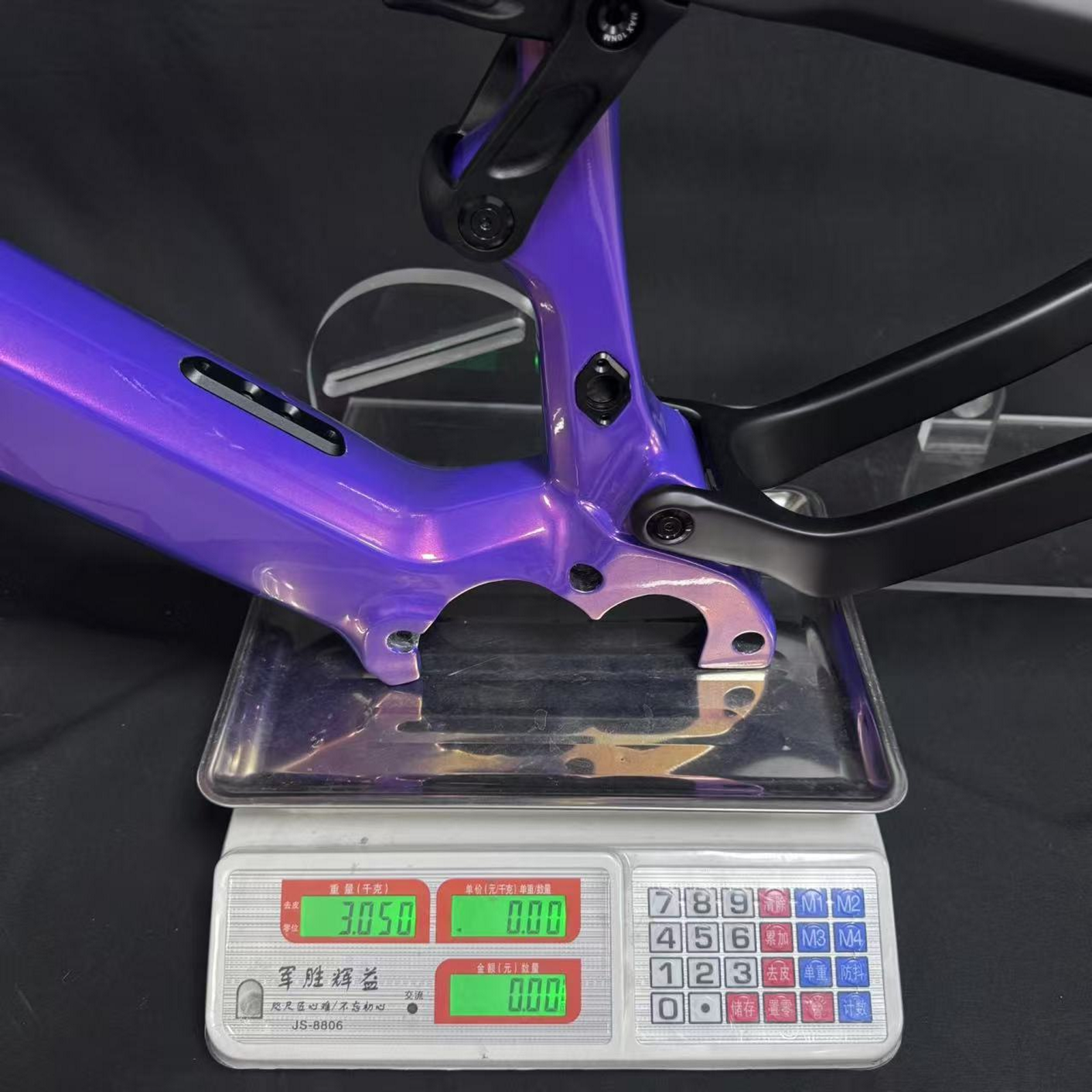

The carbon 480wh is out of spec as well. The weight is 2,35kg and not 1,95kg.
And frame weight is not even close to the claimed weight. It’s about 2800g in size large. Jean is honest about the weight of the frame, but they don’t care about updating the pdf.
My plan was to build a true SL, but with the frame and battery adding 800g I would just go 170mm front travel and cheaper overall parts without the weight weenie approach.

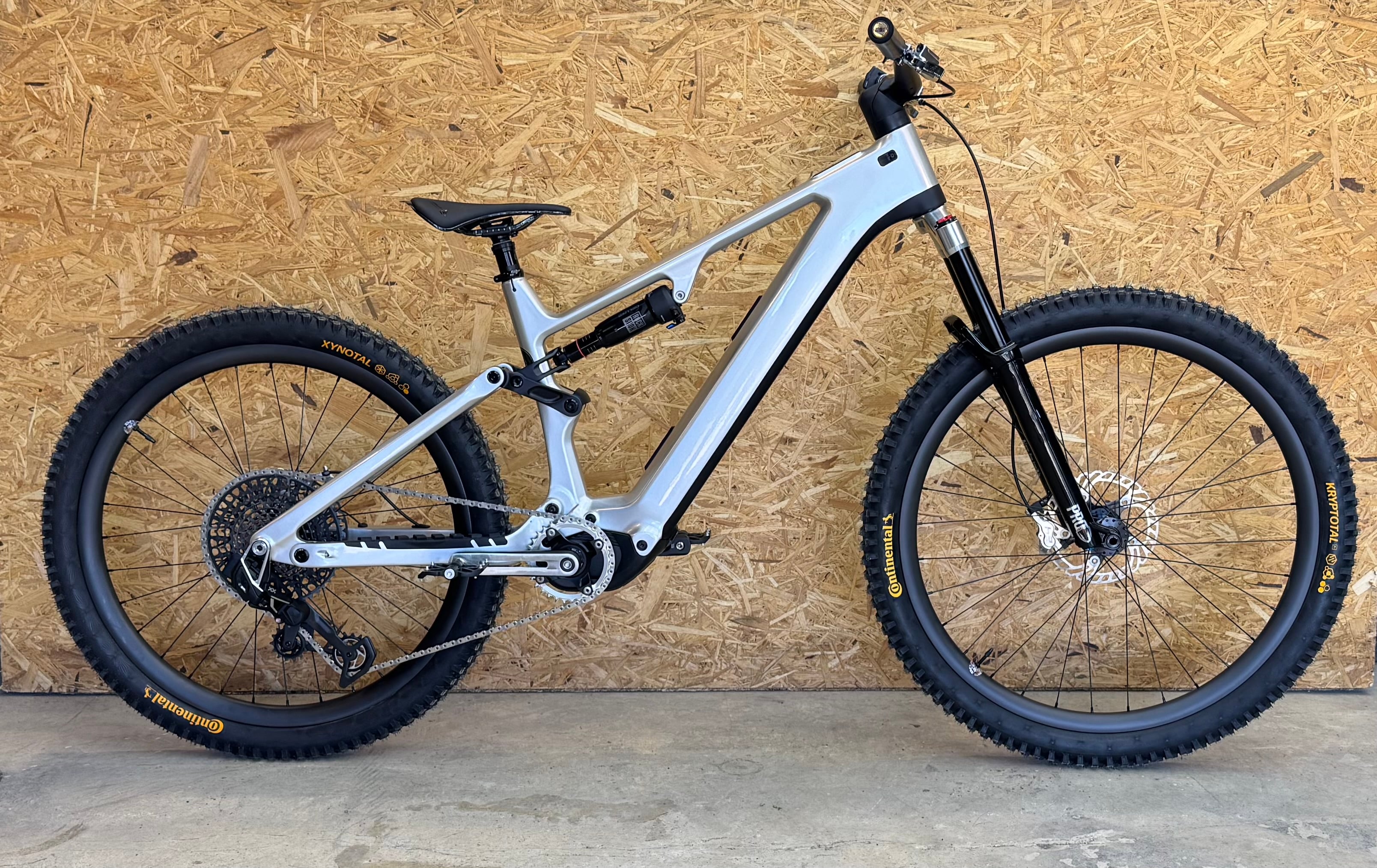

Just done a testride to see that everything is working. Carbon battery and range extender.
Thanks! It weighed in at 16,5kg in the lightest setup and 17,5 as pictured.
