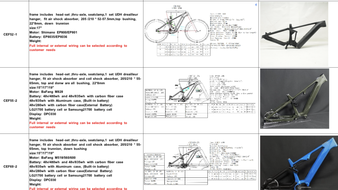

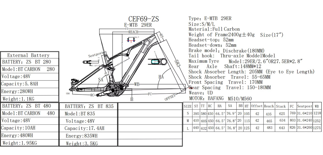

Wow! This might be the one for me. The 205mm shock length is strange, but you can use an offset bushing if you have the much more common 210mm length shock.
205mm is a trunnion size while 210 is a conventional eyelet metric size.
Some shocks can run an air can spacer to simultaneously reduce eye-to-eye length as well as travel. Otherwise the offset bushings are probably a viable alternative, and will get you close to a net 205mm length. Depending on if the frame comes with hardware to run a concenttional shock, you may also need to get creative in finding a way to mount the shock. You can swap out the 10mm ID bearings for 8mm ID ones. Or in the past, Ive drilled out chainring bolts to use as spacers to run an M8 sex bolt through the 10mm trunnion bearings.
Ah thanks for the insight. It didn't cross my mind that it's design for trunion mount. Which makes sense why the top tube shock mount is so large.

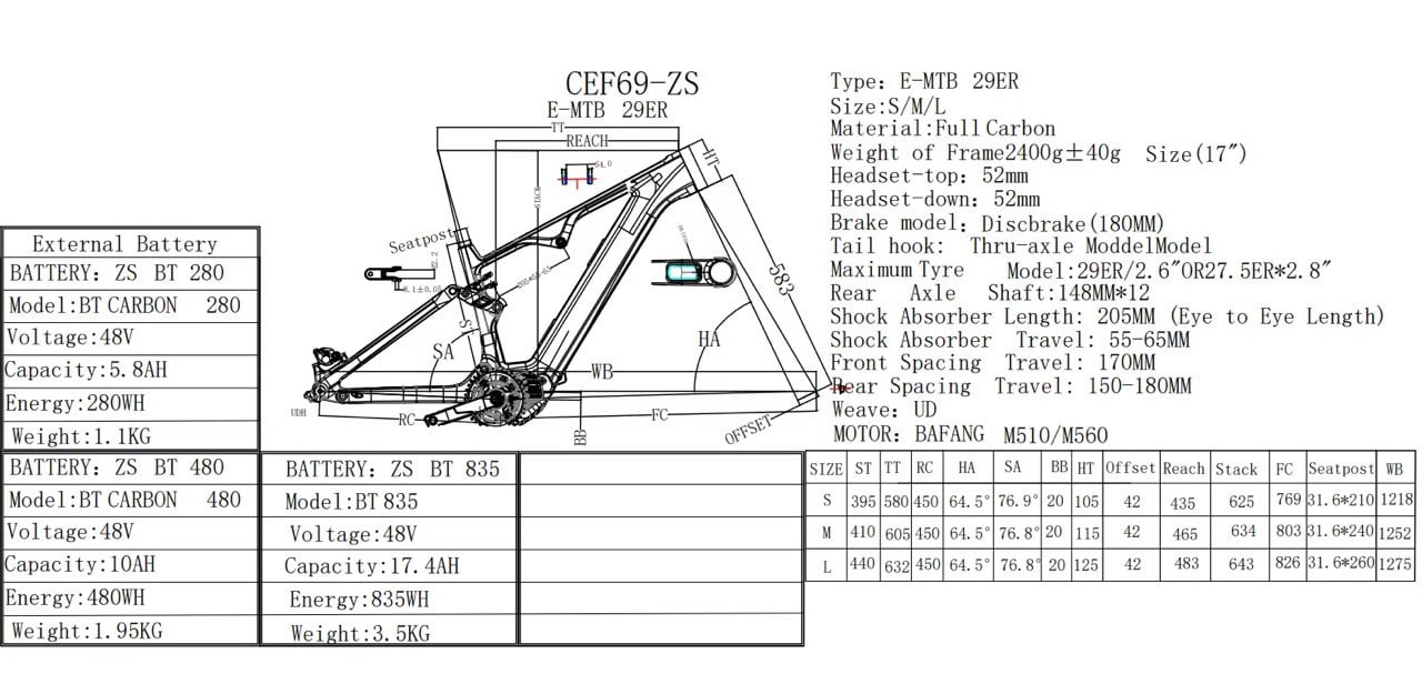

205mm trunnion shock is same as 230mm normal shock with 57.5-65mm stroke. 185mm trunnion is same as 210mm normal with only 47.5-55mm stroke. This frame is made for 65mm stroke, you would gain nothing with strange adapters. If numbers are correct it has 180mm rear travel with 65mm stroke. This could be a really nice frame!
I already have a frame with a nice 210x55 shock and don't want to spend a lot more on a new new shock. I just want move all my parts over. The spec sheet says 55-65mm stroke for 150-180mm travel. 180mm is WAY too much travel. I was trying to find a way to use my 55mm stroke shock to achieve 150mm travel for my intended trail use. Thanks!

210x65 is really strange. I just copied data from the seller's page. I think the correct size is 210x55, 210x65 is a mistake.

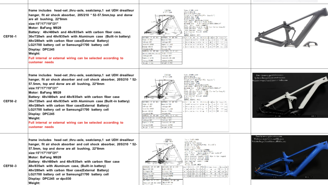

The CEF55 is 210x55 - standard eyelet mount.
The CEF69 is 205x65 - standard trunnion mount.
The second number (stroke) is variable depending on how much wheel travel you want.

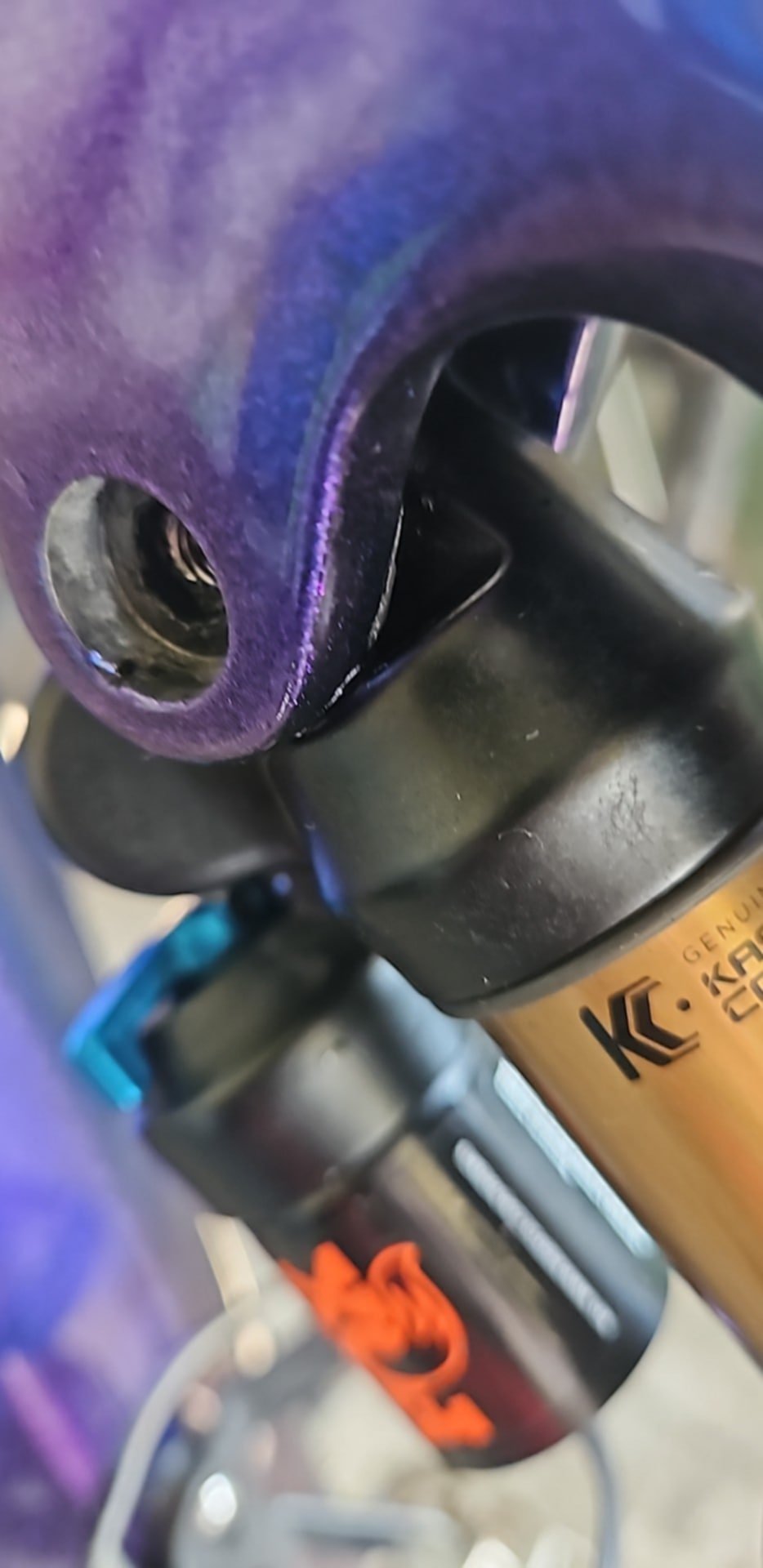

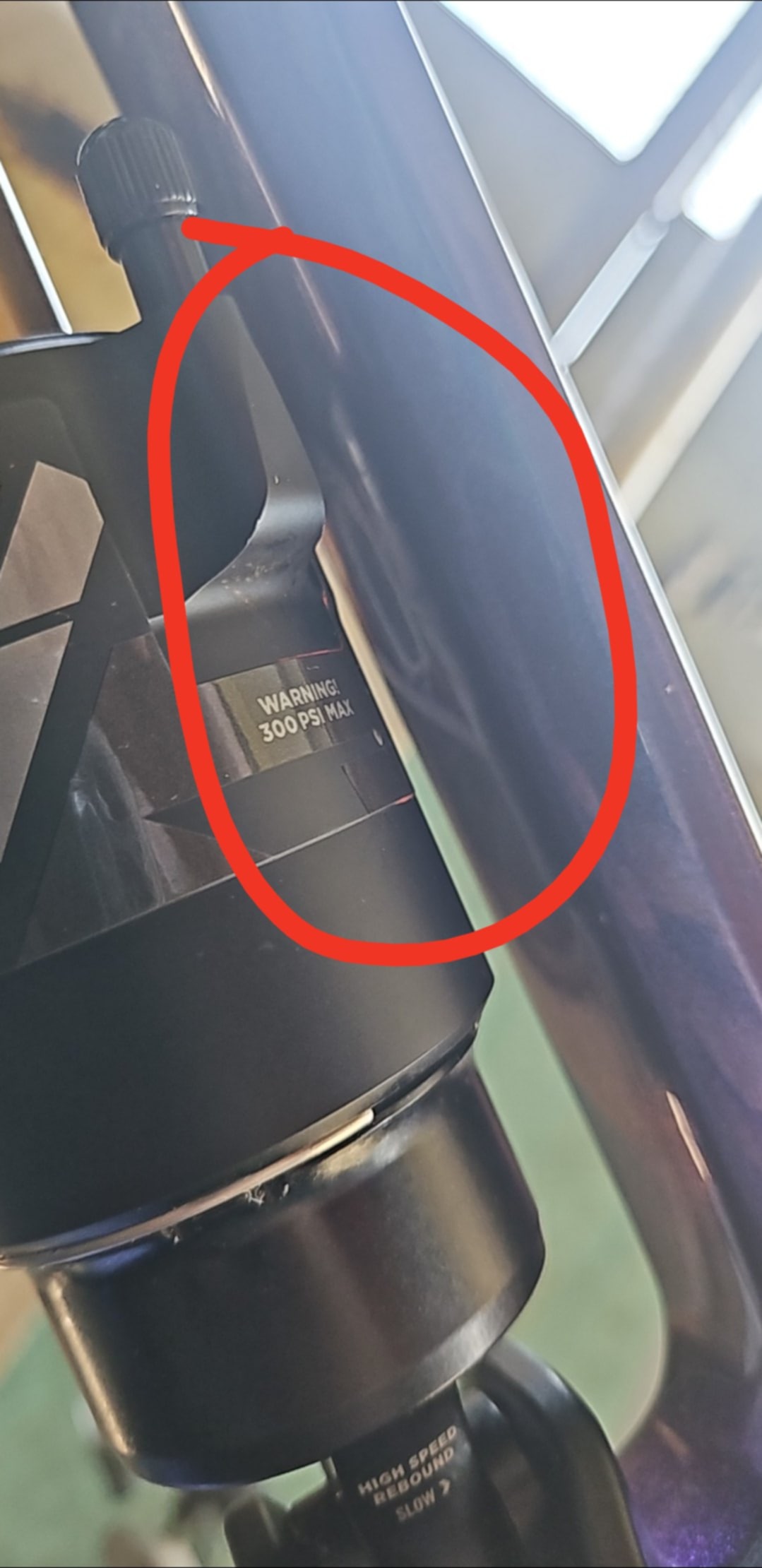

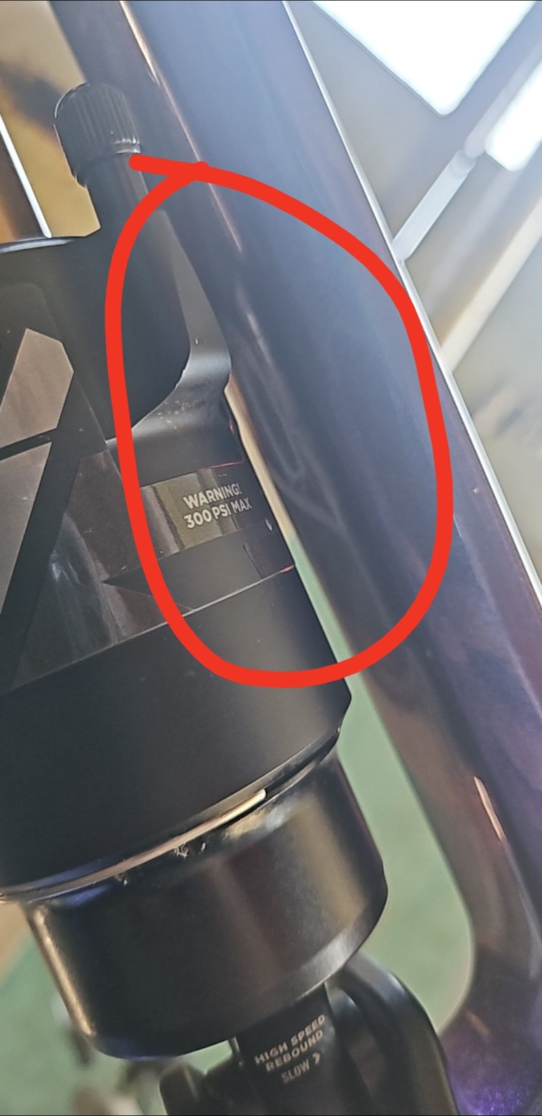

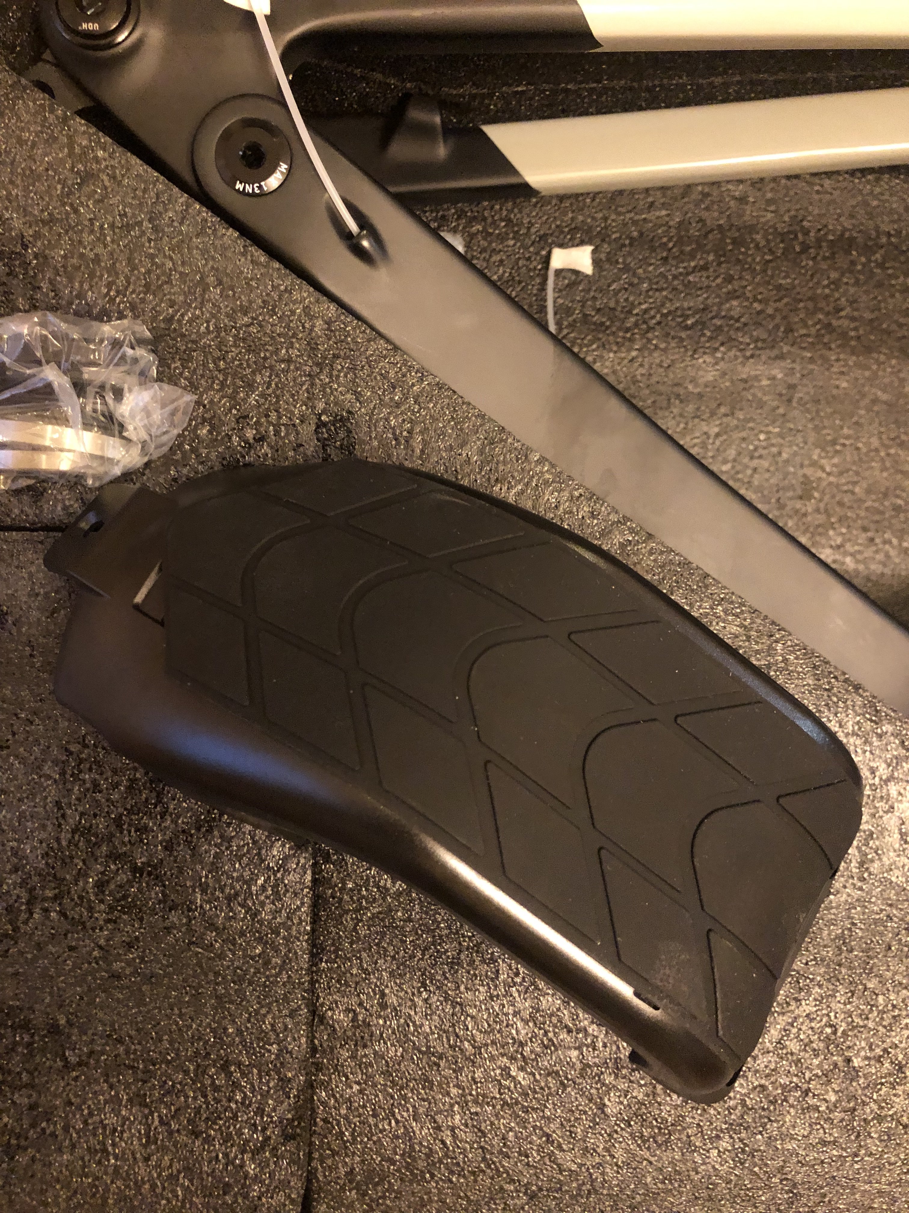

Here's an update on the cef 55 with a fox x2 210x55. The shock is rubbing against the top tube and the shock mount. Any recommendations on what shock to get?
View attachment 165470 View attachment 165471
A super deluxe should fit, since silo got a deluxe in there. I saw a Float X fitting fine.
I saw his post. I'm now looking for a float x to fit in there. Knowing that the x2 won't fit, I assumed the DHX2 won't fit either since they have the same mounting bracket.
Bummer to hear the X2 wont fit. And that's concerning because it may mean other Fox shocks may have the same issues. It looked like they might have been on the third revision of he frame already (ie CEF-55-3). Perhaps this was something the revisions addressed?
I'm hoping the Manitou Mara pro will fit. The main air can diamater is 51mm on the mara pro, while it's 57.7 mm on the x2. Also, the top cap is recessed by the eyelet to avoid the rubbing you experienced. Unfortunately I won't be able to confirm for at least another month, since I'm still waiting for the frame to ship.

I think the Manitou Mara Pro will fit because of that type of recess near the eyelet.
