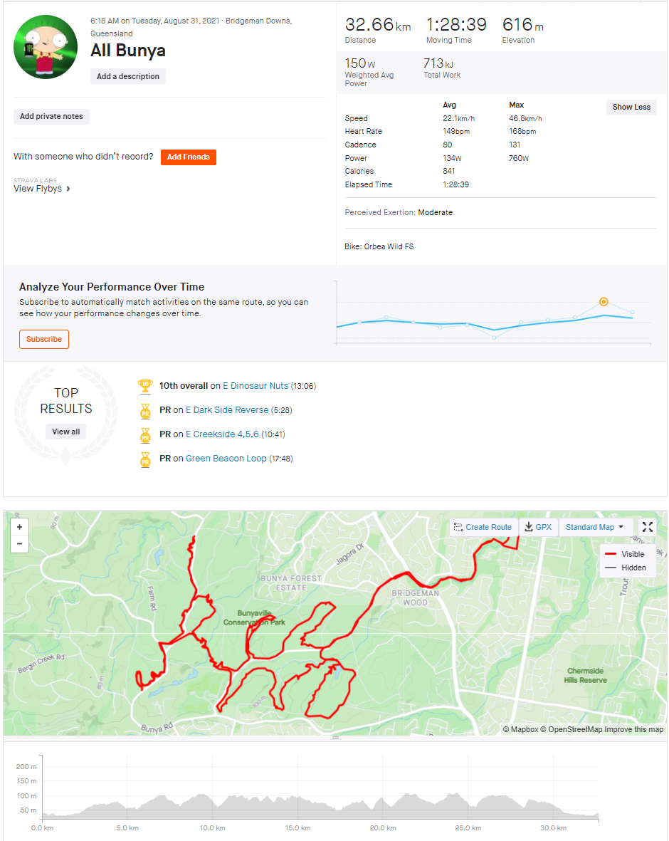

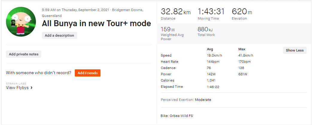

Got Tour+ loaded at the LBS yesterday. I don't muck around :)
Went for a ride this morning, duplicating a ride I did 2 days ago in eMtb mode.
First, this is in eMTB, this is my local trails and a ride I'm doing frequently as I'm working on shedding some lard:
Same ride in Tour+ this morning. I wasn't feeling it as much, felt a little less fresh and it had been raining overnight. But I think it's a decent enough length to see the difference.
First, I think Tour+ is much better at filling it's intended purpose that Tour was. With the old Tour if you put more effort in you didn't really get a reward so that meant it just became a drudgy long slow ride and meh that's not why I wanted an ebike. Tour+ makes it so you can push harder and get something back, most noticeable on hills or on approaches to jumps, but you can dial up speed anywhere with some leg torque. I'm using a volspeed and found getting to 32 limiter for a gap jump no problem at all.
Fun wise? eMtb is noticeably more exciting, especially out of corners. It was wet this morning, so that would have been a factor with overall excitement, but the bike felt more muted.
The numbers are interesting though. Average speed 19 vs 22km/h, 15 mins longer over 32kms for Tour+ (but it was also wet), heart rate difference pretty negligible. Average power output a smidge more with Tour+ but not significant either. My max output was more in eMtb I would assume because I was having more fun, and in a better mindset. There is a little better fat burn workout in Tour+ for me with some more calories out. But that's pedaling calories - I don't think the extra calorie expenditure of descending faster, working the bike etc, is in these calorie burn numbers here. Don't really know what that equates to I guess.
I have more fun and thus I naturally work a little harder in some places in eMtb, and this offsets the increased motor assist somewhat I suspect. A somewhat different kind of effort between the two modes.
Long story short. I put in pretty much the same pedaling effort whichever mode - but the bike adds more in eMtb so I go faster, have more fun, and burn more battery.
Now, battery usage, well... Tour+ 52% remaining, eMtb 29% remaining.

My conclusion, I think Tour+ is a nice upgrade over Tour and a good mode to get more battery range (vs eMtb) without crippling the bike too much. It's certainly what I would use for any range anxiety ride or maybe for a long slow ride if I was doing a training program. It opens the door to doing longer trail rides and exploring (a bit) further afield, and is for sure the best low power mode I've used so far (I had a gen 2 Levo and an e8000 before).
But eMtb mode is more fun and what I'll use generally, whenever I have the battery to cover it :)
@Zed , interesting figures. Your power input appears to indicate that you are (more or less) applying the same pressure to your pedals for both modes. That would also translate into a longer ride time, lower average speed and more remaining battery.
Do you have a power meter on your pedals/cranks? (Strava gives us lowly cheapskates only an "Estimated Average Power")
