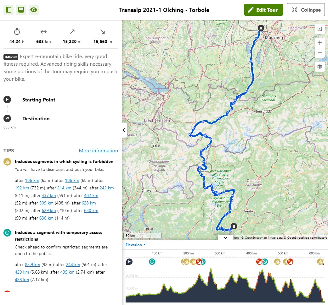

The route I am planning this year is this.
Based on this

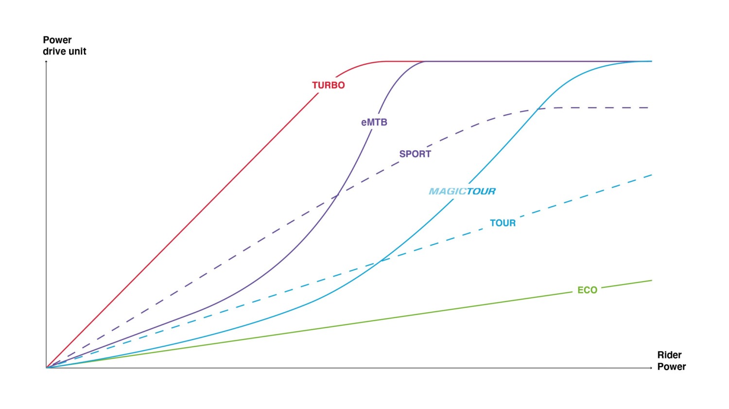

I think because it uses eco, tour and turbo modes it can land up being more efficient and still delivering better power when it's needed. This article claims the moustache one (bosch's own tour+ must be similar) gets a small efficiency gain over the old tour - which must mean that when you're just using tour, you're over powering in some places (flats).

You can see from this graph (this the moustache magic tour mode, but Tour+ you'd think would be very similar) that the turbo does kicj in but only right at the end when it senses maximum effort... but I really don't think I'm getting that. Before Tour+ I rode the steep section in eMTB and can feel that extra power over the Tour+. Would love to see some real world tests and graphs to see what power level is being applied when.

...just trying to explain why it's possible that Tour+ could have 'more' assistance and yet still deliver better battery life. Think is it's not actually more linear assistance... see the curve of MagicTour (Tour+ would have to be close). So you're getting less assistance at the bottom end, but more assistance at the top. Personally, I like the Tour+ mode a lot. I'll probably leave it on that 99% of of the time now.

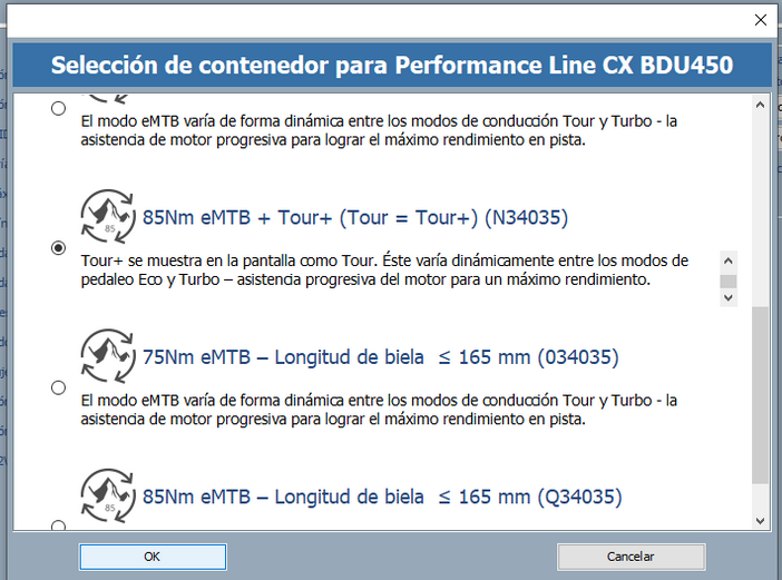

Totally agree. Had mine updated yesterday. As the LBS know that I'd be querying where Tour+ was, given that I had specifically asked for it ;), they gave me this screenshot of the update software confirming that "Tour" on the display now equals "Tour+":
