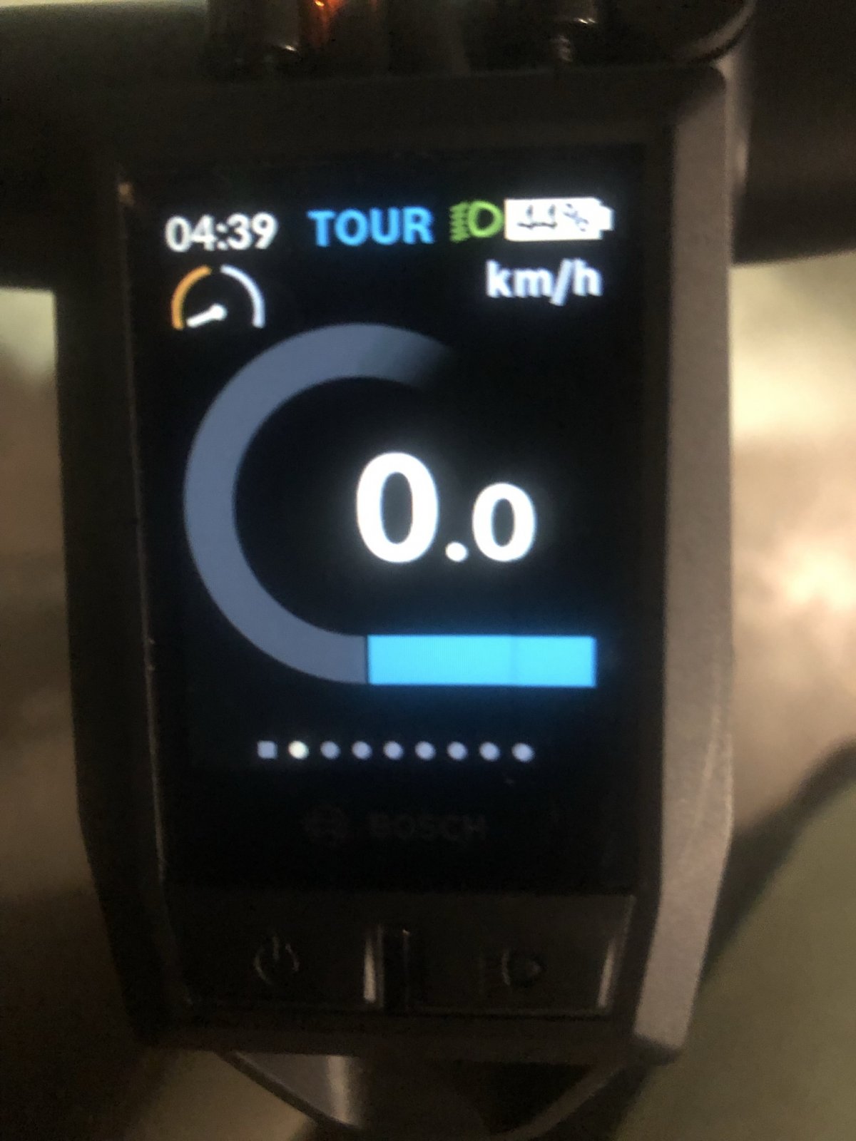

So had my update - the store had no idea what this new update was (the comment I got was "if there's a new update on the server then thats the one you'll get") but thankfully it was available.
First impressions (bearing in mind that I'm going from the original 75nm setup): Tour+ feels like its designed to keep the power in the lowest setting as much as it can and once you start to push then it puts the motor in the level of what Tour would have been and I only felt it go higher if I was really pushing hard whereas EMTB feels more willing to go to higher modes more freely. On top of all the updates (85nm etc) it did feel more instant than before. I'll get some good riding in at the weekend so properly see what this does to my riding.
Interesting as I just picked up my new bike, and I asked bike shop the same question, “does the bike come with tour +” the answer was the same, if the Sw is available then that’s what I’ll get. Question how do I know if I’ve got Tour+ does the kiosk tell me?
Tour+ replaces the Tour mode but only shows as Tour on the screen. That will most likely not change until next year.
How do we know if we have your+, is there a SW version to look out for?
I would say that you have to have Drive Unit software version 1.1.5.0 or newer AND then the one who updates it, tells you that you have it. Tour+ is just one option among other things when you choose what version you update your bike.
There must be something fundamental that restricts to change text in Purion screen. I wonder what Kiox and Nyon MY21 shows?
I have that SW version. It’s a shame it’s not easy to tell either way. Thanks for the reply.

I went to my bike shop yesterday and got the latest update. The guy in the shop didn't know what I was talking about when I mentioned Tour+ mode. And when I biked home I didn't notice any difference at all in Tour!!
I have version 1.1.5.0
The only difference I notices was a small difference in the Kiox display, where there is a small fuel gage in the top left which wasn't there before. Not sure what that is measuring.
Does the guy in the shop have to explicitly select the Tour+ for me to get it??
I think so. You can basically select if you want tour or tour+ configured on the bike.
Grrr, means I have to go back then.
Mine was in for a service last week and the guy at the lbs said it wasnt even available yet. As suggested by others to me on here, it could be that your lbs simply hadnt downloaded/accessed the latest updates so possibly werent aware of the update?!?
In my case, i didnt want Tour+ so it wasnt a problem thankfully.
yes, when they set up the computer to download the software they have to select; eMTB- lite or Tour +. If they don't it will default to the standard tour. I had to go back and tell the LBS Tech that I really digressed to standard tour (because its weak to say the least). If you have had the regular tour mode and then eMTB-lite you will know if you have the Tour +....there's a major difference. Also, the LBS that say, "it isn't available".....tell them to contact their Bosch Rep and they will inform them how to access the New Tour + that was released world wide on July 14th 2021.

The kiox display does not change. The mode is still called tour . There is no space on that screen for another letter. I don’t know if the pirion display changes?
As soon as you ride the bike hard in tour you will be able to tell if they have selected the mode feature for your bike.
As written in post #54 the job of adding the new feature is not just as simple as downloading the update.
