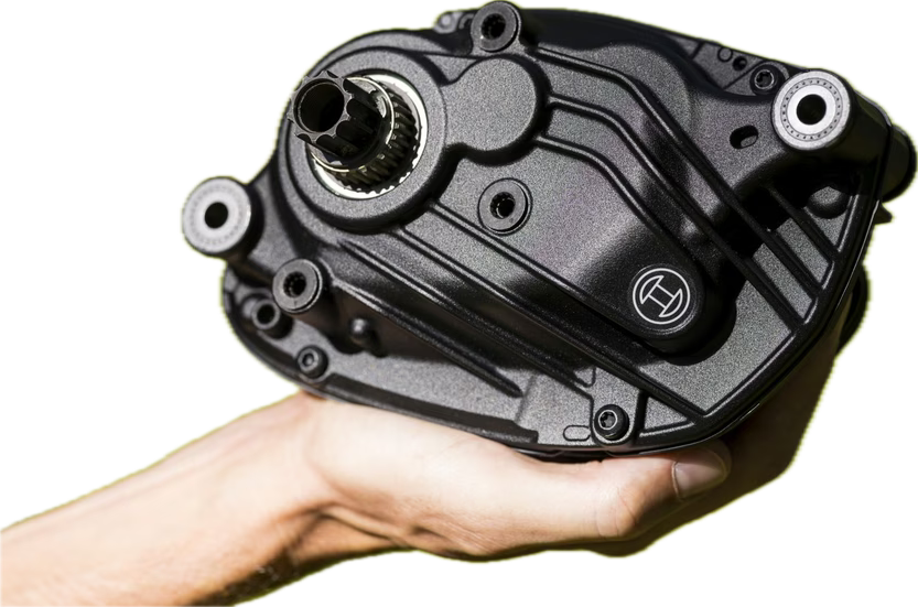

I took the below snip from a video on the Gen 5. It actually looks to be a gen4 motor with a pair of mounts to bolted on to suit the gen5 two-bolt profile?
That’s a GEN4 with the standard mounting brackets attached, you can see the 3 threaded holes on that side. 6 screws thread into the 4 brackets (2 brackets each side).
That is a CX Gen4 motor in the video.

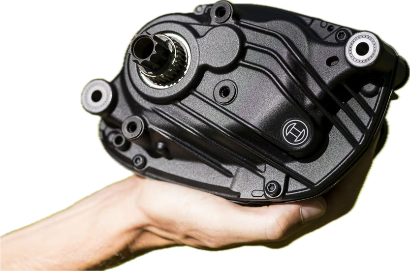

The CX Gen5 looks like this
Notice it only has two mounting points vs. the three on the older generation.
Thanks Shark. So is it possible to mount the gen5 motor in a bike with mounts for gen4, using some adapter plates?
I think the answer to that is almost certainly no. In other words no.
