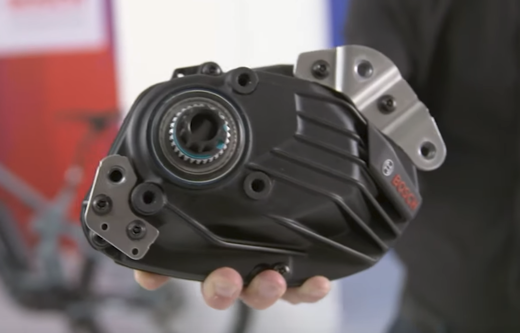

Has anyone seen any commentary around placement of a Gen5 CX in a Gen4 CX mount?
I took the below snip from a video on the Gen 5. It actually looks to be a gen4 motor with a pair of mounts to bolted on to suit the gen5 two-bolt profile?
Full video here. There's no comment on the mount though, just saw it in passing in the first 6 seconds.
Thoughts?
