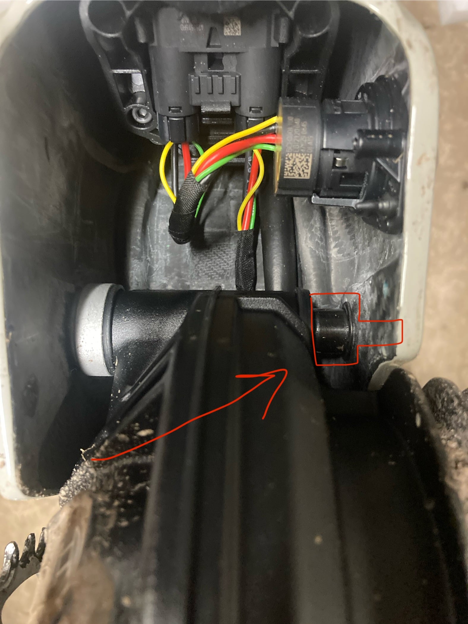

Hi there, my first time posting anything anywhere but I feel this is important. Not sure if this is the correct place to post this but I have a vala x01 and after two rides I could feel the motor moving through the pedals. Further investigation revealed the non drive side bushings were moving in the frame to the extent the drive side of the frame would not of been long before breaking.
I contacted my local bike shop and went to look at a brand new bike only to see same problem. It seems someone has messed up and all the motor mount dimensions and the holes in the frames are drilled/formed too large for the bushings. I am 5 weeks in and still nothing been done under warranty.

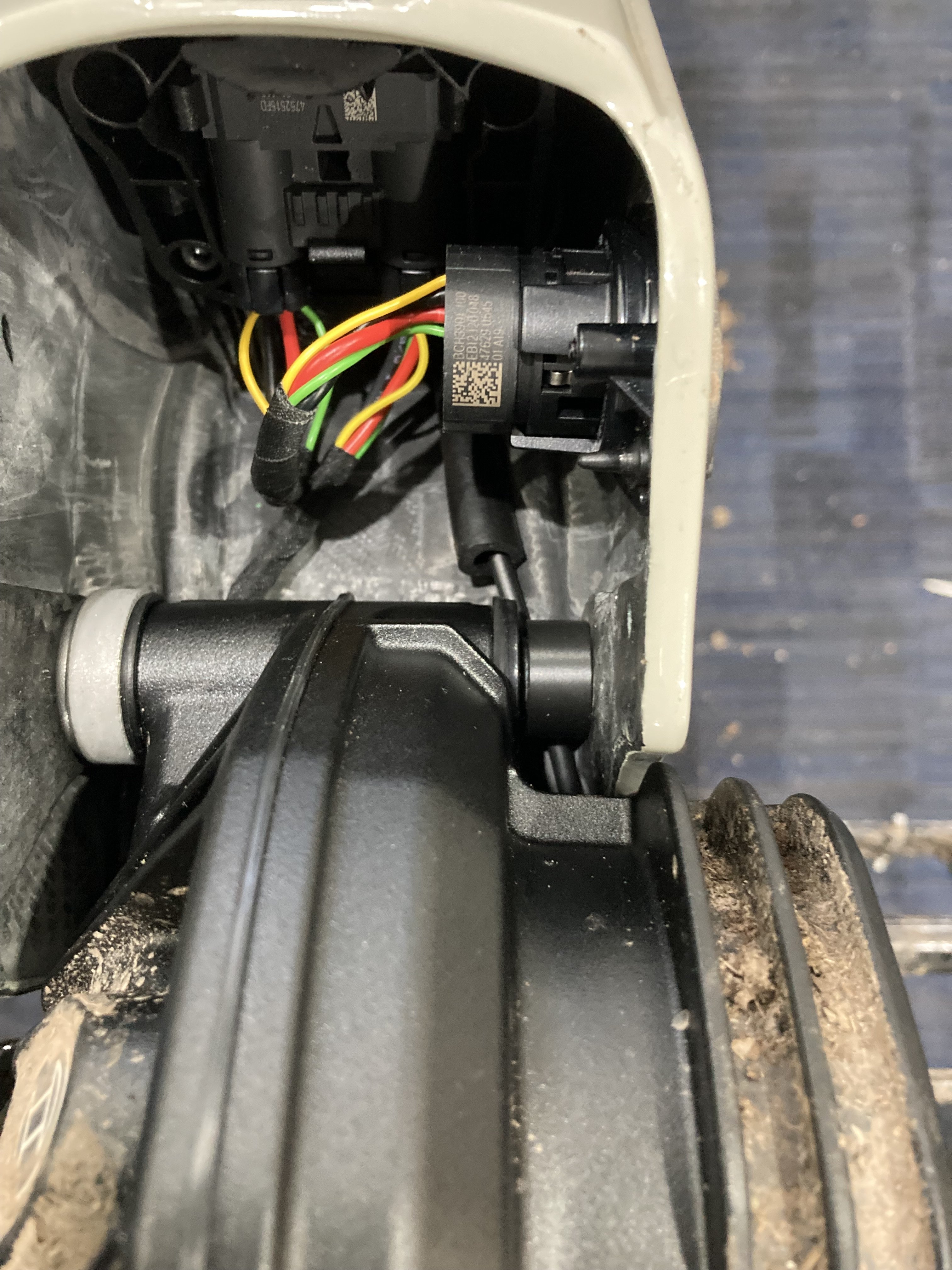

Rather than send the bike back as not fit for purpose as I quite like it I have had my local engineering place make new bushes out of acetal. They are tight fit and larger diameter on inside so can only be fitted from inside with motor removed. This eliminates the bushings being able to come outwards. I also had the bushings made so they have a 0.5 mm tolerance laterally instead of floating so to help with lateral strength from a pedal strike as the non drive side frame can now share the loading. The main mount has a rubber busing inside so motor is still not held still and can move on the Bosch main mount as designed.
We used a couple small o rings to centralise the square threaded plate drive side as holes that side were a joke. We torqued everything up to 20nm as per Bosch spec and having done 70 miles of enduro type riding all is well.
Please see pics below of what we have done. As you can see the Bosch bushes are like new and are correct diameter it’s the frame that’s the problem.
I’m not moaning about the brand as things go wrong but this is an easy fix and hopefully will help someone sort this out.
Just a note from an above post the original bushes should be fitted from the inside so if they are coming out they are scrap and more likely the frame is the same as mine.

Good morning, I’m sad to hear another Vala with same issue although not surprised.
I have over 500 miles of enduro riding on my bike since we put the modified bushes in and as expected I have had no issues.

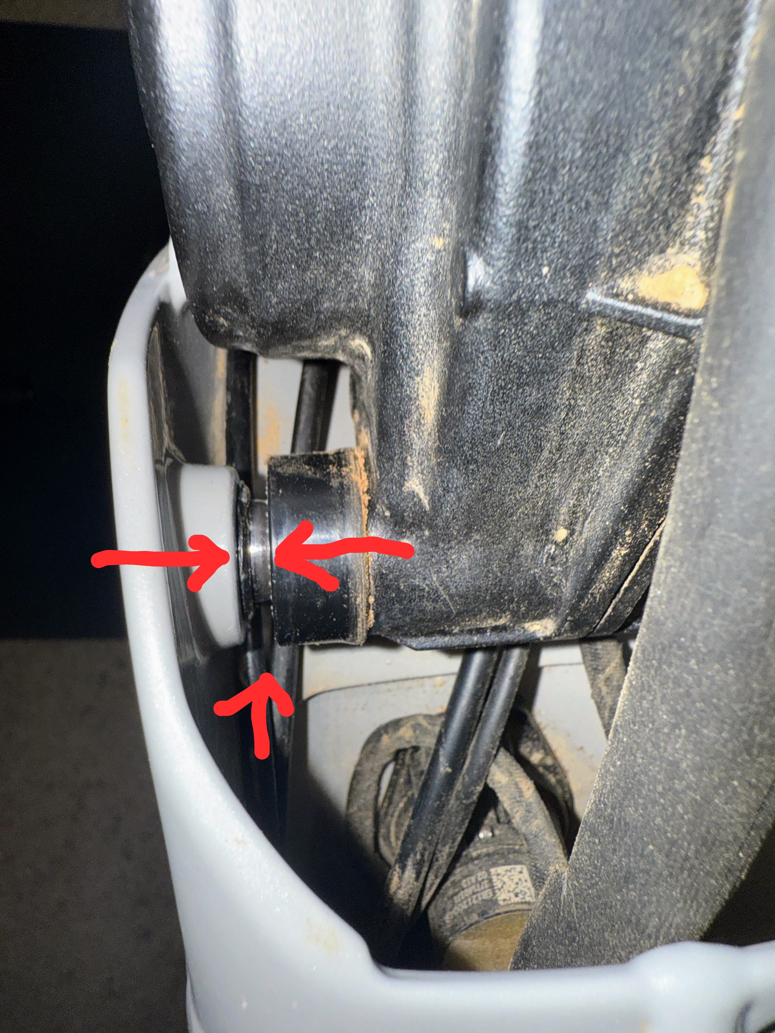

I also had this problem and have already replaced the original bushings.
The bike is a Cube hybrid One 44 HPC and I am not very aggressive when riding, no jumps or anything like that.
The front screw bushing came out again. :(
800 Km and two bushings / sleeves...

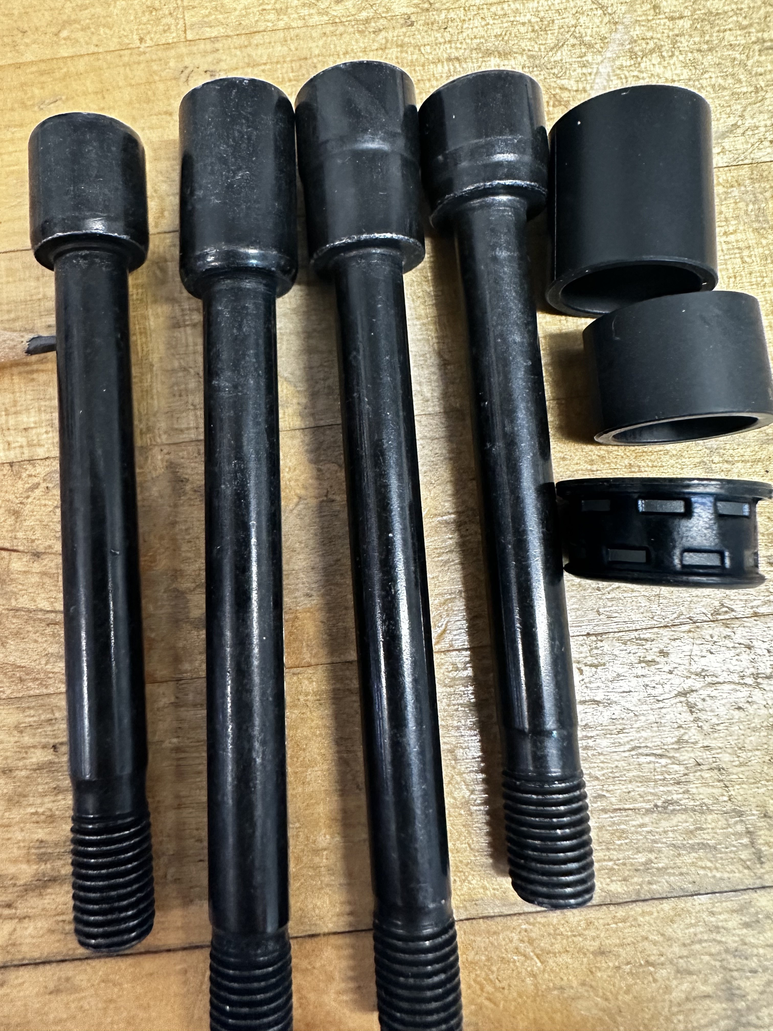

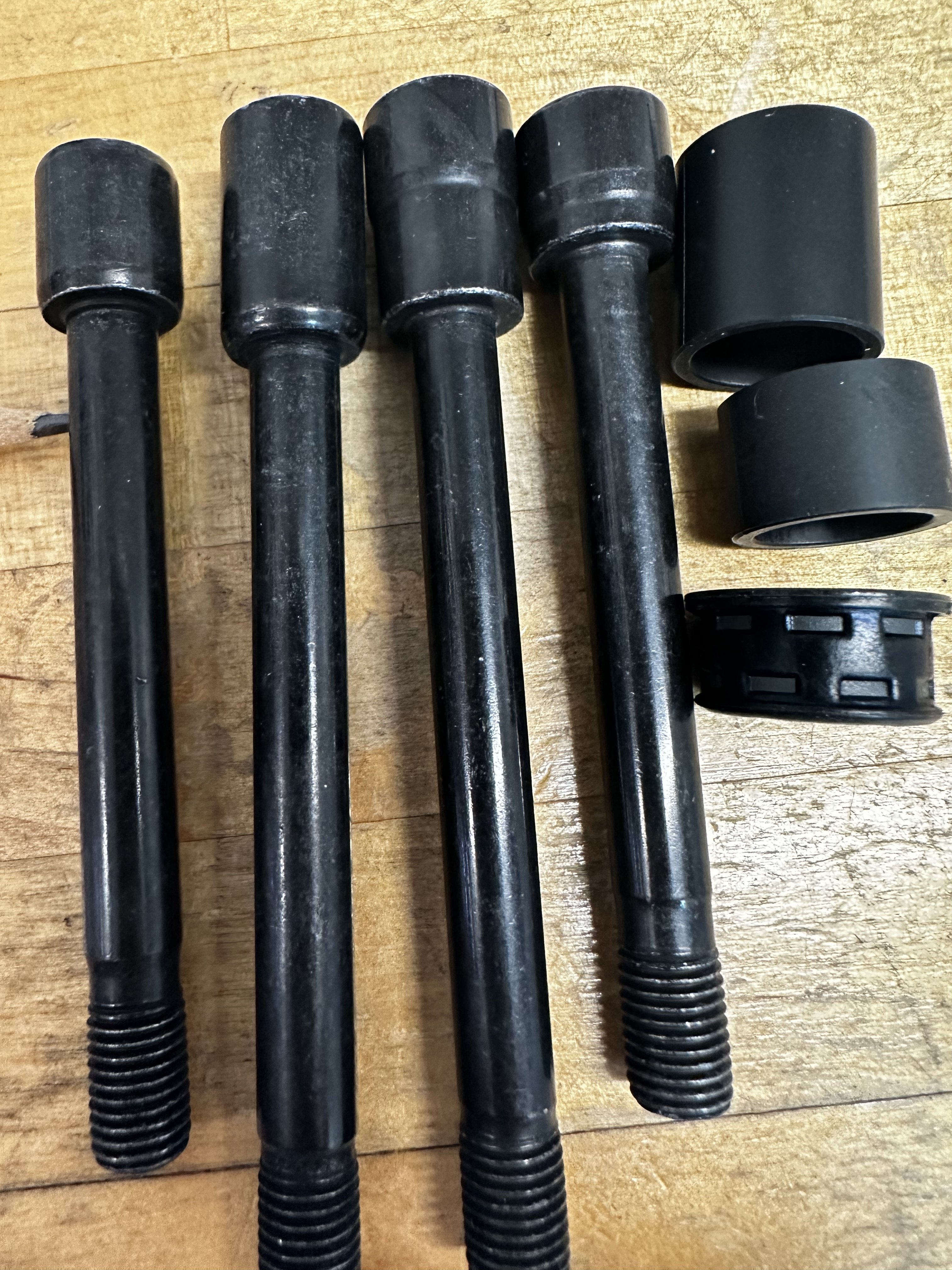

I did get a set of those latest bolts and plastic sleeves and ended up installing the new version bolts to my existing bushings that seemed ok.
And problems solved.
No more play and no more creaking sounds.
My vala is happy now and I have been riding hard.
Happy Monday

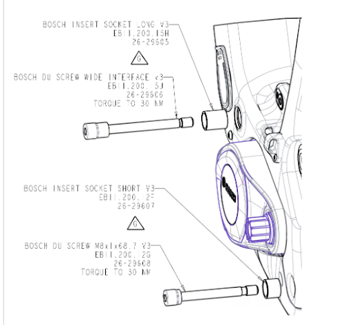

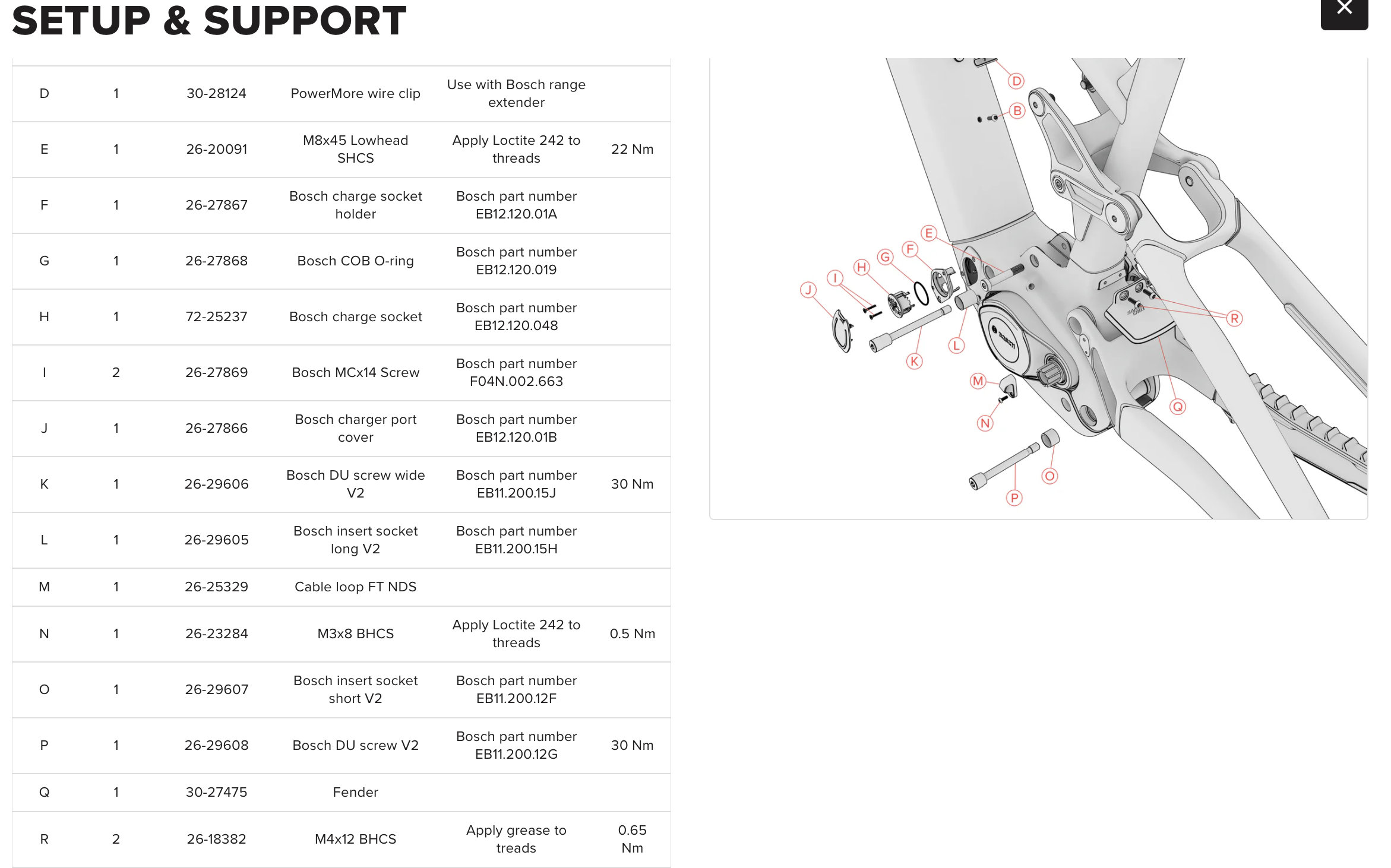

According to the SantaCruz website, under any of the Vala bikes and there setup & support - exploded diagrams (vala-x-0-axs-rsv-2026) you can find these bolts and sleeves specified as V2 for the aluminum frames. For carbon frames they still specify the old bolts and sleeves.

Well, here is my Vala (carbon) story.
I bought it brand new.
On ride 1 I noticed play on the motor and a creaking sound when pedaling.
I took it to my LBS which is a Bosch certified location and they called Bosch and Santa Cruz.
They both said that a flex was needed to help with the torque.
However it was excessive in my opinion.
So we left it alone.
My bushings never fell or were even loose.

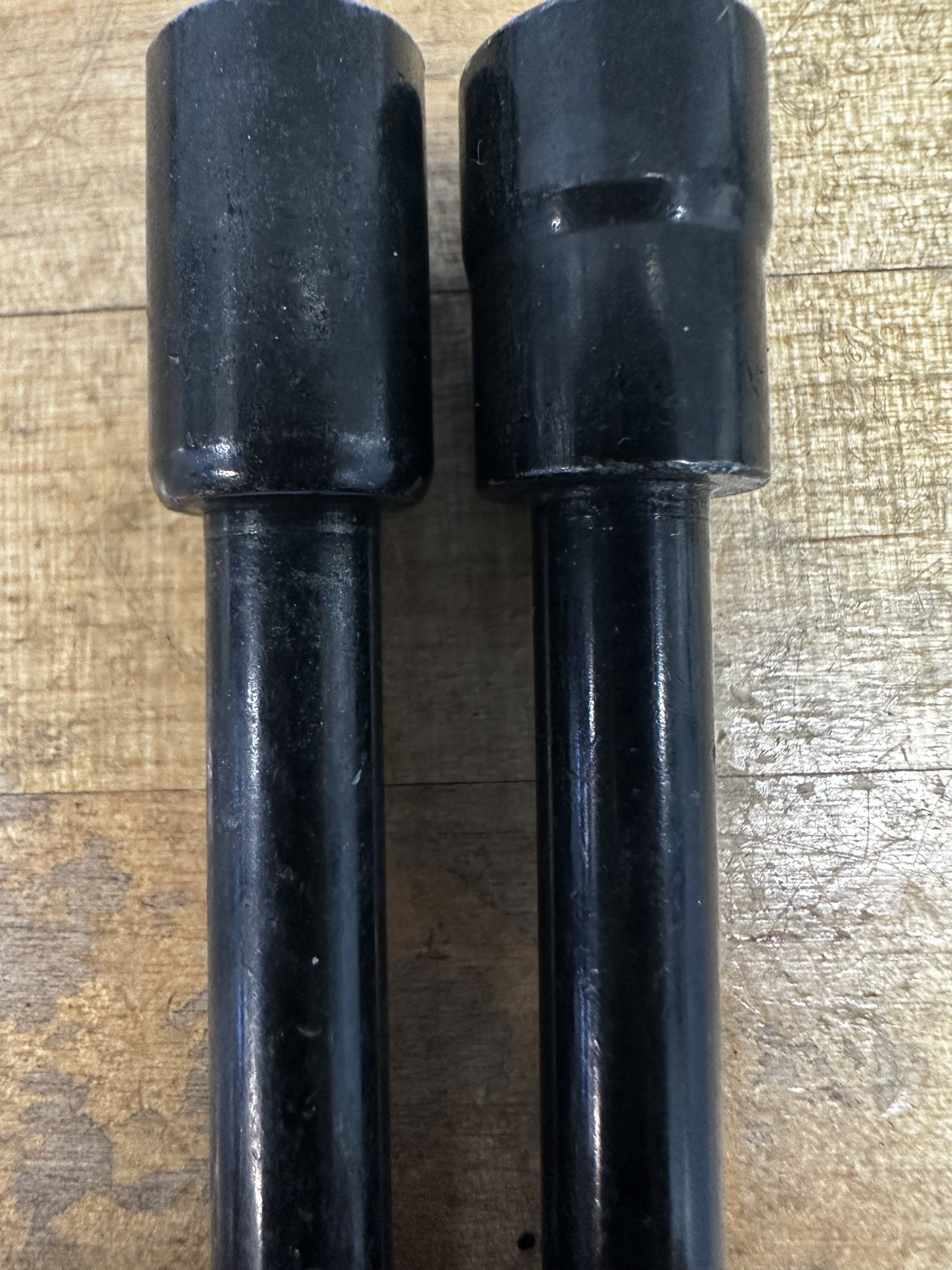

The play was between the heads of the bolts and the inner parts of the frame bushings. Very clear.
So I contacted SC myself and they sent me those updated bolts and plastic shims. The ones on that image.
However when installing, I compared and measured the heads of the old vs new bolts. And the new bolts are bigger.
I tested with everything in place but with the new bolts, and everything was solid.
So basically I only replaced the bolts. That’s it.
My motor is solid now.
I am sure there is some interior flex in the design that I can’t feel with my fingers.
I have now a few hundred miles on the bike and it’s stilll solid.
Very happy.
I kinda knew that being a new bike with a new motor, there was going to be some time for both companies to get the right hardware developed.
And I was very frustrated as well. I understand.
I would try those new bolts and give them a shot.
I hope this helps.

@RN611 was correct. I measured the diameter of both the old and new bolts and the new V3 bolts are .022 larger in diameter. This would definitely create a tighter fit using the original DU bushings. SC provided me with the V3 installation image. Effectively the plastic sleeve gets pushed into the frame and when you tighten the bolt, it expands the plastic sleeve into a press fit in the frame. Not sure if these sleeves are one time use or not. I also am going to try just using the V3 bolts and if that does not work then go full V3 bolts and sleeves
