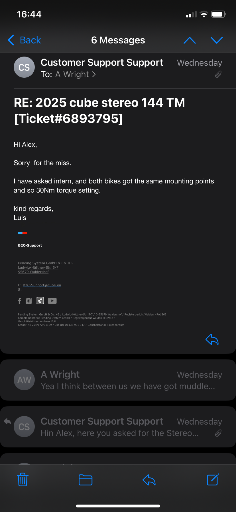

Apologies, I was looking at the settings for Cube
Hi cube also state 30nm 😊
Although admittedly that does feel very tight! Might be worth going 25nm with a little bit of lock tight.
Please not this is only for the 2025 generation 5 motor.
Hope this helps

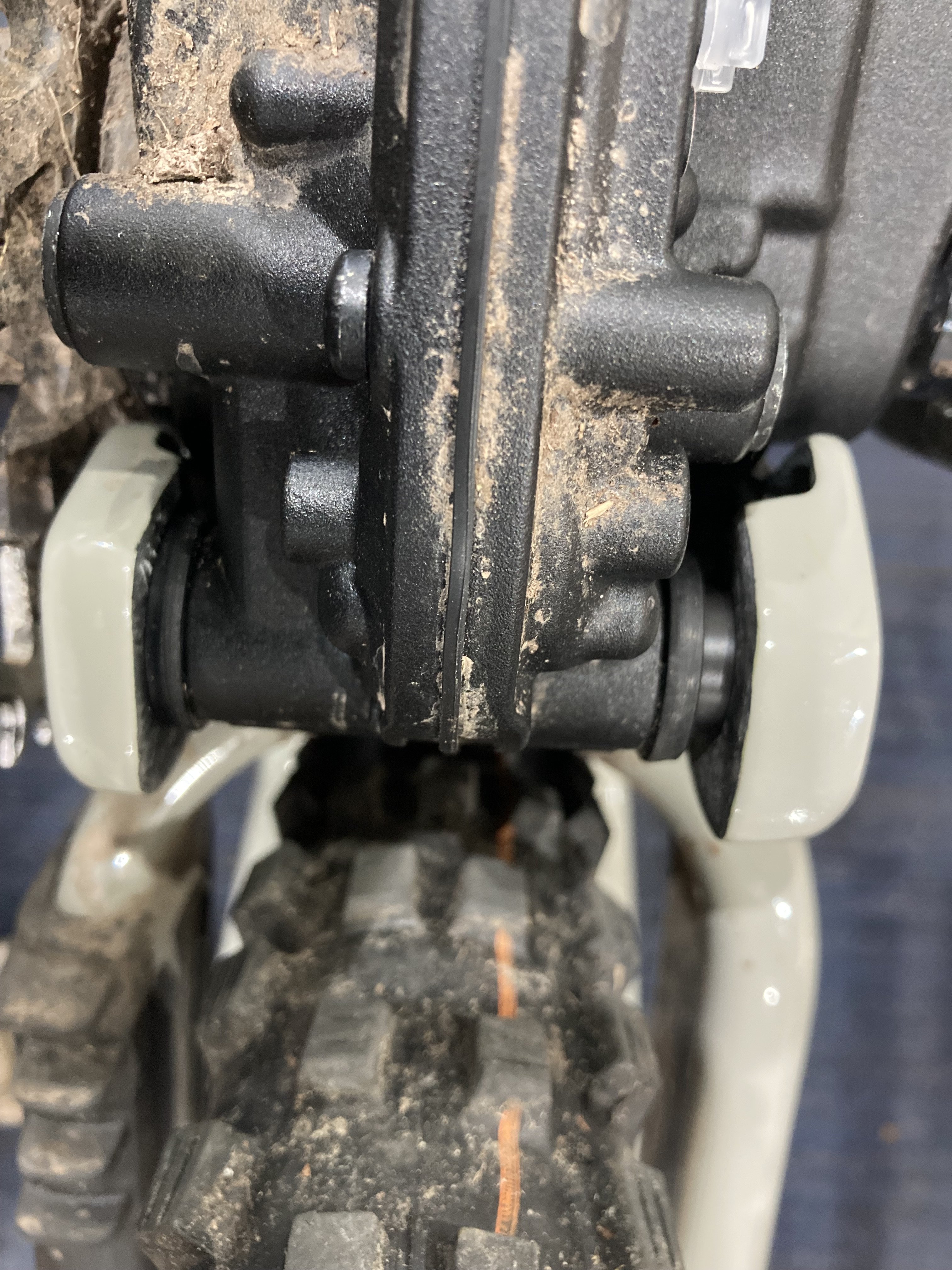

Hi there, my first time posting anything anywhere but I feel this is important. Not sure if this is the correct place to post this but I have a vala x01 and after two rides I could feel the motor moving through the pedals. Further investigation revealed the non drive side bushings were moving in the frame to the extent the drive side of the frame would not of been long before breaking.
I contacted my local bike shop and went to look at a brand new bike only to see same problem. It seems someone has messed up and all the motor mount dimensions and the holes in the frames are drilled/formed too large for the bushings. I am 5 weeks in and still nothing been done under warranty.
Rather than send the bike back as not fit for purpose as I quite like it I have had my local engineering place make new bushes out of acetal. They are tight fit and larger diameter on inside so can only be fitted from inside with motor removed. This eliminates the bushings being able to come outwards. I also had the bushings made so they have a 0.5 mm tolerance laterally instead of floating so to help with lateral strength from a pedal strike as the non drive side frame can now share the loading. The main mount has a rubber busing inside so motor is still not held still and can move on the Bosch main mount as designed.
We used a couple small o rings to centralise the square threaded plate drive side as holes that side were a joke. We torqued everything up to 20nm as per Bosch spec and having done 70 miles of enduro type riding all is well.
Please see pics below of what we have done. As you can see the Bosch bushes are like new and are correct diameter it’s the frame that’s the problem.
I’m not moaning about the brand as things go wrong but this is an easy fix and hopefully will help someone sort this out.
Just a note from an above post the original bushes should be fitted from the inside so if they are coming out they are scrap and more likely the frame is the same as mine.

Looks like a neat fix my only concern would be are the bushes not designed to flex?
I am awaiting on some bolts and if they arrive how they look in the photo will be a permanent fix.
Hi, nothing has changed in terms of flex as when the motor is as per Bosch/santa Cruz fitment the motor is held tight to drive side and the motor has flex from a large rubber bush inside the main motor carrier mounting bush. This is still the same. With the factory Bosch non drive side bushes fitted properly to the frame there would be very little movement as they are rubber coated and a metal bushing is under the thin rubber. Mine are acetal which is similar to nylon and can be used as a bearing surface and is self lubricating to a degree. Any movement here is only flexing the non drive side of the frame and this is not ideal. The bushes non drive side don’t need to have any flex as long as it has a little lateral float the main motor bush deals with any flex the motor requires.
I’ve not tried to re-engineer the design I’ve just rectified the fact the frame holes are too big for the Bosch bushes.
You said you have some bolts coming and I’m not sure what your plan is but I don’t think you should sandwich the whole assembly as per other motor makes. My changes keep the fundamental design the same as to what Bosch must of tested to be reliable.

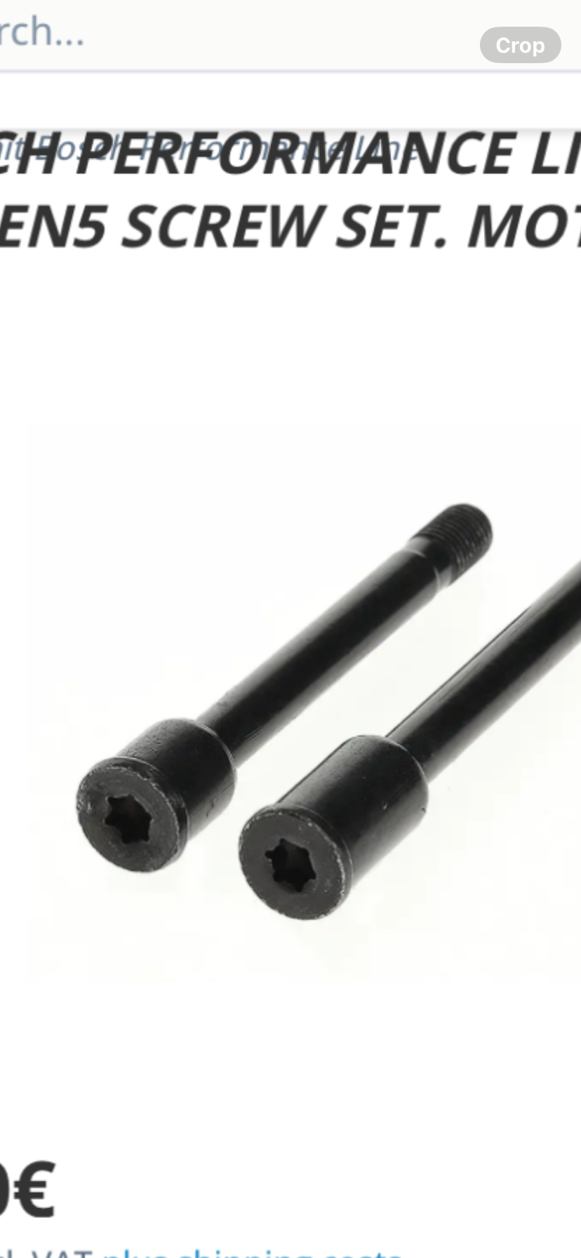

Sounds like a decent fix I’ve ordered a set of these from Bosch but still waiting for them to arrive if they have a shoulder on them like in the photo it will 100 percent fix it! But who knows what will actually turn up
Just to confirm — I ordered the same set last week hoping it had the shoulders like in the photo… unfortunately, it arrived today and it doesn’t. Bit of a letdown.
Yea same I’ve ordered two sets and they aren’t like in the photo just standard motor bolts!

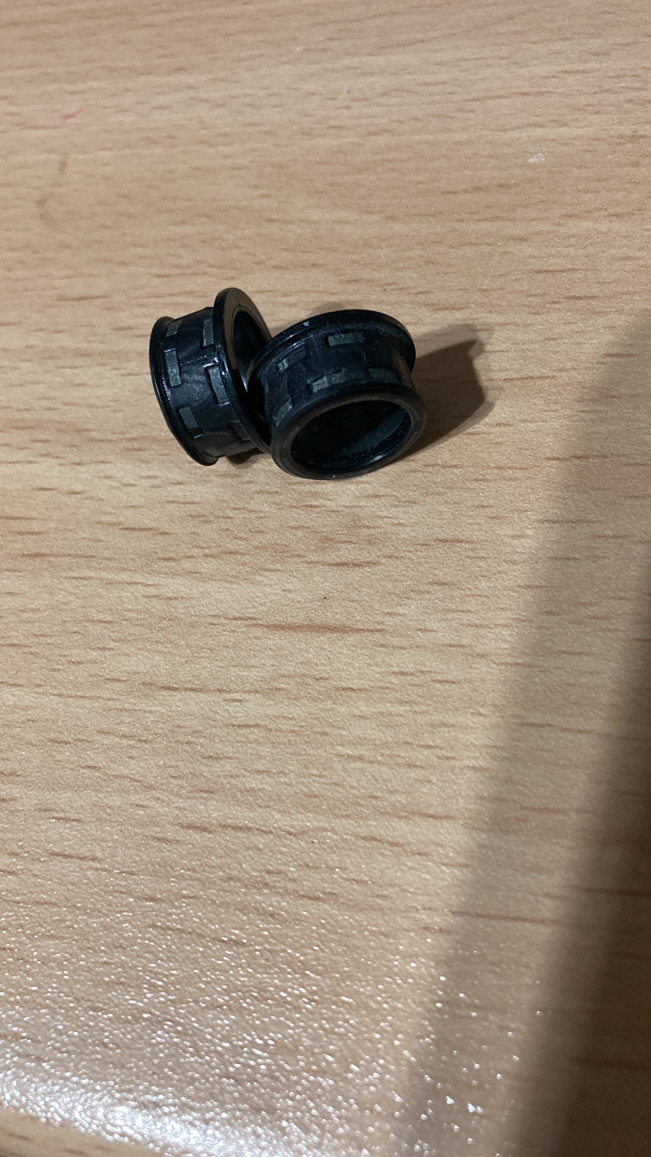

Can you post a photo of the bush that has fallen out?

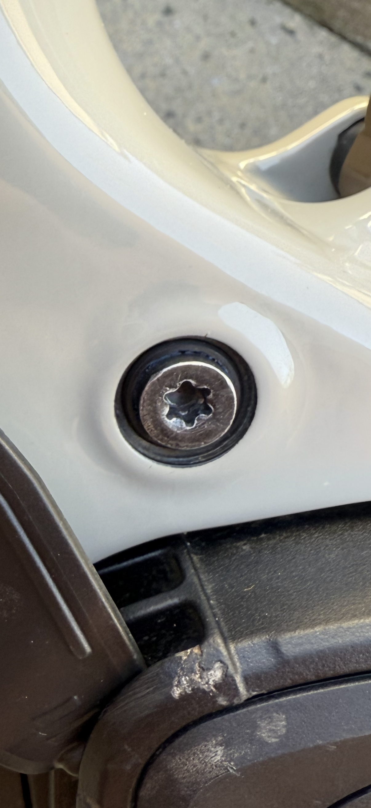

I really like the bushings you came up with, even if the rubberized bushings are in place correctly. I am not fond of the stock design where any flex means flexing the frame. Even small movement in the bushings means some amount of twisting the carbon frame on the other side.
Do you have photos from the side showing the mounting bolt head?
