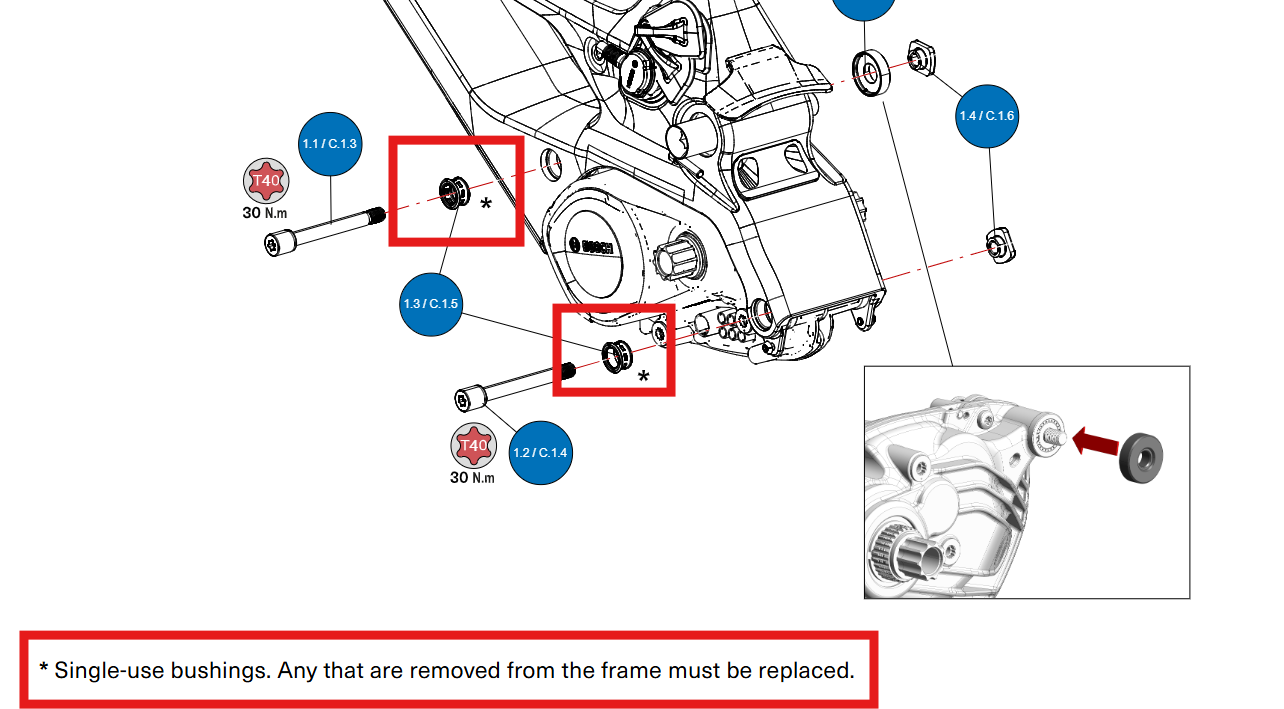

I don't know if it's possible to replace shifting cable without dropping the motor. I guess least older models there was some zip tie on top of motor. Dropping motor would for sure make this all easier.

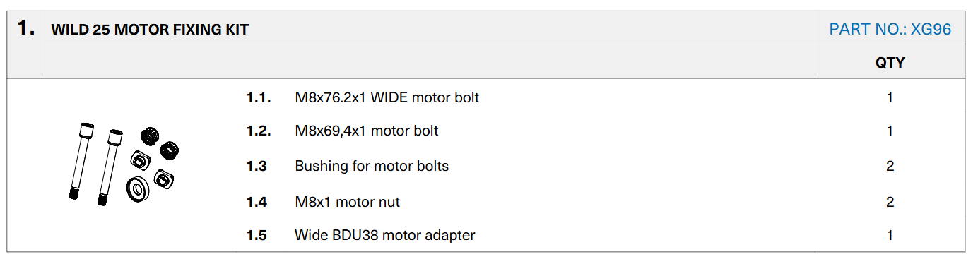

Blue book tells to replace the bushings if "removed from the frame". Do I need to remove these from from frame when motor is dropped? Are these Bosch or Orbea parts? As Orbea sells these only with Motor bolt kit, about 50eur, and new bolts etc are not needed anyway

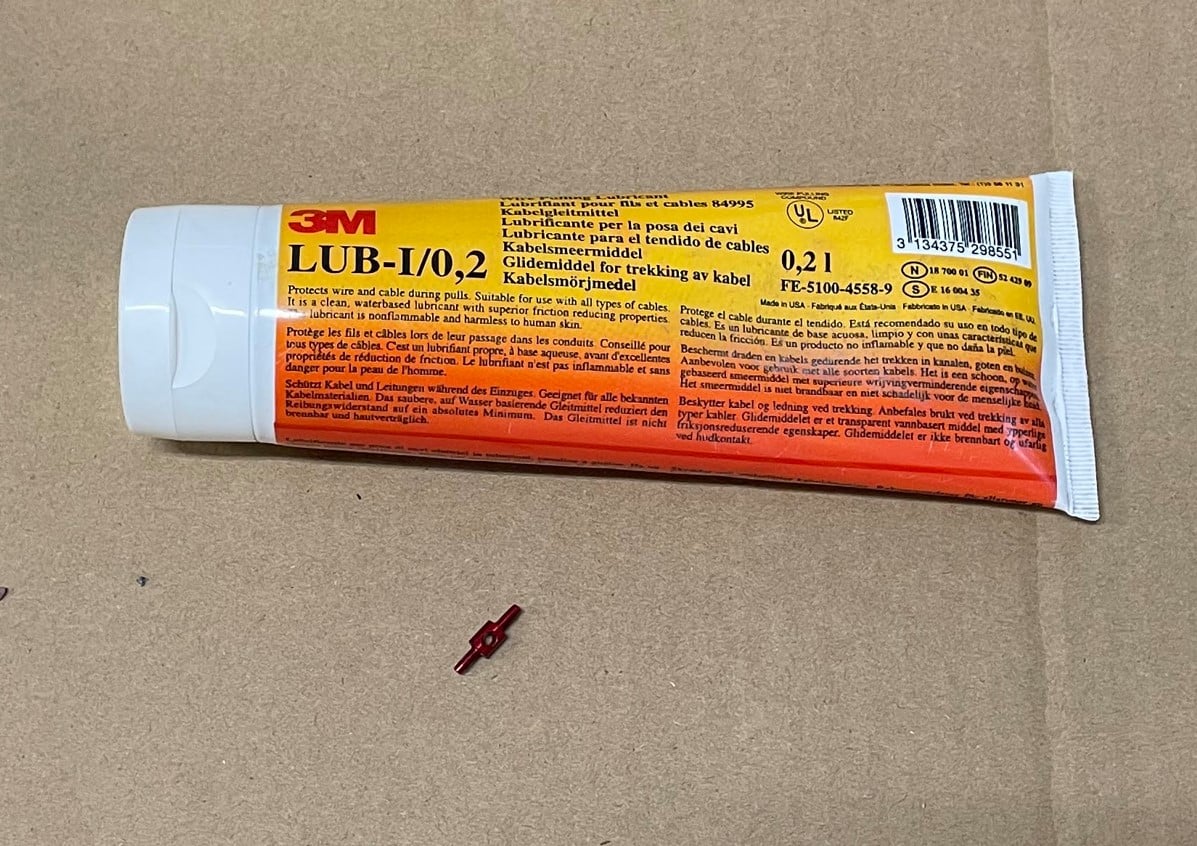

Now done, it was completely possible to replace the outers without dropping motor. Brake hose did slide easily, derailleur outer was more tight, but just possible.
The Rockshox Reverb tool was again priceless, 3M wire pulling lubricant LUB-I is good stuff for this. There may be also other type of skin friendly lubricants that are suitable :ROFLMAO:
I'm thinking of doing this, really want to put TRP EVO DHs on my '25 so that I can swap out wheelsets with other bikes in the garage that have the slightly thicket TRP rotors on them (and well because I prefer them). Did you drop the motor or just use lube and Reverb tool? For my '22 Rise, people had said this could easily be done but my bike had a zip tie up in there and it was impossible without dropping the motor.
I didn't drop the motor. With Reverb tool and lube, the brake hose was extremely easy. I did also derailleur and dropper outers, those was more stiff, but still doable without dropping the motor.

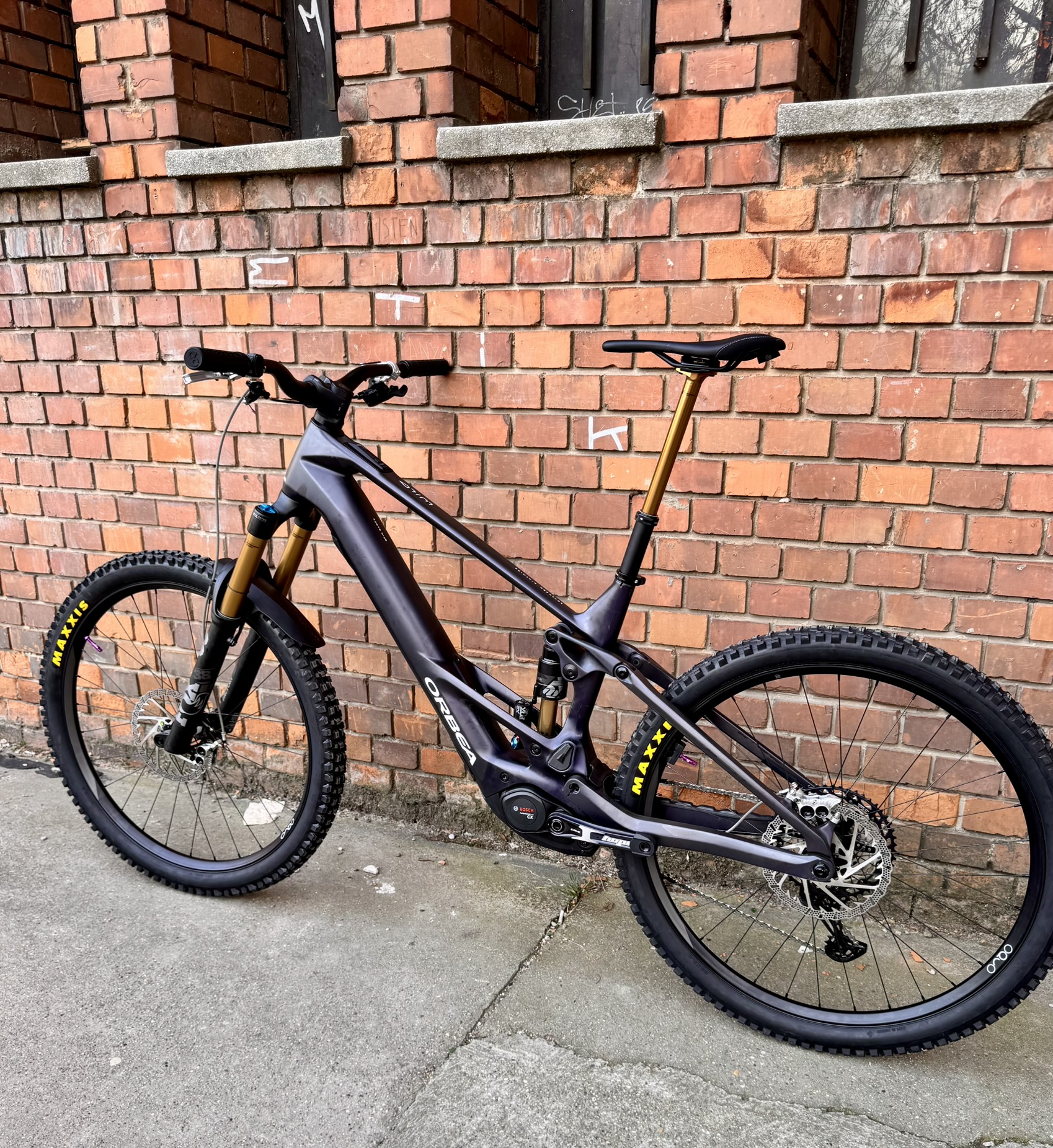

My 2025 M20 was 22,74kg. Size M, without pedals. Factory options 600Wh battery, Fox 38 performance fork, DH casing tires, 200mm dropper and MC11 stem.
Now it is 20.86kg. XTR drivetrain(XT cassette) and brakes, SRAM XX cranks, OneUp carbon bar and dropper, DT carbon wheels and Schwalbe radial tires.
It is soo good🥰
With Maxxis DH casing tyres exactly +300g, compared to Schwalbes. It would be quite easy to build it under magical 20kg without too big compromises. Especially as mullet.
