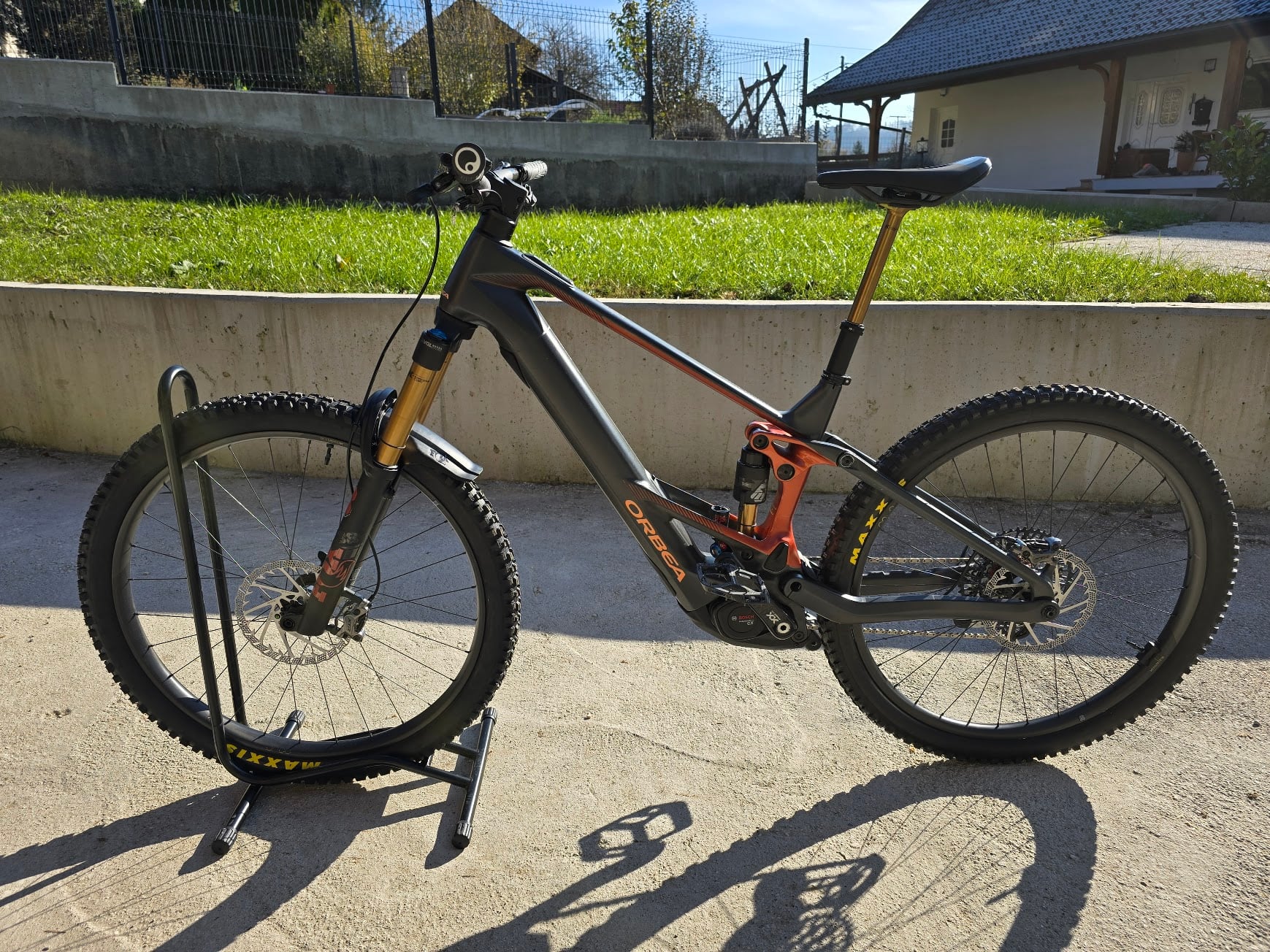

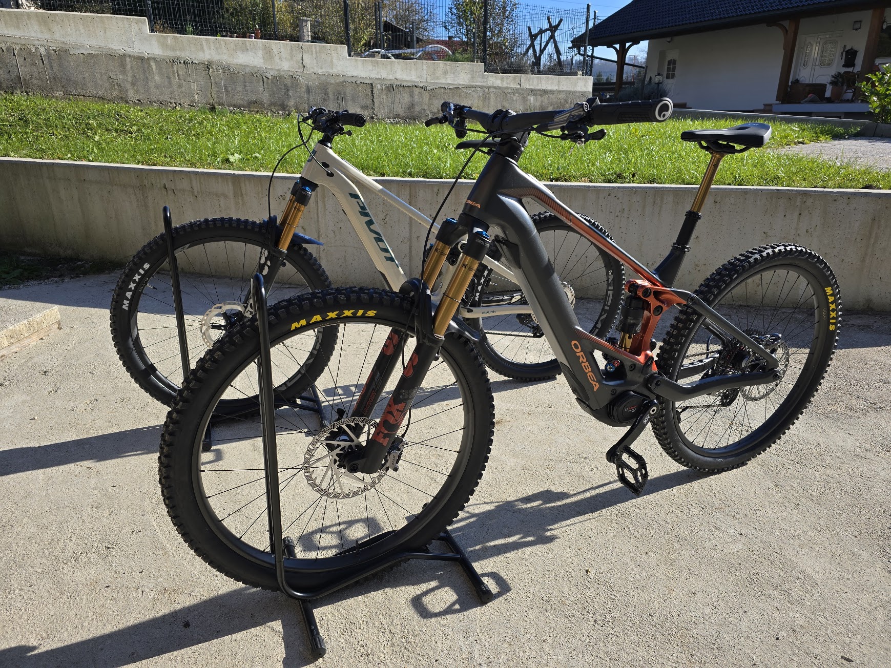

Finally, after months of waiting ... the bike is absolutely awesome :cool: 🤙
That looks sick! I'm in the market... Until just 3 nights ago I had an M10 with factory upgrade fork and coil shock, but some dickwad decided they needed it more than me and stole it. Custom paint, pretty recognisable so I'm not sure what they'll be able to do with it... But hey, that looks mint and probably what my insurance will be going on
