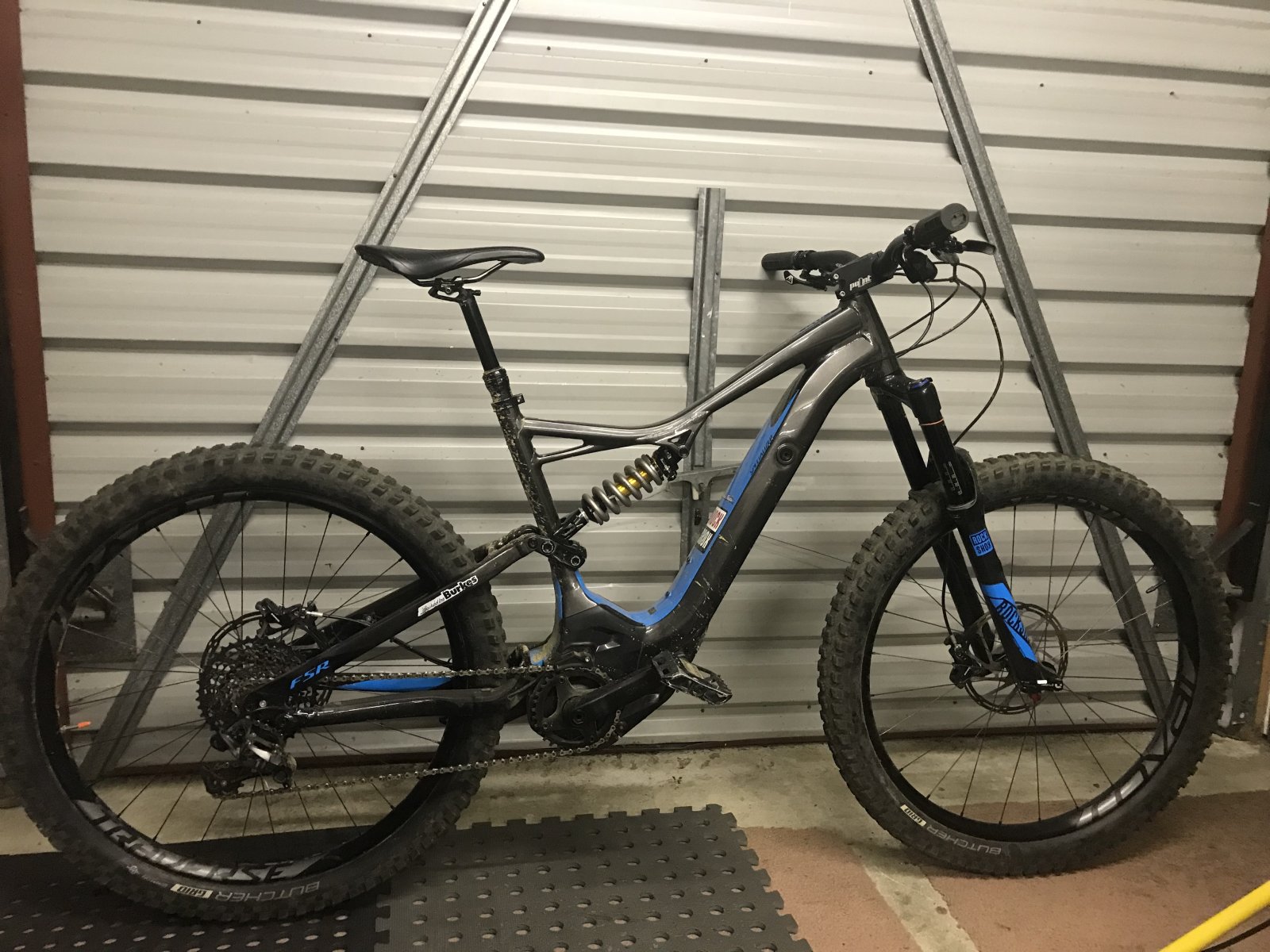

I am new to the forum... I thought I would add a couple of pictures of my steed!
It started life as a basic 2018 Levo Comp, this was my blank canvas :)
Upgrades:
Fox 36 Fork
Cane Creek Dbinline Coil (550lb Spring)
Trp Slate GWin Brakes
XT 1x11 Groupset
Lyne Components 150 Dropper
Easton Havoc 50mm Stem
Fabric Seat
Front Wheel - 29 Easton Arc 30mm Rim - Spez Butcher 2.6 Tyre
Rear Wheel - 27.5 Std Roval 38mm Rim - Spez Butcher 2.8 Tyre
504 WH Battery Upgrade
Great bike............ really enjoying it!!!

Hi Theolegit
Very much, the suspension has made the biggest difference, it feels bottomless and punches way above its 140mm rear travel!
I cant believe the difference the coil has made to the bike and also the amount of adjust ability the Cane Creek gives one.

Thanks for the compliments! I will upload some more pics over the weekend.
The Cane Creek is an easy install, you need to order the 190 x 50 with a new yoke from Bike Yoke. In the UK TFTuned is your best option or direct from BikeYoke.de in Germany......... Setup has been interesting, I ordered a 450Lb and 500Lb spring according to their website I should have been good but have found i'm running near max preload to get around 33% sag.... I have ordered a 550Lb spring which I will hopefully get within the next couple of weeks. I have just less than 140mm on the rear and running 160mm on the front.
Running the bike with 160mm and 29 front wheel has made the bike tend to understeer a little but its a worthy sacrifice for the increased roll-over and also the increased BB height which has helped allot with pedalstrikes!
Using my phone.... My HA is bang on 65deg, great sweetspot!
For our local skills/jump parks I put the 27.5+ front back on, it is better balanced in the air with the smaller front wheel.
I also run the bike with a 29 (2.3 Onza Ibex) rear wheel for gentler trail rides, it does carry speed allot better.
I also have to say how chuffed I am with the TRP brakes, I had Saints on back-order and took a flyer on the TRP's.... for the price they cant be beaten!
They have held up to multiple downhill runs with no fade. I can recommend them!

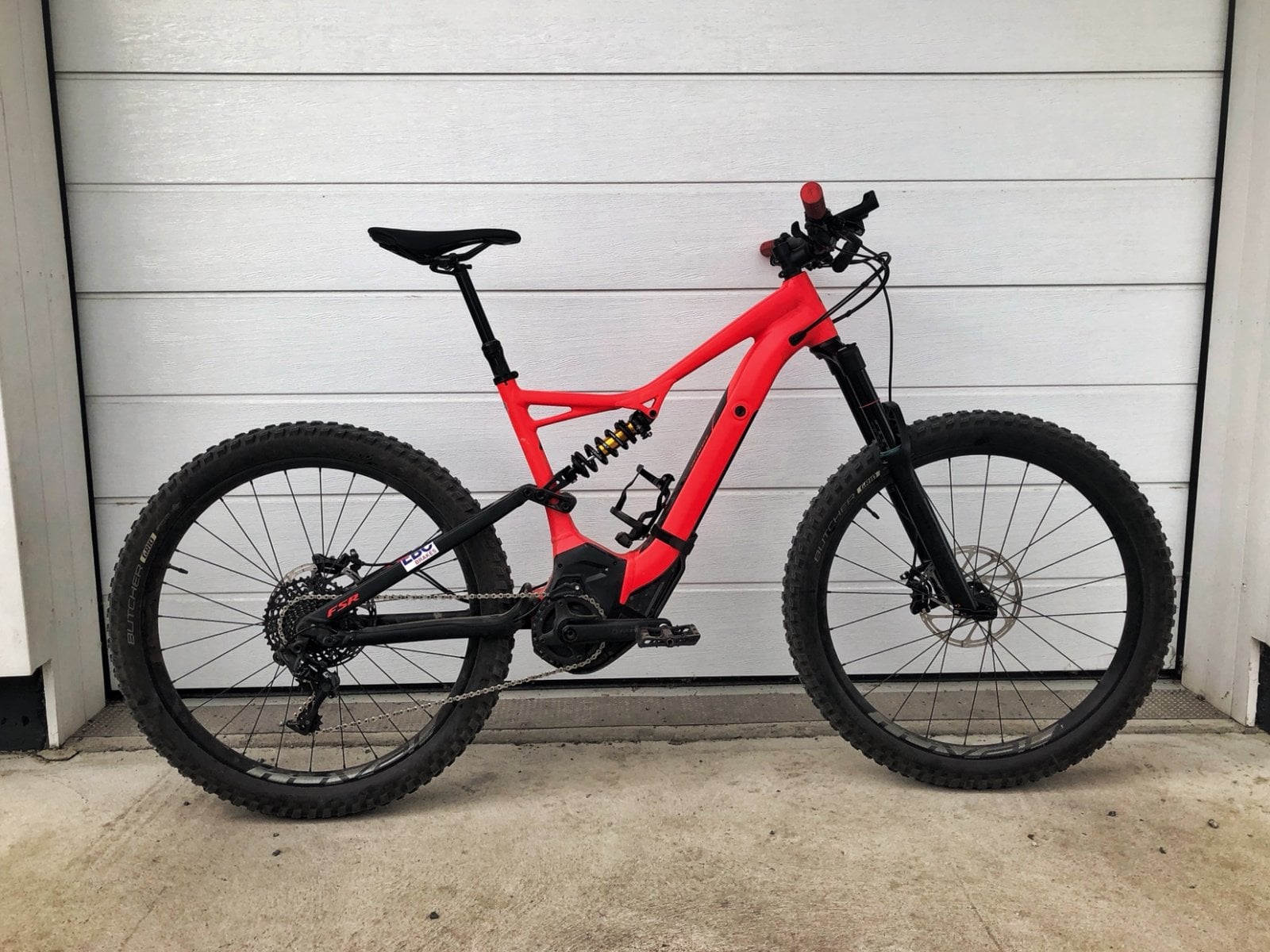

First message to the forum - greetings from Finland.
Out of curiosity, how much do you @Mambat weigh (with the riding gear)? I also have CCDB coil IL on my Levo with 600 lbs/in spring and I get roughly 28 % sag with no preload (well, a half a turn just to remove any slack). I weigh 87 kg with gear (~191 lbs for any SI-system limited ;) ).
I ordered just today 500 lbs and 550 lbs springs to test them out, as I’d like have 30+ % sag and a tad more plush setup.
On the front I have RS Revelation, but it’s basically a 2019 Pike as I have upgraded it with Charger 2 damper, 2019 model DebonAir spring (160 mm) and SKF seals and I couldn’t ask for more from it.

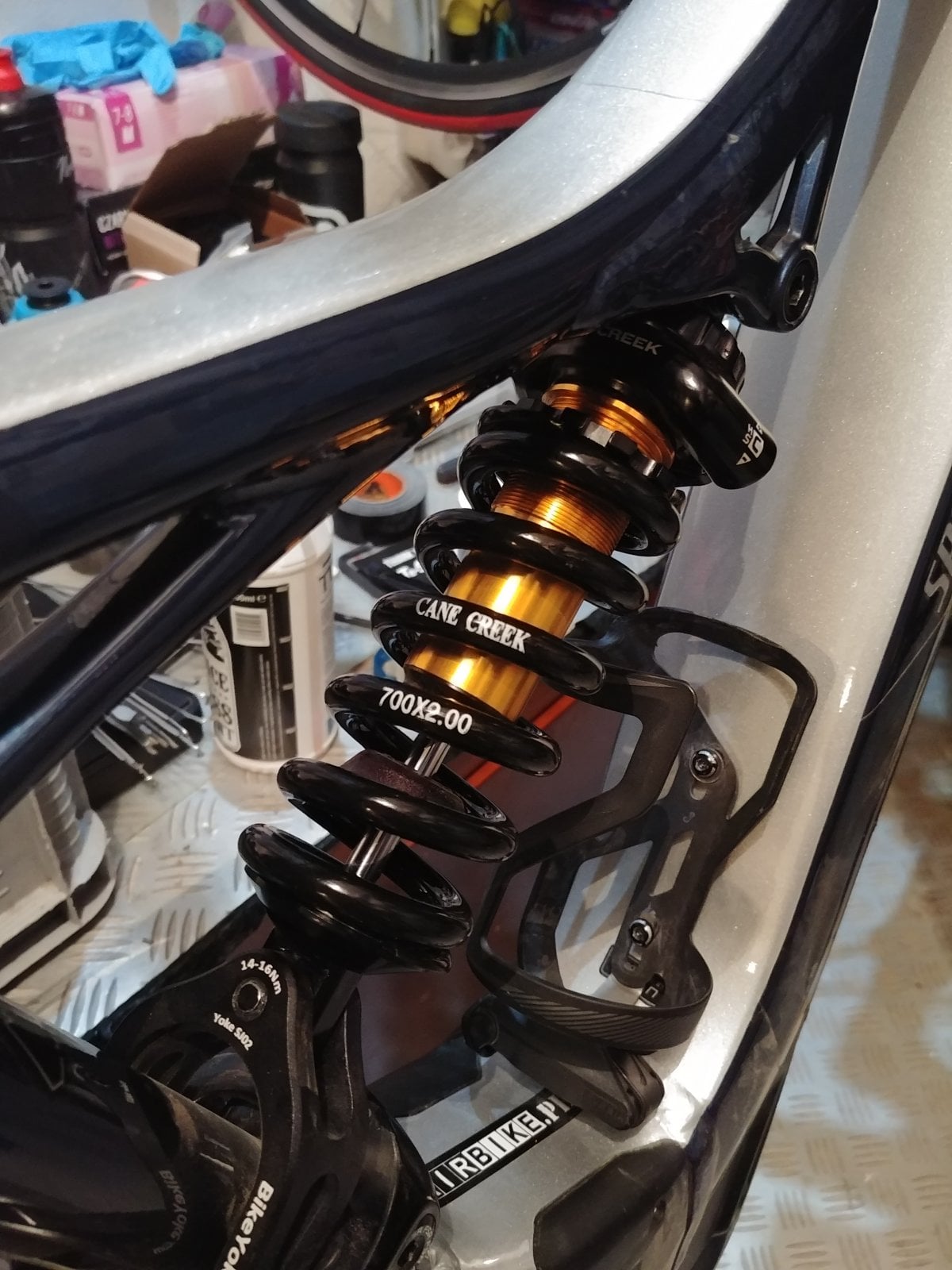

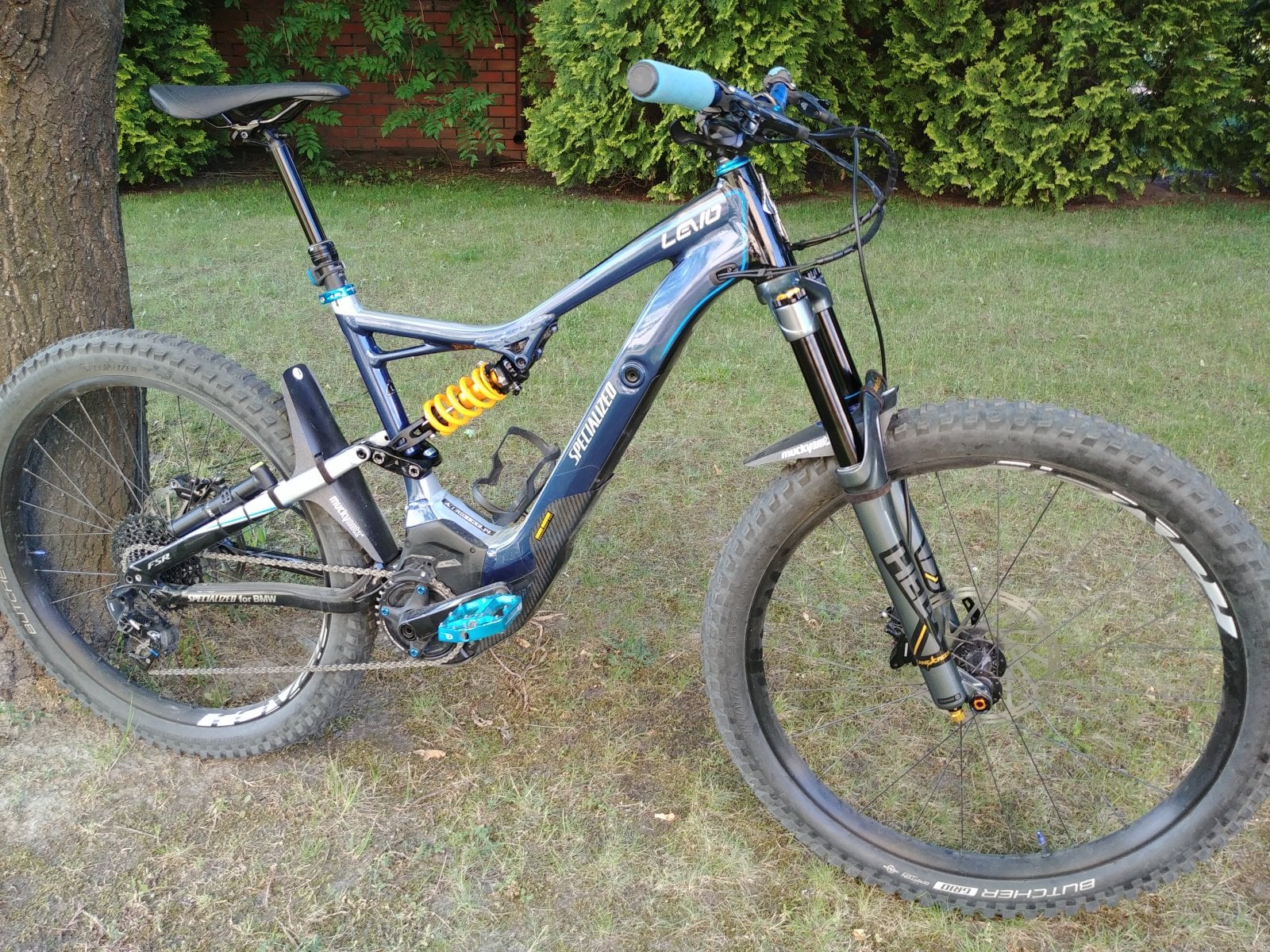

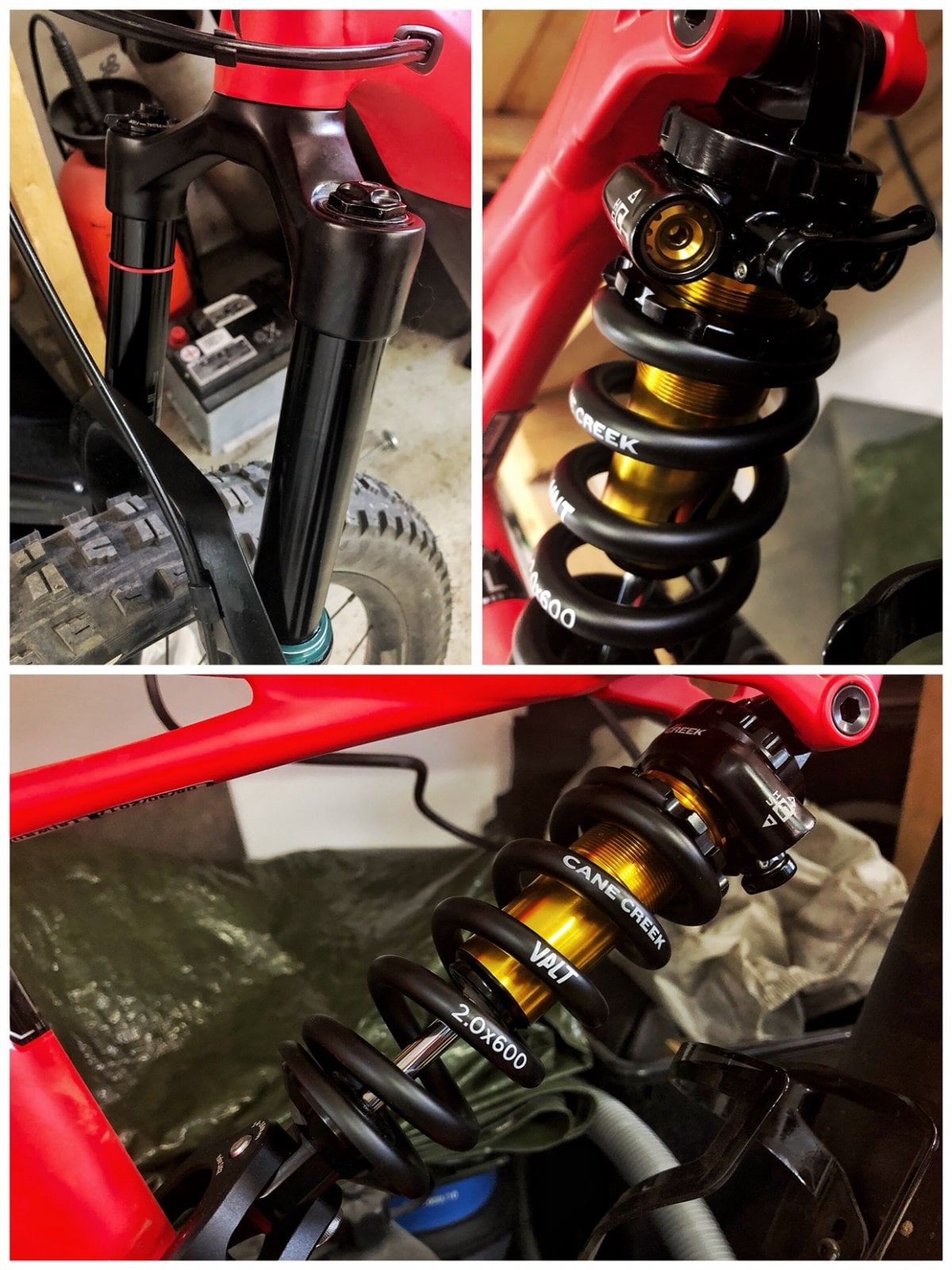

This is weird... I'm 92 kg geard up. 640 lbs Ohlins spring was too soft although I was able to get the right sag. 700 lbs is a sweet spot. 2 preload turns, 25-30% sag and still a little reserve for harsh landings...
And my beauty BTW 😎
And my beauty BTW 😎 View attachment 2060 View attachment 2061
Hey mate, where did you get the 700 spring and is that the 190(7.5) or 200mm (7.875) cane creek?
How about some feedback/review on the CC Helm??? Please !

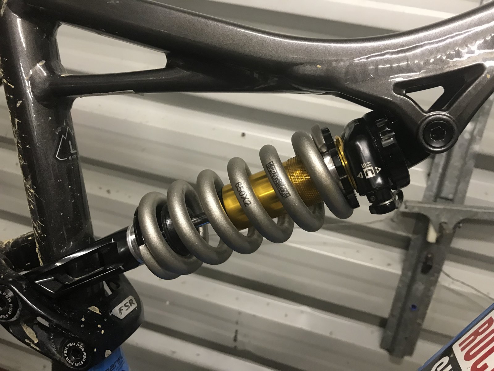

Cane creek 190/50 customer to Specialized yoke. 650 titanium spring. 90 kg 30% sag
Massive improvement, really supple, it has 2-3 mm sag under its own weight. Improvement in grip is like dropping 5psi in tires. Way more composed when jumping and flat landing.
160 the fork but gone back to 150 as it was too lazy.
29 next as not stoked on fat tyres. Maybe just front.
And 160mm cranks if the 29 doesn’t fix the pedal strikes.

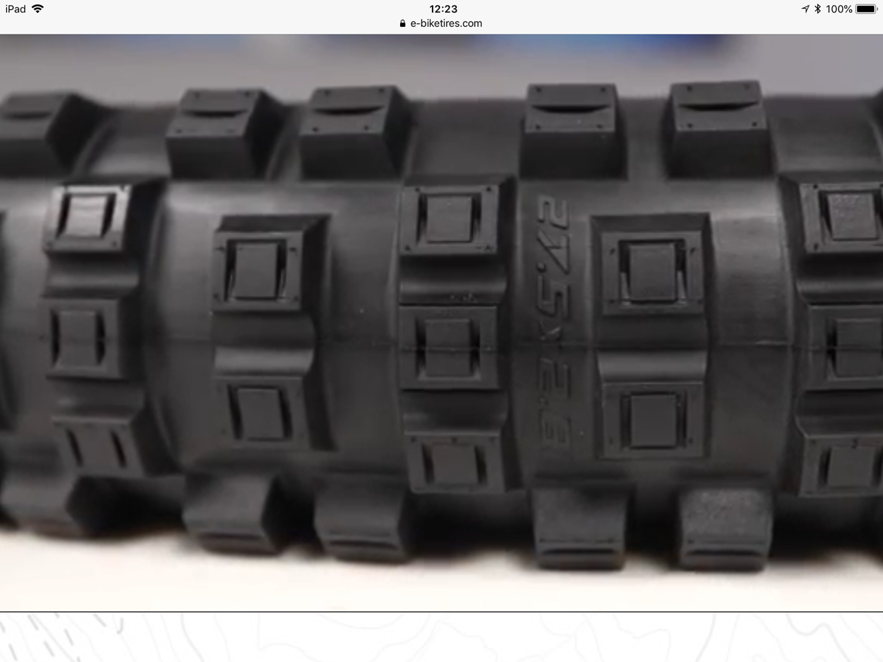

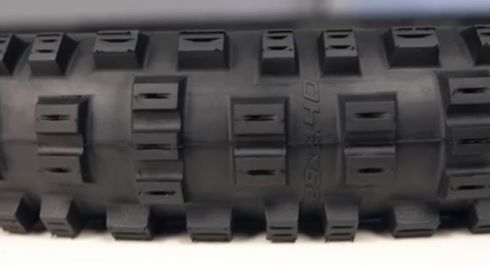

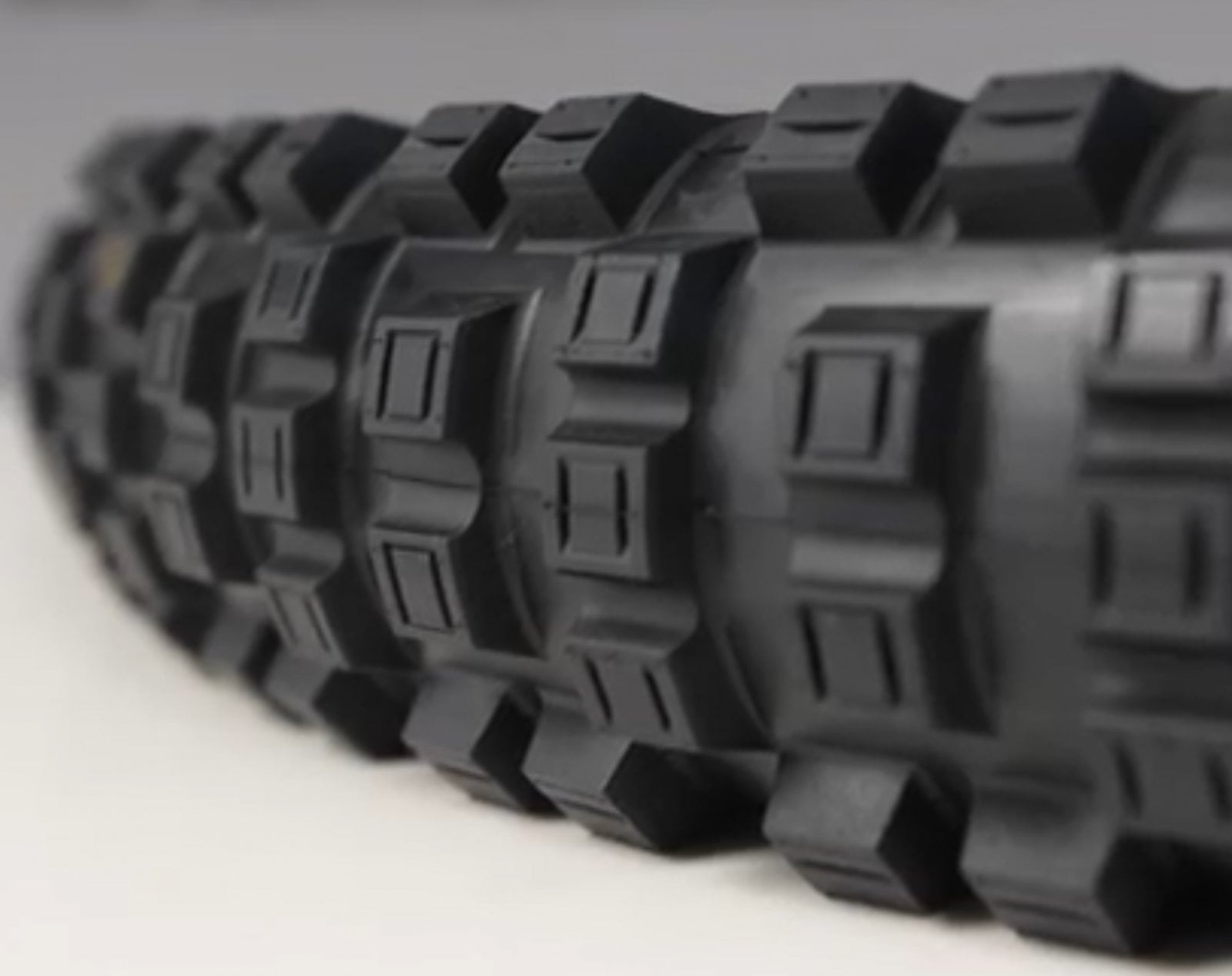

I am waiting with great anticipation for the new Schwalbe Eddy Currents to be released.
The Eddy Current REAR tyre is available in a 27.5″ x 2.8″ and 29″ x 2.6″ version.
The Front is available in the same sizes and also in a 29″ x 2.4″ version.
The first ebike designed tyre from Schwalbe. Heavy at 1300 plus grams but the grip should be immense.
View attachment 3144 View attachment 3145 View attachment 3146
Yes, me too! I'm so gonna go with that, as soon my first set of Butchers is done.
Schwalbe made a specific website for their new ebike-tyres: E-MTB - Schwalbe E-Bike-Tires
