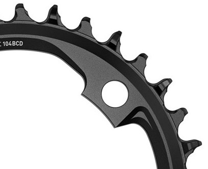

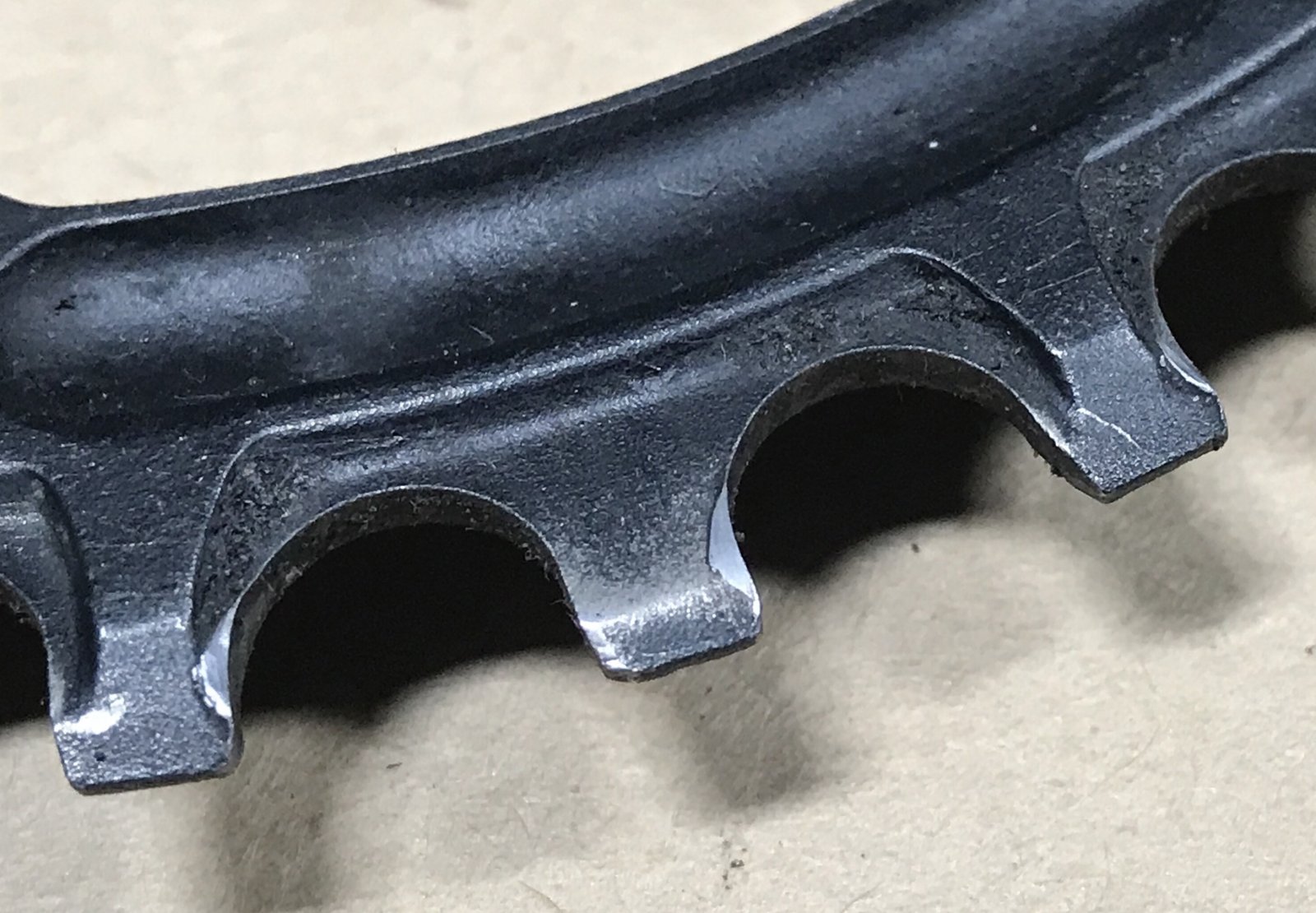

I ran the original ring, there was a terrible grinding sound coming from the motor housing as the covers tend to amplify any sound, turned out it was the chain ring, see attached image, the load had swaged the metal around the side of the teeth and was catching the inner plates of the chain.
Since replaced with an Eagle with massive cutaways on the trailing side of each tooth as pictured.

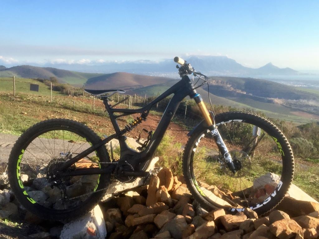

Hi All
I am new to the forum... I thought I would add a couple of pictures of my steed!
It started life as a basic 2018 Levo Comp, this was my blank canvas :)
Upgrades:
Fox 36 Fork
Cane Creek Dbinline Coil (550lb Spring)
Trp Slate GWin Brakes
XT 1x11 Groupset
Lyne Components 150 Dropper
Easton Havoc 50mm Stem
Fabric Seat
Front Wheel - 29 Easton Arc 30mm Rim - Spez Butcher 2.6 Tyre
Rear Wheel - 27.5 Std Roval 38mm Rim - Spez Butcher 2.8 Tyre
504 WH Battery Upgrade
Great bike............ really enjoying it!!!
