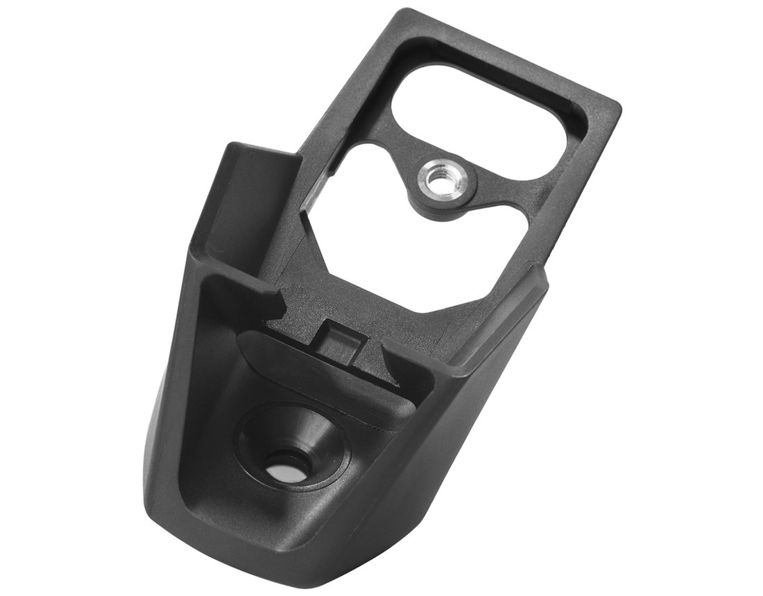

The mounting of the Kiox on my 140 Race seems to be in a very vulnerable position. Has anyone relocated it via a stem mount, if so how did you do it?

Thanks. I saw that one yesterday, while browsing, but didn’t know if it was the right part for the job. I assumed it would be more complicated, as surely Cube would use those, if it was that straightforward?
My understanding is that you just swap the base plate from one holder to another.

Both mounts the bases look the same so I guess is a straight swap?

Ah, ok, looks like the right part then, thanks.(y)
Will I need any additional bolts etc, or will the standard stem bolt work with that?

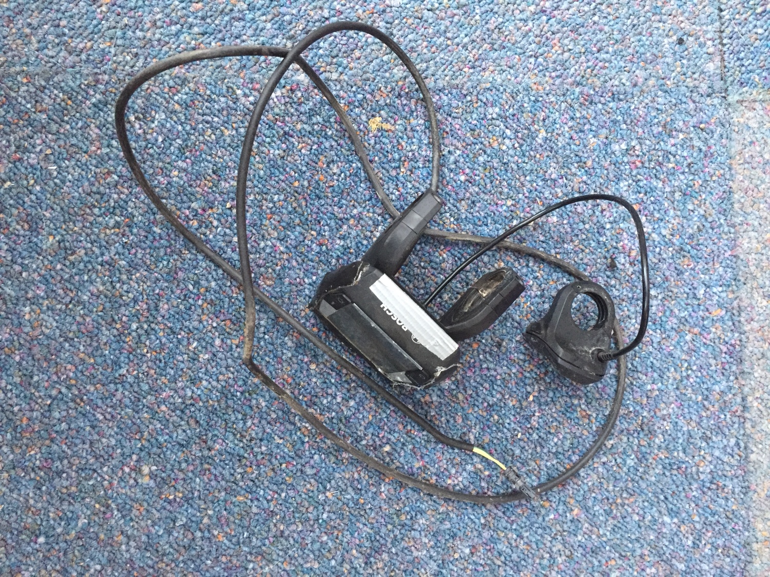

I'm not convinced the stem is the best place for 200 quids worth of glass fronted electronics and I have a very sorry looking Intuvia head unit that would agree...
img_3159-jpg.3441
Yes, the gaffer tape is structural, thanks to an OTB at Cannock. :eek:
img_3159-jpg.3441
What happened?!
