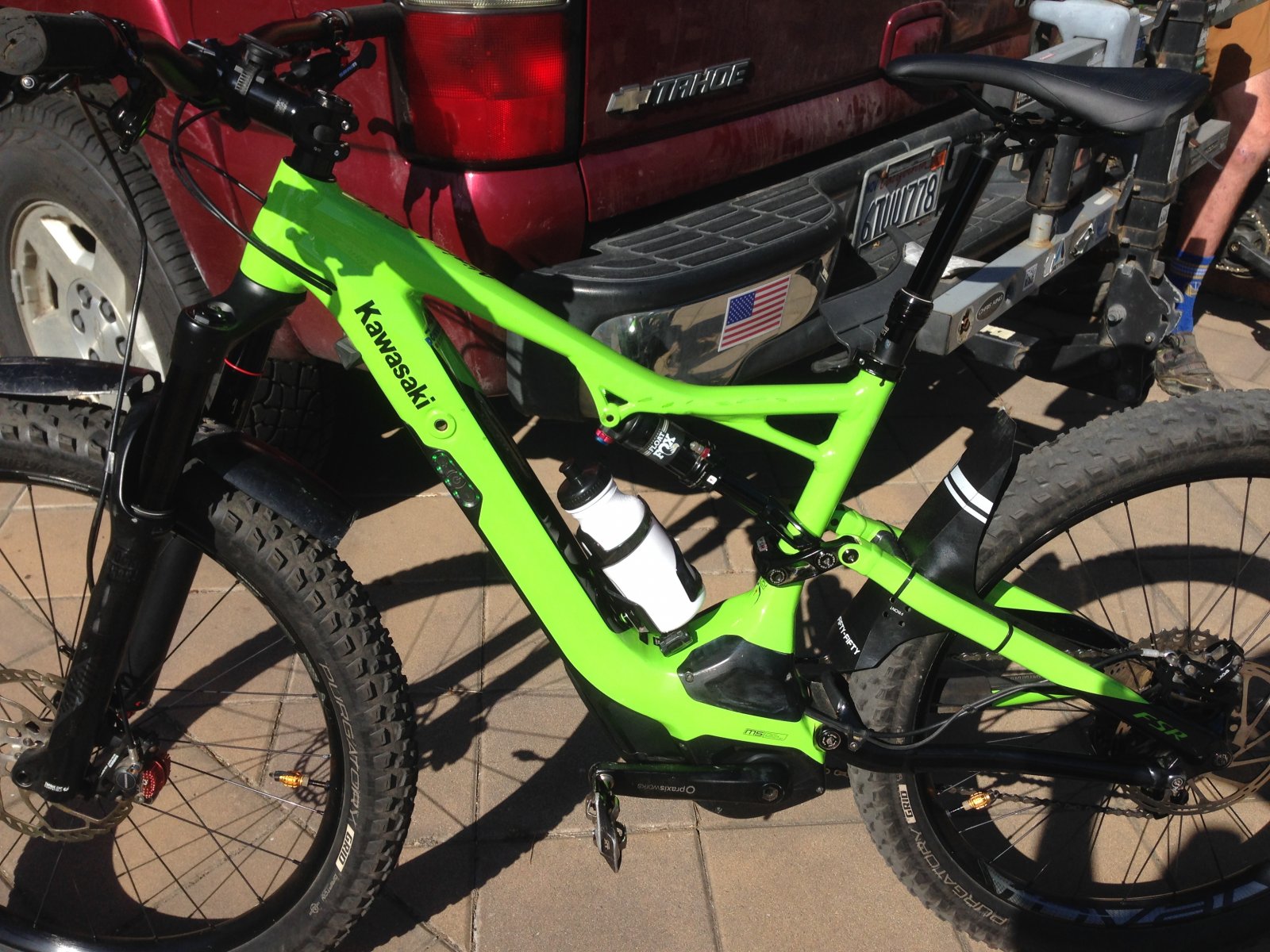

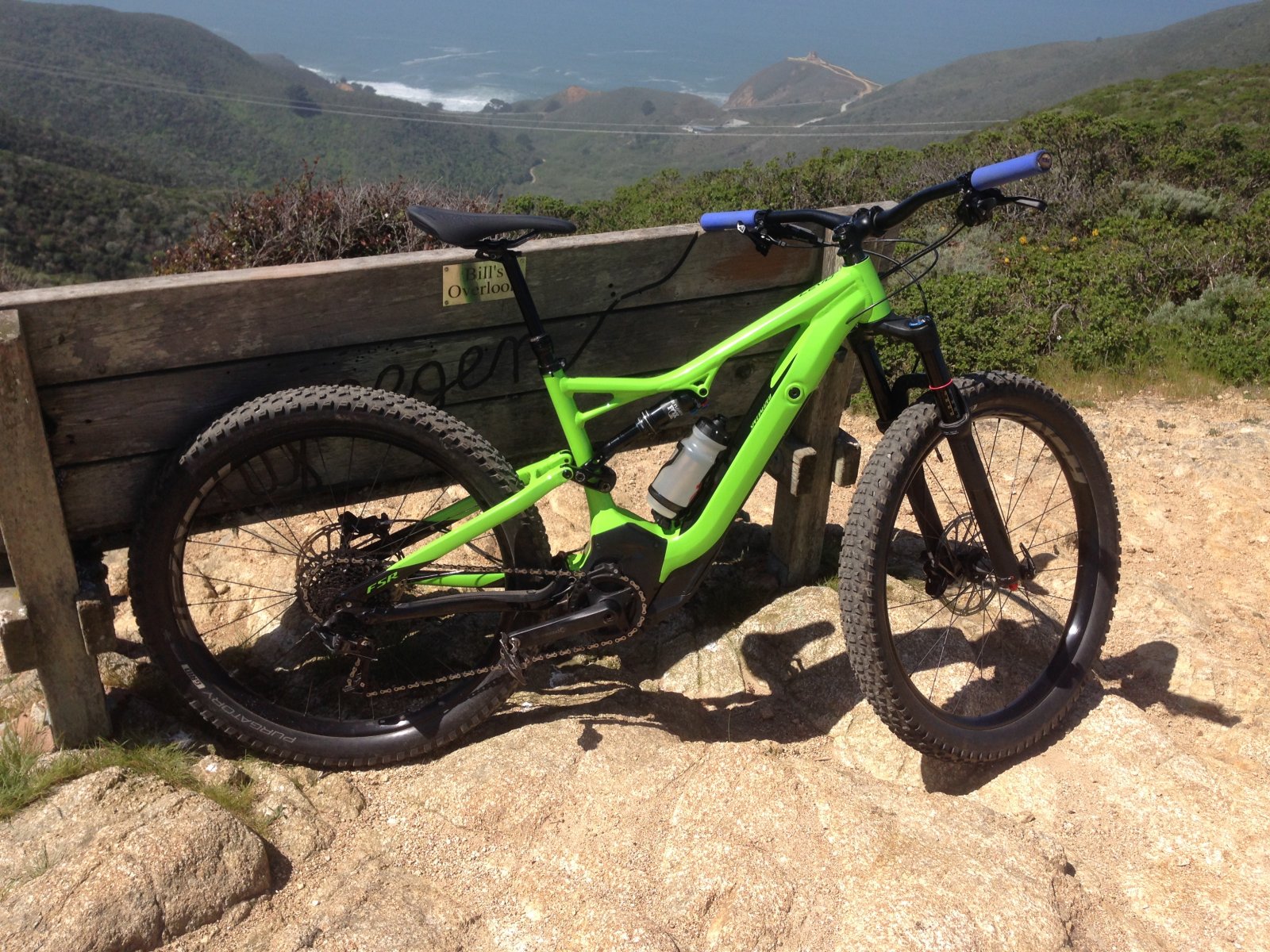

Ok, heres my .02
My bike shop here in SF calif. did the updates on my 2017 LEVO, for free, even though I didn't buy the bike there, and Spesh had said all this was supposed to be free anyways, and the bike has noticeably improved in the way it engages, and accelerates.
Much better, and noticeable engagement of the motor than before the update thats for sure!
I run support at 35 ECO, 45 TRAIL, and 65 TURBO
I run peak power at 45 ECO, 50,TRAIL, and 70-75 for TURBO
I'm getting about 10-12% more battery life too.
This seems like a good start for me.
Your settings may differ.
I re-installed the Lightblue app, so I could get past the speed limiter, works great, and I am considering the Blevo app, because the spesh app does suck, and I would like to have the HR functionality.
My speed cadence sensor had also shorted, frayed cable, and the bike shop, and spesh, took care of it no questions asked.
I had even installed, deleted, and re-installed the Lightblue app numerous times, and nothing was mentioned about it to me by either the shop, or spesh.
Your results may differ.
These bikes, LEVO, KENEVO, are pretty awesome, so I hope all who are having difficulties, can work them out and you get to enjoy your ride.
As far as all you people outside of the U. S. with bike shop issues, like another poster said, support your local bike shop, even if they have to charge you a nominal fee.
I don't usually use the shop, I work on all of my bikes, buy most parts online, but anytime they do anything for me, free or not, I reciprocate buy buying something, even if it's small and I don't need it, or I'll bring in beer or doughnuts.
That's always a friend maker.(y)
In the long run you need a shop, if anything as a conduit to the bike companies.
These bikes have come a long way, and have even further to go, and so far, It's been very fun to be apart of it.
If anything changes, as far as the bike is concerned, I will post updates.
I look forward to hearing everyones experiences!
