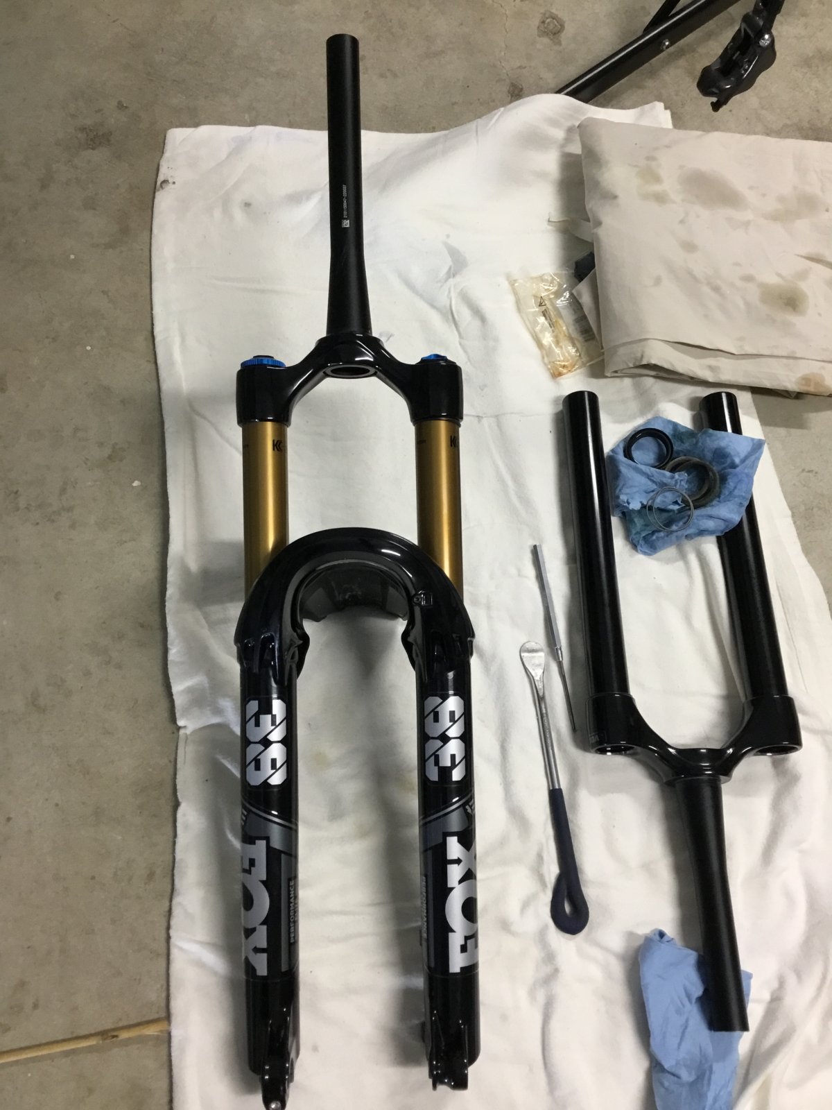

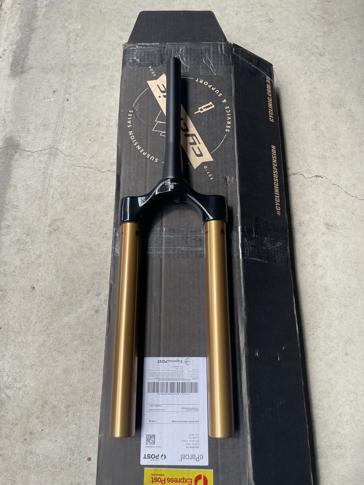

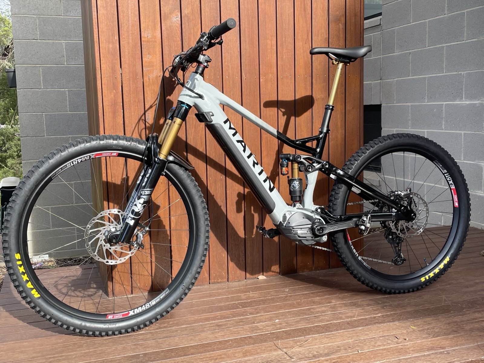

My Kashima coated fork stanchions arrived today, so sexy!!
Over the next week or so other bits and pieces will arrive and i'll have everything i need to swap the stanchions over.
I've never done any mtb suspension work before but i'm going to do this myself. I'll watch a few youtube videos and jobs done! What could possibly go wrong?
I had some time this afternoon and fitted the Kashima stanchions to the Marin. Having never done any suspension work before it was a bit daunting for me to do the job for fear of messing it up and damaging the forks. Prior to installing the stanchions I watched heaps of YouTube videos and meticulously studied the guides on the ride fox website. I took my time with it and everything went really smoothly. It took me three and a half hours from the first tool touching the bike to taking it for a test ride.
The scariest part was cutting the steerer tube, I thought if I mess this up I’ve wasted a lot of money!
The saying goes measure twice cut once, well I measured about 20 times and got it bang on.
I feel a real sense of achievement and now have the confidence to do more suspension work myself.
I’m really happy with the result and I think the bike looks awesome!

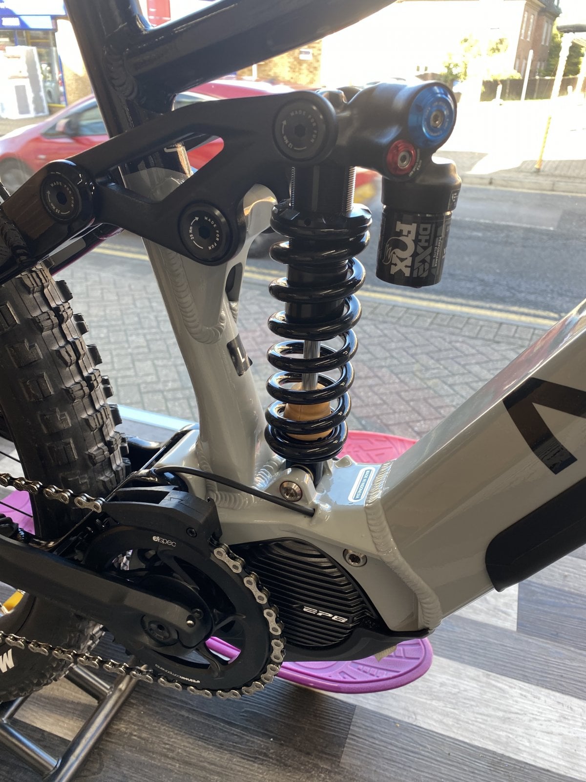

While changing the coil spring, the top pivot bolts that go into the trunnion both rounded out, despite using the correct size Torx piece. So its cheap, soft allot used. So be warned to have some spares on standby. Marin says these are made to spec for their bikes, so I doubt getting a pair with hex bolt fittings will be easy/possible? The online dealer here in Australia was pretty good about the replacement bolt....after I argued I didn't want to/need to spend $99 on a complete bolt kit for the sake of 1 bolt.

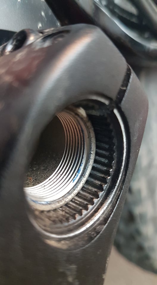

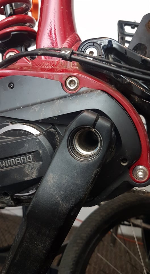

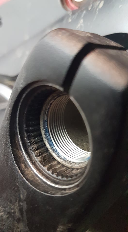

Also, tonight, while getting my bike ready for a ride tomorrow, I noticed the non drive side crank arm bolt had come off and the left crank arm had worked its way about 5mm off the spindle. It didn't have any flex yet as it still had enough bite on the spindle. The pinch bolts were pretty loose as well. The drive side crank arm bolt was almost hand loose but its pinch bolts were tight enough.Not much locktite was used on the threads either.

Just curious, why did change the coil? Was it just not strong enough or did you go for a progressive spring? What is your experience regarding bottoming-out and how lively the rear end is on the trail?

The build quality if the actual frame seems ok so far. Granted, the pivot bolt torx heads, they seemed weak and rounded out. the replacements they sent me are allen head so happy days. The crank arm bolt, speaking to a reputable Trek dealership/bike shop here, its a common issue for ebike crank arms to walk themselves off the spindle, so regular checking and lots of threadlock.

The original bolts were alloy, I picked up a plastic spare as a stop gap to getting another alloy, which I've got now but the plastic is holding steady with lots of threadlock, so can't be bothered fixing what isn't broken.

Trunnion bolts are always a touchy install on any bike - its a fine thread aluminum shoulder bolt and has to be 100% aligned and straight to start the bolt - just take your time and make sure to manipulate the rear triangle to get it lined up. Both our bikes came with allen heads
Clean the threads with a brush as best you can, put clean blue threadlocker on the threads and a dab of grease on the shoulder upon reinstall, torque to spec. I've replaced both springs - I put a Sprindex on mine and put the 350 from the M onto my sons, and lining up the trunnion bolts is the touchy part.
