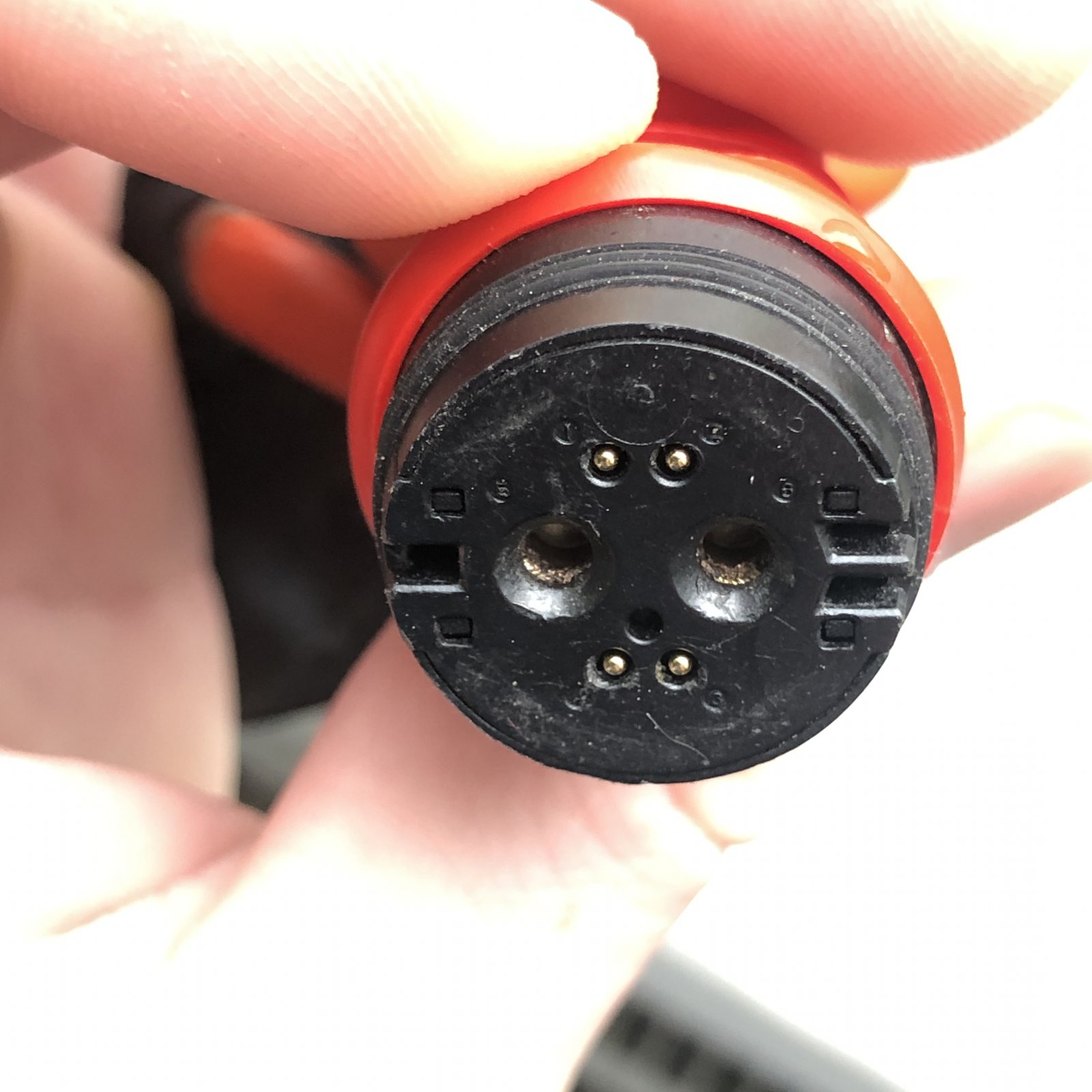

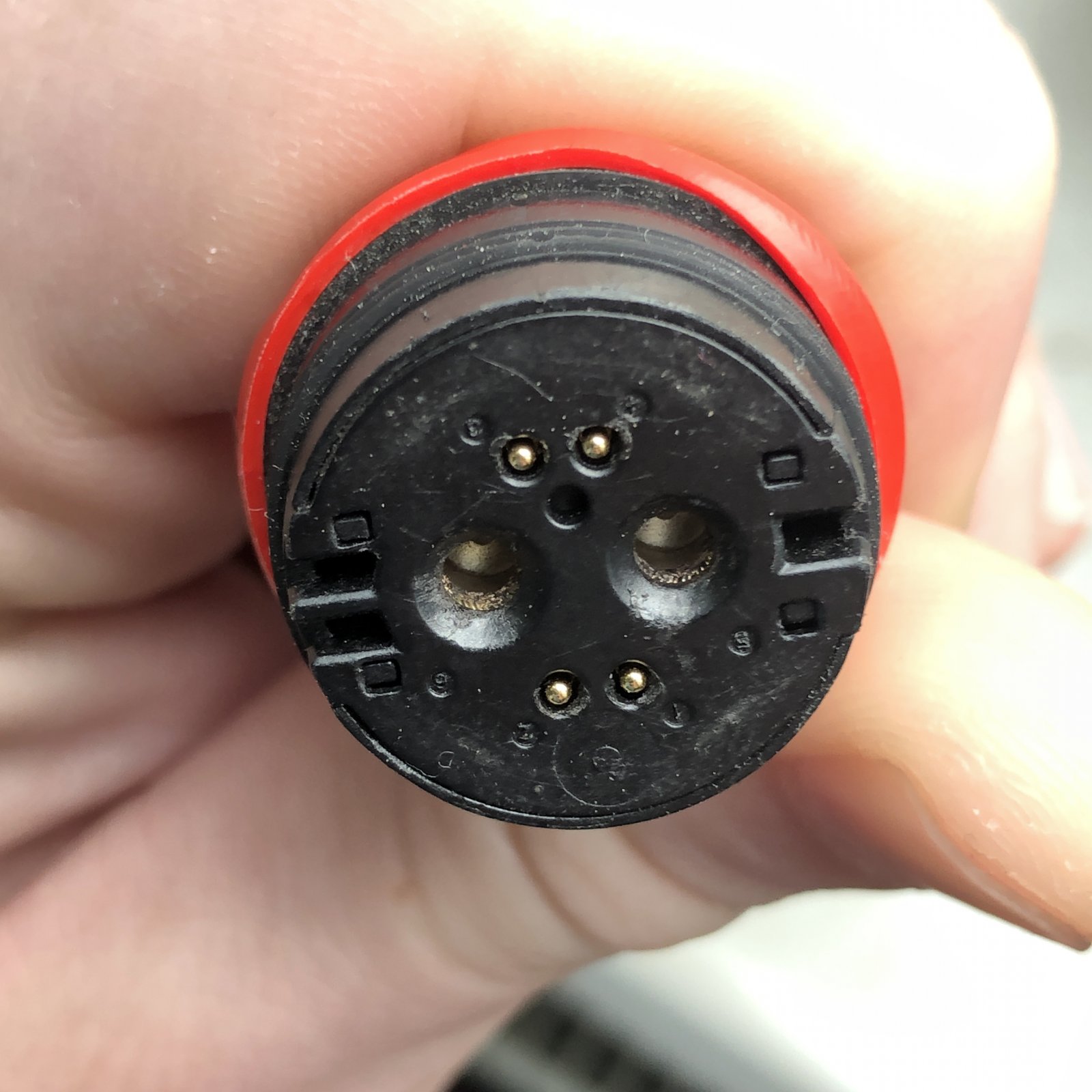

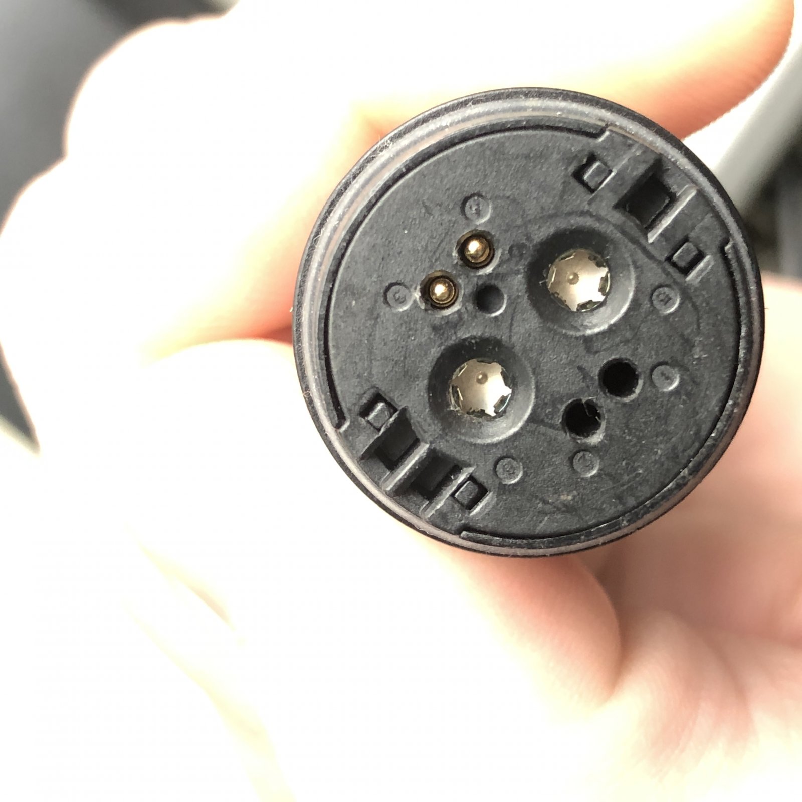

During last ride I noticed that the pack would disconnect from the bike. Turns out that the connector needs to be pushed firmly and to one side for the contact to be made, but then still it is not very stable. Will have to take the battery apart and solder a shorter cable. Maybe that additional length/weight was causing issues.

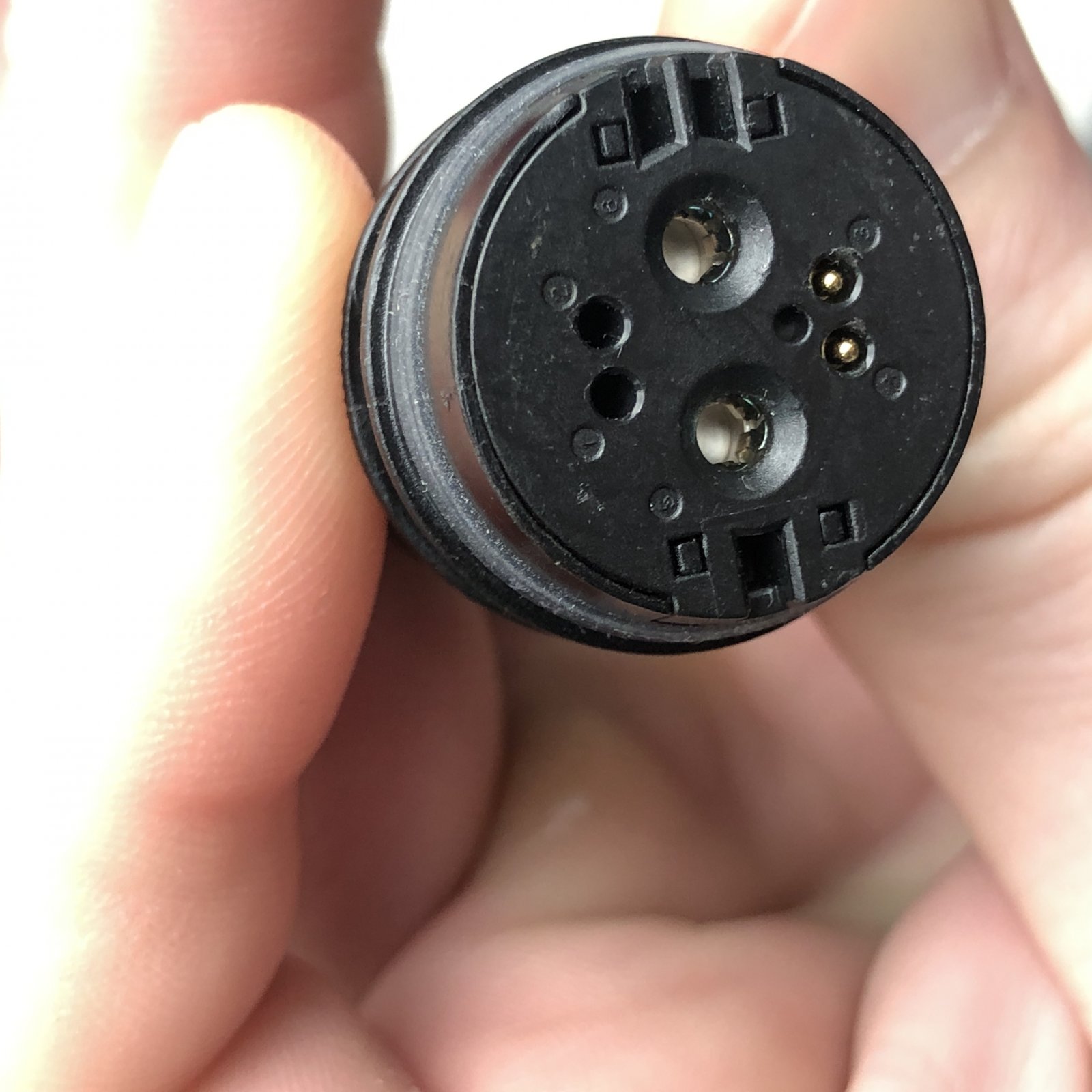

Also noticed that the sockets on the connector itself are quite deformed / oxidized. Maybe that's due to constant vibrations under current or other factors, but doesn't look good. Compared to the charger, where everything is pristine (see below). Actually even the ends of the plugs on the frame connector are now a bit oxidized as well - will post a pic later though, the bike is in shop.
Guess the TEC pack with their battery design is not so bad after all, at least the connections seem to be quite secure there, so hopefully this problem won't be there.
Wonder how easy it will be to replace the connector on the frame.
I keep mine covered at all times when not in use bit some 7/8" plastic/rubber caps. They still look nice and shiny. But your comment about weight is probably spot on. Too much momentum with a hard hit if it's too heavy. The magnets are very strong but not if the cable is bulky and heavy. My cable run is pretty short but I do have some very light 12 gage silicone ones I might try some day if I start having too many disconnects. They two wires, red and black sort of formed together, very flexible and not extra weight. But soldering them to the plug might add a bunch of shrink tubing and weight right where you don't want it, lol.
Maybe some contact cleaner and a toothpick or wooden dowel would clean it up.

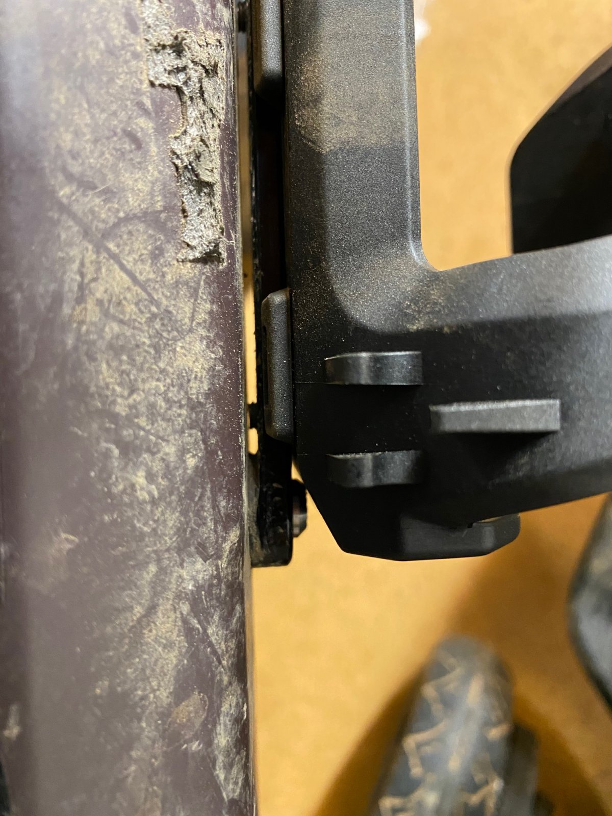

Oh I've had the bikes connector out when I swapped frames and it's not that hard if you can get a replacement. I think there's enough service length to just take it off, disconnect and put a new one in.
Thanks, I'm glad that I've got replacement connectors for the frame then :)

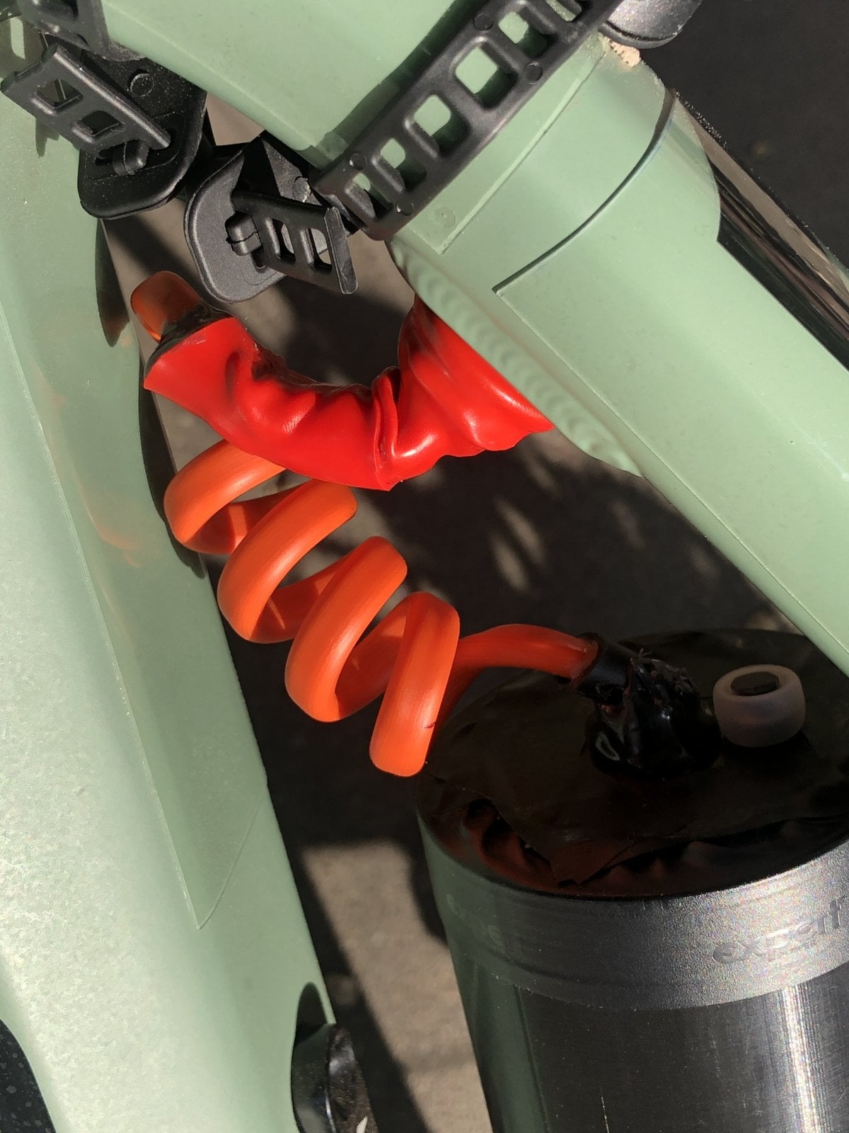

Regarding your point with lighter cable - definitely a good idea. I might try to put some velcro over connection as well - just for peace of mind. Even though I'm not riding very aggressively with the new battery due to the concerns about the weight limit of the fidlock mount. They guarantee 1 kg, and with the older 1.3 kg battery I rode it any way I wanted - jumps, drops etc. This one at 1.9 kg though... a bit scared :) So now this is rather a transport battery to get to / from a spot, or for leasure trailing
Do you wash your bike or ride a lot of mud and water. It's bone dry here in SoCal and only rarely do I wash mine. I have not looked at the bike's connector and will try to check that out today. I'm making another bottle to hold the hoverboard 250 wh battery. It had a clearance slice at the bottom to clear the DVO shock once I get it and slightly smaller OD with a snap fit lid. I'll post when my friend finishes running it soon.
Well, I rode through all the winter and washed after every ride... when it is dry, I wash every 2-3 rides. But I also use protective cap for the connector - so guess water is not a big factor here.

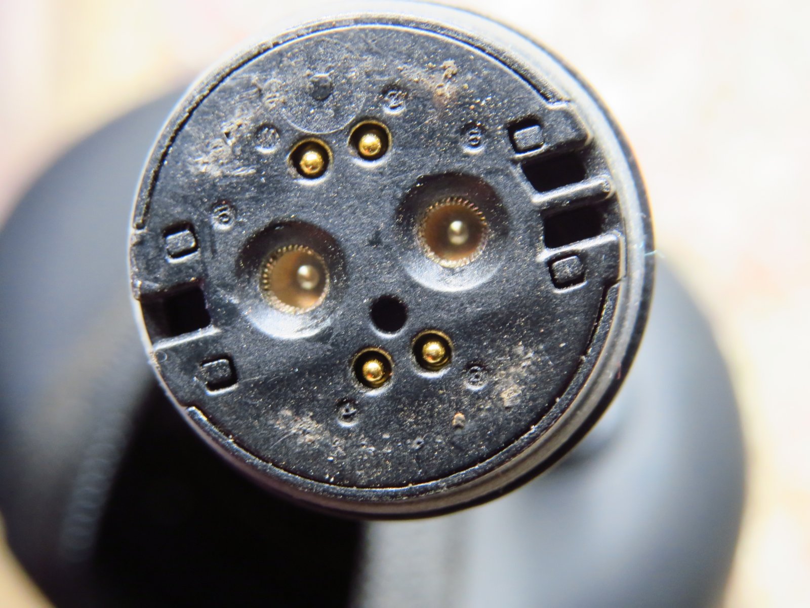

What I noticed is that clamps that hold power plugs on my charger and on the cable which I bought for pack are different. You can see in the pictures above that the clean one (charger) has metal "petals", while the pack cable has a fine spring in the same place. It might not be clearly visible in the pictures though, but once I tried to fix the pack cable and scrub off some molten metal bits from it, that spring just came off. Using some foil it is still possible to make a connection, but better to replace the cable altogether, especially that I need it cut to a proper length anyway.
I unscrewed the frame connector and cleaned its plugs with a point of a knife. All the muck came off nicely, exposing the metal a bit - but this should be ok I guess... looks like copper or some kind of copper alloy, by the color. Charger works fine anyhow. Btw, cable came off only about 2-3 cm from the frame, did you manage to pull it off any longer than that?
Also I'm wondering, which type of plugs do you use - "petal" or spring ones?
Since I had to remove the battery and the entire wiring harness it all came out but the rest of the harness must be holding it in or maybe the start switch connection.
I don't think mine are springs. I bought them from PowerButler in Germany. Looks like I should probably clean them up from time to time with some contact cleaner.

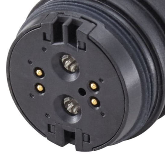

Did anyone find any info if silicone dielectric grease is ok to use with these rosenberger plugs?

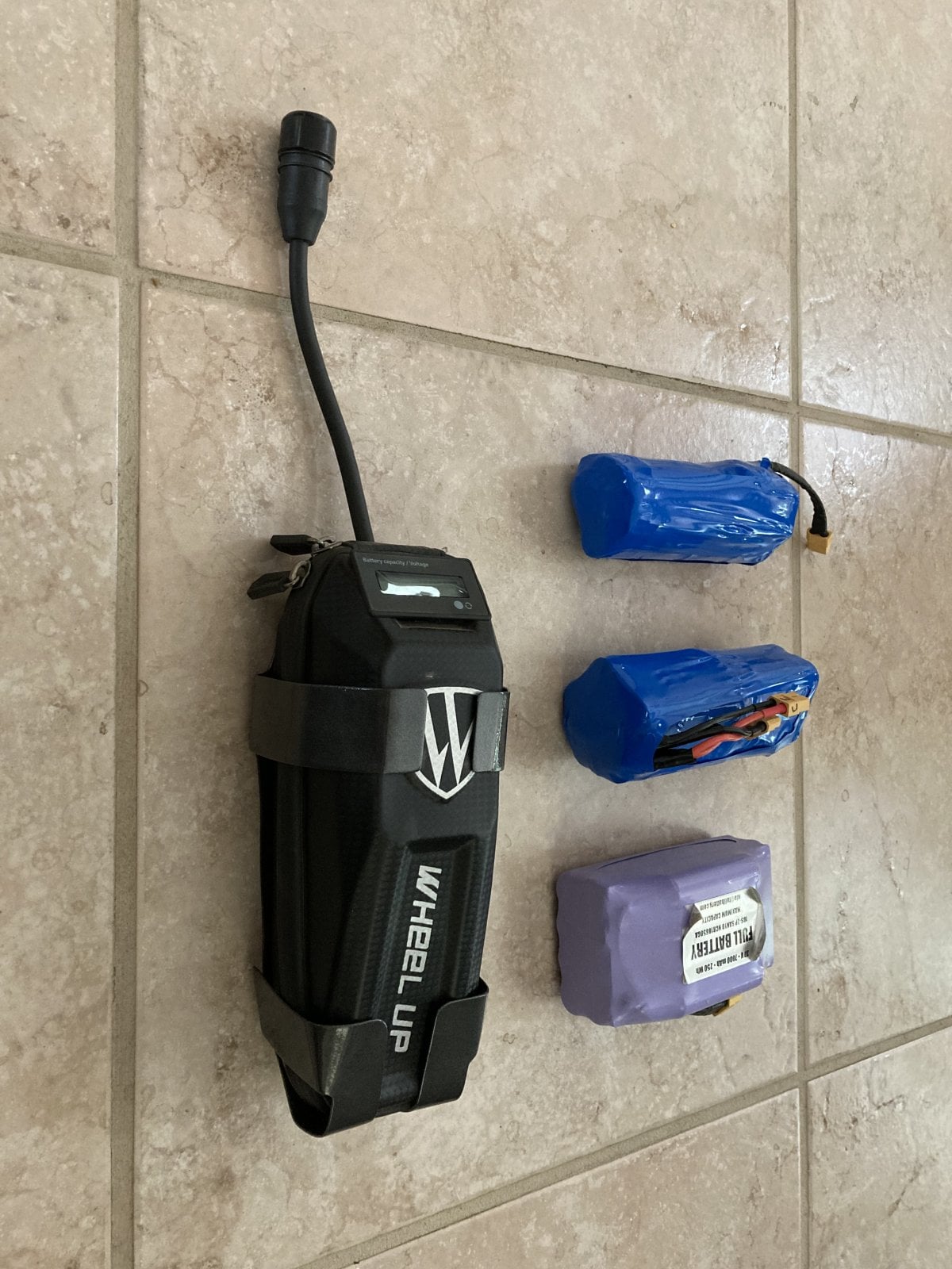

I had a very weird thing happen today. I finally replaced the BMS on the 180 wh Tesla pack (what a nightmare to take it apart and reassemble) and have also gone back to my original style of pack. It can accept any of my 3 batteries, 125, 180 and 250 wh. I was doing to ride to gage the distance on the 180 pack and swapped over to the native battery for a short steep hill when the pack voltage was about 32-33 volts. I didn't want the 180 pack to cut out early under this high load. After I got up the hill I went back to the 180 pack and noticed after some distance that my native pack went down 1 bar (was fully charged) and the voltage on the 180 pack was up to 37-38 volts, like it drew a charge from the native pack! Diodes normally prevent this so I'll have to see what happens on the next ride and if it behaves normally. No data lines were shorted out in my pack so I'm not sure what caused this. I also used a very small amount of that silicon grease on the 180 packs connection which should not be related to this.
I can't help you since I'm a dummy and yesterday i rode for the first time with a basic home made tec pack. A liitokala 5200mAh.

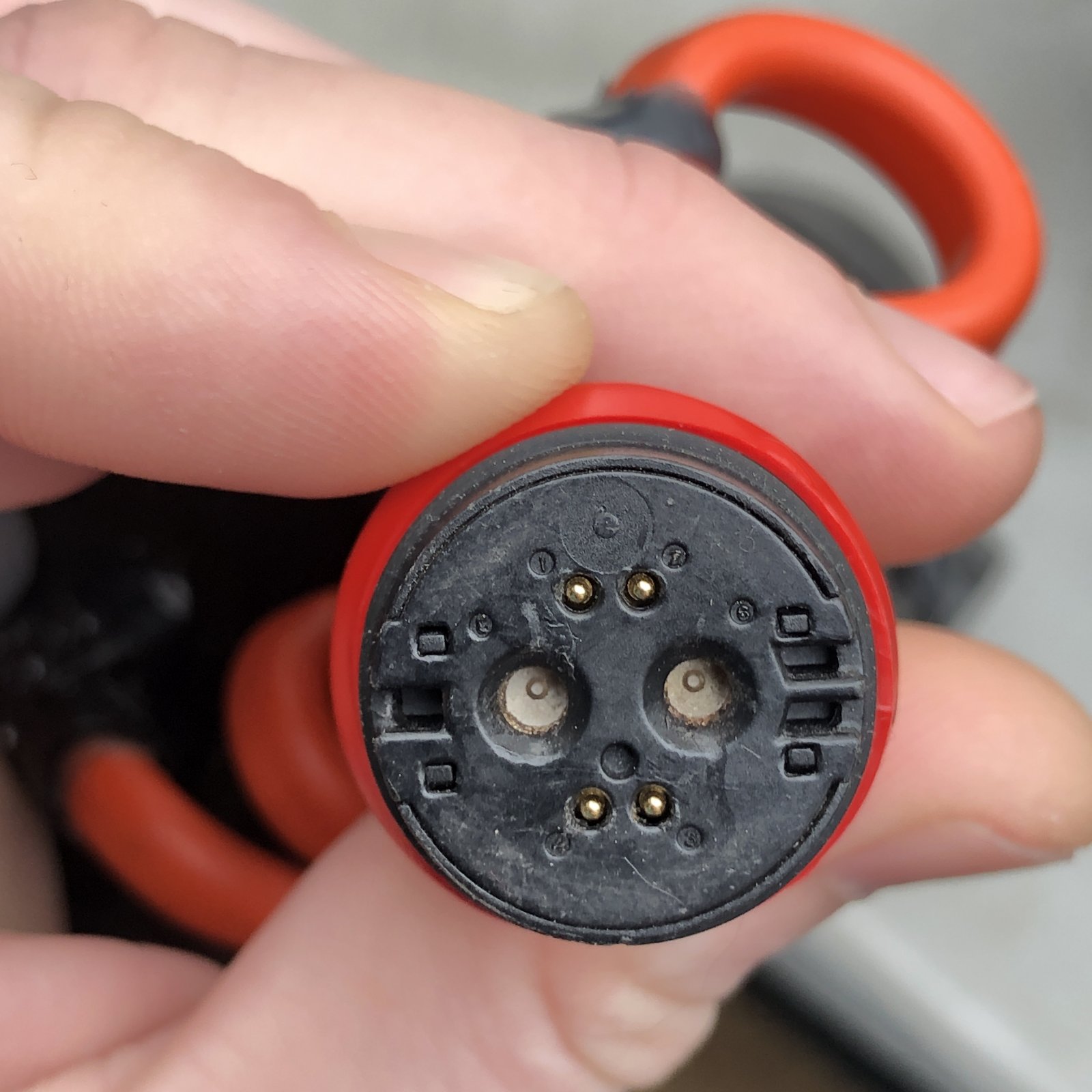

I did use some of that grease and the contacts got pretty dirty so I cleaned them with some spray on contact cleaner that has lube built in. I think I've worn one of my plugs out even though they look clean. You can wiggle it and it disconnects unlike a new one which doesn't seem to have the same issue. And I'm hearing a spark when I connect it up and I don't hear that with the new one. I've had lots of unexplained disconnects while riding lately too. I don't think the rosenberger design is very good for a long term connection during a ride that subjects it to lots of vibration and shock. It's great for a simple static charger connection but for a range extender I think it leaves a lot to be desired. Just this theory I have but I now have one plug I can't rely on any more and can't explain except for wear. I don't know what I can do to fix it or how to prevent this from happening long term with a new plug if I install it. Since I didn't use the grease from day one maybe that is the solution? Can't say right now.
I found this comment in the Rosenberger description: The system is not hot-plugable. So does this imply our DIY batteries need an on/off switch that can handle the current? I also did not find any reference to springs pins or any options in that regard, however the two battery connections do look different in their own picture of the connector. There is some sort of three pronged "thing" inside each of the contacts that I don't see with my connectors. What is that and since there aren't any options why do I have something that doesn't look like that? And another site shows a pic that looks more like my Rosenberger calling that rosenberger2. Is the first pic what they look like before they install the receptacle into the plug? Looks almost like an ultrasonic weld of the two receptacles in the 2nd picture.

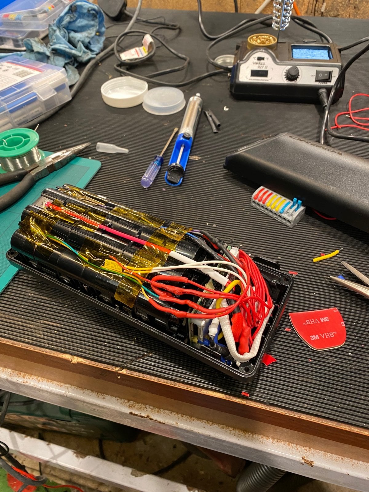

I've found this thread invaluable while making a range extender for my 2017 Jam2 so I thought I'd write up what I did in case anyone else finds this useful. First, some irrelevant background: my Jam 2 is running a -2 HA adjust headset, a 170mm fork and increased 153mm rear travel (using a 60mm stroke shock rather than 55mm). I run a 30mm wide rear rim and a 2.3 tyre , with a 2.8 front on the standard 40mm 27 in rim.

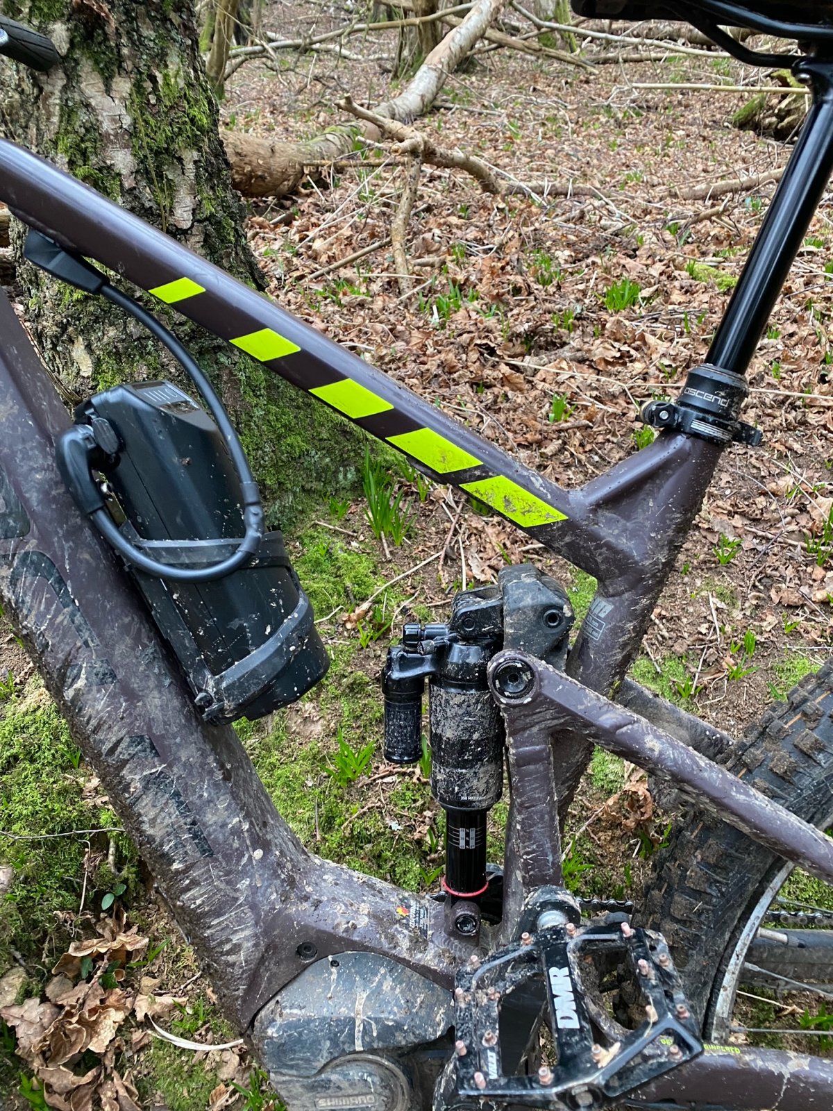

I liked the packaging of the orbea rise range extender. This is a 1.4kg 252Wh battery that fits in a waterbottle compatible mount so you can swap between bottle and battery in seconds: RS RANGE EXTENDER RISE M
To get it to fit I first needed to attach the orbea water bottle mount. To do this I had to turn down the large focus jam rail screw heads on a lathe to get enough clearance (very bottom screw head in this picture):
Once that was done, I cut the orbea power cable (that comes in the kit) and attached one end to a Jam 2 spec rosenberger cable I ordered from mouser: https://www.mouser.co.uk/ProductDetail/Rosenberger/C003-04-2000-C?qs=sGAEpiMZZMsvnOgGvSjZeLsLOOYFAZjZnmmFgZB4JFu6BZmNADaSRQ==

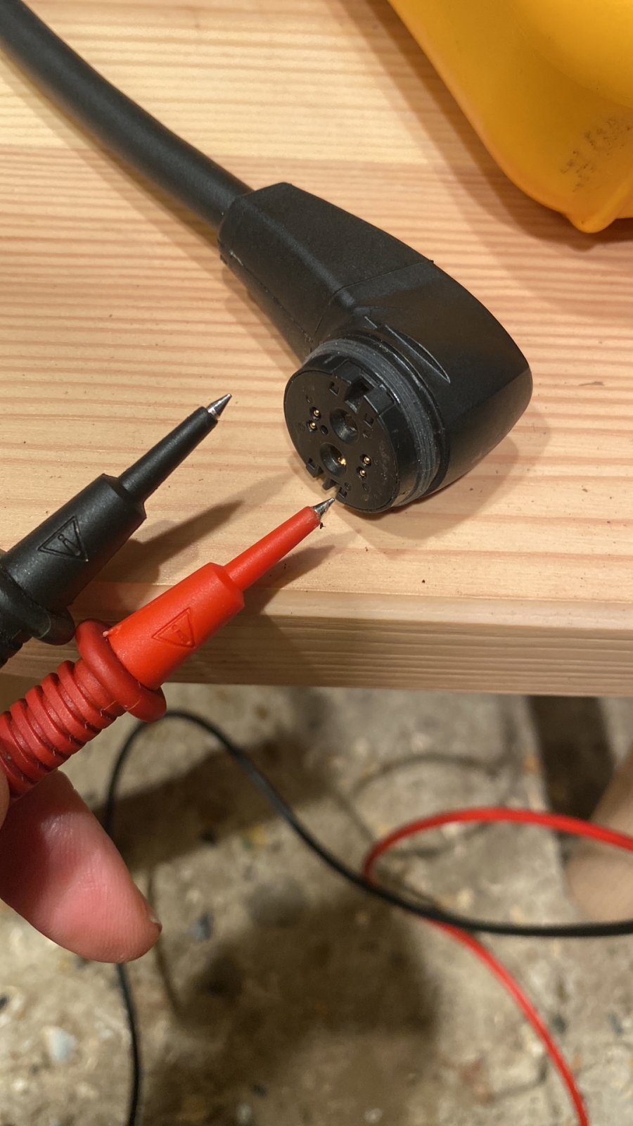

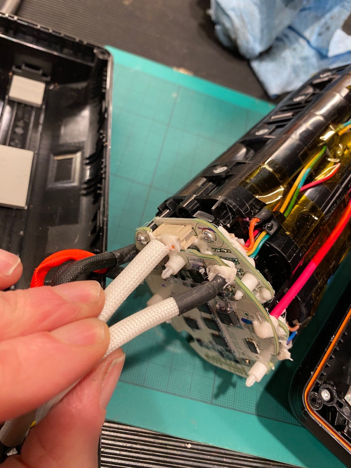

I had assumed the orbea battery would have a +36v, 0v somewhere, but it did not. I tried every possible combination of bus wire attachments while keeping the two power cables the same (literally all- I wrote out all combinations and went through them one by one- it took over an hour). None worked. So I opened up the battery.

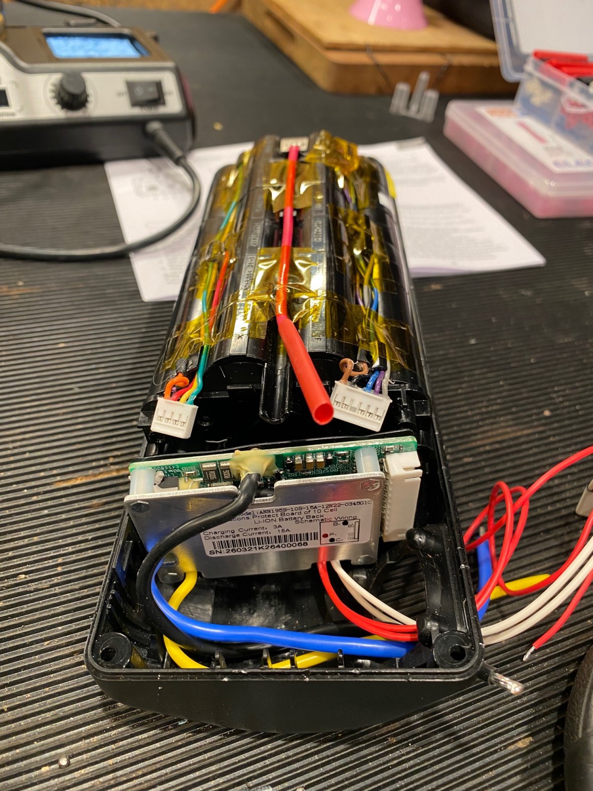

Inside I could see the pcb's controlling the battery. While it would have been great to keep this (it has an external on off switch and battery voltage led) I quickly abandoned hope of working out how to do it and simply bought the most compact bms I could find with an on off switch (space is very tight- I made a wooden mock up and it only just fitted).
Original bms:
When it arrived, I bought a soldering station, taught myself to solder, removed the old bms, and fitted the new. I soldered and used adhesive heat shrink on all joins.
new bms:
I didn't have a switch and I didn't want to put one on the case and lose the waterproof rating, so I soldered the switch wires together. I closed it all up and tested it and it worked fine- just like all the other range extenders in this thread (attach- instant power on and always reports battery state of the internal battery). Great, I thought, and went to bed happy. The next day after work, I connected it as before for a test and it did not work at all. I checked the outputs and both were at 0v. I opened the battery case up and cut the switch wires. On reattaching them it all reset and worked fine. For reliability, I realised I needed to be able to reset the switch. To get this, I wired the switch wires to two of the bus wires on the connector and then wired those together in the join in the external lead. Easy to say, hard to do when it means you have to cut your newly joined cable in half again..... However, I think this means that the bms will reset evey time I disconnect the cable and will only turn on once it is attached at the battery end. Which I hope will be quite a nice solution.
Finished? bms wiring:
Once this was all done, I connected everything back up and ...... nothing. The rosenberger connector had voltage but the bike would not turn on. Three terrible hours of undoing everything later (open case again cut open lead to check if bus wires were shorting), I realised the rosenberger connector was the problem. Another hour of testing (if I put swarf in the connector holes it worked, if I twisted it really hard, it worked) I realised the real problem. The voltmeter probes I used to check the voltage in the connector were precisely the correct size to bend the rosenberg connector springs back so they would not touch the male terminals on the bike. I cursed a lot. Then I bent them back gently with toothpick and a childs microscope and it all woked. Great. Now all I needed to do was to close the case up again (for the third time) and make the joining cable again (also for the third time). This was all plain sailing.

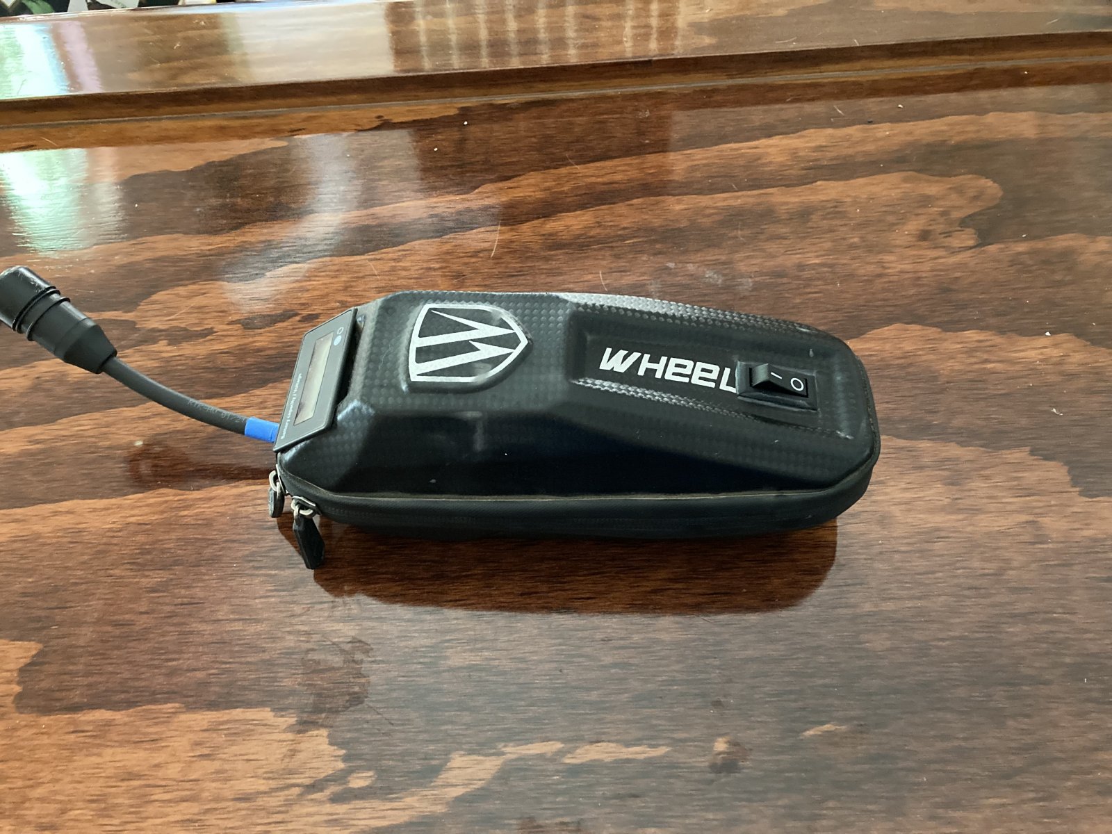

Next up- charging. I had a £15 childs swegway charger (1 amp). Orbea wanted £100 for a charger. So I started with the swegway one. I also had the other half of the orbea cable I had cut off that I could wire to the charger. Sadly things were not simple. The orbea discharge cable had only the discharge cables wired and not the charge negative. So I had to open the connector up, dig out the termnals from some resin stuff then solder on a charge negative. Once done, it all worked fine.
I've tested it three or four times now and been very pleased. I've lost the use of the button and state of charge indicator, but it otherwise works very well. It's very convieniently packaged and completely rattle free. There is plenty of clearance to the (longer stroke and additional reservoir) shock.
When the reserve battery quits, I roll a ruber o ring onto the connector at the battery end then reattach. This is enough to disconnect the battery while still retaining it in place so I don't need to carry it.
