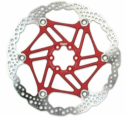

I'm wondering if it's worth it to change to a floating rotor?
Like these?
More expensive but most of us have went this way.(8 bikes maybe?)And most of us went 220mm for the front and 203mm for the rear. Better modulation, or more equal modulation. Less rear tire drag. Better stopping power for the front tire where it’s needed.

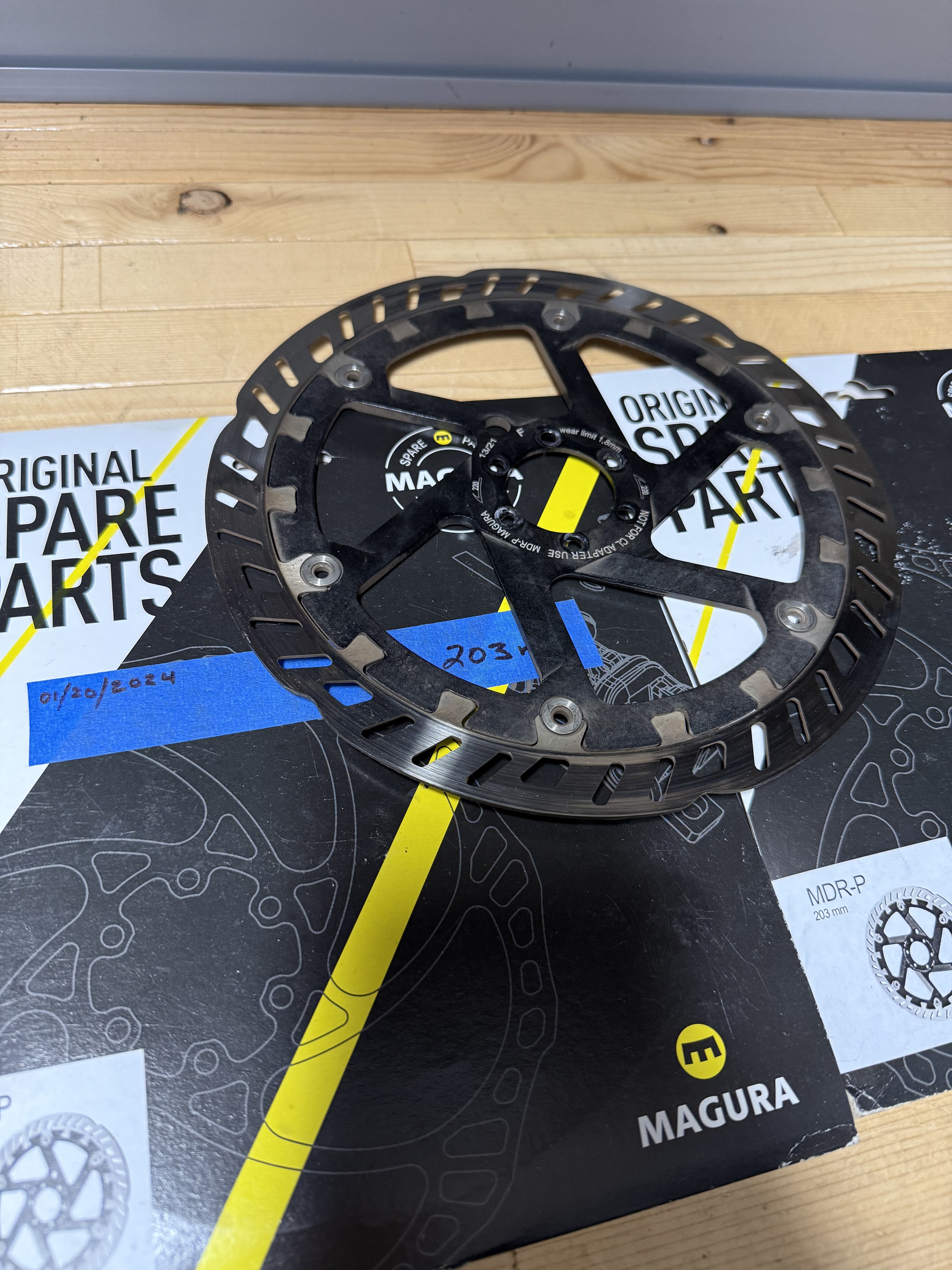

Note about floating Magura rotors; a couple of guys in our circle found a great deal on-line from an unknown supplier. As they rode them on chunky trails they sounded like tambourines. The sound drove them nuts. They replaced them with OEM floating rotors from a reputable local Bike Shop.
I suspect that these noisy tambourine rotors were rejects after the QC process. Possibly sold at a discount to a foreign buyer who resold them at a discount.
I guess you get what you pay for.
