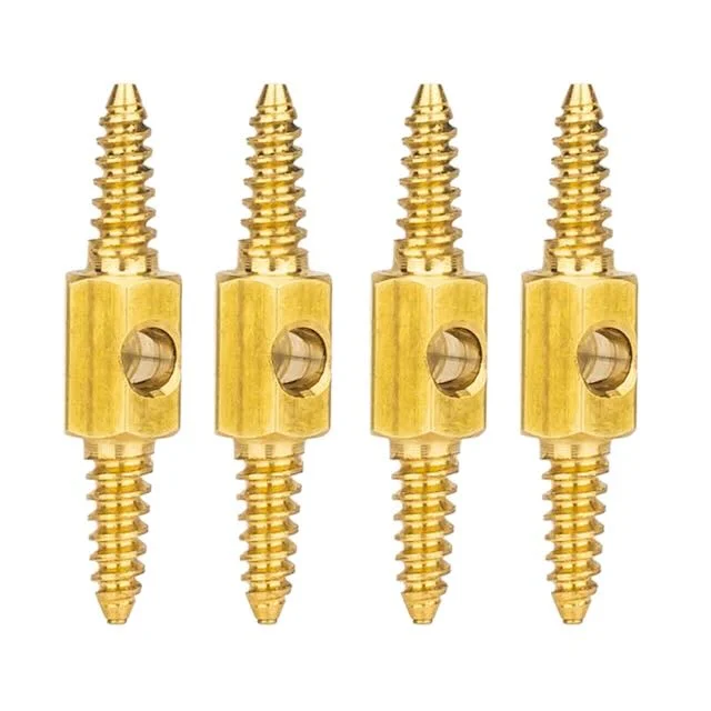

I would think you could use one of those double ended threaded connectors for internal routing using the existing brake hose to pull the new on through. Or the Park Tool IR-1.3 internal routing kit (or equivalent) using the existing hose to pull the cable through then hooking it up to new hose to pull it back.

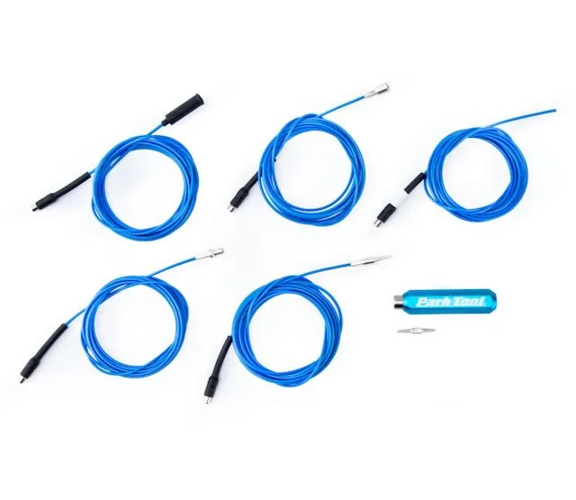

When I installed the power cable on my bike I had to drop the drive unit and used the Park Kit to pull the power cable through the swing arm using the shift cable housing I had the dealer leave in the bike when he installed my X0 T-type derailleur. It worked great. Dropping the drive unit isn't a big deal but it would be a lot easier and faster if you don't have to do it.
2-4pcs-Coppers-Connector-Bike-Wire-Threader-Bicycles-Internal-Cable-Routing-Tool-Hydraulic-Ho...webp

I used the Park Tool when pulling the old hose. Unfortunately, pulling the new one through was not as easy. It got caught on an internal zip tie at the base of the motor. The motor had to be pulled which was "much" easier than expected. Remove bottom cover and two bolts. The cranks do not need removed or unplugging the connectors.
It's quite easy to replace the rear brake hose. Those barb joiners posted above are helpful but not even remotely necessary. Just clean the hoses and tape them together with something reasonable like packing tape. The battery section is not tight and the built-in clamp/guides don't really grip the hose anyway so they're a non-issue once loosened a little.
You do have to drop the motor, of course. There are a few cables zip-tied to the brake hose. The whole job is easiest with the bike upside down. Just put the derailleur in the fully forward service position and you'll have enough slack to lift the motor without even needing to jump the chainring.
