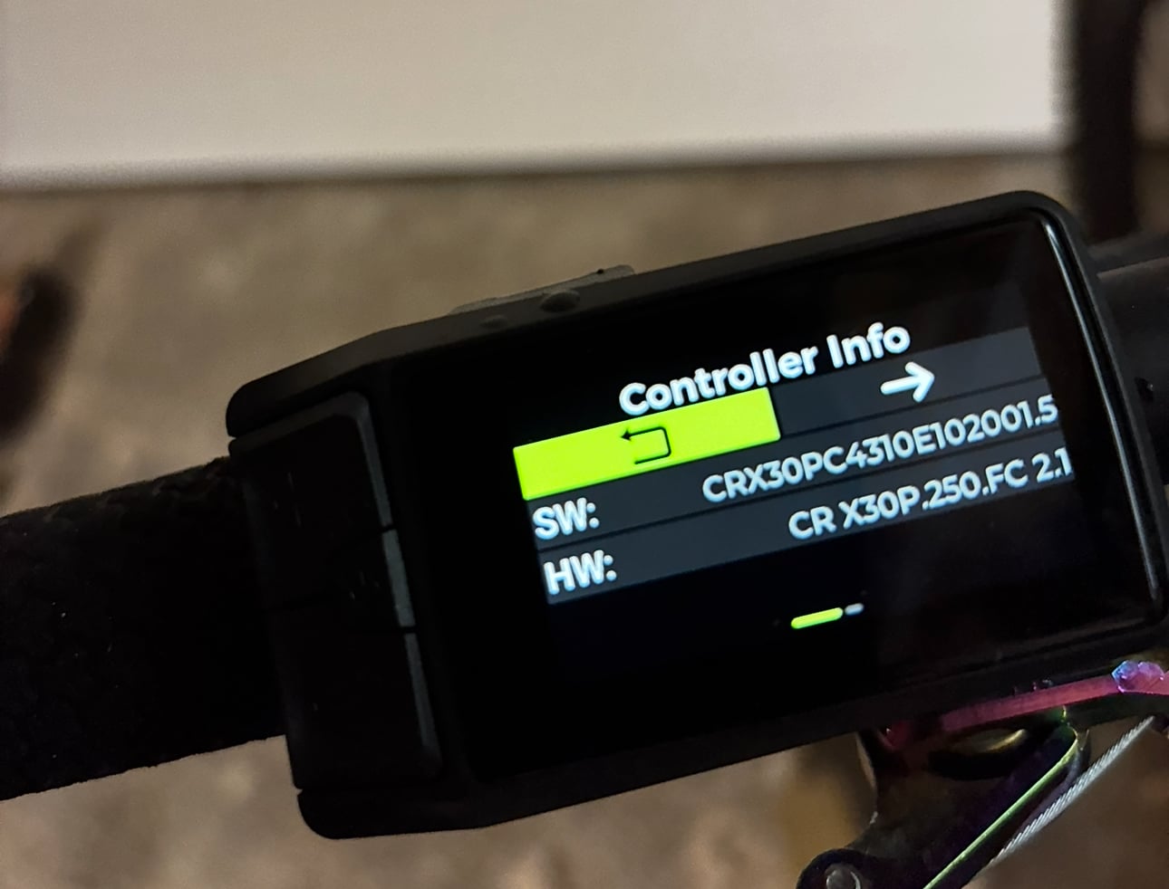

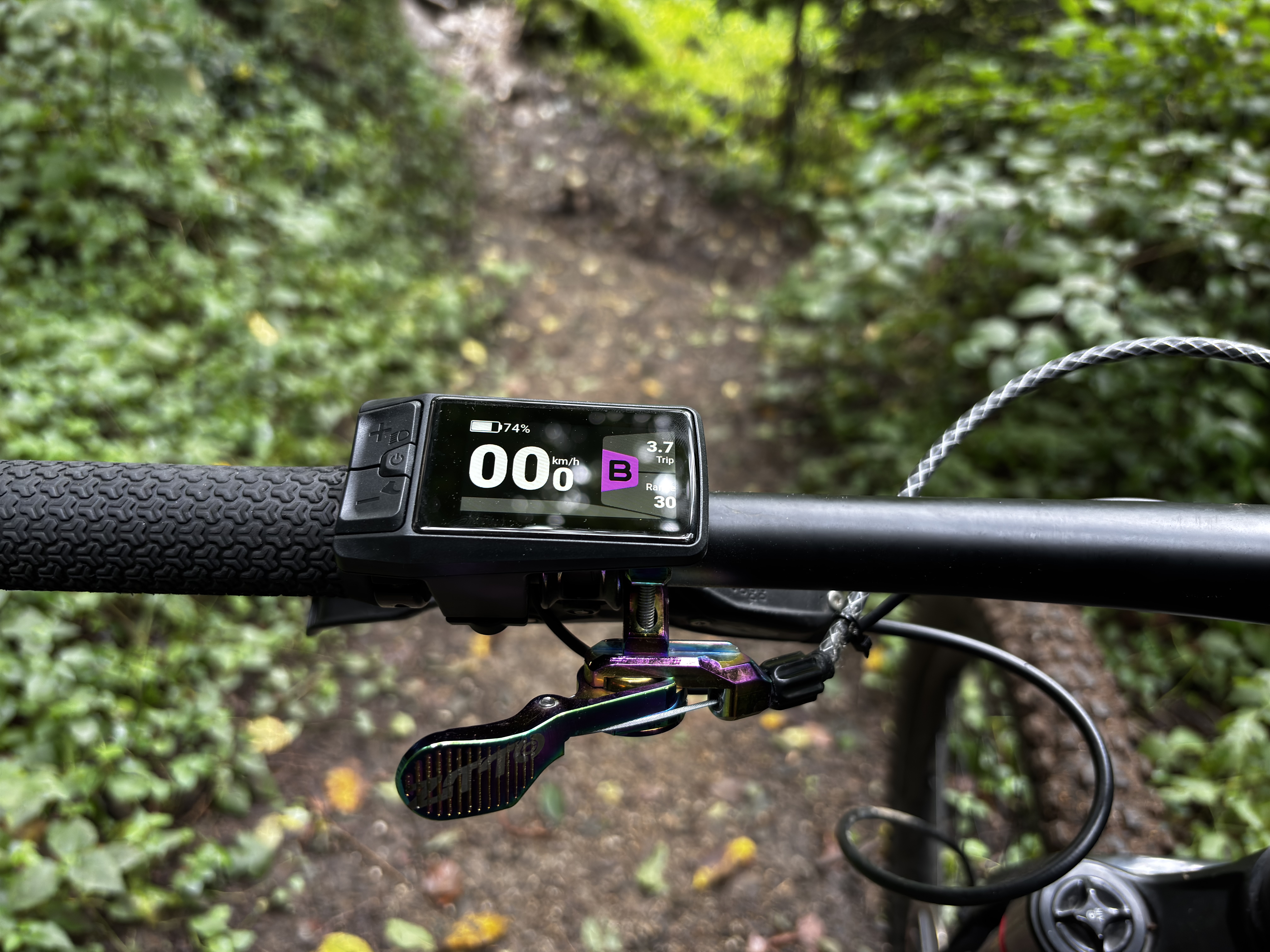

New motor (spare - 43V) arrived yesterday and I rode it today, I did not have the time yet to plug the besst and check the fw but this version is awful !
It feels like it's another motor, absolutely zero overrun, not powerful at all (feeling), power delivery is not smooth, that's a nightmare !
I wil have to update it asap but I don't have a Windows laptop right now available :(
Also, ordered the new DPC080, it's quite nice
PS: I know, my dropper cable is too long :D
You don't you have a preview from the display level to the fw version? I'm very curious what you have uploaded, because I felt more power on 43V fw already on 48V fw, only the support disconnected for a long time after stopping pedaling
I updated from the 10A to 13A firmware and noticed a difference. I only have one short ride on it though. I am interested in your findings.
I need to find a laptop and I'll update this asap :)
I am running CRX30PC4313E102004.3. It has power enough, but not smooth at all and overrun is loooong. Difficult to use on technical trails. Might be eroad version. It is available in the M820 firmware thread.
