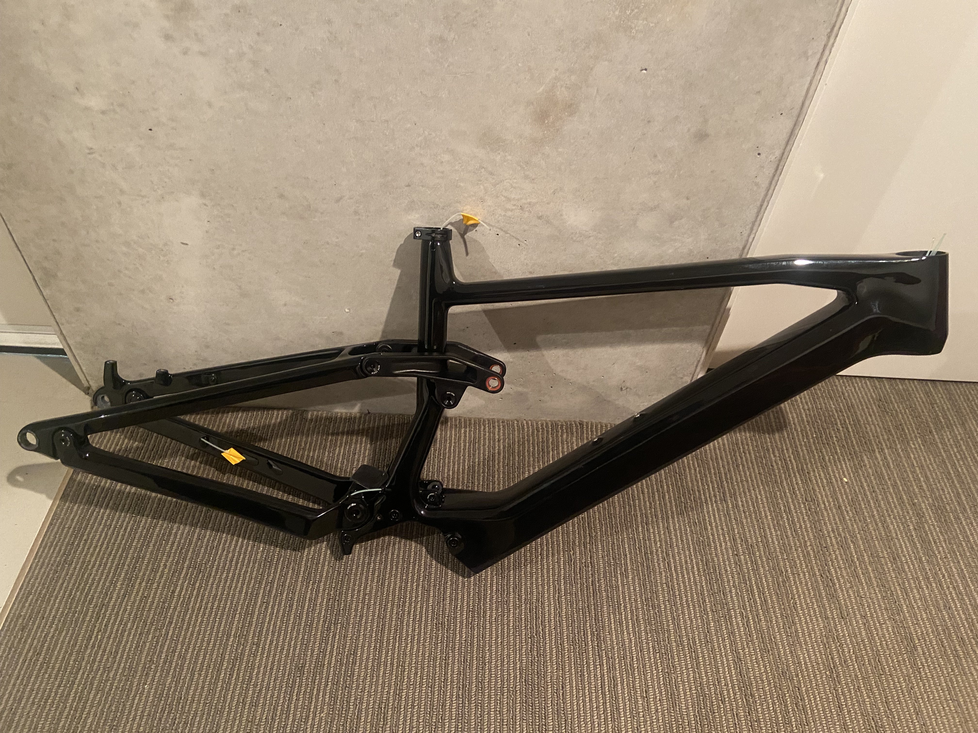

M820 Bafang - LIGHTCARBON LCE930 Frame (lightweight)
My size large frame arrived
Good quality and all the bolts etc.
looking a the cable entry on the head set you need to make sure there is cable length in the frame or the cables will chaff
looking forward to the first ride

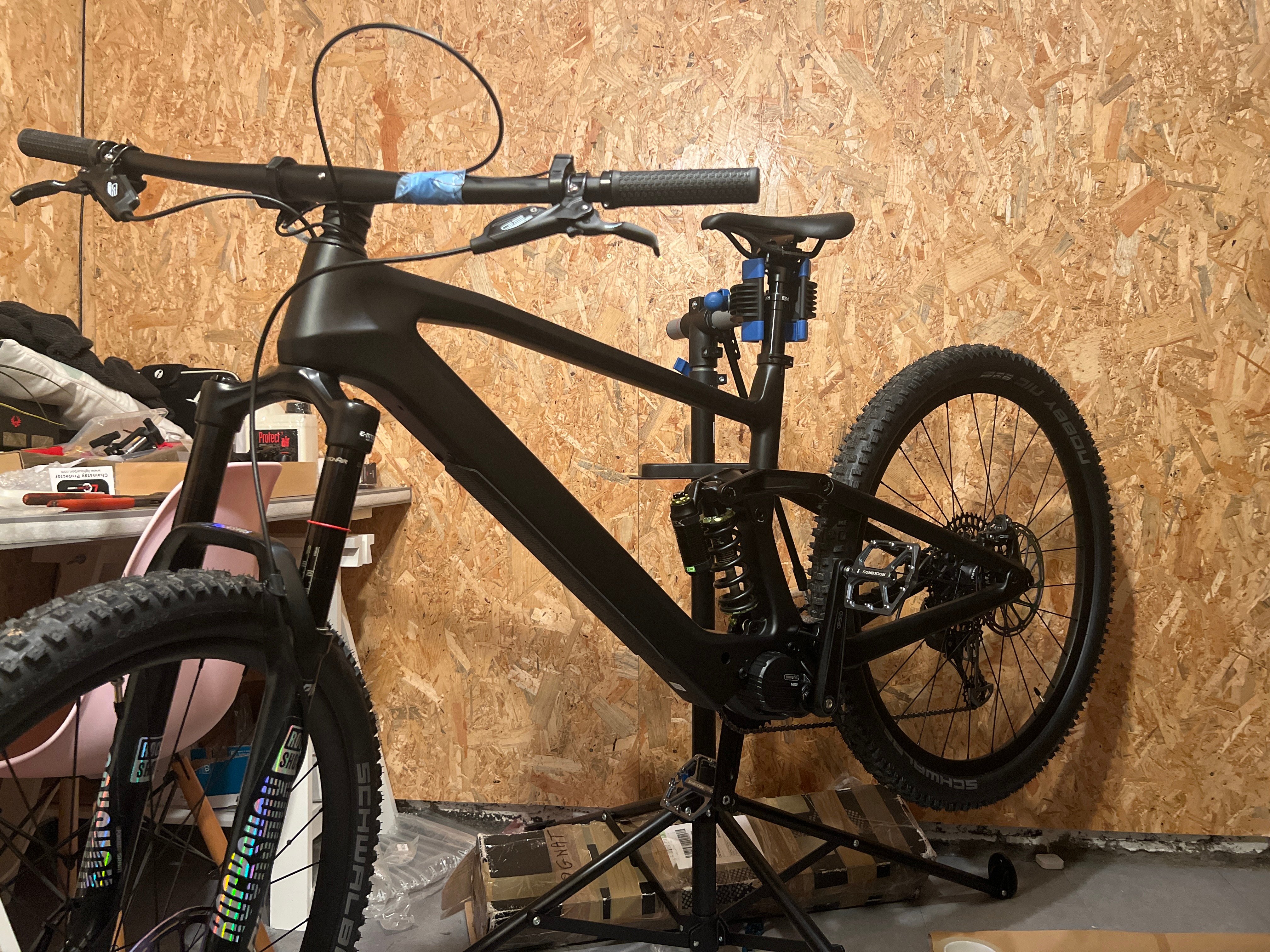

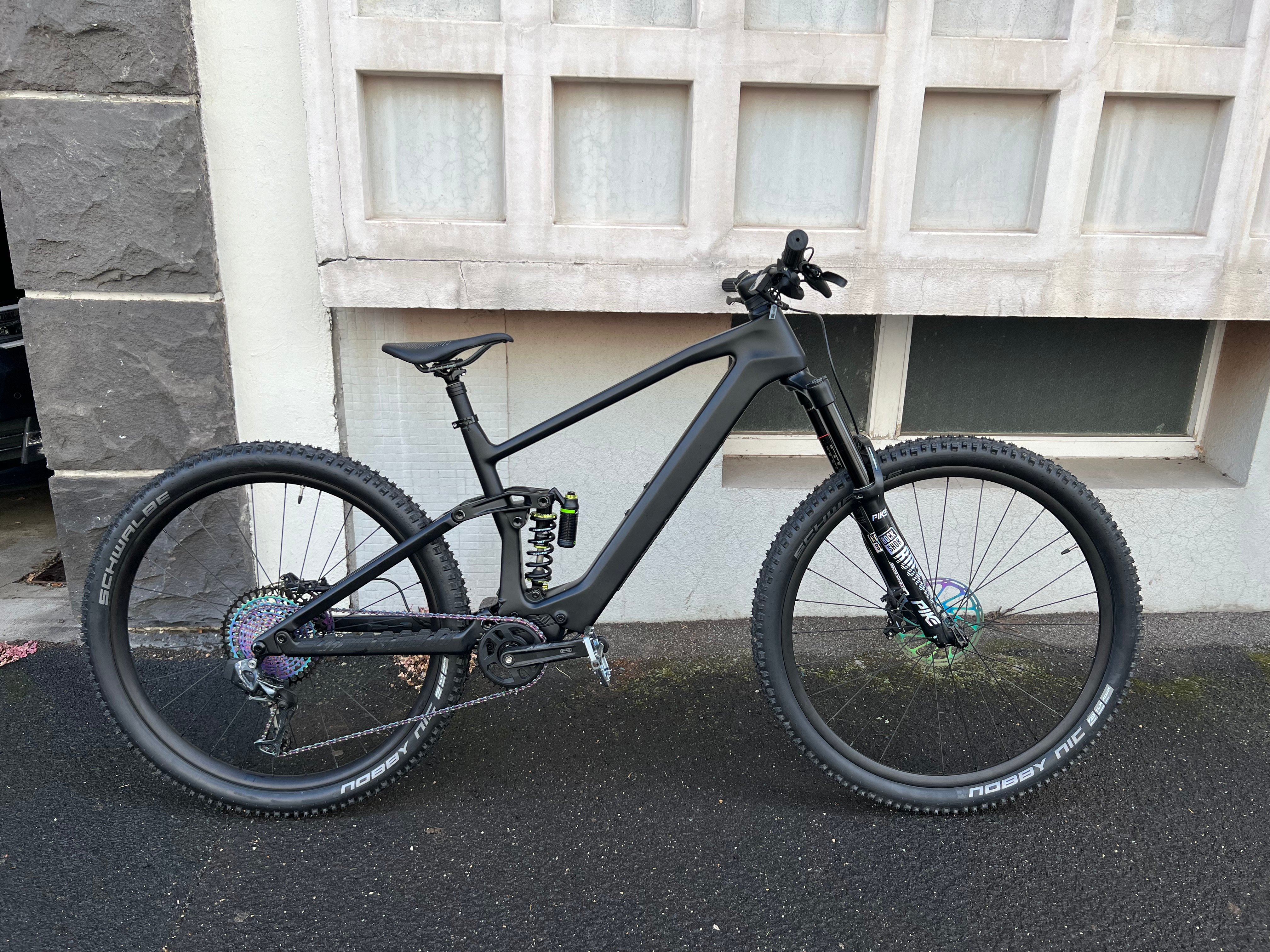

So my build is almost finished, 16.5kg without battery. My dropper is dead so I need to change it.
I’m waiting for the bafang btf014 and in the meantime I will build the 1p that will be less than 1kg

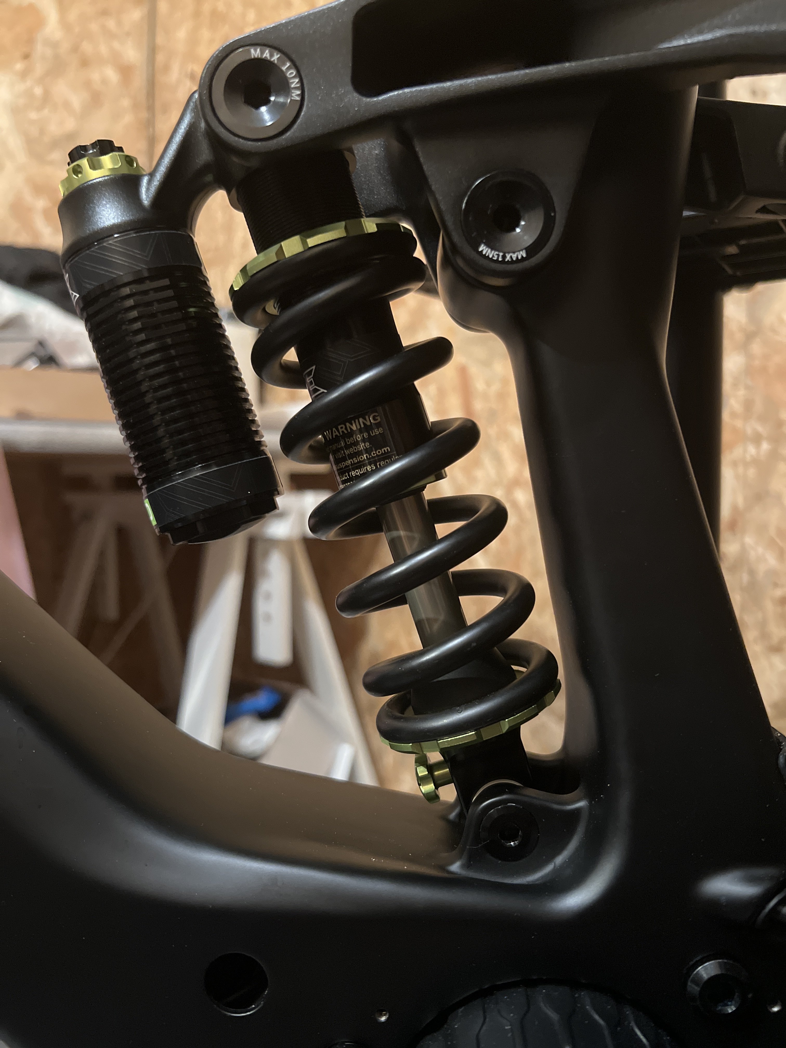

Wow, very light! Cca 19kg with org battery. Does the coil shock fits OK?
Wow, very ligth! Cca 19kg with org battery. Does the coil shock fits OK?
It fits perfectly! My fork is quite light, 1800gr, which helps to keep the total weight low.
I have a alloy wheelset which is quite light but I could save some weight with a carbon wheelset and a new chairing and spider
Looks good! What spring did you go with and how much do you weigh?
I am 73kg out of shower, and I have 450lbs/inch spring waiting for the build.
Same weight, same spring!
