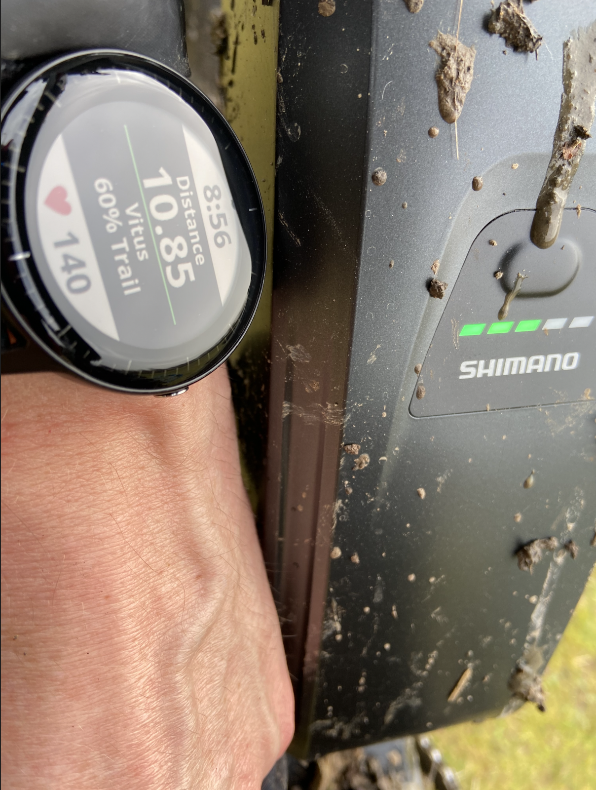

Its not great and designed for use with the phone mounted on the bars, but I too run the EW100 on my bike as I hate displays, and it comes in handy from time to time.
Not sure if @mark.ai data field for Garmin that he created for the E8000 works with the EP8, I have that on my watch.

I think it will work especially when using the EW-EN100 (as that part is still the same) - but I don't think anyone has actually confirmed it for sure :) There's a report here of it working with the new EP8 display but only on an Edge so far (not a watch): Garmin watch data field for Shimano STEPS EMTBs - EMTB Forums
But there is a Garmin-side bug with some of their watches: Vivoactive 4 (and Vivo 4s and possibly Venu) that prevents the bluetooth connecting - so don't try it with one of those!
I haven't used the E-Tube Ride App - but I think it might only display 5 bars and not the actual percentage - at least I haven't managed to find any screenshots of it displaying a percentage ...
