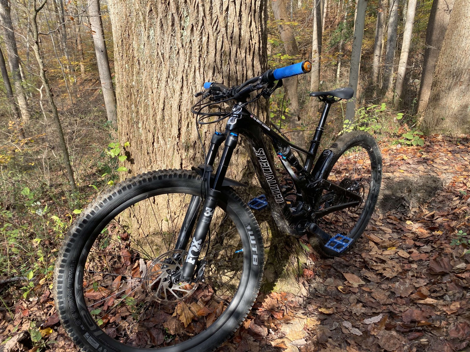

Rise gets the win on price, no doubt about that. I have a SL, almost no stock parts left (actually still using the G2 RSC) Large w/ Pike, DPX2, Cascade link, Bike Yoke 160mm dropper, XT 12 spd w/ XTR cassette 10-51, Praxis carbon crank arms, Next R bar 800mm, Diety Copperhead, WTB Silverado Ti rails, Roval Carbon w/350 DT Swiss, 2.6 Butcher Grid Trail and 2.6 Ground Control 2.6.
39.2 pounds tubeless w/ XT Trail pedals.
Just for kicks, I removed the internal battery, threw on some Bontrager Line Pro 30's shod w/ 2.3 Purgatory Grid, 2.3 Ground control grid. I'd guestimate that the wheelset is about 200+ grams lighter than the Rovals w/ 2.6 tires.
34.11 pounds/15.47 kg with no battery, 36.51 pounds/16.56 kg with range extender...w/pedals.

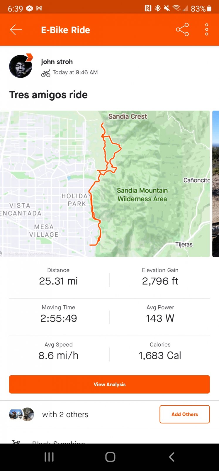

Here's a glimpse of range possibility using the range extender alone. I'm a fit 51year old, 195 pounds ready to ride. Bike @ 36.51 pounds/16.56 kg Dialed down power to these levels-
Eco 20/50 Trail 35/60 Turbo 75/100
Used Eco for 98% of the ride, used trail and turbo for some short, steep technical bits.
Had 20% battery left (or 10% of a total of 50%. Mission control app reads a fully charged RE as 50%)Also had another range extender in my pack just in case.
