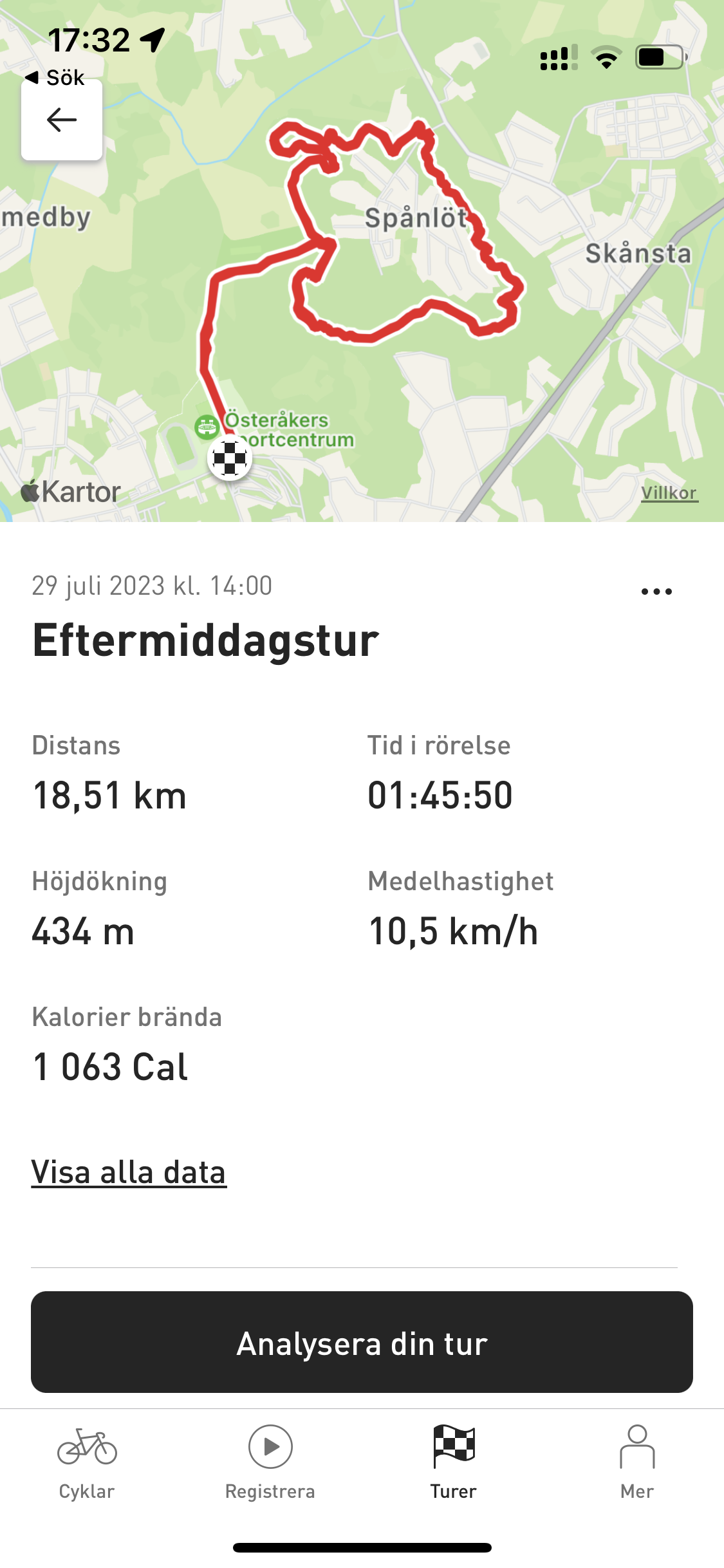

Been riding FF in mountains for 10 days soo now Im back riding XCO tech trail with SL 2.
Super agile and fun...more of analogue bike with support than e-bike.
I run a Hacksta MTB XCO track in Åkersberga Sweden:
4 laps in total 18.5 km
Time 1h 45 min
Climb 434 meter =1423 feet
Power Eco mode 20-40
Last run 40-50% on micro adjust
Charge at start 80%
Charge at finish 50%
Power usage 30%
Rider weight 98 kg fully geared
I guess power effort and battery usage is OK running this.

Thanks Yes, at least for me tech trail are great with the SL 2.
I am still "early" in using SL 2 with 120 km soo far, and using Garmin Fenix 6X for GPS and measuring.
3 laps in Eco mode setting 20%-40%.
Last lap 30-40-50% on micro adjust started in Trail mode.

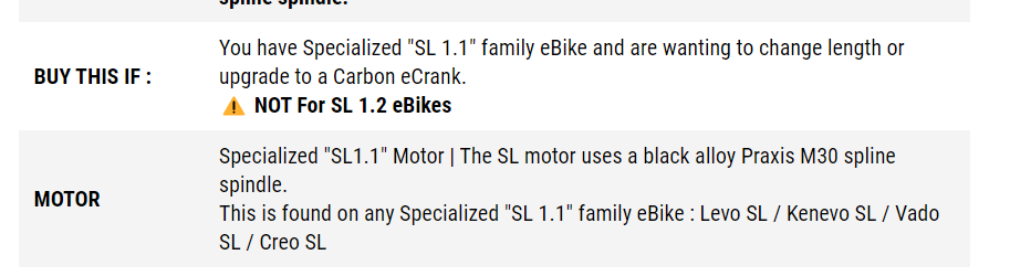

Hi, just checking, will the Praxis cranks for the SL 1.0 fit the SL 2.0? No change rite
ok nvm...i just saw this on the FAQ.

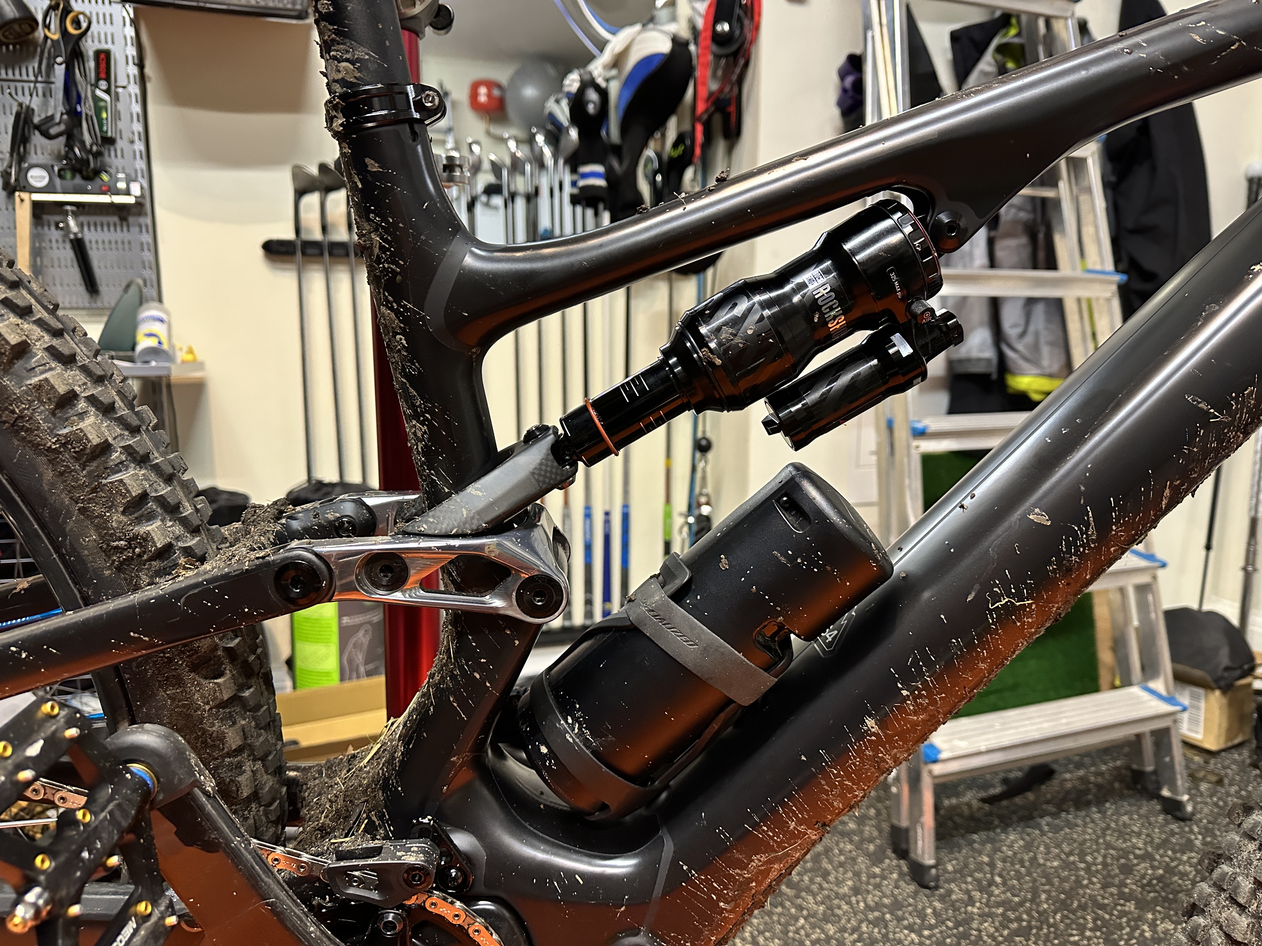

Does anyone know where to get the front eyelet shock hardware for this bike?
There is a very high volume specialized store here in Austin and they can’t seem to figure out which hardware fits this bike.
I have a Storia v3 that came off my LSL 1 that’s 210 x 55mm and I would like to be able to quickly switch between the float x and Storia, so I want them both to have the hardware without having to press anything back and forth.
It uses an 8x20mm hardware. All shock eyelets are the same size but shock manufacturers use different bushings systems. I would go to the Storia website and order the 8x20mm kit directly from them
