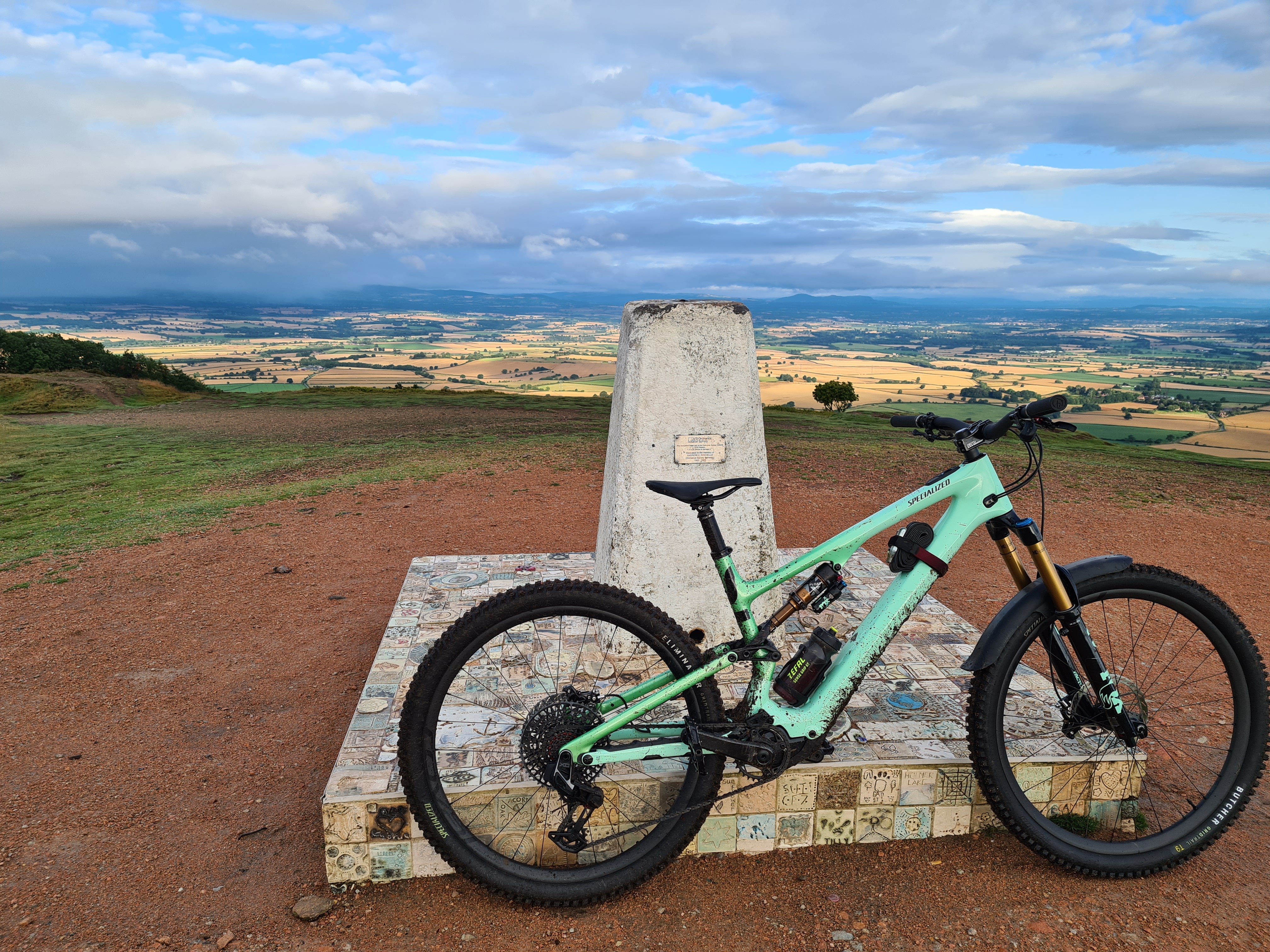

I got them here. S-Works - kit adesivi telaio.
Yeah, they are stuck over the top of the black originals. When they arrived I found it better to cut the letters off individually and apply them one by one as it means they fit better. Not sure he does metallic blue though. Arrived in 5 days from Italy.
Thanks - looks a bit more complicated than simply feeling them I have a Levo SL in size S4! I’ve just arrived in Majorca for the next 10 days… so I’ll have to get my ruler out when I get home.
Looks like they can do any colour… but I’ll ask about a metallic blue.
Slik Graphics will have metallic blue, and they’ll already have the measurements so you won’t have to measure anything. I’ve ordered all my stickers from them, they even matched the almost impossible to match redwood smoke colour on my levo pro.

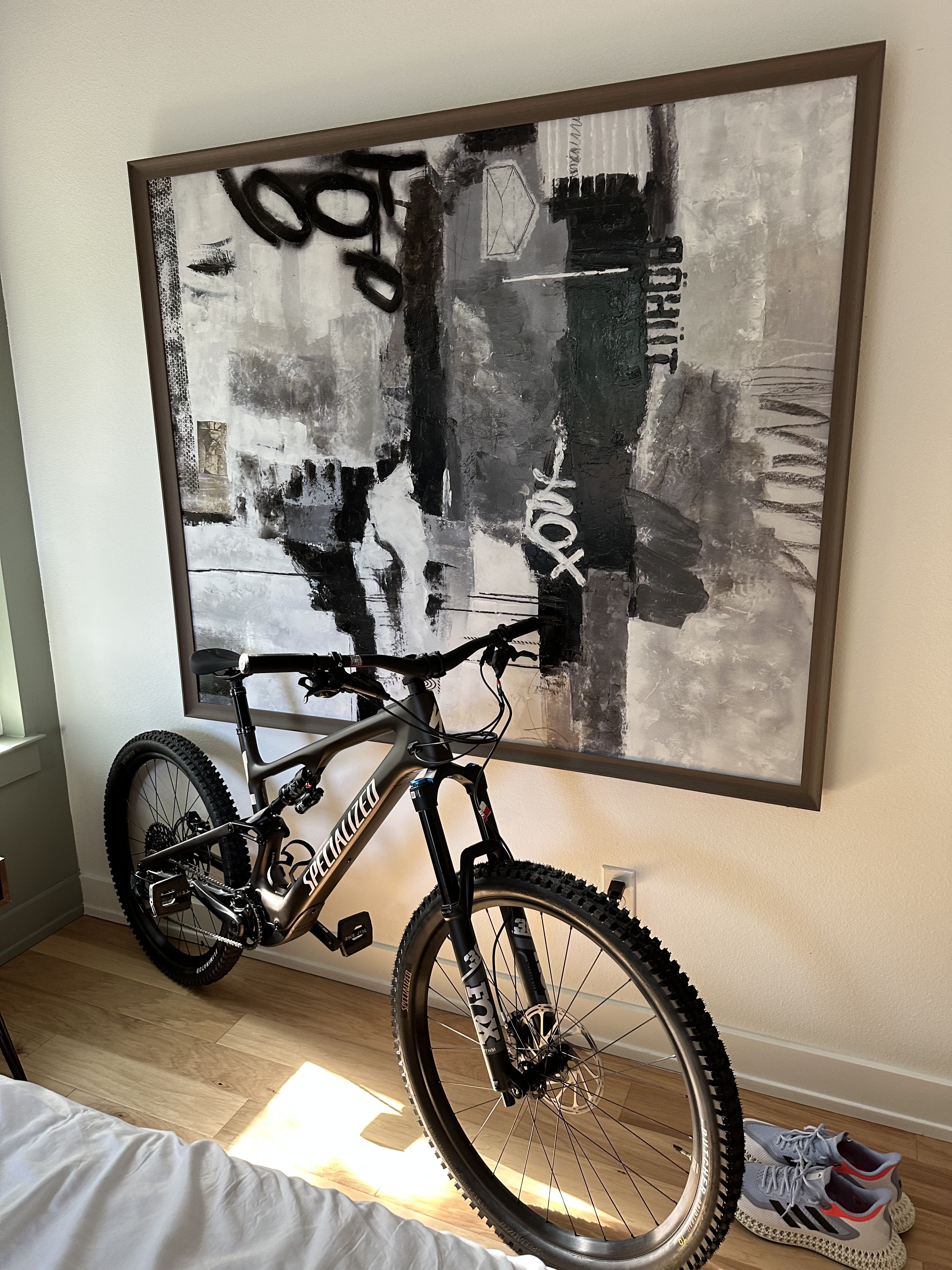

I got my Comp Carbon yesterday. Unfortunately I just also go surgery for a broken clavicle from losing it full speed into the trees at Angel Fire.
Guess the bike will torture me next to my bed for the next few months.
I hope this s6 works out. It’s as long as my trek slash, but with a more mellow seat tube. I rode an s5 Levo they had built and that felt a bit short for me. I’m hoping a 35mm stem will sort me out.
I’ve got a EXT storia from my gen 1 SL I kept around that will make its way on here. Not sure where I’m gonna go with the fork.

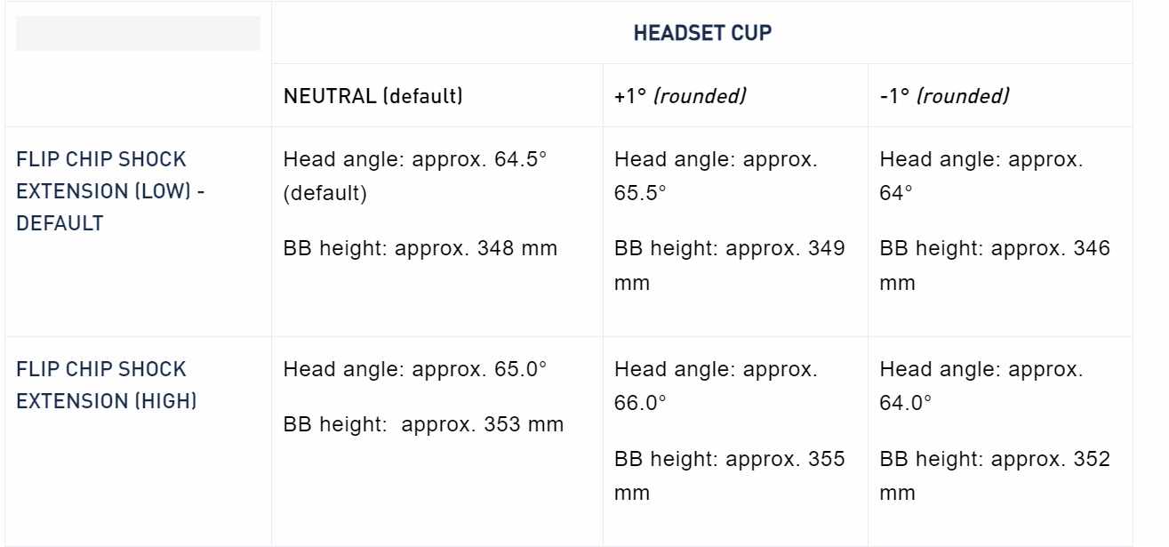

Anybody try to put 27.5 rear wheel on the longer chainstay position but with the high rear shox position, to see how the geometry is impacted? thanks
The high shock position only gives you 5mm at the bottom bracket whereas the 29er position lowers your BB probably closer to 15 mm at the BB if you kept the 27.5" rear tire on.
So unfortunately that's going to make the sta pretty slack, BB pretty low, etc.
One work around is to run a 2.5 or 2.6 rear 27.5" tire to help lift it back up.
I was unable to see a path to a decent CS length combined with the 27.5" rear wheel and a BB that didn't bang the ground and even more slack sta, which is why I went a different path for my ebike than the Levo SL2.

Is anyone riding their bike with the flip chip in high and the head tube in the slack position?
I’m curious what type of HT angle this results in. Seems like it would give you a higher BB, steeper ST angle and a similar HT angle to the factory settings.
