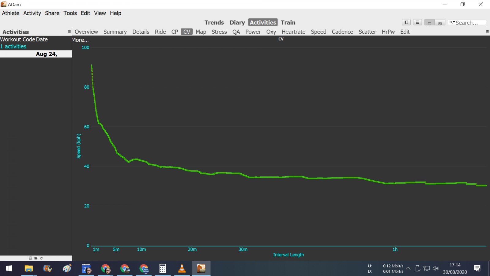

If you run up Mission Control. Turn on the bike. Let it connect then select ride, you have several "tiles" showing you statistics. IF you press and hold these tiles a drop down appears and you can change what you want them to show.
If you record the whole ride in Mission Control you can then export that file- email it to yourself or something off the phone, assuming you then have access to a windows PC, you can download a freeware app called Golden Cheetah :
I've not used it for ages and this is the only shot I can find from a Kenevo ride last year. But basically you can analyse all the data from the ride and it helps you find out where or why problems might be occurring.
