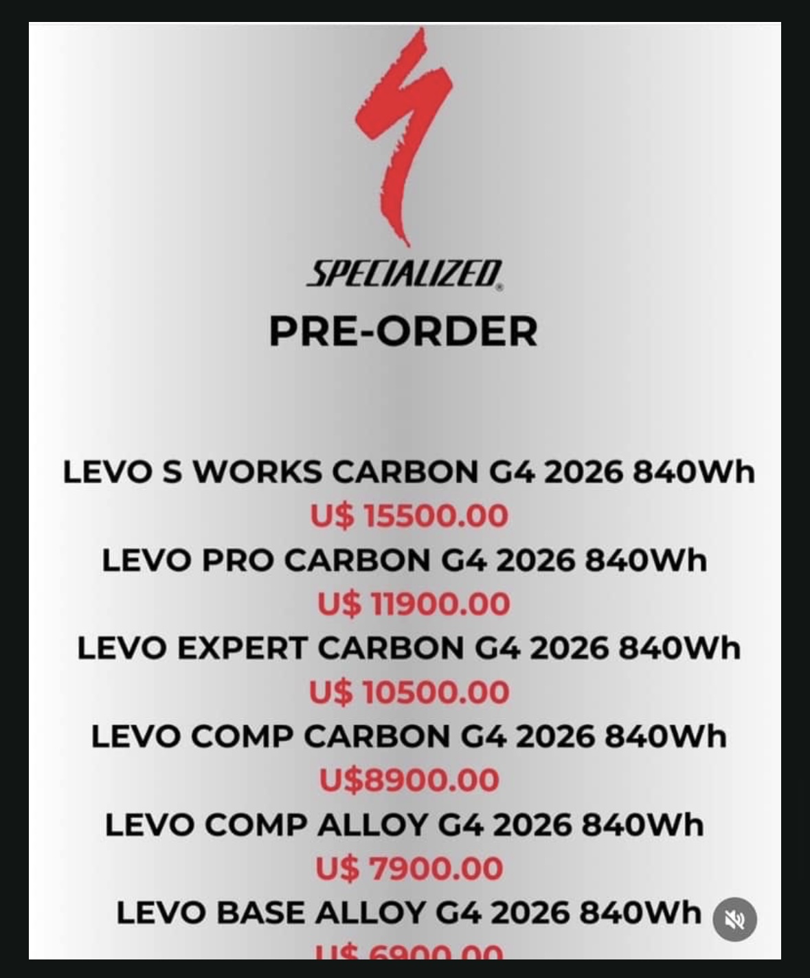

I believe those numbers are in Euros
In US:
S-Works- $13.5
Pro -$11.5
No looks like US$

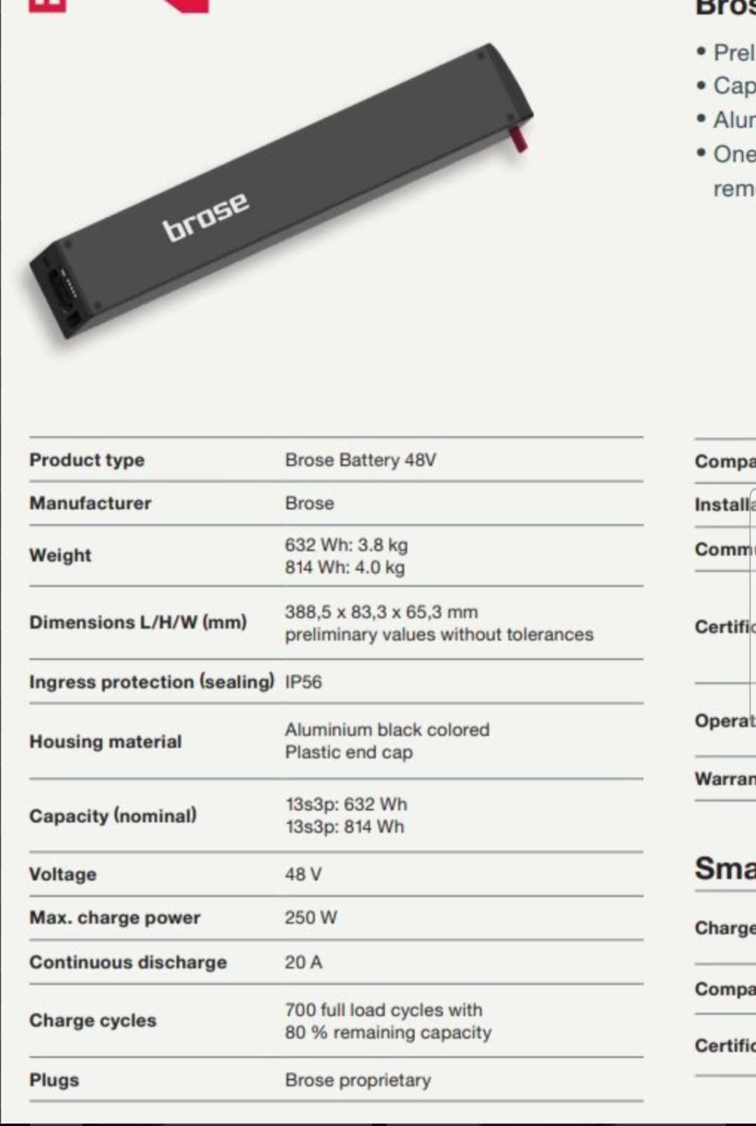

Hey love the conversation here, yes your points on the standard for 48V systems stand on solid grounds.
The first reason why I speculated on 14S3P and 14S2P was first because the 52V and 48V ebike system aren't to far apart from an electrical point of view. Adding a link to a page that talks about the interchangeability of the 48 and 52V systems, what the advantages of 52V batteries on 48V motors are and what the advantages of 48V batteries vs 52 are.
The second reason was because of the Levo spec number of 840Wh and the currently most popular high capacity cell from LG the M58T with a capacity of 5,57Ah.
42cells(14S3P) x 5,57Ah x 3,6V = 842Wh
But hey we all can be wrong, there are different points of viewing things.
If we take the fact it has the new Brose motor and that they kept the original Brose battery specs then the battery in fact are both a 13S3P configuration but using different capacity cells.
The original Brose batteries are 814Wh and 632Wh which would imply to:
13S3P - 39cells x 3,6V x 5,8Ah = 814Wh
13S3P - 39cells x 3,6V x 4,5Ah = 632Wh
If Spesh used this configuration then that means they for marketing names rounded(like u implied) up for the big battery and down for smaller battery.

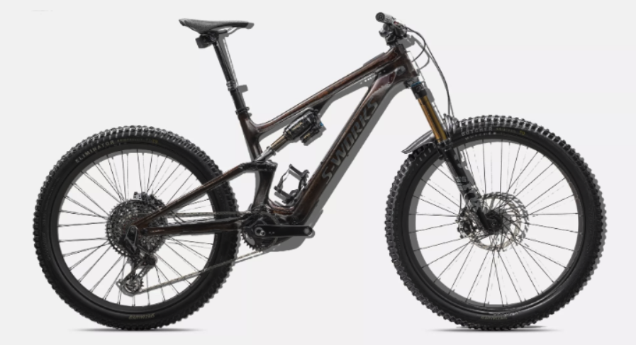

Saw an sworks in person today. Unreal. Paint is colorshift burnt orange/dark red/dark blue/black metallic.
You can indeed switch between class 1 and 3 via the remote. Battery size is smaller than I expected.
Swat just behind the headtube and about the size of a small seatbag.
2.3” tires. Definitely room for 2.6”. Definitely no room for 29”

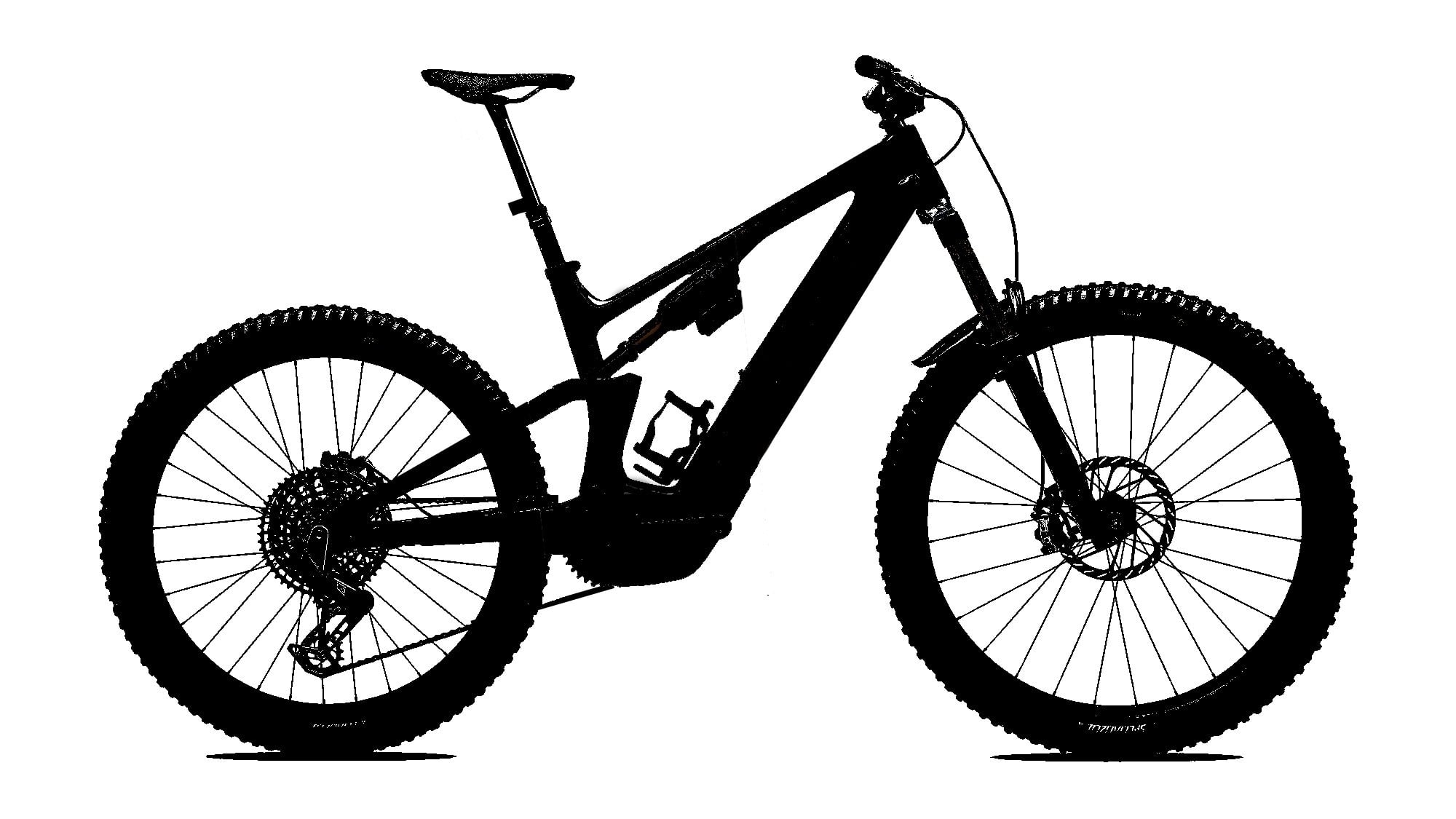

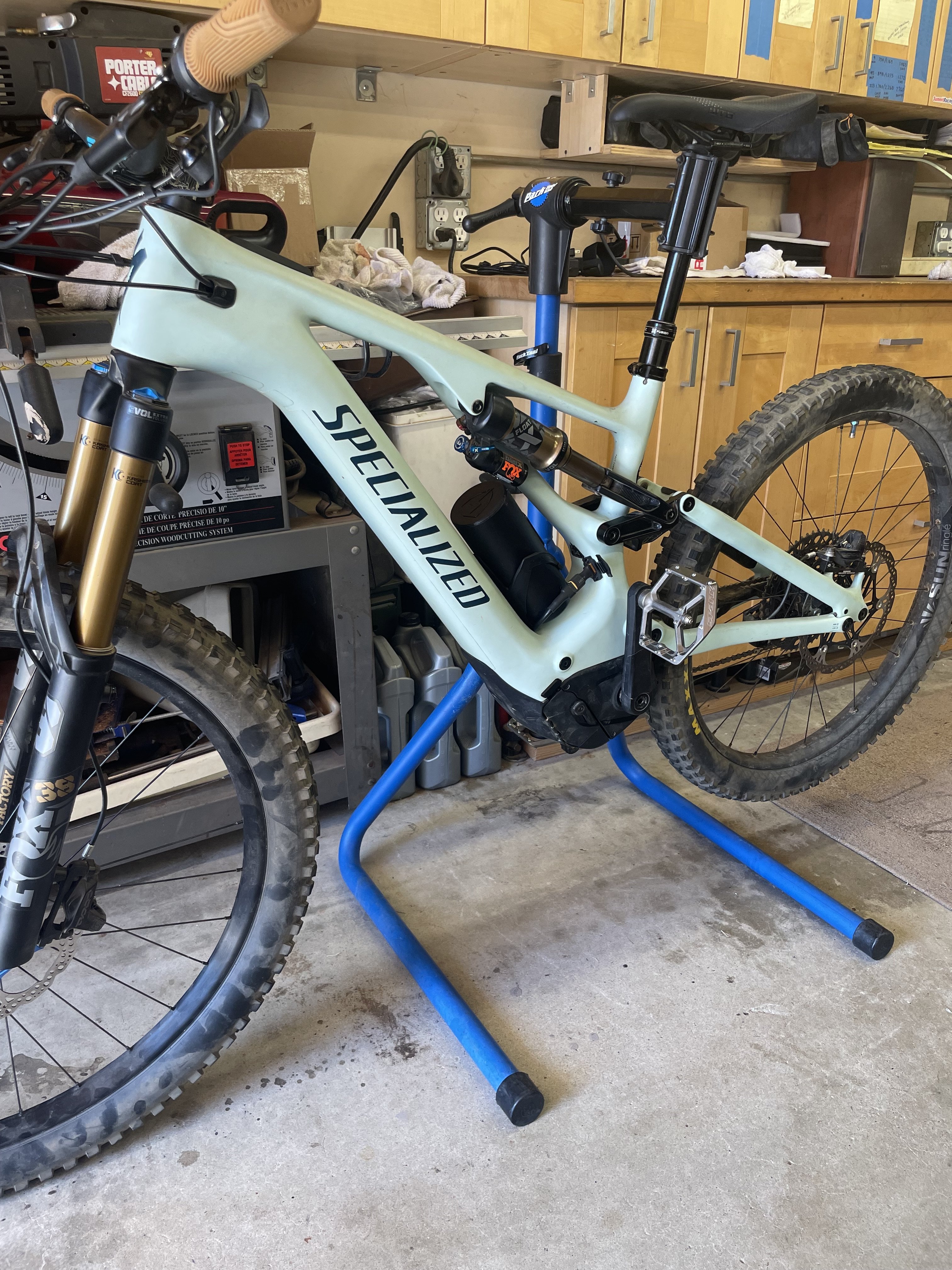

from design it looks identical (at leat for me) like an SL2 just a more fat downtube...
It was discussed in the original (now closed) thread.
But yes, it's pretty similar, Gen4 over an SL2
We did a mockup based on an SL adding in what we knew and had this before there were any leaked images, we got a lot right, mainly due to the SL similarities to start with :
First real image of the all blacked out version? 😧
It was only the mockup, quite a few things were wrong compared to the actual Gen4. The image design was discussed here - mainly the area round the headtube was completely wrong, but it was only supposed to be a rough guess.
