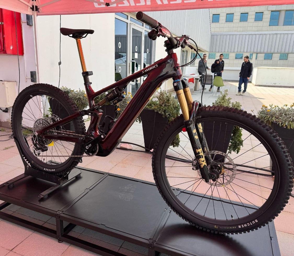

New Levo 4 s-works
23.5kg, is that a joke, for 14000euro? This wight you can buy for 8000euro, or dji for 6500euro 21kg give me a reason where this is justified to buy?

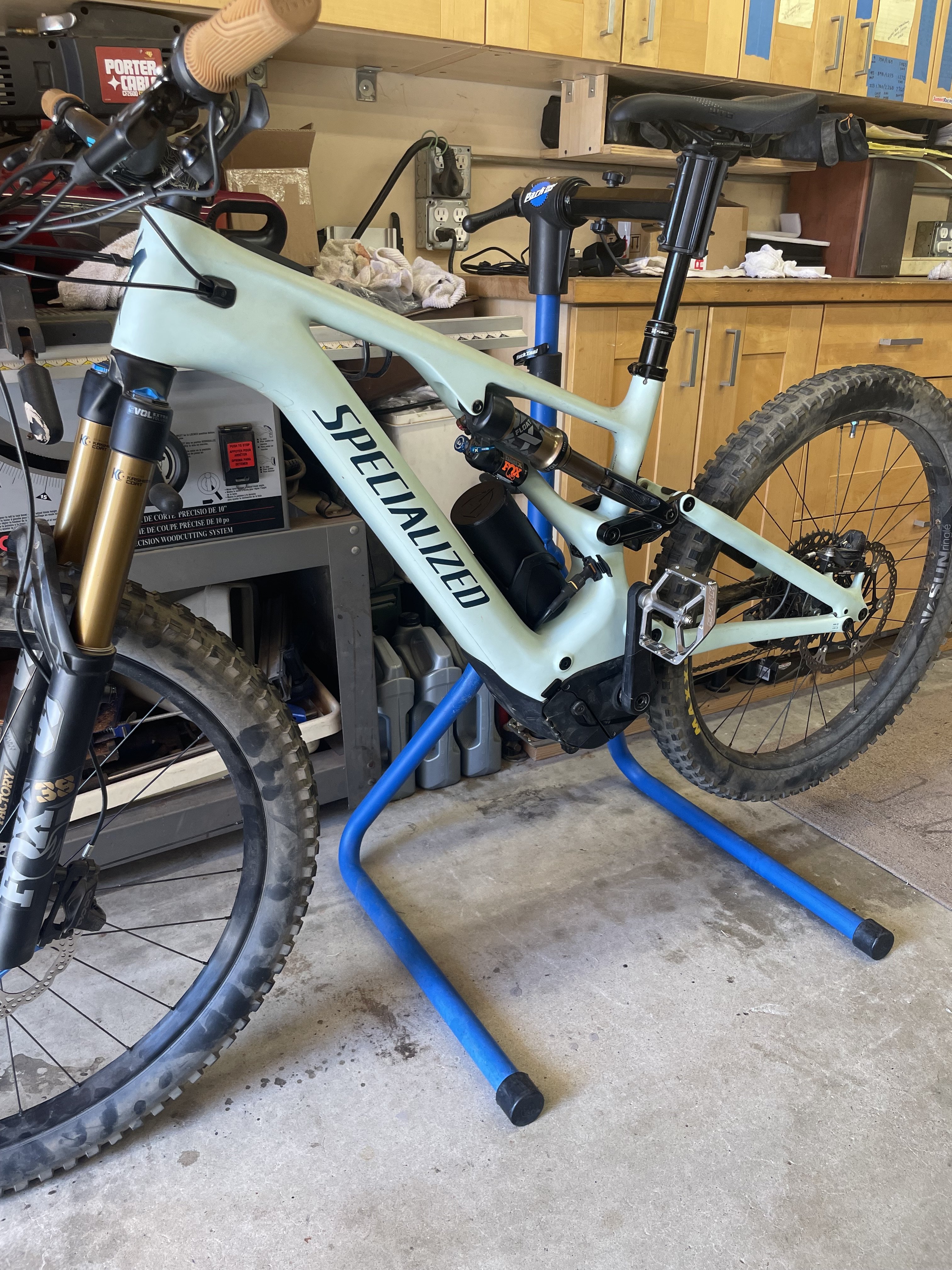

Industry standard for 52v systems is 14 cells in series, 48v = 13 cells, and the gen 3 levo which I have is 36v and has 10 cells in series per group.
Has nothing to do with motor load.
Different discharge rates on cells and capacity (ahr rating ) is how they are classified.
Higher voltage equals lower amperage for the same wattage output.
Highest rating for 18650 cells is 3.5ahr.
Highest rating for 21700 cells with the “new” Samsung 58E cell is 5.5ahr rating, previous max for their 50Ecell was 5ahr. They’re probably going to continuously rate it at 5.8 ahr but testing doesn’t support this but marketing is what it is. Just sayin.
As far as the 840w battery not being possible I gotta disagree.
840 ÷ by 48v = 17.5
Using 1850 cells rated at 3.5ahr would need 13s5p which is 75 cells at 48gr = 3600 grams.
Using 21700 cells rated at 5.8 ahr rating would use 13s3p which are 39 cells at 68.7gr = 2679.3grams.
Battery manufacturers a lot of times round “up” when rating their products.
I have an aftermarket extender battery ( trailwatts ) on my Levo and it’s rated at 252w meaning it’s a 10s2p configuration but I can only use it in parallel with the main battery and it measures in at 3”x7.5” and fits where the water bottle cage is and that’s with the shock strut. So eliminating the strut should allow a 280w battery to fit easily.
Not sure about your guys standard 4a chargers which is common but mine gets hotter than sh-t when charging. Supposedly that’s normal.
Looking at the pics of the “new” charger with the fast charge capability it doesn’t look
Iike there is a cooling fan or anything to help disapate the additional heat from the increased charging current. So that will be interesting to see how they handle that issue.
