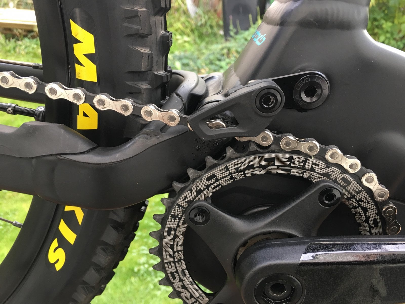

I see your ring gear was mounted on the outside of the spider instead of the inside like stock. That certainly buys you distance out which is what I was saying would help me fit the 38T (mine didn't fit). The mounting surface on that side of the spider isnt flat though. Does anyone else have any concerns with moving it to the outboard side? I'm wondering if you have issues shifting into the lowest couple of gears.
hello i have no problem at all. I've been driving it for two weeks now, everything is going perfectly. And as for the plane placed on the spider of the chainring is also perfect because the outside is slightly flattened.

There are usually flats milled into the spider to allow the chainring to sit flat. In this case the chainring may be bolted to a non-flat area of the spider which may (or may not) cause the bolts to have an uneven pressure on the parts. In the end if it works then it is ok. ;)

Can anyone confirm that the chain guide adapter works with a 2022 Carbon Levo? I went to the site but he says it doesn’t work with most 2022.
Yes the 36T chainring works but the chain guide takes a bit of work and a dremel tool to make it fit. Else just reinstall the bolt and go without.

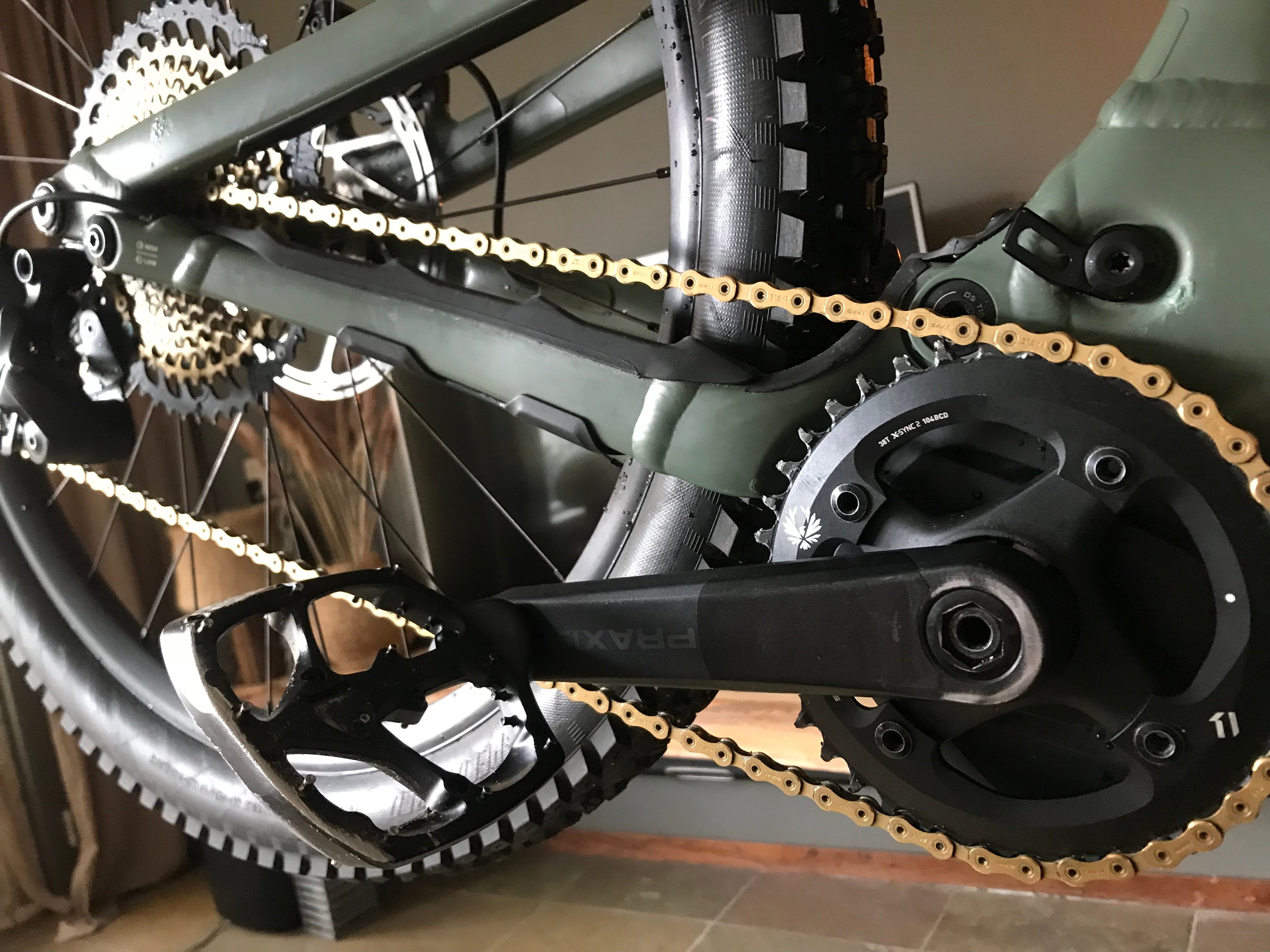

I have just mounted this SRAM 38T chainring on my 2022
Tight fit at chainstay - But no problems for the first 100 miles
I find that I - as hoped - use the "midle gears" more
Have ordered this guide - But I haven't received it yet...

i used for a while 36 and 38, Praxis direct mount also.
My best at the end is Sram X-Sync2 alu 34T.
And you must dismount chian guide.
For the chain i use 117 plus 1, same for 34/36, just check distance of pulleys
Monocorona SRAM EAGLE X-SYNC 2 12V 4 Fori 104 mm | Probikeshop
Hi, can you explain what a 36,38 direct amount is? Does that mean you removed the spider from your turbo levo, or are you talking about the threaded praxis chain rings? Where you only need one chain ring boat?
