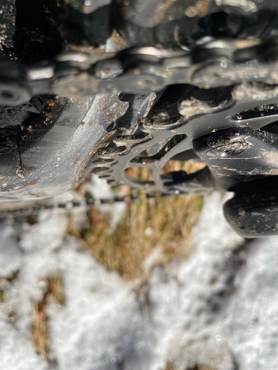

I have just mounted this SRAM 38T chainring on my 2022
Tight fit at chainstay - But no problems for the first 100 miles
I find that I - as hoped - use the "midle gears" more
Have ordered this guide - But I haven't received it yet...

With the 38t SRAM chainring the space is used...but works ok for the some 200 miles now
Sorry pic with dirty bike at the trail :cool:

Just yesterday finished swapping out the 34T SRAM chainring for the Sram 38T on my newly acquired 2022 S-Works.
Happy to report that after a 25 mile test run all functioned perfectly. Original chain was retained with no issues.
With the change I am now using a bigger spread of my 12 speeds whereas previously mostly using bottom 3 lowest cogs.
Mostly more or less flat terrain.
I read here that it was possible to remove the original chainring without removing the crank. In the end I removed the crank and the spider as I could not for the life of me get the chainring over the spider.
Other than that a good swap out which will suit my uses of this amazing bike.
The space between the tip of the teeth and the chain stay measures at best 4mm so close but I don't see it being an issue. The little chain guard had to be removed but I will probably get the adaptor pieces that has been mentioned on this thread. Attached a couple of closeups to show clearence.
