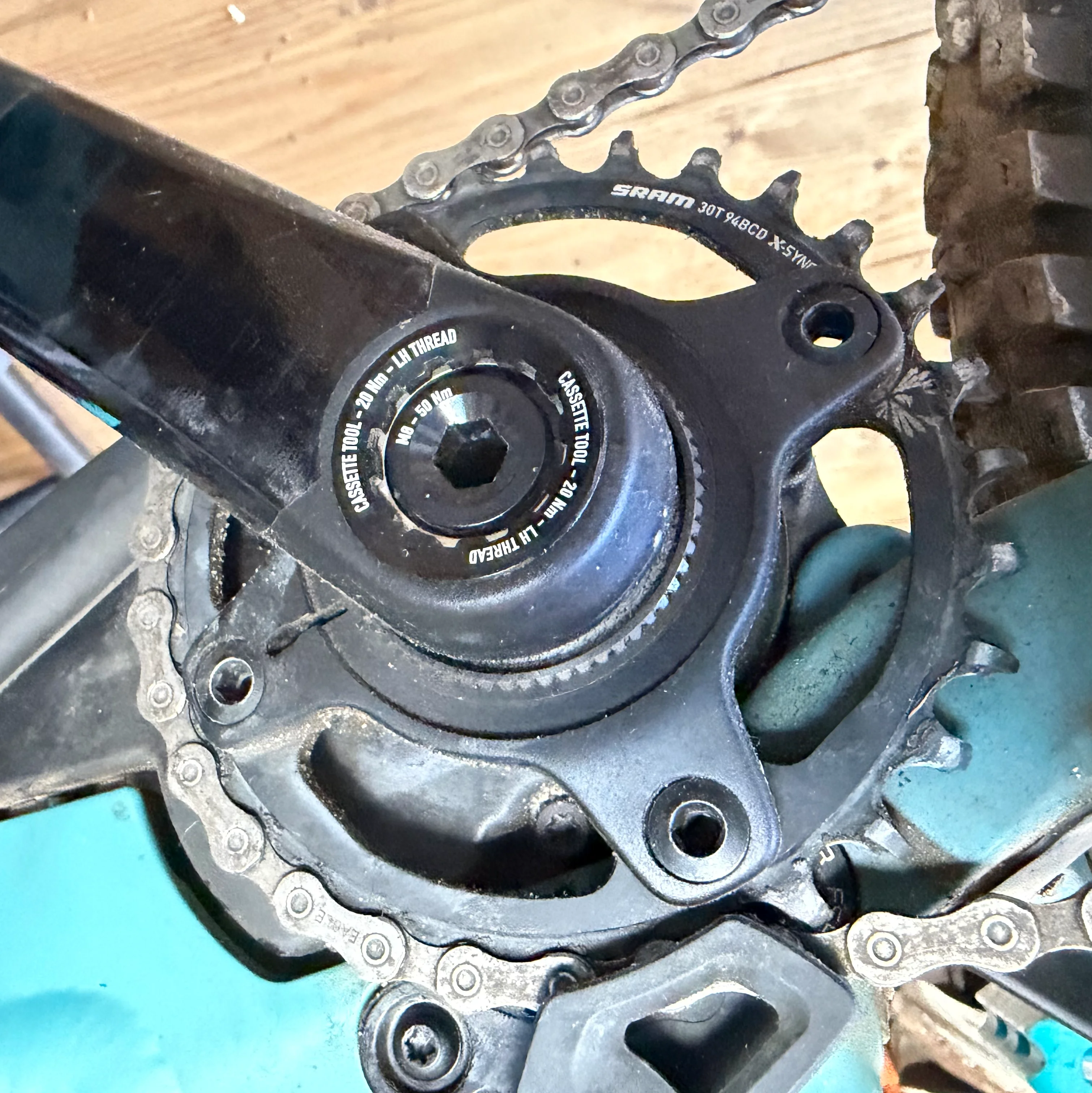

Can anyone tell me specifically what chain ring is compatible with this bike? I've been looking at a
Wolf Tooth 94 BCD SRAM X1 Chainring, but the website says it's not compatible.
Any suggestions, please?
The bike is a medium Turbo Levo bought in 2020
104 BCD chainring.
I use a praxis steel 36t on my 2020 medium levo
Hi, thanks for the reply. Unfortunately, my chain ring has 94 BCD
ah, my bad. I didn't even realise levos came with different bcd
What drivetrain are you running?
something like this should fit:
Looks like the OP has a Levo SL.
I think the biggest they'll reliably take is a 34t.
There are generic rings on ebay that might be worth trying before splashing out on a 'nice' one.
OK, thanks, Johnnystorm. I've taken your advice, I'll return the £60 one I've just ordered and try the £26 one from eBay!
