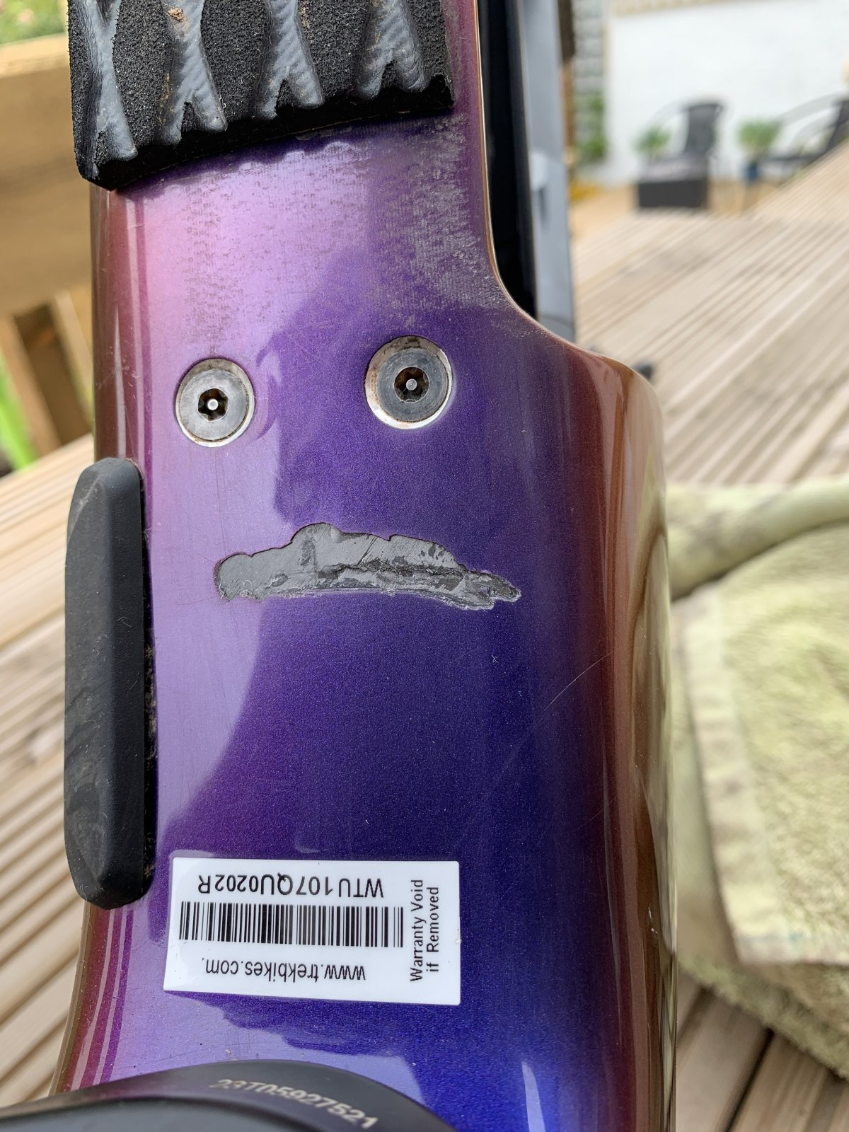

Bugger bugger bugger. I had a simple wash-out on a corner at Cwmcarn. Knock-block "feature" broke and the forks over rotated causing the knurled aluminium damper adjuster on the Lyrik's to scrape along the underside of the downtube.
Trek are stating it's not a warranty claim which I can't argue with but I would claim this "feature" is a design failure and the consequential damage has basically/potentially written my frame off.
The bike shop is offering me a replacement frame at cost or I look to repair the damage: thoughts and feedback welcome! Extremely upset if I'm honest; £6k bike, 200 miles in and looking at a massive bill for a basic wash-out. Not cool.

Id put a sticker over it. Frames are hugely overbuilt at the head tube/down tube bit anyway to cope with all forces involved so it wouldn't bother me too much.
But if you don’t want to do that a Carbon repair company would do it a lot cheaper than a new frame even at cost price
id be pissed with Trek though that’s a shitty response considering it shouldn’t have happened in the first place

I'm inclined to agree. I've got in touch with a carbon repair facility and will see what they say. I don't think the structural integrity of the frame is compromised but worth a check!
I think it's a poor response, particularly when you consider the cost. I notice that the 2021 Slash has the option not to run the knock-block system which speaks volumes!

You'd think they might offer you a new front triangle under some sort of crash replacement scheme, ie at a heavily discounted price?
As it stands, I guess you can get to the inside of the frame at that point, so can see if it's showing any damage on the inside?
I'd probably touch it up with epoxy, sand it back smooth, repaint if I could be bothered and carry on riding it.

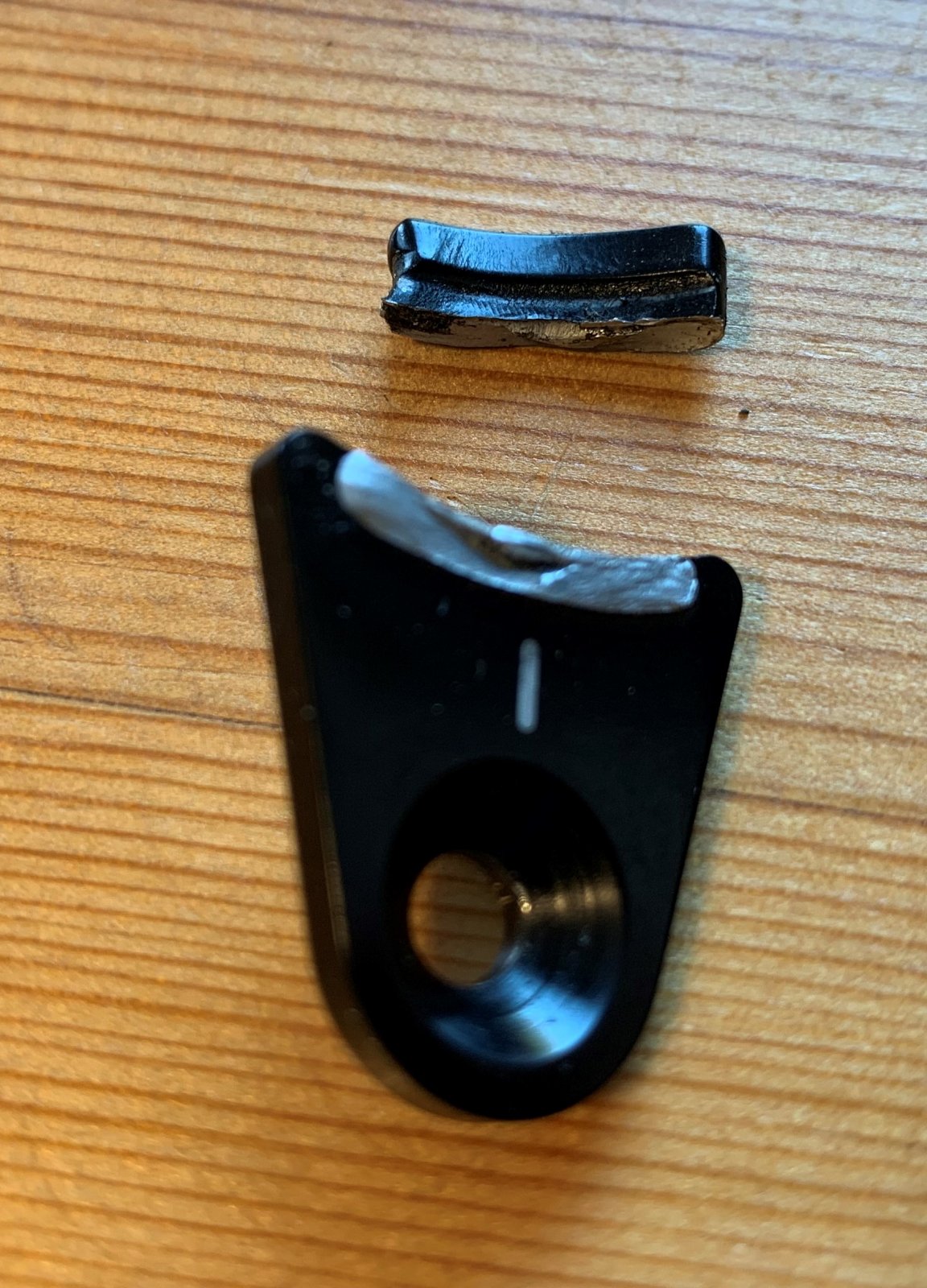

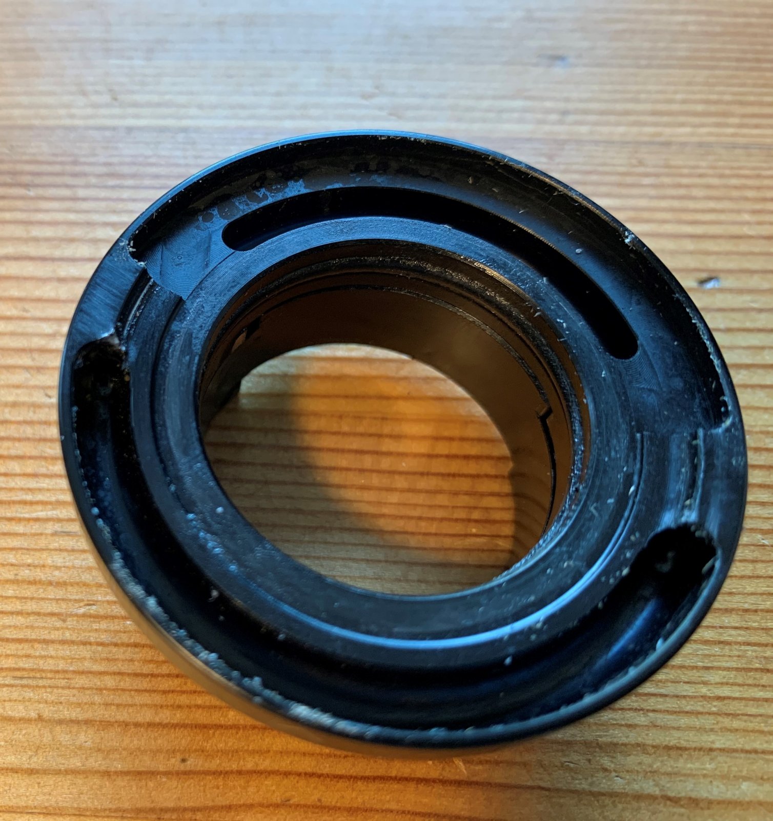

I've attached a couple of photos of the broken knock block frame pin and top cap. You'll see that the "pin" has sheared and there is a slight stress mark in the top cap where they made contact.
Incidentally there was no other bike damage so make of that what you will.
I don't believe there is any warranty claim here, I've never made that claim, but i do believe that the fallout from such a "feature" should not be damage to a frame. Again, I raise the point that knock block 2 can be safely removed on the Slash.

Is that pin (the Stop Chip) made from steel or aluminum?
Trek's marketing says "hey Knock Block removes the whole problem of forks hitting the frame...
... but we include rubber bumpers 'just in case'. It's worry free!"
But the diagram shows a 'replaceable' stop chip:
Which makes me wonder if it is designed to fail under certain loads???? Why would they call this one part of the system replaceable?
I can't think of a reason you would want it to fail though...

The stop chip is an aluminium alloy.
It's a bit of an oxymoronic feature really which Trek clearly have no intention of backing up.

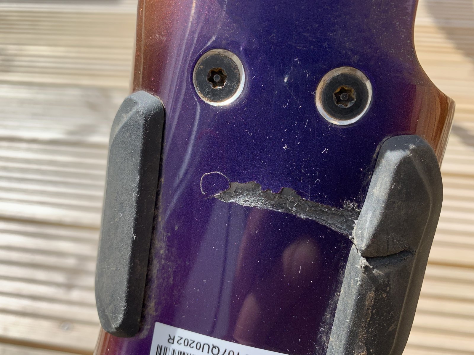

You'll see in one of the first pictures that the charger damper adjuster tore through the rubber bumper too. I only removed that to enable full inspection of the damage.
They must have done a shear test on the stop chip, I wonder what the calculated failure force was? I've got an idea... something equivalent to one 42 year old at a weight of 80kg (of middle age muscle spread) and a carbon Rail...
Confusing. I mean, you don't make something small and aluminum if you want it to be subject to highly leveraged forces, which if you think about a typical 42 y.o. putting all their weight through the end of 780 mm bars during a stack at any speed over 10mph will be.... I'm not a mathematician... but it would be a lot.
