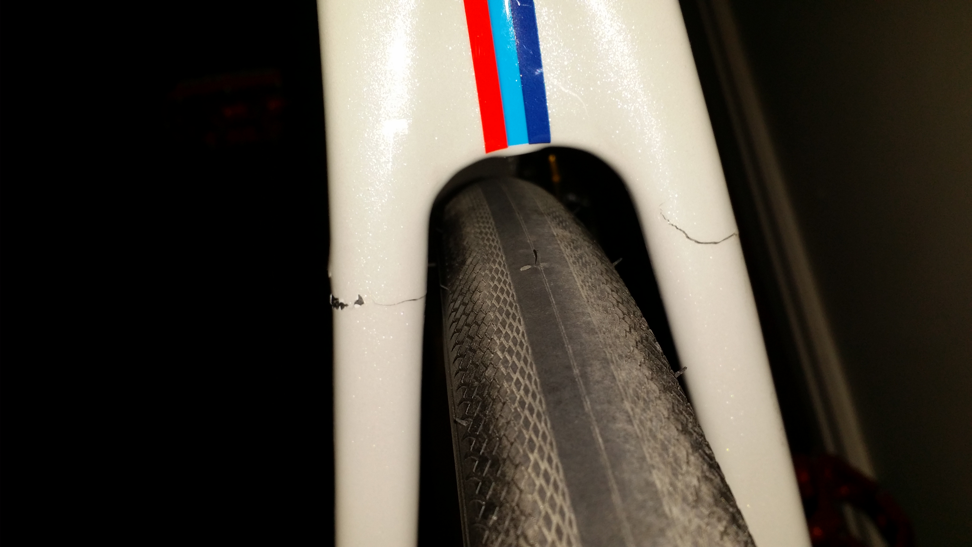

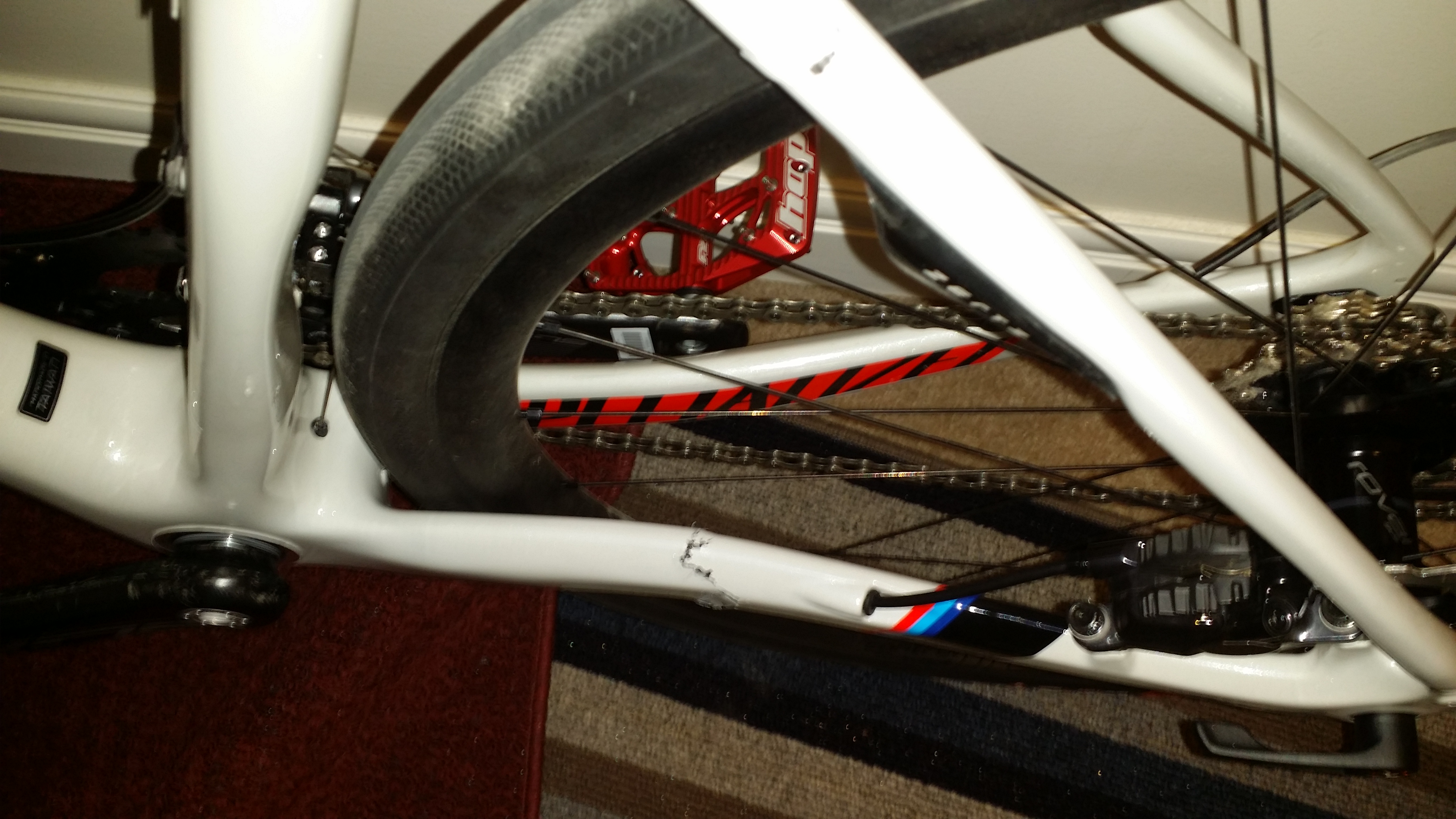

I was riding home from the bike shop, maybe a km away. The road was pretty busy, with cars flying past. I decided I should get on the sidewalk. There was some gravel on the curb of the sidewalk - which I saw. But I said to myself this is a "gravel bike", so I'll be okay. Upon mounting the curb of the sidewalk from the road (almost parallel), the front wheel lost traction, and I fell on the drive side of the bike. But both seat stays cracked, as well as the left chain stay.
Initially I thought the crash was 100% my fault (bad judgement, bad rider). But later on, after thinking a bit about the crash, I thought perhaps Specialized had some fault, as the bike was marketed as a "gravel bike", yet came with relatively slick tires. I did not mention this to the bike shop; I already had admitted fault.
Cracked left and right seatstays 2016-7-15.jpg Cracked left chainstay 2016-07-15.jpg
